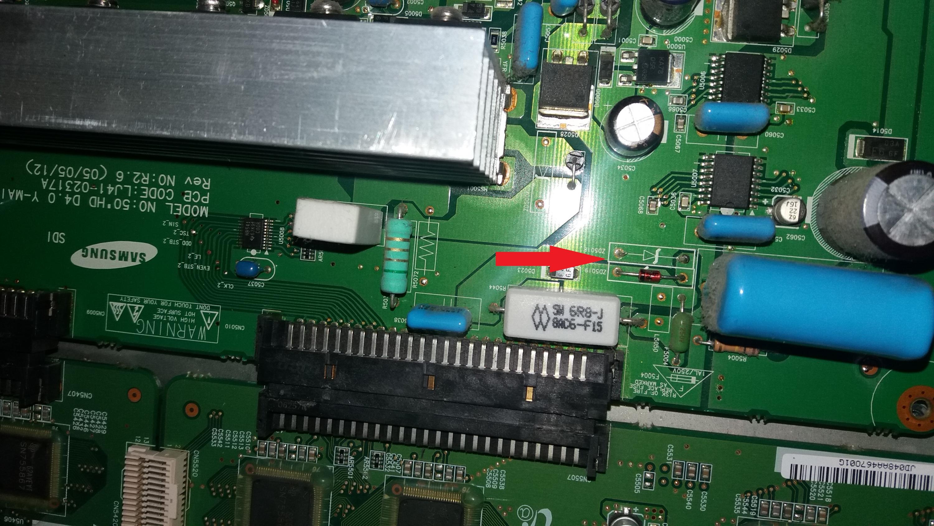

    I have a 50PF7521D/10 with a Y MAIN board faulty
    The problem is it has the 4 zeners faulty (short circuit),can someone knows what are the part number or the zener voltage ???
    on the zener diodes it was marked P758ST but I cant 't find anything on google
    attached you can find the part number of board and where the zener is located

    I believe these are the ones 755-UDZSTE-1733B (33 volt). Looks like 36 volt zeners would also work

      Common failure. Unknown as to why this happens but usually that repairs the ymain back to normal operation

        Are you sure it's a 36volts zener,because on the FUSE (F5004) that was blow up their was at around 700v dc.
