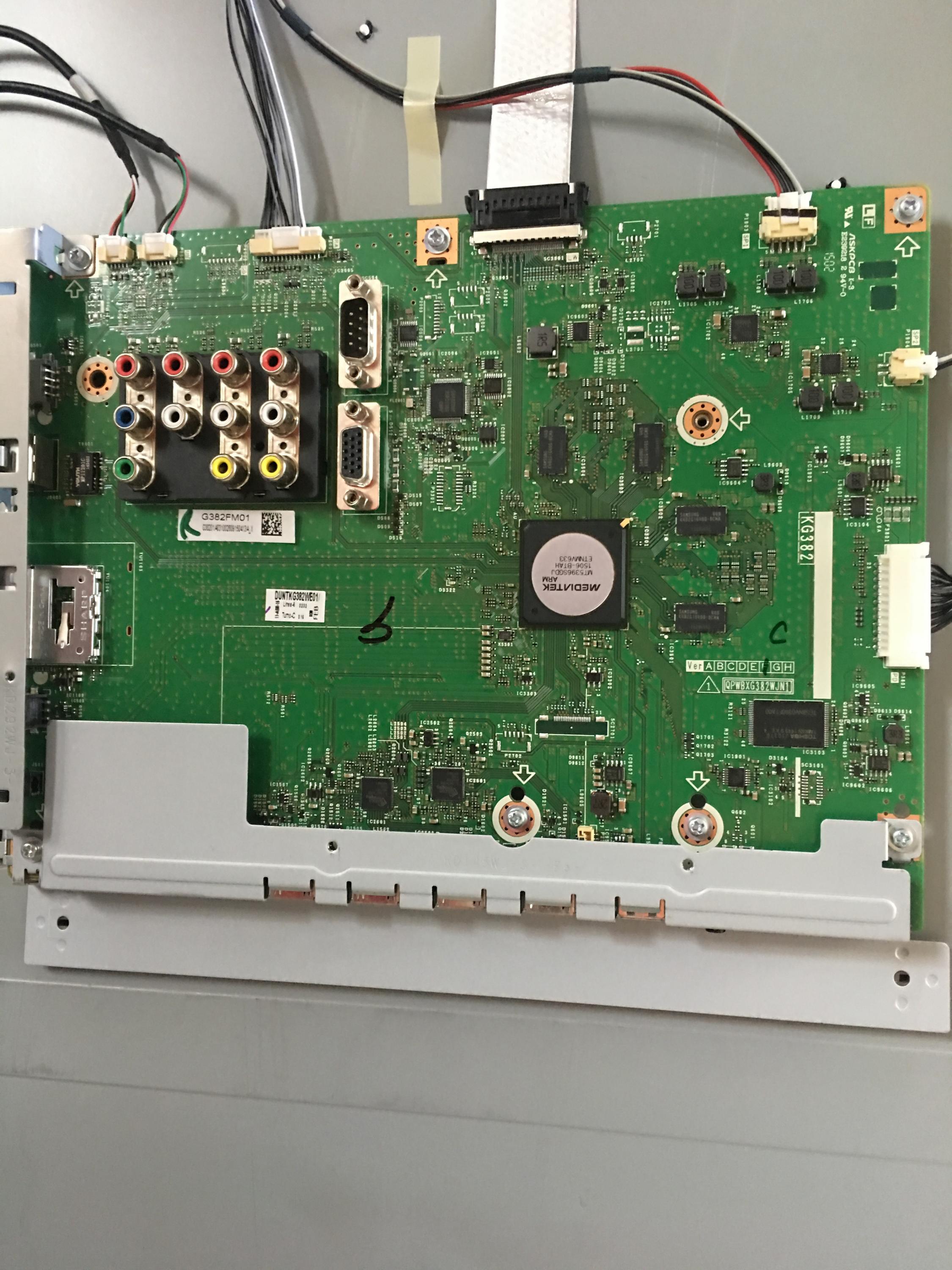

    I have 3 tv's on of which is a Sharp LC90LE6570. I am trying to troubleshoot what parts I need to repair or just replace. I assume the power supply board and or the logic board are going to be the ones with damage.

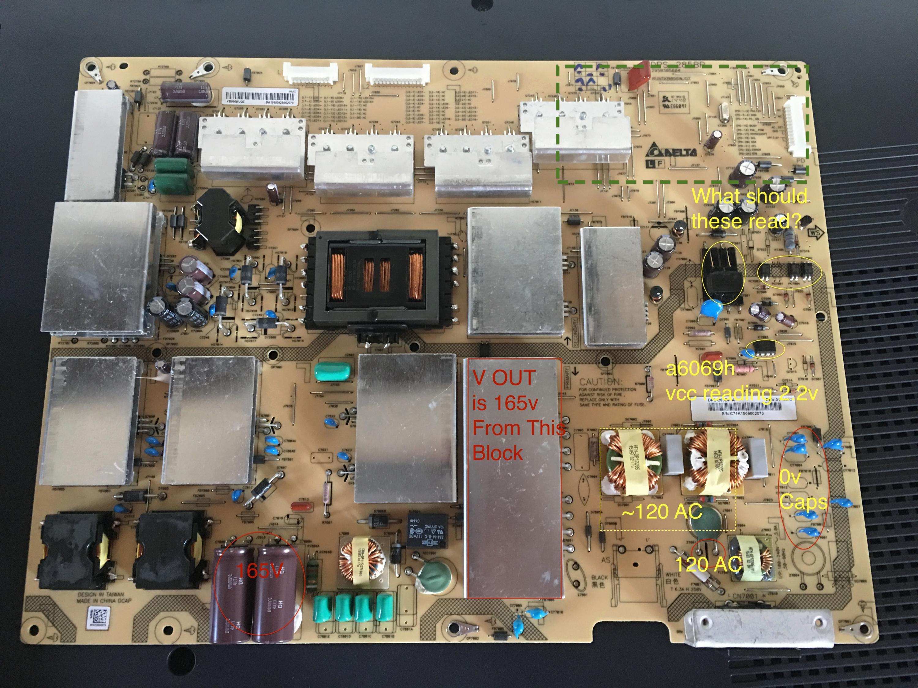

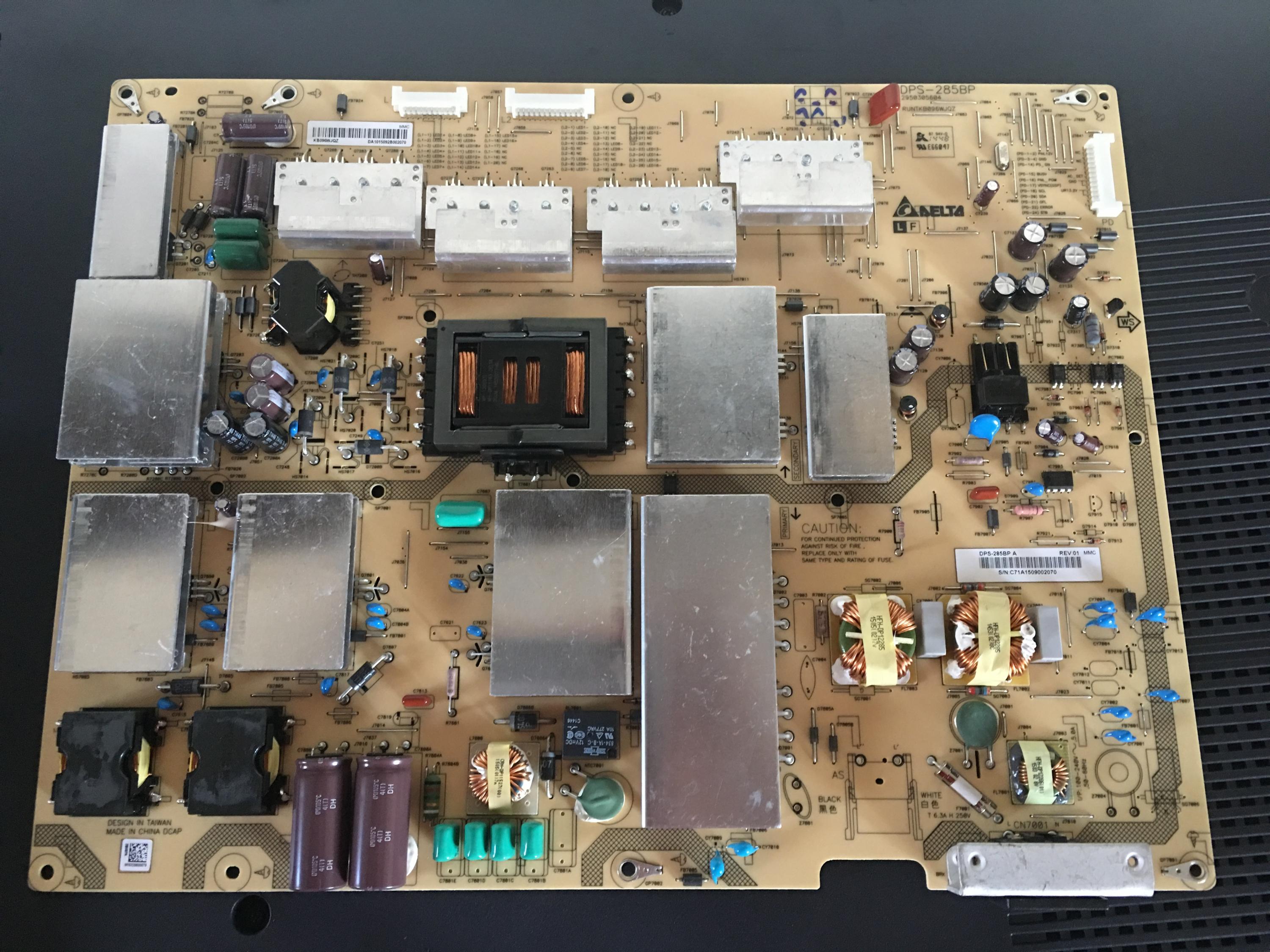

    First I do not get indication of power and no standby light power or anything... zilch with the tv plugged in. I tried to volt meter power pins on the logic board and I do not see any voltages. So over to the power supply. Fuse is good and getting rectified DC voltages over to the relay section of the Primary power side. I do not get any power readings on the pin headers going to the Logic board including the STB pin 24.
    So my assumption is Power supply standby power circuit needs more attention. Anyone here have experience with this scenario and if so any direction you would recommend. I do see some power supply replacement parts online that I can buy to replace and most likely thats what I will end up doing.... but figured I would post it here to see what you guys think.

    What is voltage on main cap?

        You have an ic on back of power board that seems to control everything. Need to read # and try to find data for it.

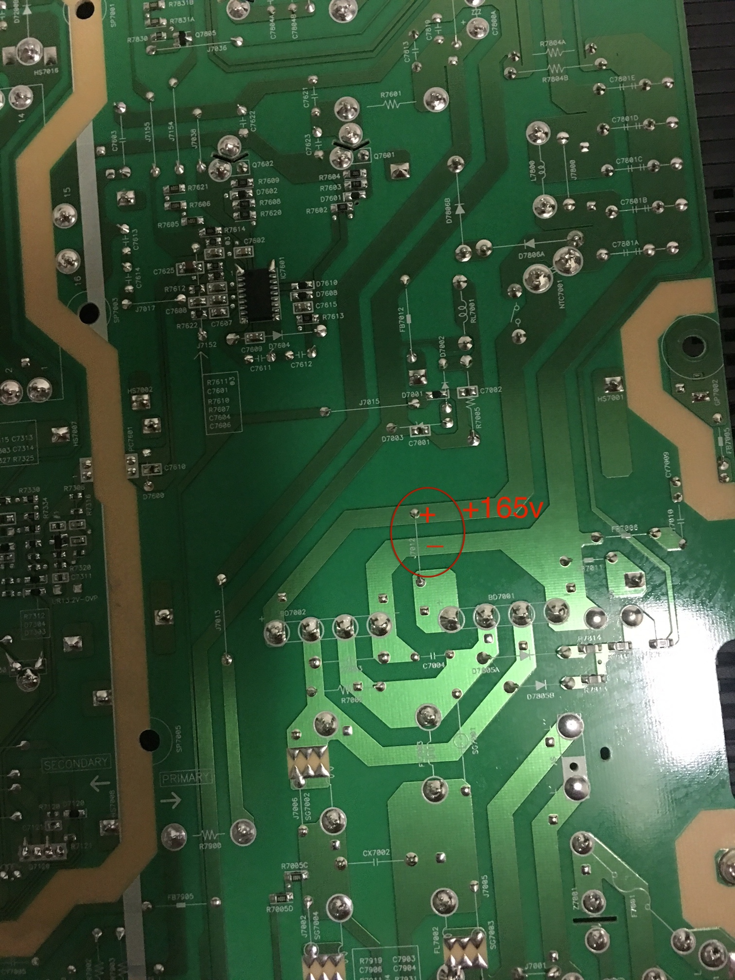

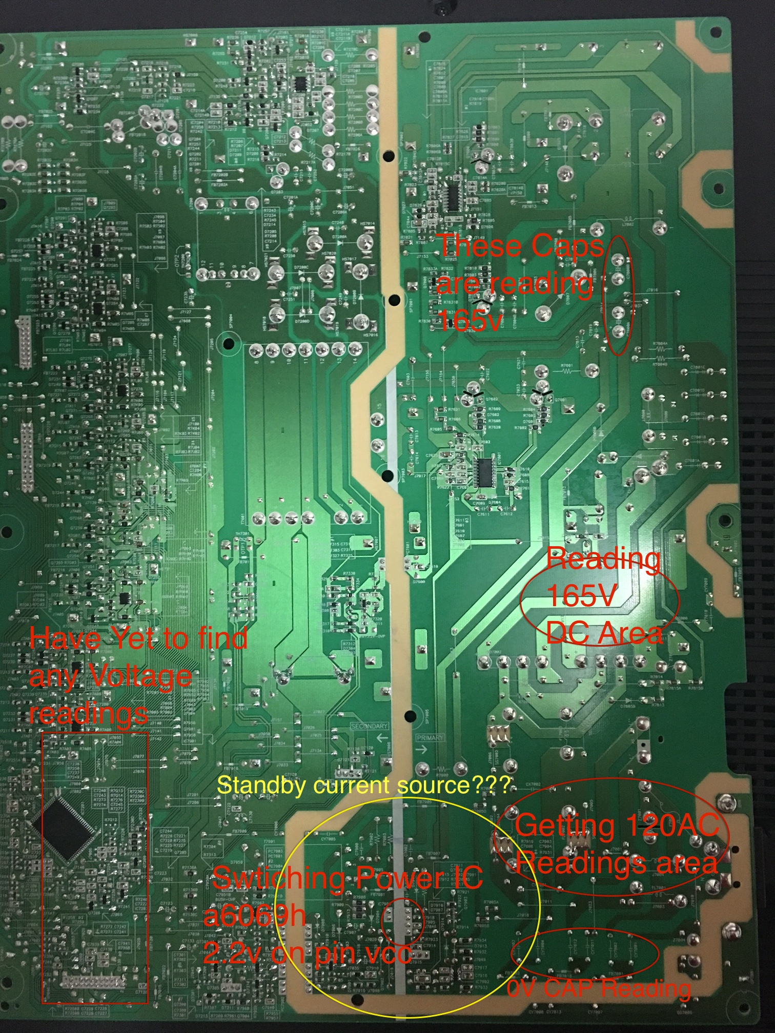

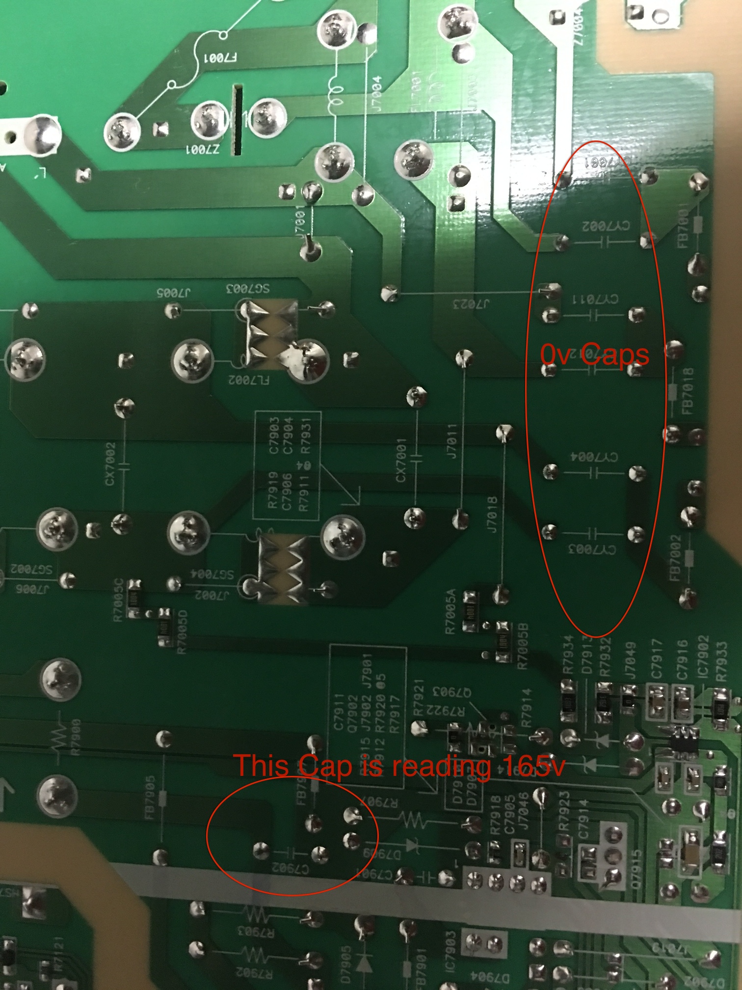

          The first Cap it hits (Blue Ceramic?) is registering ac 120v. The two largest caps on the same Primary Power side of the board are measuring 165v DC.

            Will do. Probing the larger Caps near the main chip are 0v.

                  Here is some readings. Just probing around. Trying to see where standby current is coming from. Also is 165V DC a correct voltage for this board?
                  • dskall
                    • Oct 2016
                    • 2905
                    • usa
                    Re: Sharp AQUOS LC90LE6570 Lightning Damage
                    165v is good in standby
