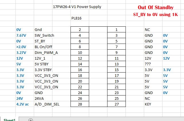

                    #29
                    Re: Toshiba 32BV500B fault - Vestel 17PW26-4
                    Here is my voltages again compared to correct specs
                    Don't Bin It - Repair It.

                      #30
                      With the mainboard disconnected short ST_BY to 0V ?

                        #31
                        As pin 6 has voltage in standby it will have to be pulled to ground to turn on power supply.

                          #32
                          Just me being stupid there... I just needed to short the main switch PL815. The voltages albeit the wrong ones show up after that and I can here the psu clicking. I guess PFC is trying to kick it on?
                          I got real problems though.. Here's my 3.3 & 5v rails too.. The 3.3v looks ok however there's still a light drop seemingly as the PSU tries to start.. But the 5v is all over the show dropping to 2.7 volts each time I assume start up attempts are made. So it seems now I've got a dodgy 5v rail AND no 12/24v
                          Thanks for the advice so far guys

                            #33
                            I cannot tell from the photo's how much the 5V is dropping and that looks like the capacitors are not filtering the dc voltage.
                            You also say no 12/24 but had you shorted ST_BY to 0V
