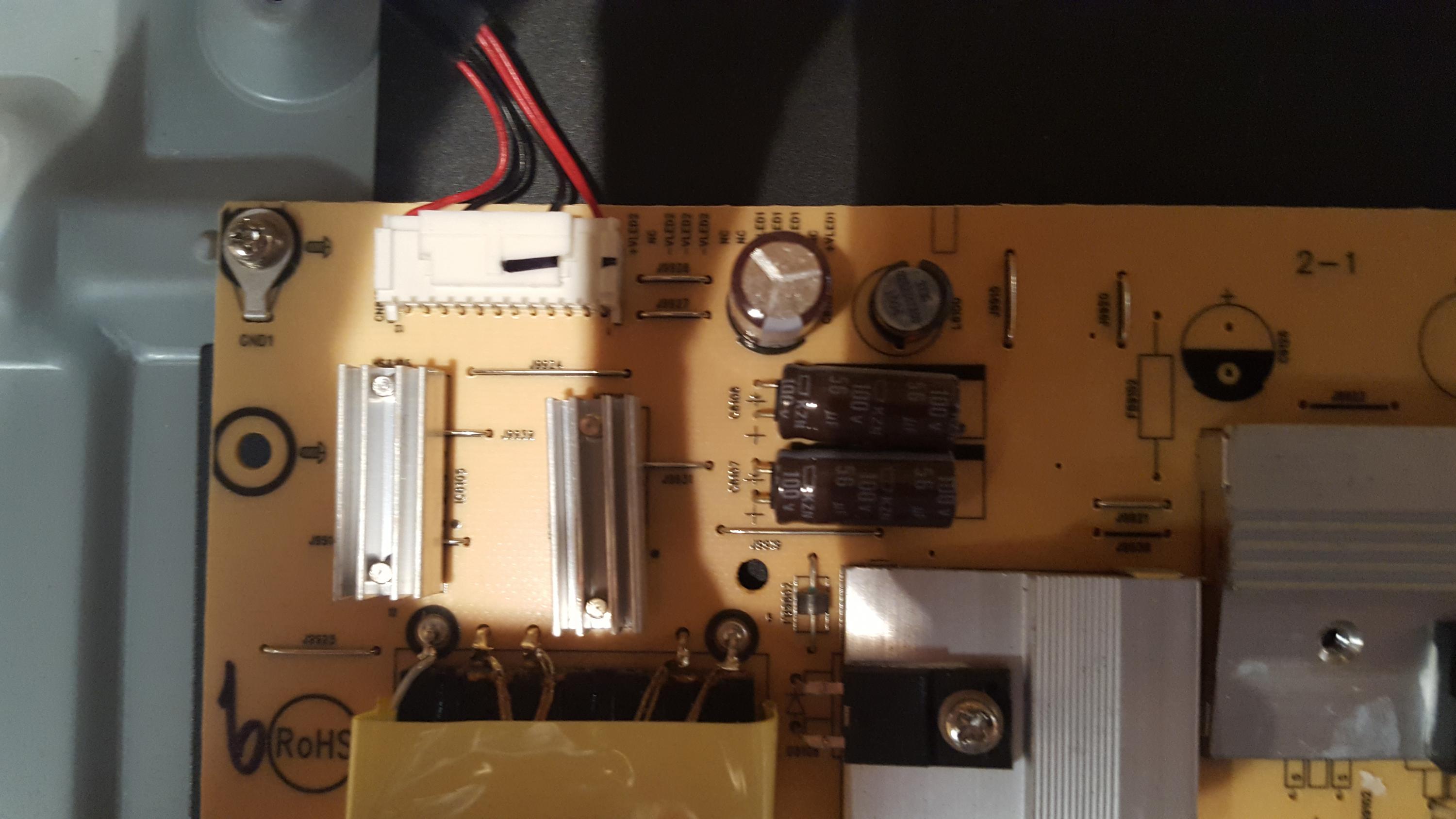

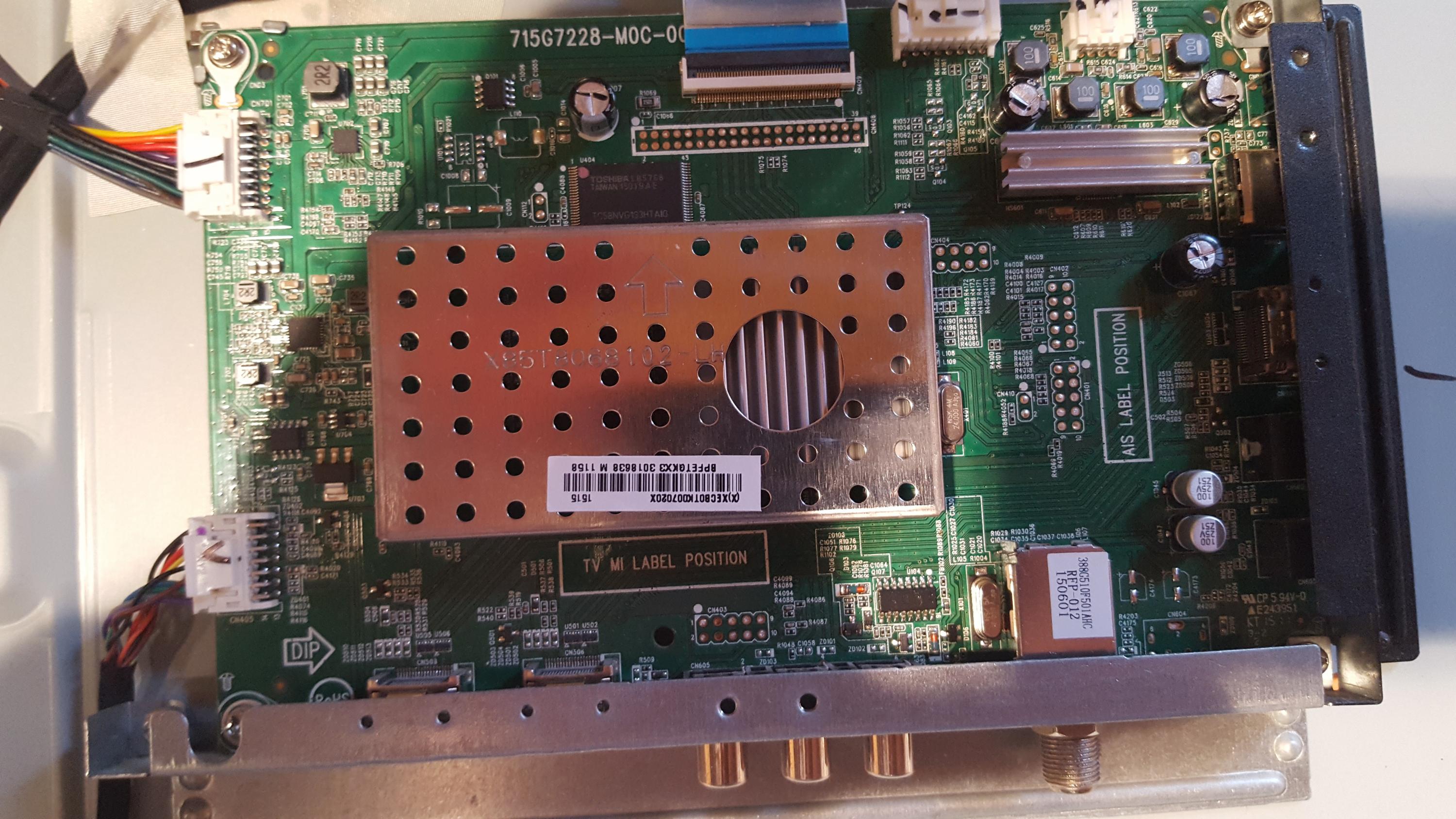

    this is a new one on me, looks like the backlights are leds. i have sound and the startup menu but no backlights. power led flashes 7 times and set comes on. my next post will be of pics, easier for me to serch and type with computer insted of my phone which i take pics of

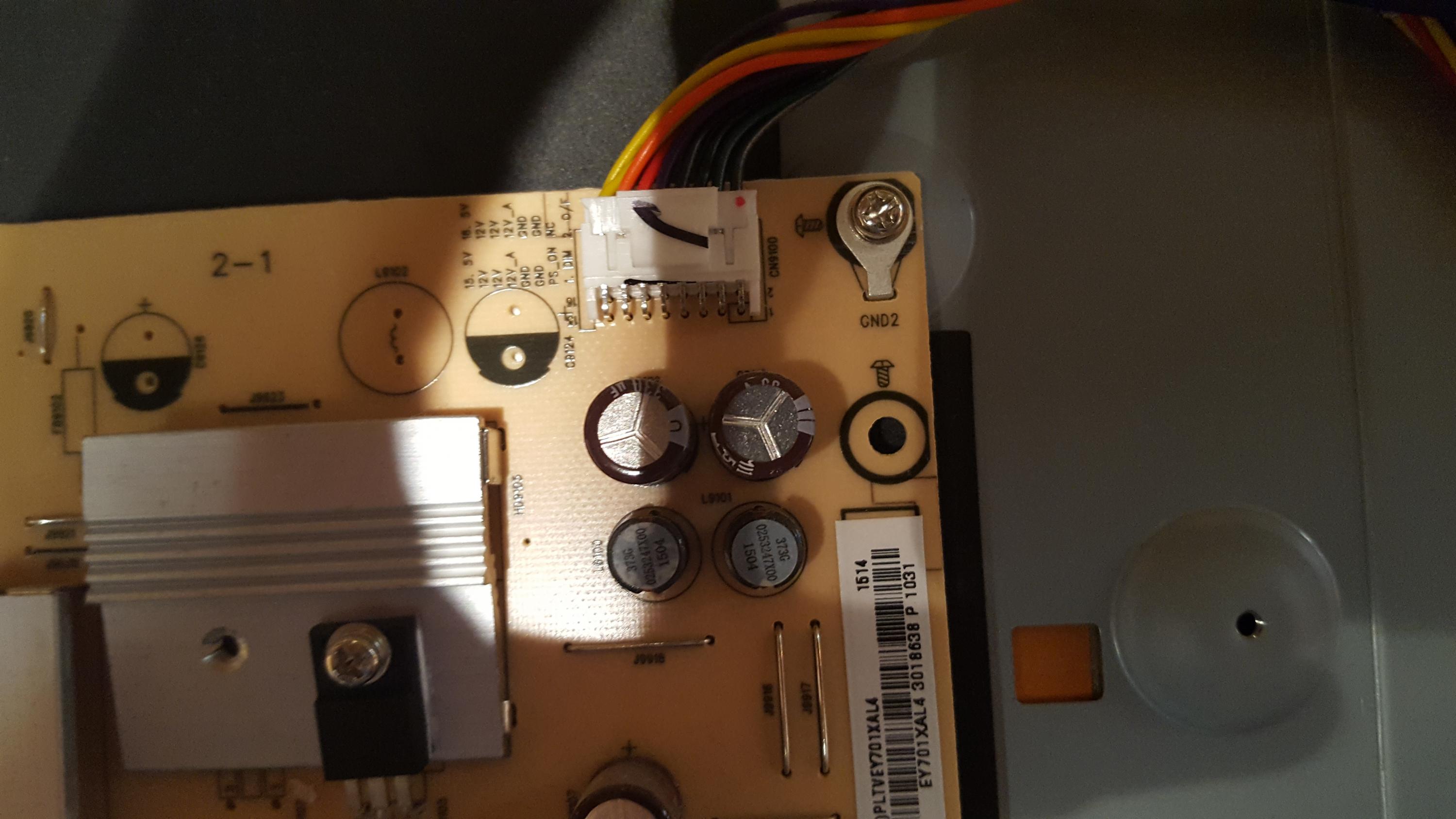

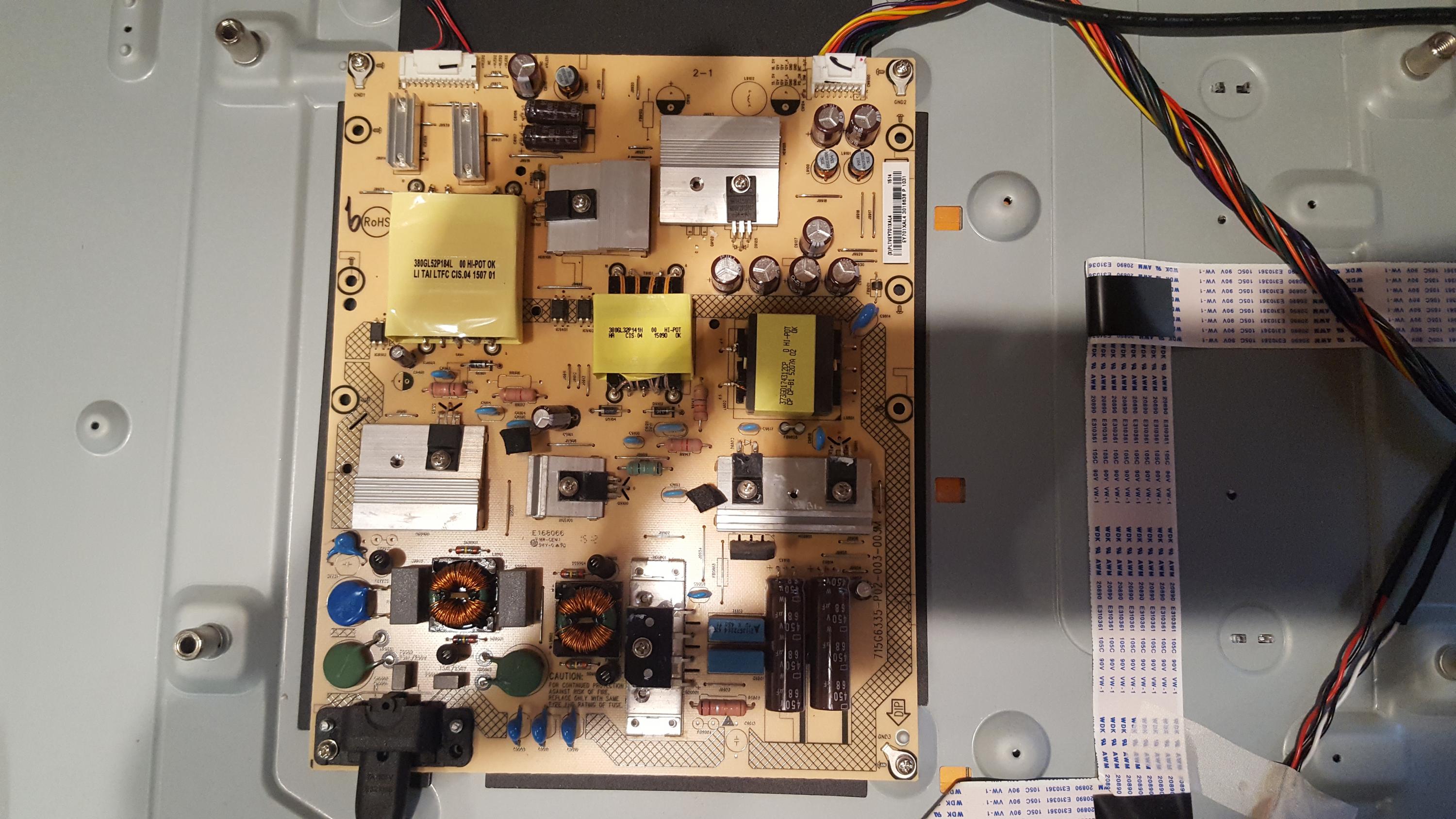

            Re: sharp 50-lb371u no backlights
            Can you post clear and sharp pictures of your power supply and what voltages you have at the connectors including the pin names all which would prove helpful.
              Here are some pics
              • robert phelps
                • Dec 2016
                • 94
                • usa
                On the psu I have 64.8 volts on the red lines that goes into back of panel. The yellow should be 15.5 volts but don't have it. Other volts are there

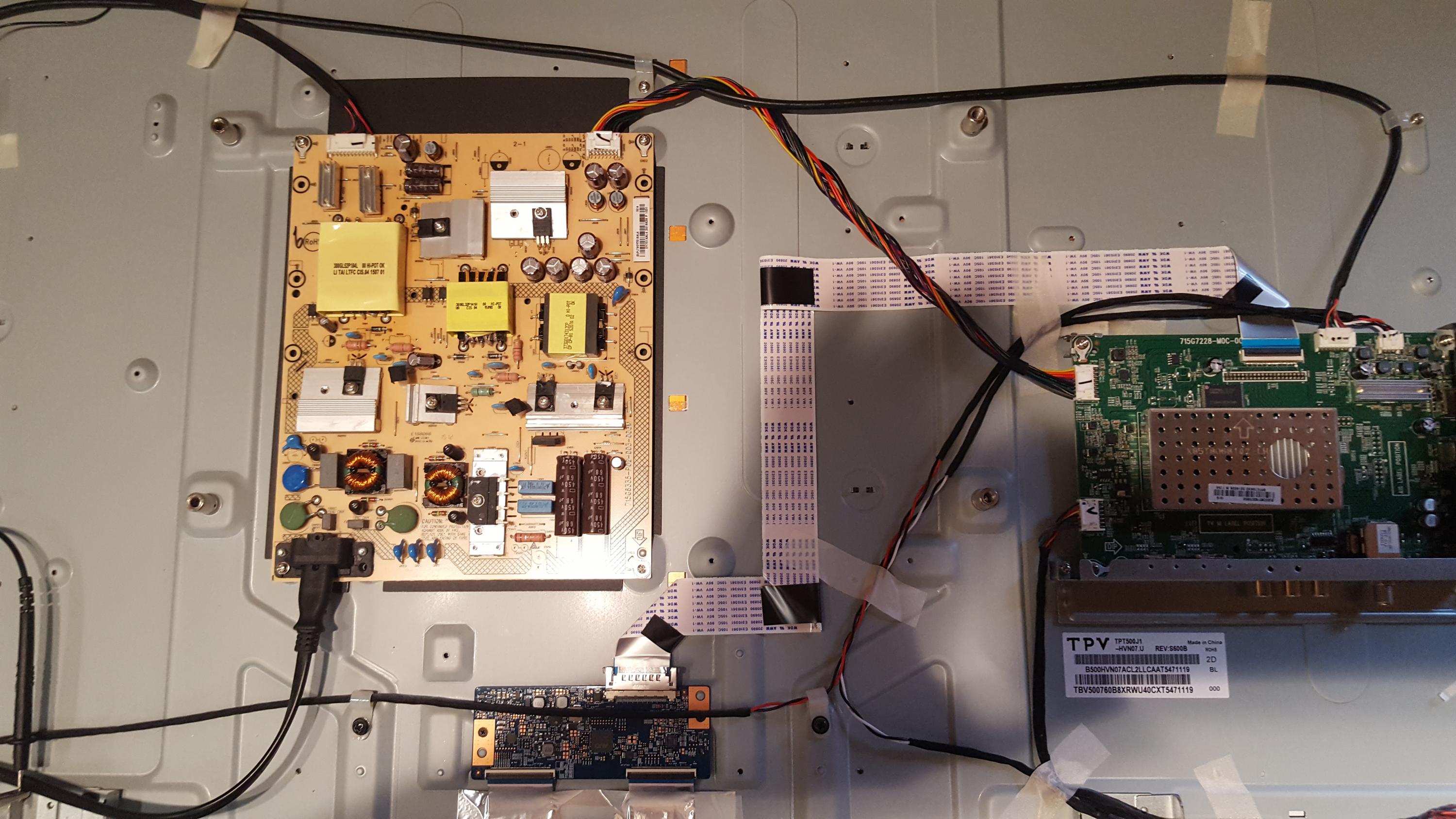

                  1. Measure the voltages on the 2 LED+ pins. If the voltage goes high and then settle off to 50% -75% of high voltage measured then we can think the Power is OK.
                  2. Measure LED- pins, they should measure 4V-10V. If they are 0V, we can say the LEDs are 'open' and need to be replaced.
                  If the LED-pins are high approx. 30V, this would indicate an open Driver on the PSU. Take a 100ohm resistor and place one end on chassis ground and the other end on the high LED- pin. When the power is applied if the LEDs turn on, then you have confirmed a bad Driver on the PSU.
                    If the 15.5V is missing I would be looking to see why. Can you check underneath of the power supply pcb to see if those pins are in use. A photo of the underneath would be useful.
                    Edit
                    Looking at you power supply pcb it looks like the 15.5V is not supplied on this board. There are several components not included on the board (alongside the connector) which I feel would be connected to provide the missing 15.5V line.
                    So it looks like Andrew F. Ali comments to concentrate on the leds is the correct step to take.

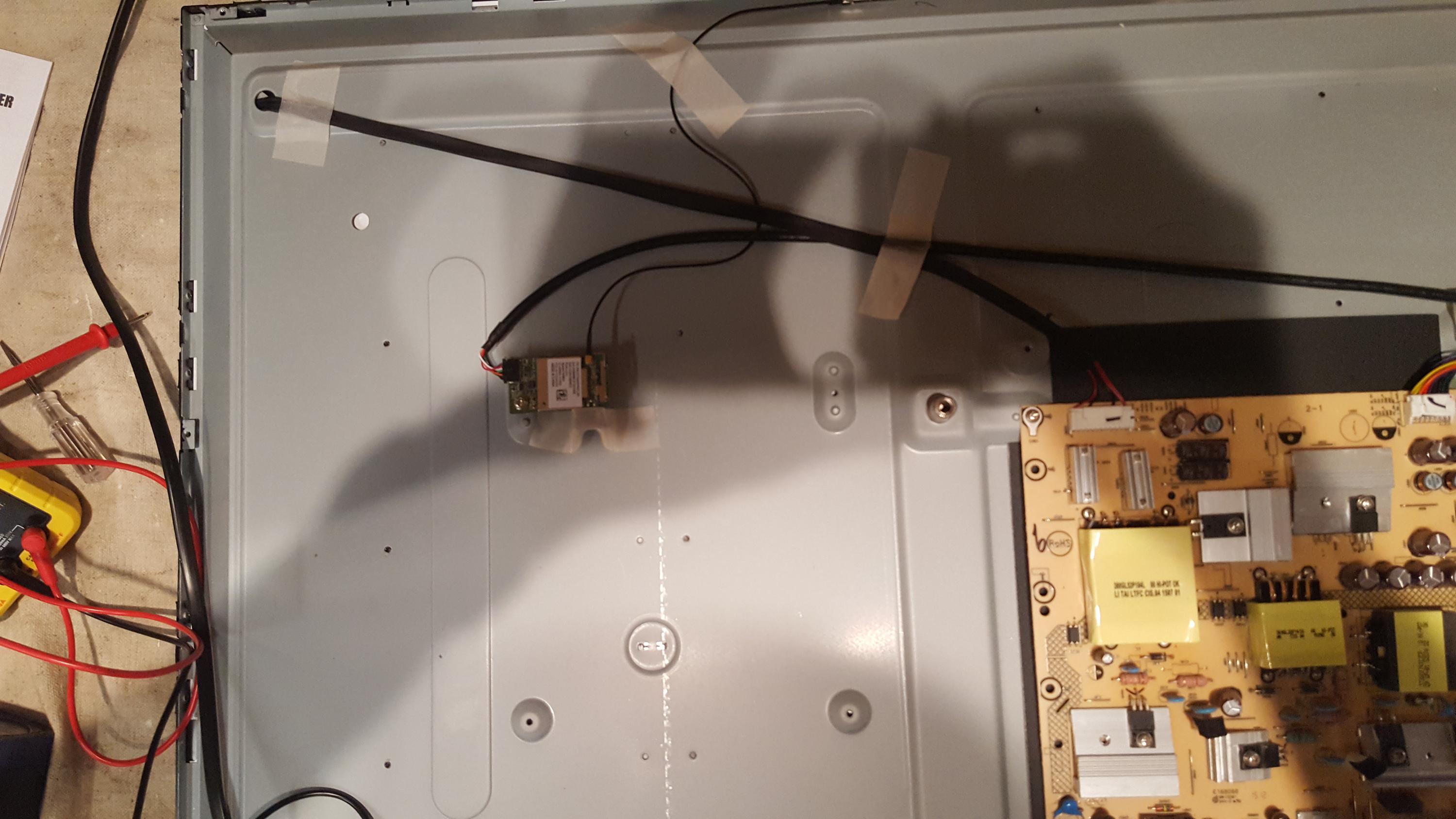

                      ok will try check back in a while thanks
                      • robert phelps
                        • Dec 2016
                        • 94
                        • usa
                        ok here what i got my red leads when power on are 64.8 volts then go to 95.8 volts then back to 64.8 volts both red leads led1 and led2 i guesss. the black leads are .04 volts not 4to 10 so are the leds backlights bad and is there a way i check them before pulling the whole set apart.

                              • Wales
                              What voltages do you have on pin 2 of CN9100 when you switch the set out of standby. Also I can't quite make out what it says alongside it ?
                                pin 2 is labeled o/f and its 3.3 volts when powered on
