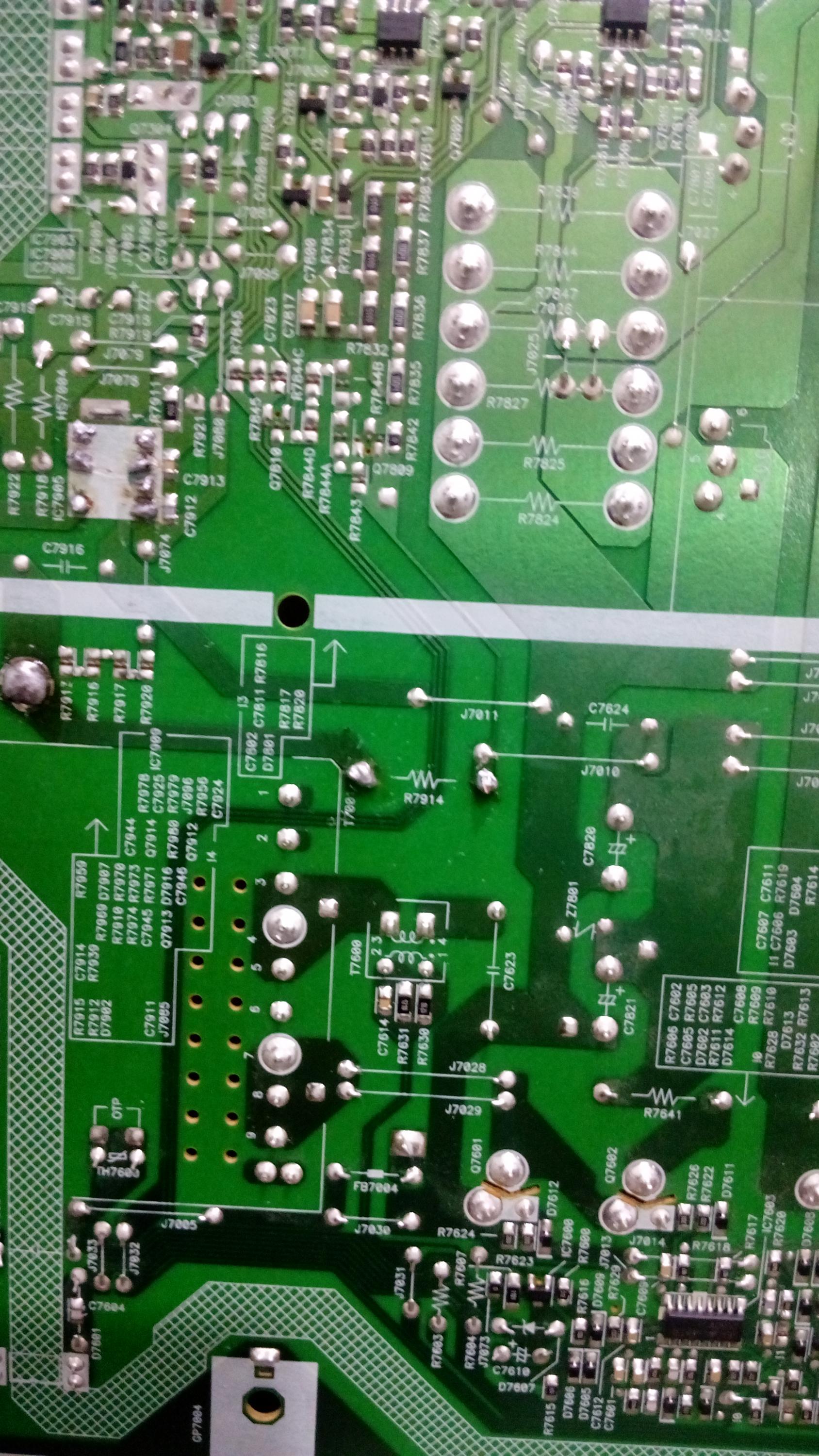

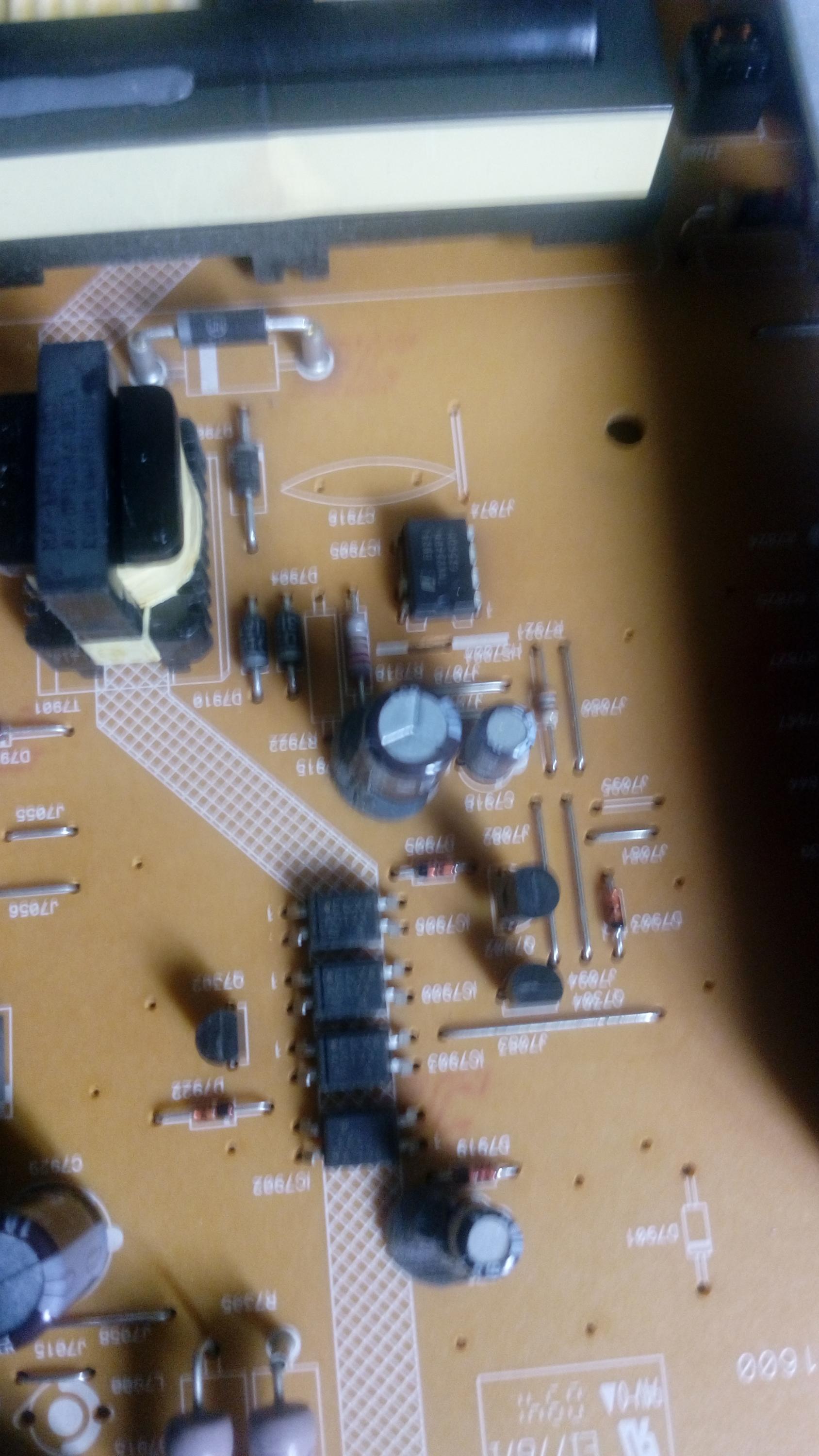

    I have Sharp LC-46A77M power supply model no: DPS-286AP-1.
    After on from wall plug I header something pops, and the power went off with no sign of front power line.

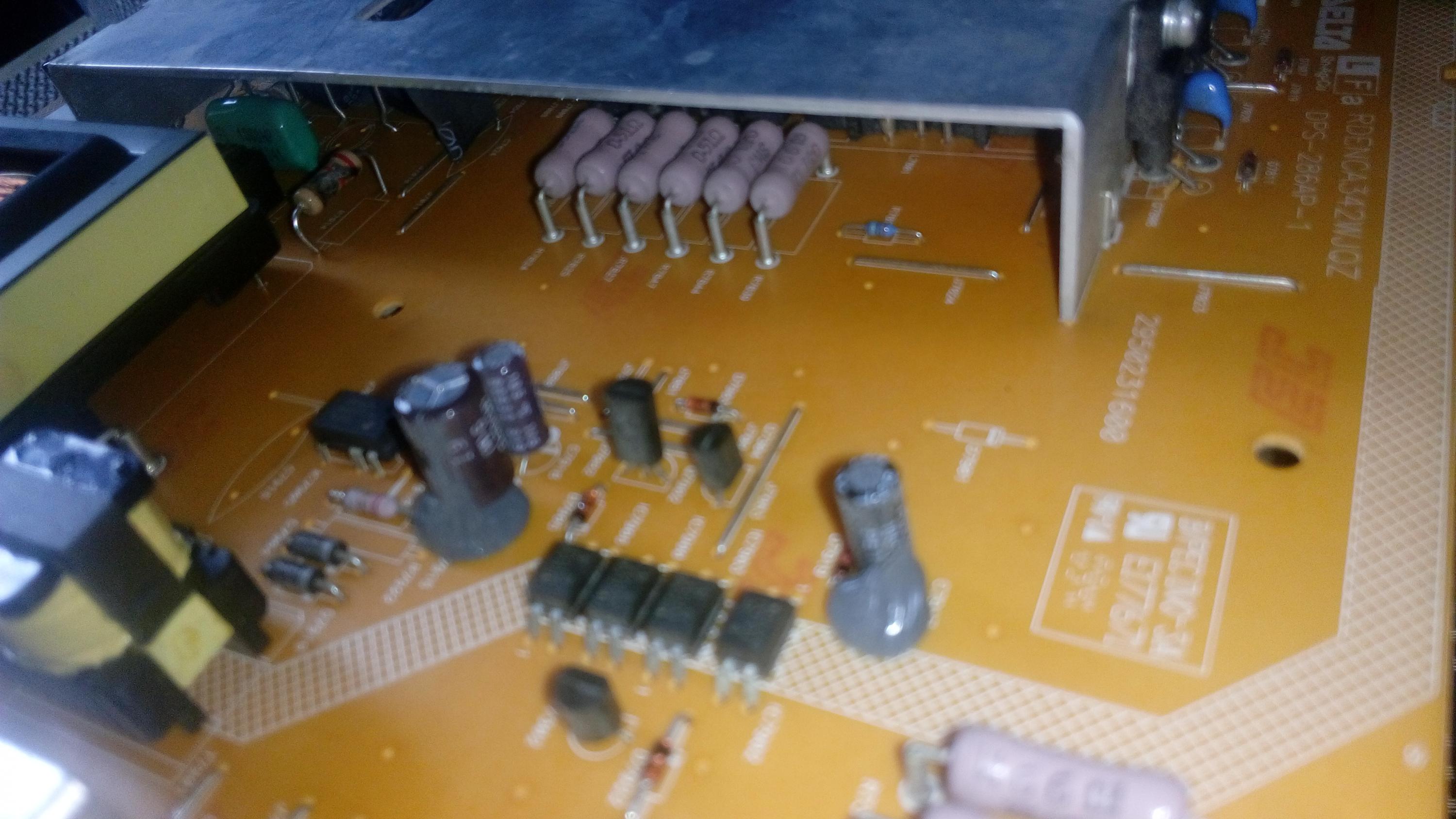

    I open the back cover to check if any thing that blow like the IC or any other fused and resistors, but I couldn't find any physical signs of damage, also I check if any DC voltage like the 5V at PD11 also the reading was 0v, I take the power board out for further inspection and I find that R7914 open, also I check if there any capacitor pop up but all looks ok, so I change the resistor R7914 with resistor 2.2ohm 1W.
    After I on the power the resistor blow right away as you can see in attach photo.

    Need to check D7908 and D7909. Shopjimmy has a kit that may fix problem. Looks like it will fix your problem

        Repair kit states the following so you would need to check the components on your board
        Totally dead TV, missing +5V standby on the power supply board; resistor R7914 (to the left of the large transformer TH7600) open.
        Kit contents
        Replacement components for IC7905, R7914, R7918 and D7908.
        All components in the kit are brand new. They may be slightly different from the ones on the board, but they are guaranteed functional replacements or improvements over the OEM parts.

            It's a TNY264PN
            Quickest way to check it, is to replace it.

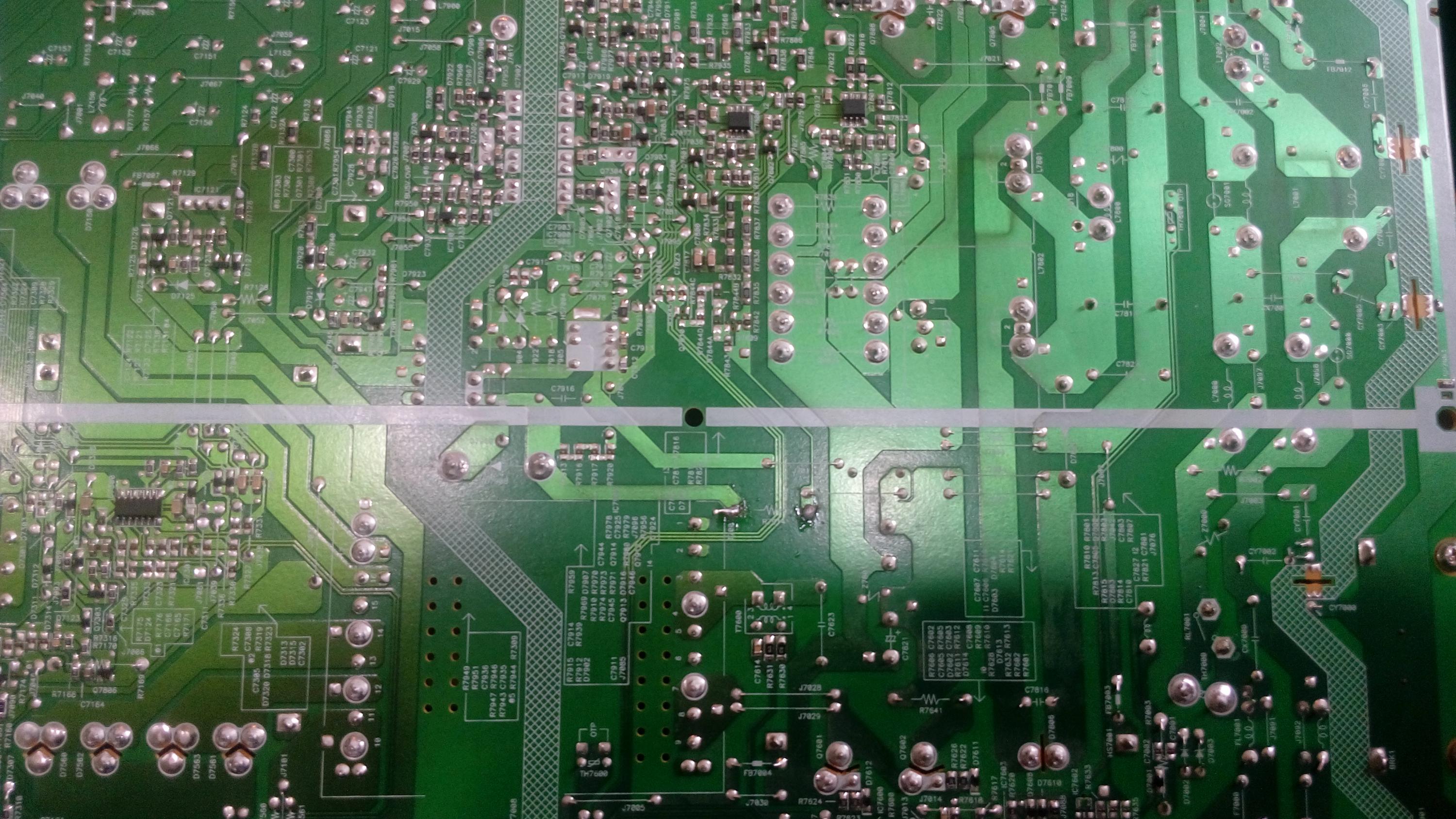

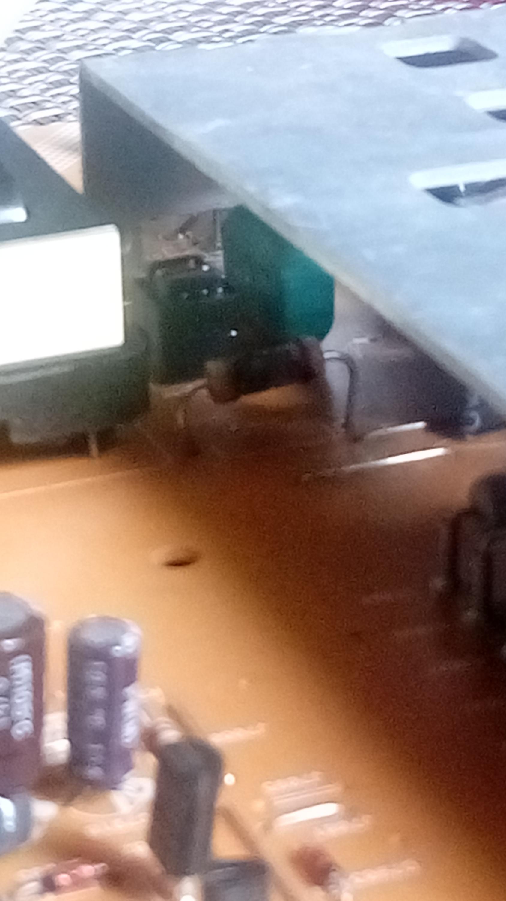

                          I do change the IC TNY264 and the resistor R7914 and every thing is ok now
                          Thank you every one and many thanks to budm as well who was try to help me in other reply.
                          the attachments for the tv with the board and i hope it will helps others.
                          Sorry for poor soldering
                            Re: SHARP LC-46A77M No power ON
                            You need a higher wattage soldering iron for greater heat and some fresh solder which would tidy up the solder joints. Glad it working.
