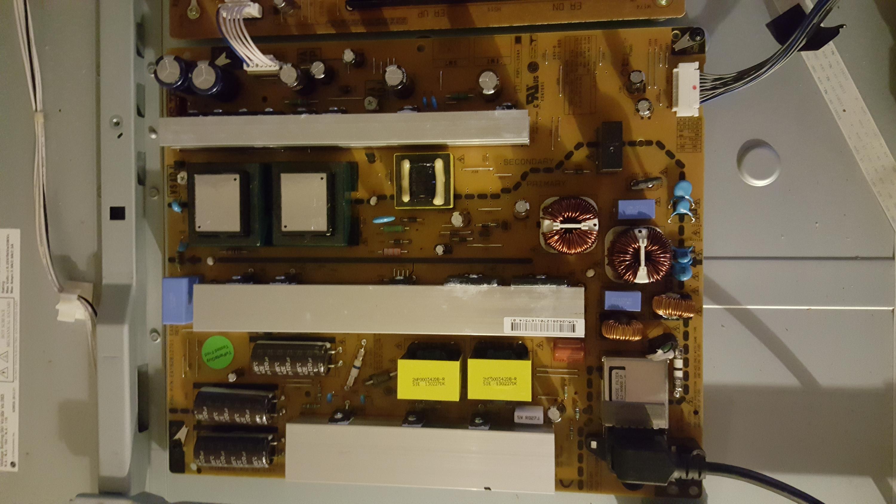

    Have a 60pn6500 sound no audio
    VA 61
    Vs 221
    Vsc 167
    Vsb 121
    Jumper test pattern still just sound
    Ideas where to test further

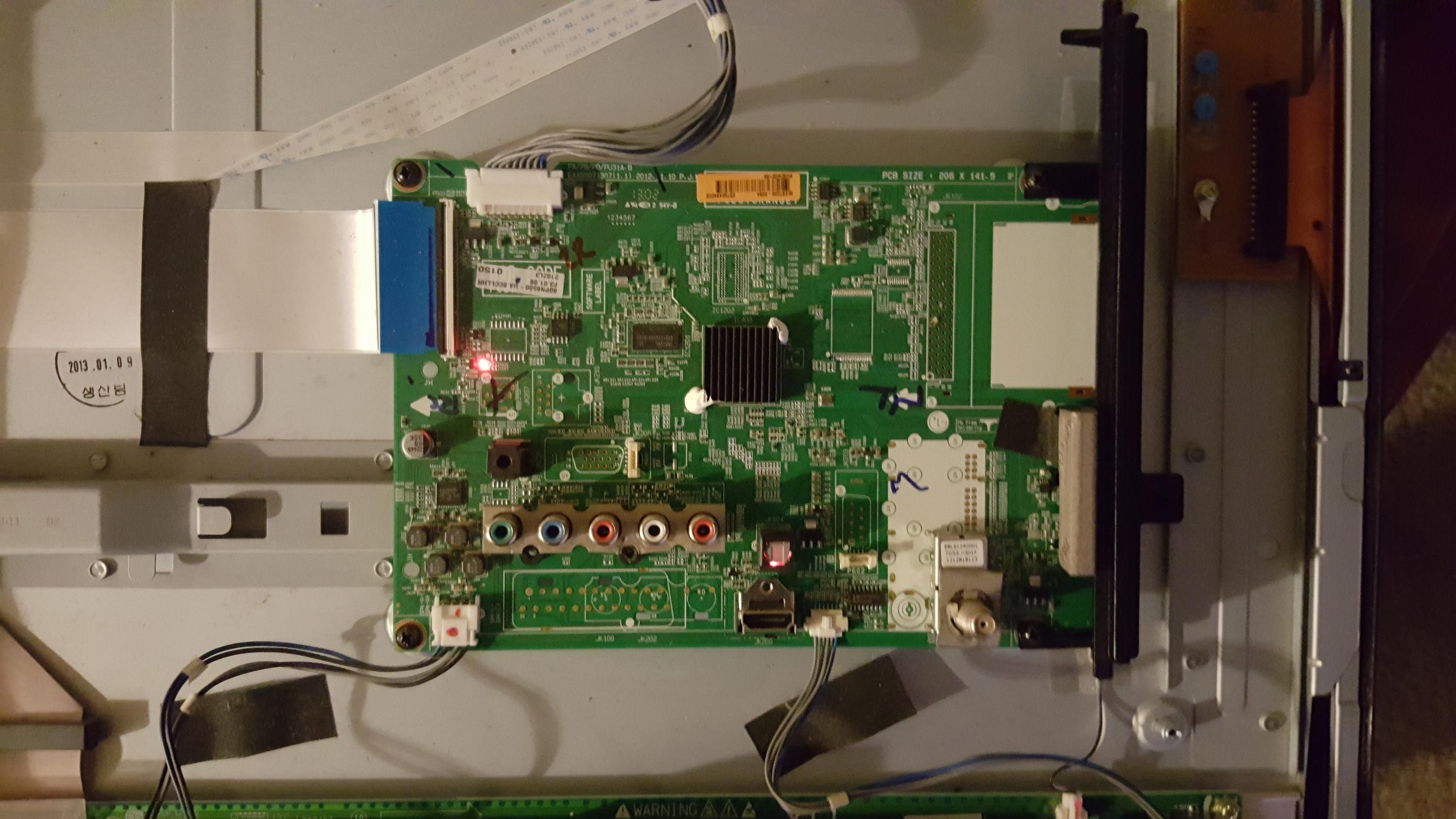

    Re: LG 60pn6500 sound no video
    Here the pics

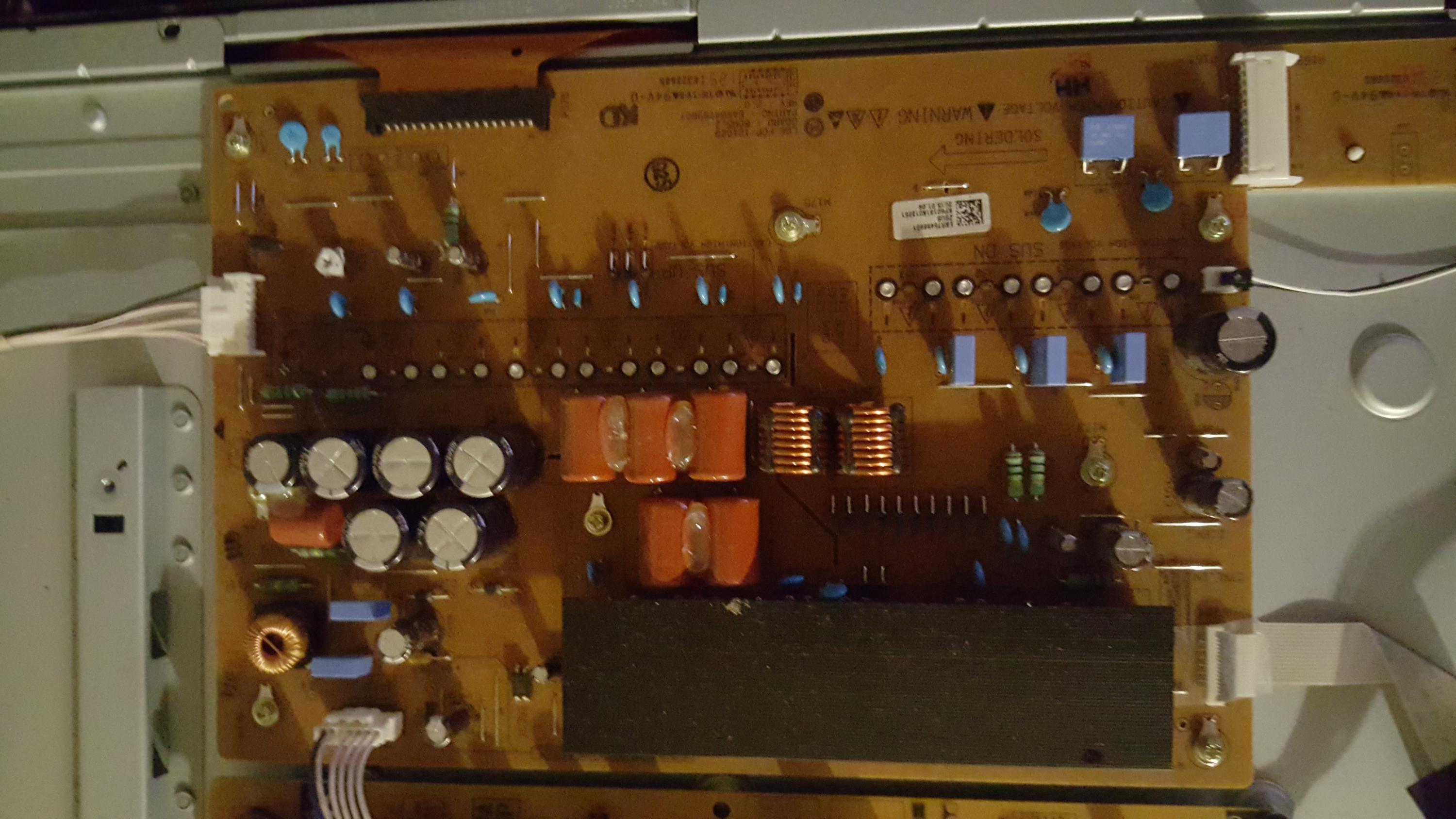

        Found the VA fuse on zsus is blown it's a 125v 4amp not a glass fuse. I put in 125v 2amp glass to try it just blew right away. Haven't found any shorts on zsus yet any ideas?
          Is the voltage from psu to high? Label says max 56v va I get 61 wouldn't think 5volt kill it . Another thing on zsus from ground to top of that 250v cap by fs2 fuse it shows reading oh 91v. Bad cap?

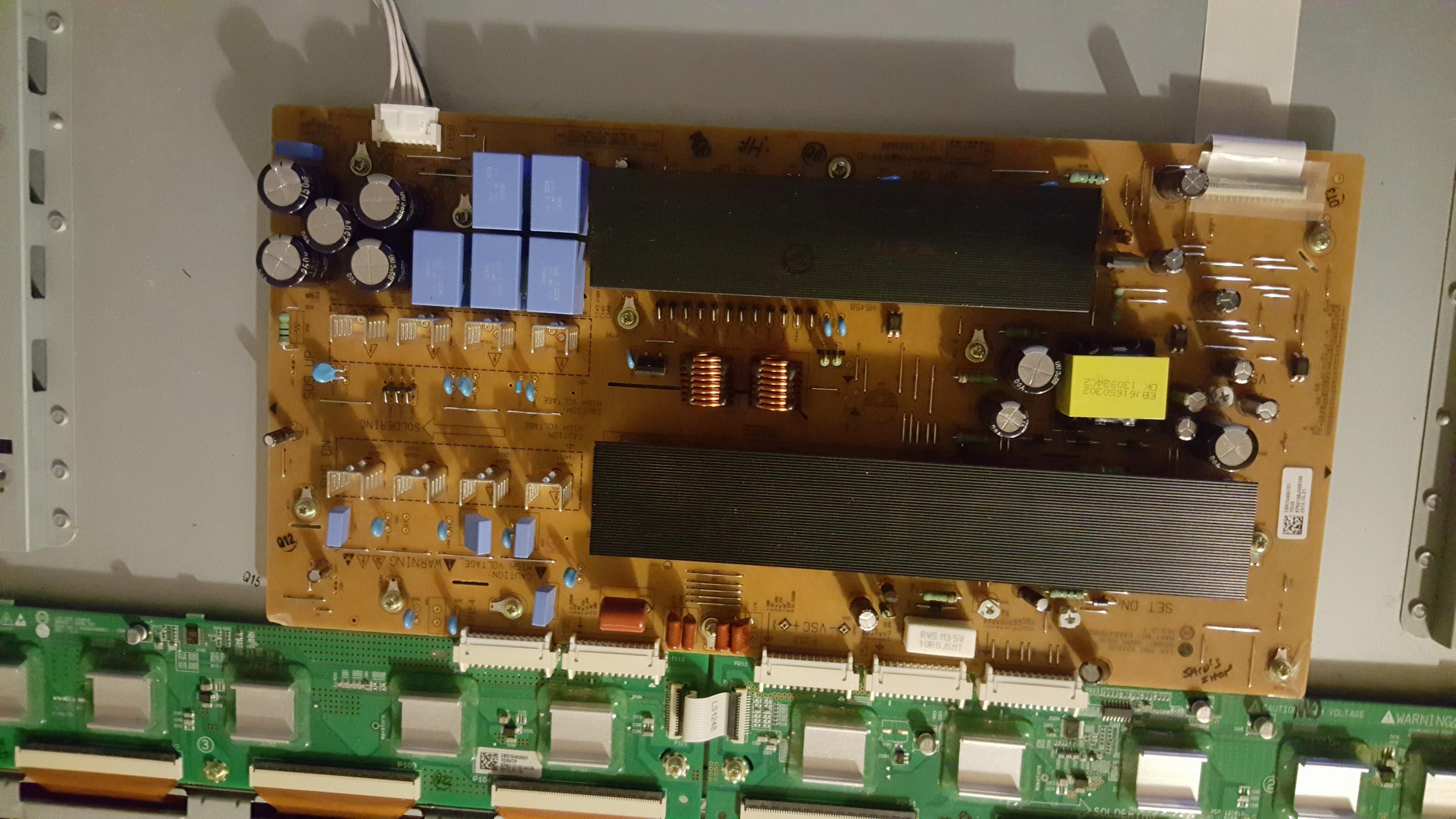

            How would I test the buffer boards for shorts do I need worry about boards along bottom

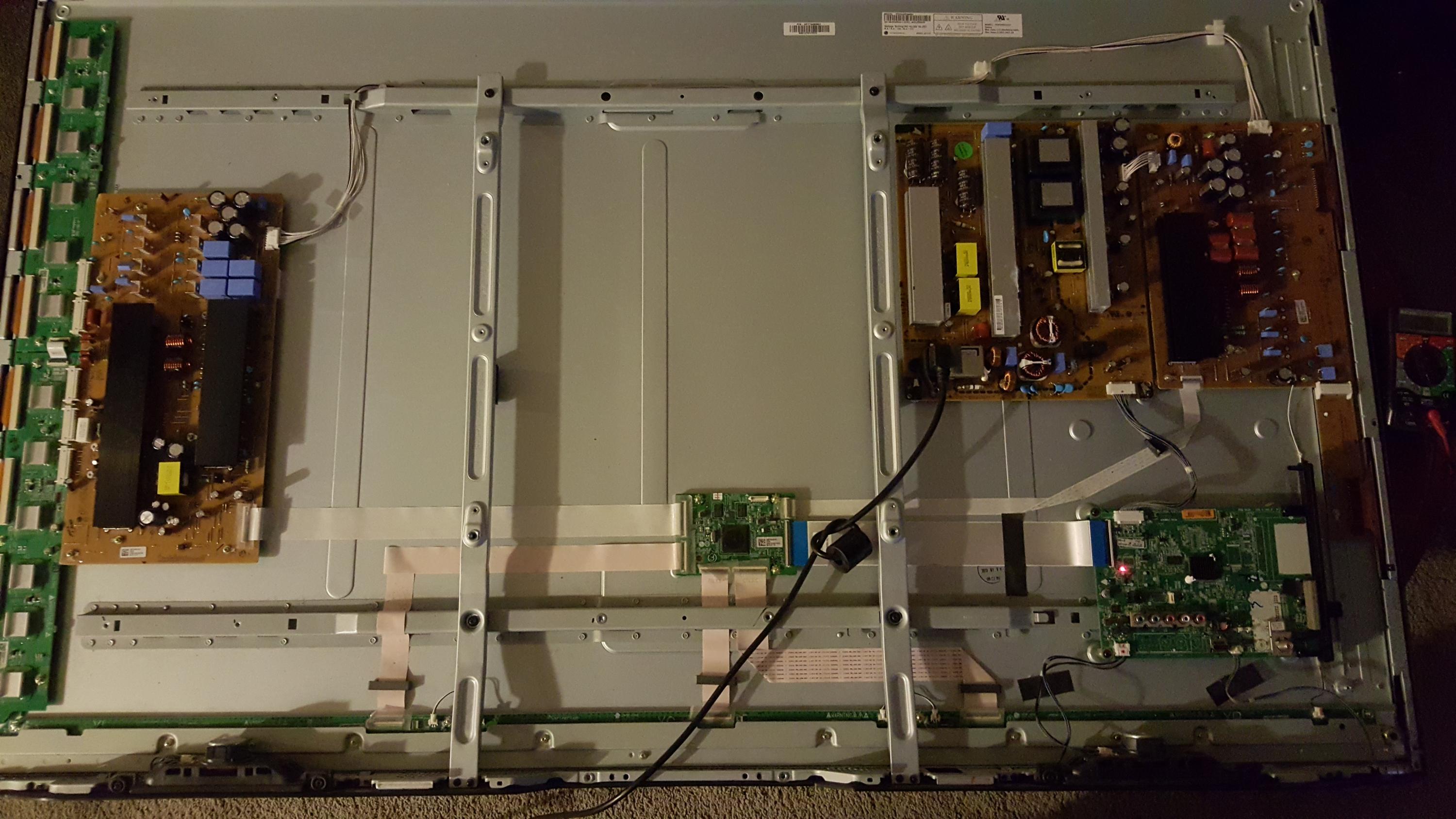

              Swamped all boards tv power up screen lit up then dim sound no picture va fuse blown on zsus . I tested connector to x boards it shows closed . Disconnect all ribbons to panel from x boards and tests open .turn tv on with xboards ribbons to panel disconnected screen shows snow. Panel shot?

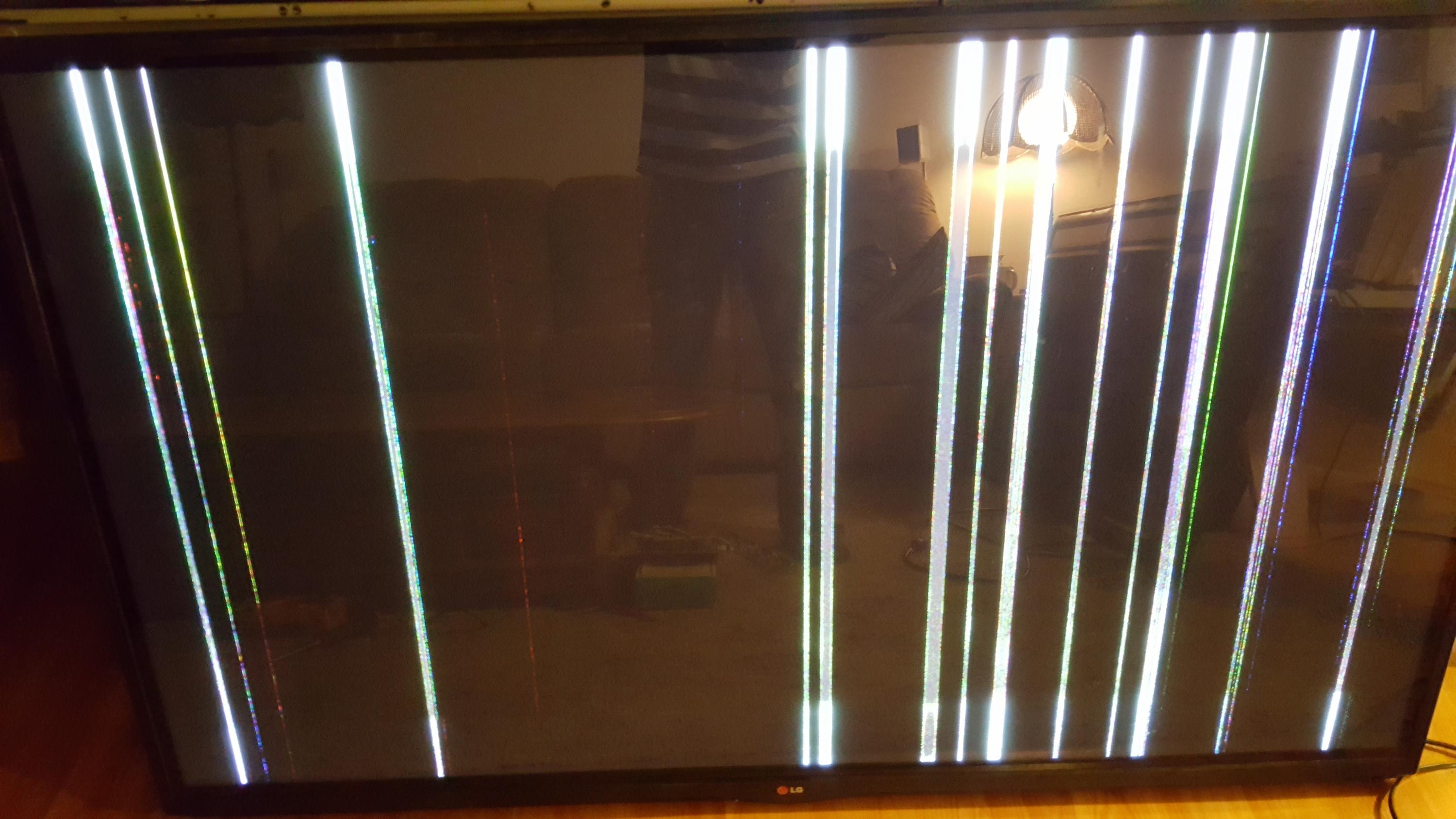

                This bad panel
                  Thats weird, also yeah Id say panel is shot as the lines are single and grouped. Maybe the address boards took a hit when the ZSUS shorted out.
                    I swap them as well when not hooked to panel ribbons showed open ground to va connector. Soon as attached to panel shows short. Guess panel shorted . Wierd stays on
