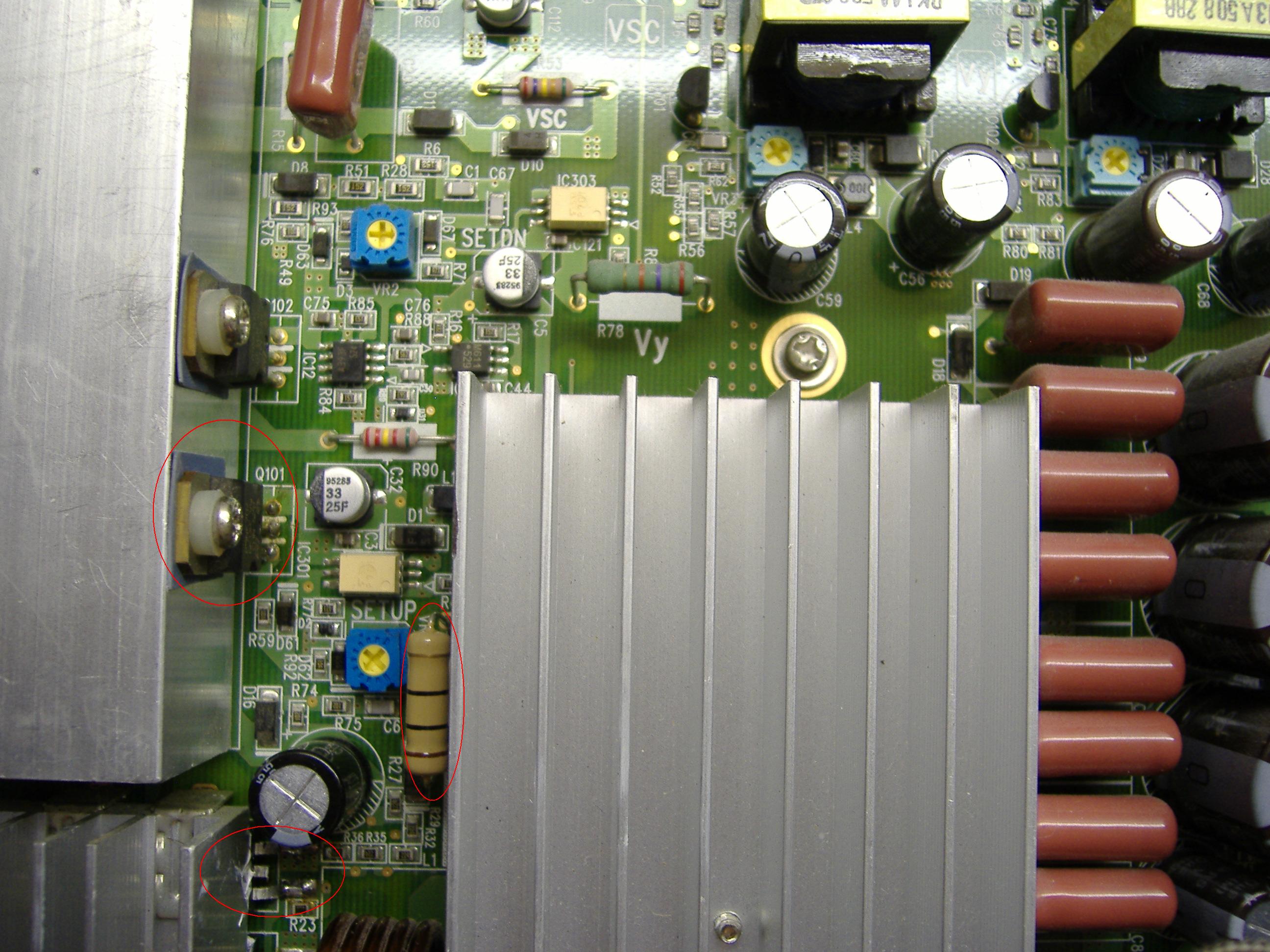

    Hi Guys, this Sony plasma came in not switching on. Red led on, and no relay action. (refer to photos)
    Whilst checking for Short circuits, I noticed R4 looked a bit cooked, and it measured open circuit.
    Two components that connected to it were short circuit.

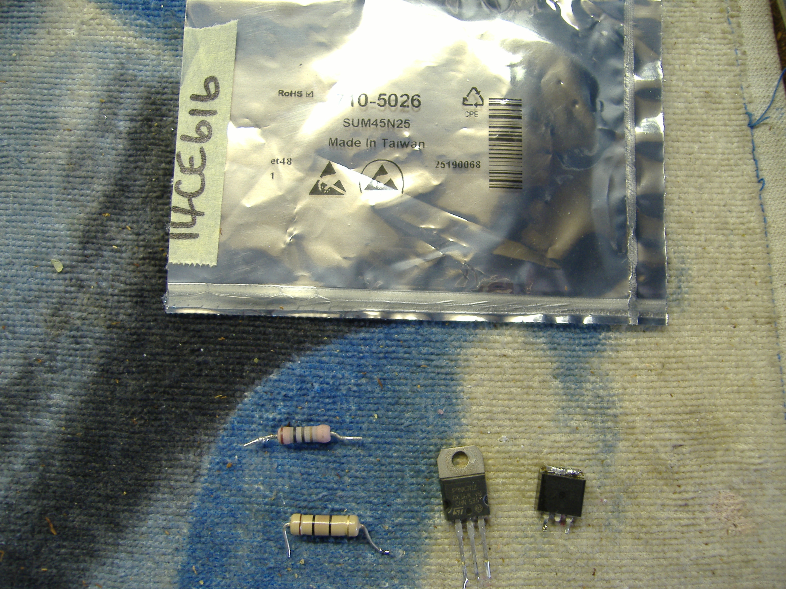

    Q101 (P7NK70Z) I replaced from an old pcb.
    Q16 (SUM45N25) I replaced with a new one.
    R4 was a PROBLEM IDENTIFYING, I replaced with a 10 ohm?
    Set has run for over two hrs, and still running.
    Vs measures 185v (label says 184). not altered.
    Va measures 44v (label says 45v) not altered.
    -Vy measures -75v (label says -75v) not altered.
    Now the " oh shit I'm stuck" part....
    The manual says the Vsc should be measured on R53, and it should measure 120v.
    DOES THE MANUAL MEAN MEASURE FROM GROUND TO R53 (270k)--120V, or
    ACROSS R53.
    ONE SIDE of R53 I GET -75V ( -VY), THE OTHER SIDE 44V. ACROSS R53 119V.
    120v/ 119v, and the sets still running.

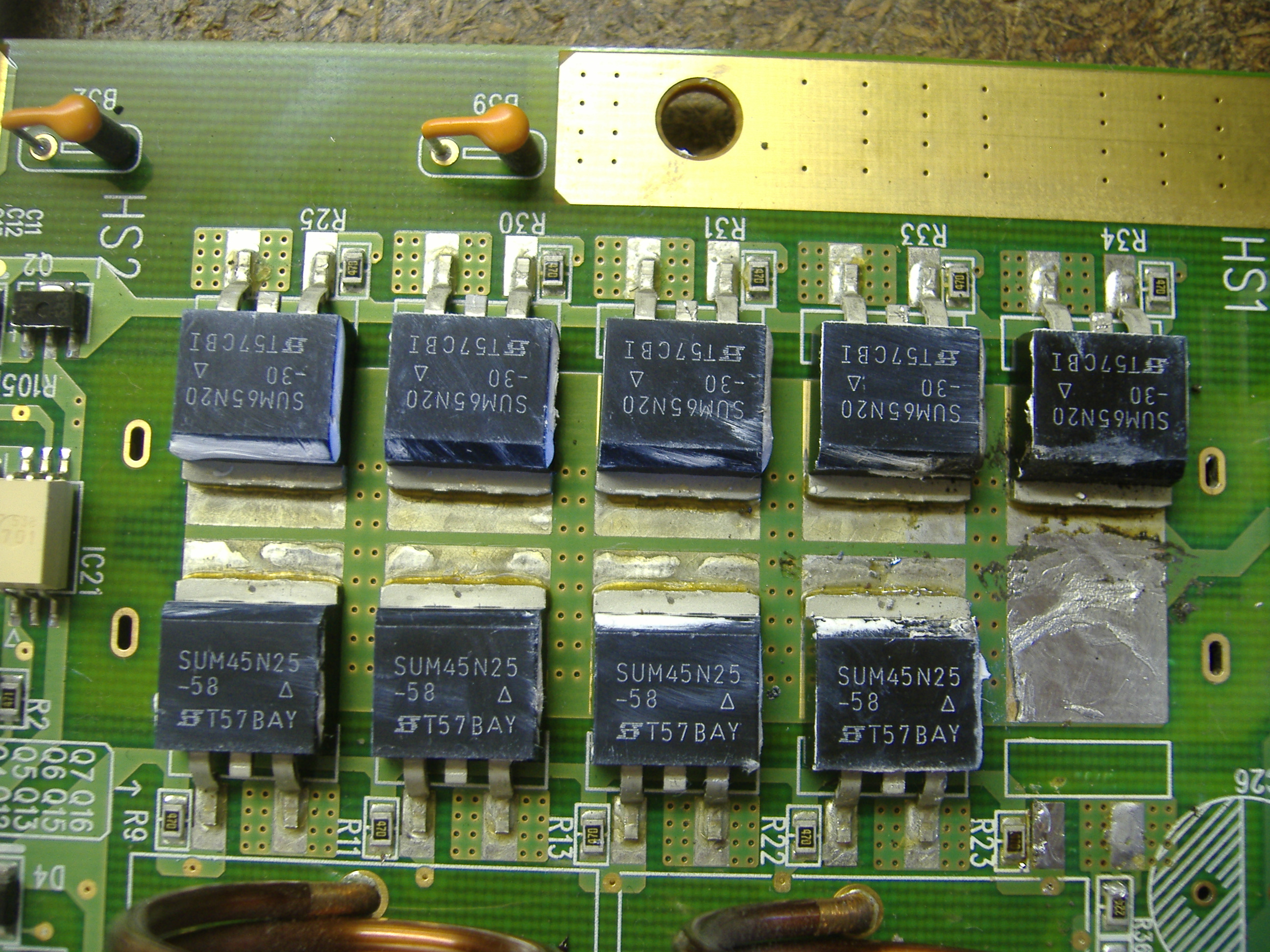

    Is the image poor when its running then ? Also you might of missed something like a burnt gate drive resistor on one of the shorted fets.

      Hi Reecey, The image looks fine. I had run the set for 20 mins on initial repair, and nothing seemed to get too hot either?
      So I should be measuring between ground and R53? Not across.
      When there is more than one component of the the same specs on a pcb, I usually compare readings to make sure that there aren't any drastic differences in measurement, which I'm sure I did with these 8 FET's.

        Yes Reecey, on re-looking at the photo of the Fets, I see the the one gate drive resistor looks a bit blackened.

          VSC is measured across resistor(R53) on these LG Y Sus boards and would be correct at 119-120v
            phew! Thanks Flocko. Was putting off opening this set again. (lots of things to undo to get the Ysus out.
            Really chuffed. Thanks a million!
