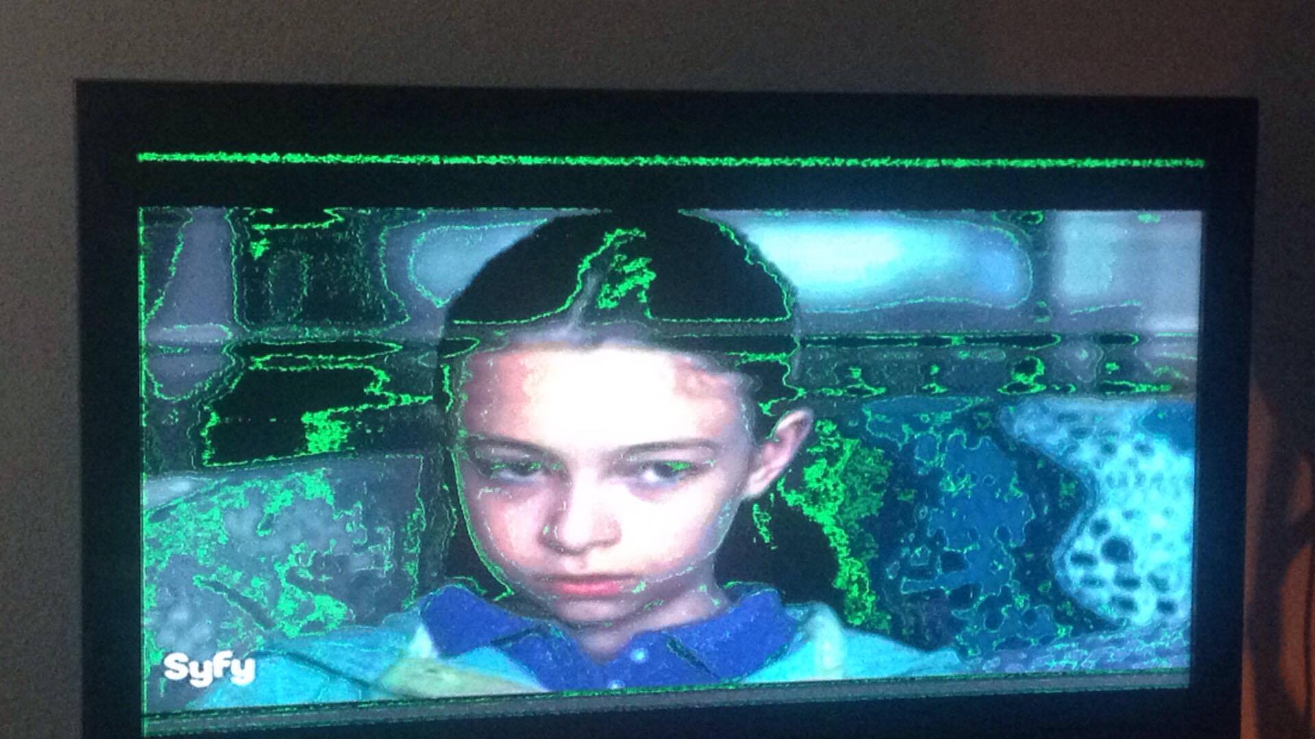

    Does this look like a flaky AS15/T-Con? It happened one time for about 15 seconds and has not happened since in the last few days.

    I had the same thing on a 52" philips lcd. I changed the t con but no luck. It was the mainboard.

      I'd would clean all the ribbon cables between main board, Tcon and panel and see if that clears it up.

        Will do! Thanks!
