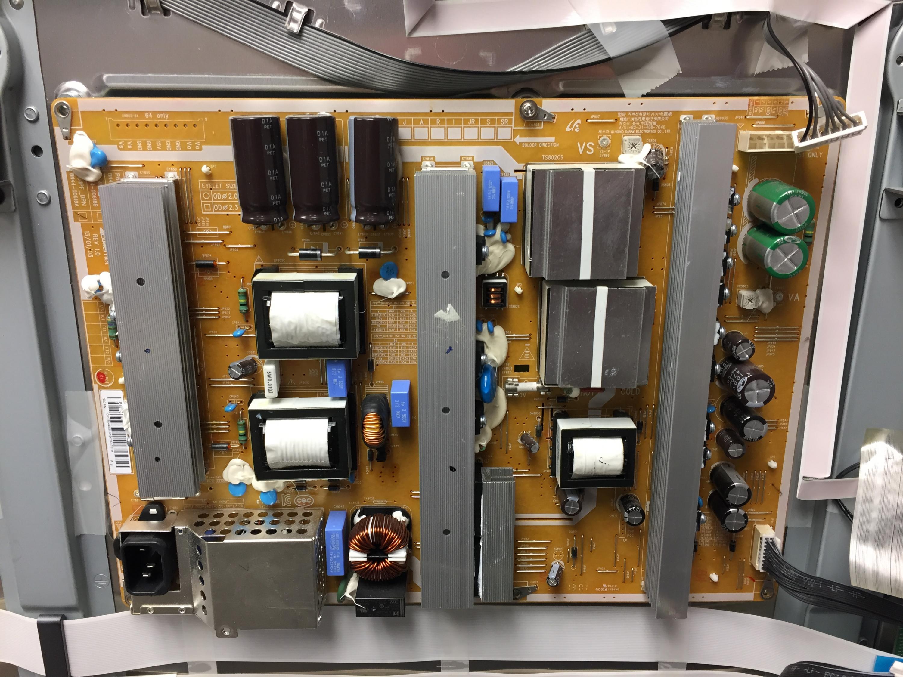

    I acquired a pn51f8500AF from a local guy. He had troubles with it and sent it out to have the Power supply fixed. put the power supply in and still didn't work so he cut his losses and gave it to me.
    First I have disconnected everything from the mainboard and power supply and just connected the power supply to the mainboard. It still just clicks over and over about 1 second apart. All the voltages (even standby) are going down to 0v and then flicking on for a brief second. (all low voltages (5s and 15s) come up for a momentary second, but drop quickly back to 0).
    If I disconnect the mainboard and force the PS on (ps_on to ground), it comes on and all voltages look normal. I can even force VS_on and the Vs and Va look good.
    Back to when the PS and mainboard are connected:
    The mainboard light flashes when the power briefly turns on. What concerns me is that standby voltage drops to ground. This makes me think there may be a short in the mainboard causing the power supply to reset or something.
    When forcing PS_on with a jumper and still connected to the mainboard, the power supply still shuts off, so it's not that the mainboard is switching PS_on.
    So at this point, I think perhaps mainboard. But my knowledge of power supplies is not very good and this one is known to be trouble. Could be one of those ghost loose solder joints that shows proper voltage under no load (mainboard disconnected) but with the load of the mainboard it drops down and causes a reset? Could be still a bad PS if perhaps a cap or something else is dead and even the slightest load on it causes it to shut off. I tried putting a 600 ohm resistor across every voltage output to the mainboard (the 5's and 15's). It powered the resistor to 3/4-1watt without trouble.
    Only thing I could think of to do next is to try and remove pins from the plug and see if I could measure current draw on each supply voltage to the mainboard. Perhaps see if one is shorting out. Then look for shorts on the mainboard? bad voltage regulators? or keep eye out on ebay for replacement mainboard.
    Thanks so much anyone who can give me some tips on this!

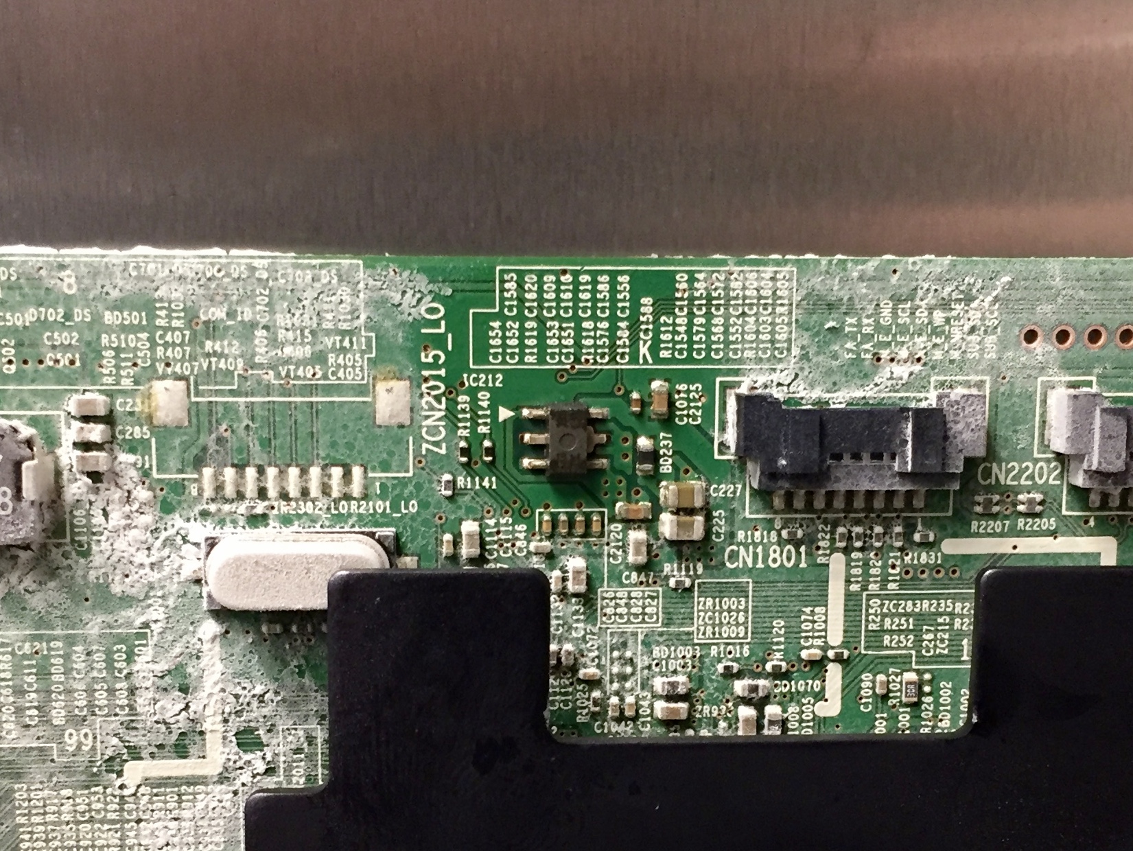

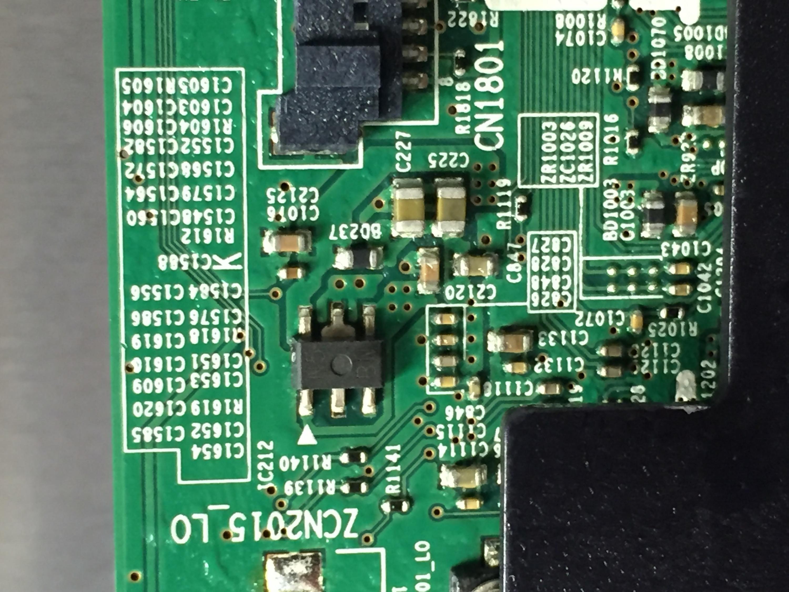

            Well, I powered all the 5V lines. Is there a reason not to test the 15v Lines as well?

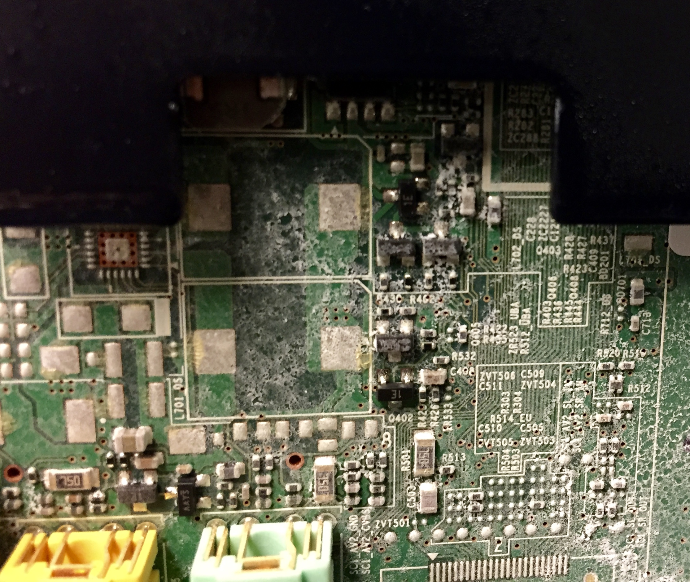

            What I did was use a phone charger type thing which was about 1amp max. Hooked up it drew about .75Amps and dropped the voltage to around 4.7v.
            Attached are pictures of the components to heat up first.
            The marking is: N5 over BN.
            From looking through mouser, I figured it's this SMD package: SOT-89-5
            Anyone know how to identify it further? Perhaps try and source the Samsung service manual? I can probe the pins, but need to figure out the layout to know if it's a correct voltage or not.
            There were also 2 small transistors I believe near the bottom that heated up fairly quickly as well. Marked "31" which i think is a NPN transistor. I will have to measure those shortly to see if either is shorted.

              Sigh. 1 step forward, 2 steps back. I didn't realize in my connections I had mixed up my left and rights on one of the pins for 5v. So during my first test i was sending 5v down a line that required 15v. That didn't harm anything, but I then put test probes into the back of the plug for the 15v connections (to keep separate from the 5v in front) and then I applied 15v to the same pin which sent 15v to the entire 5v system.
              So my first test was probably a fail and didn't really check the 5v system since it was perhaps trying to drive a 15v lead as well and I missed applying 5v to a different pin.
              Then when I connected 15v (was lazy and used the PS board) it sparked a bit and definitely blew a very small 16 pin chip...one I will likely not repair.
              It definitely shows up fast as a dead short/heat area on the freeze test. and Board won't light up the LED anymore (in the attempt to startup).
              So looks like i'm on the lookout for a new mainboard. I'll tell myself the other fault I may have found was a bad one anyways :P.

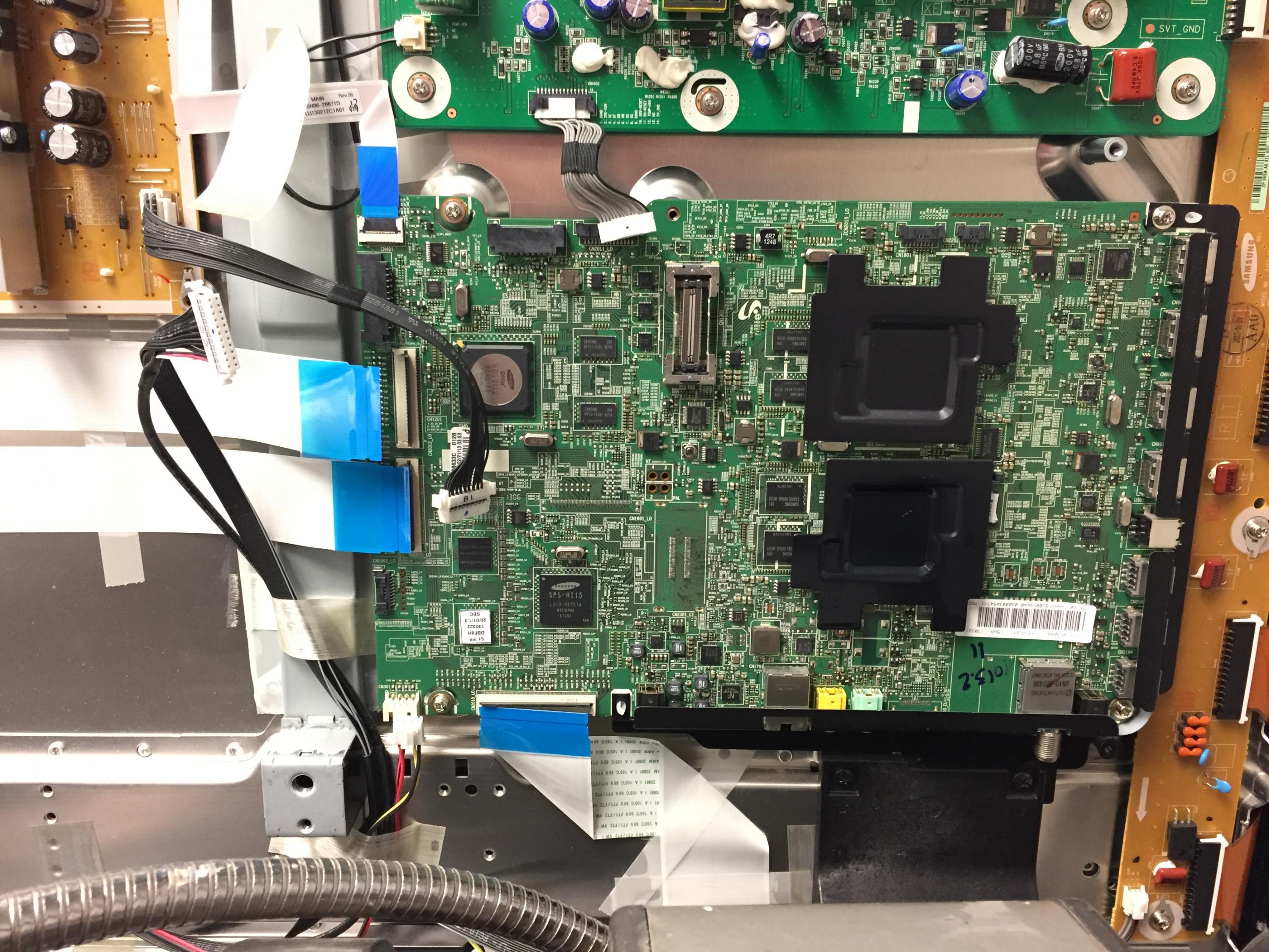

                Update: got a replacement mainboard.
                It responds to the power button, but only clicks on then off. Just a fraction of a second.
                But now when I force PS_On with a jumper, the board will actually power up and flash green led nice and steady (1 second apart). This also brings VS_on from the mainboard, yet I can't get any images to come up, no menu, no input change, no volume, etc. I do see the screen come on black now.
                ALSO! if I force PS_on with the service jumper (pins 3/4 connected) I get all the test screens looking perfect.
                I'm baffled.
                I wondered if a defect in the power supply was causing a really high drain for it to turn on PS_on (a bad mosfet or something overloading the Mainboard Ps_on line). But I measured, and it only takes 2mA to turn on.
                My thought is perhaps that the mainboard works yet its' getting a reset signal (DRV or DS? not sure how these work) or some other fault to turn off. Some sort of power on test that's not completing. I feel it's a step forward as now jumpering PS_on at least doesn't keep reseting/shorting to ground. I notice there are temperature sensor pins coming from the sustain boards, maybe one of those is bad?
                Anyone have any ideas from here? There is always the possibility of this mainboard being bad as well. Could purchase another provided they have a decent return policy.
