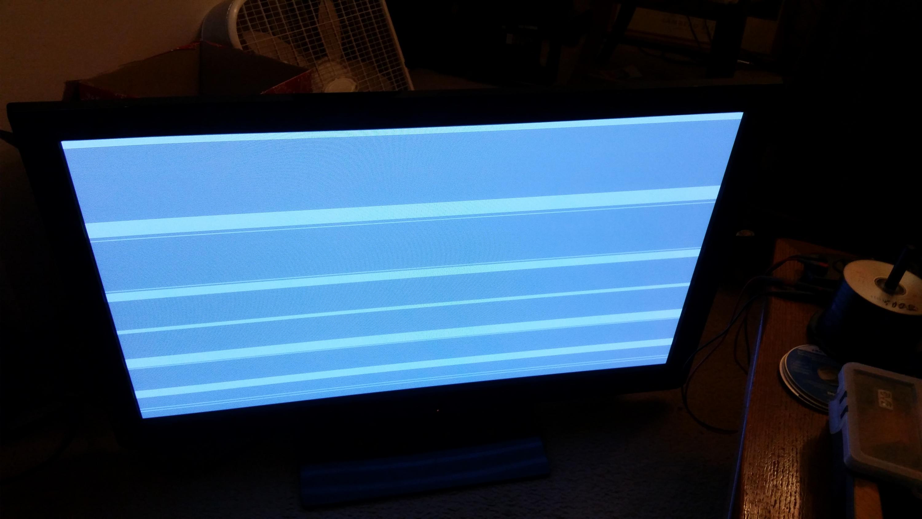

    Panasonic TC-42PX14 bad panel?
    This is what I have on the screen. I ran the test patterens and did the mirror and flip with the mainboard. Still has lines that dont move. I had a short on the SS board. SC was ok.I replaced the shorted fets twice on the SS and then bought a used one off ebay. I powered it on and it looked like malcharge on the screen but that cleared up and left the lines. I think its the SC or maybe the panel itself. What do you think?

    Re: Panasonic TC-42PX14 bad panel?
    Looks Like lose buffer ribbons to me reseat them.

      Re: Panasonic TC-P4232C bad panel?
      I tried that too, forgot to say that. I re-set them 12 times, took 1.5 hours, nothing changed.
        I just looked on shopjimmy and then ebay and there are no a boards anywhere.
        This would be my last attempt at fixing this piece of crap.
        Looks like I scrap this fucker and sell its guts.
