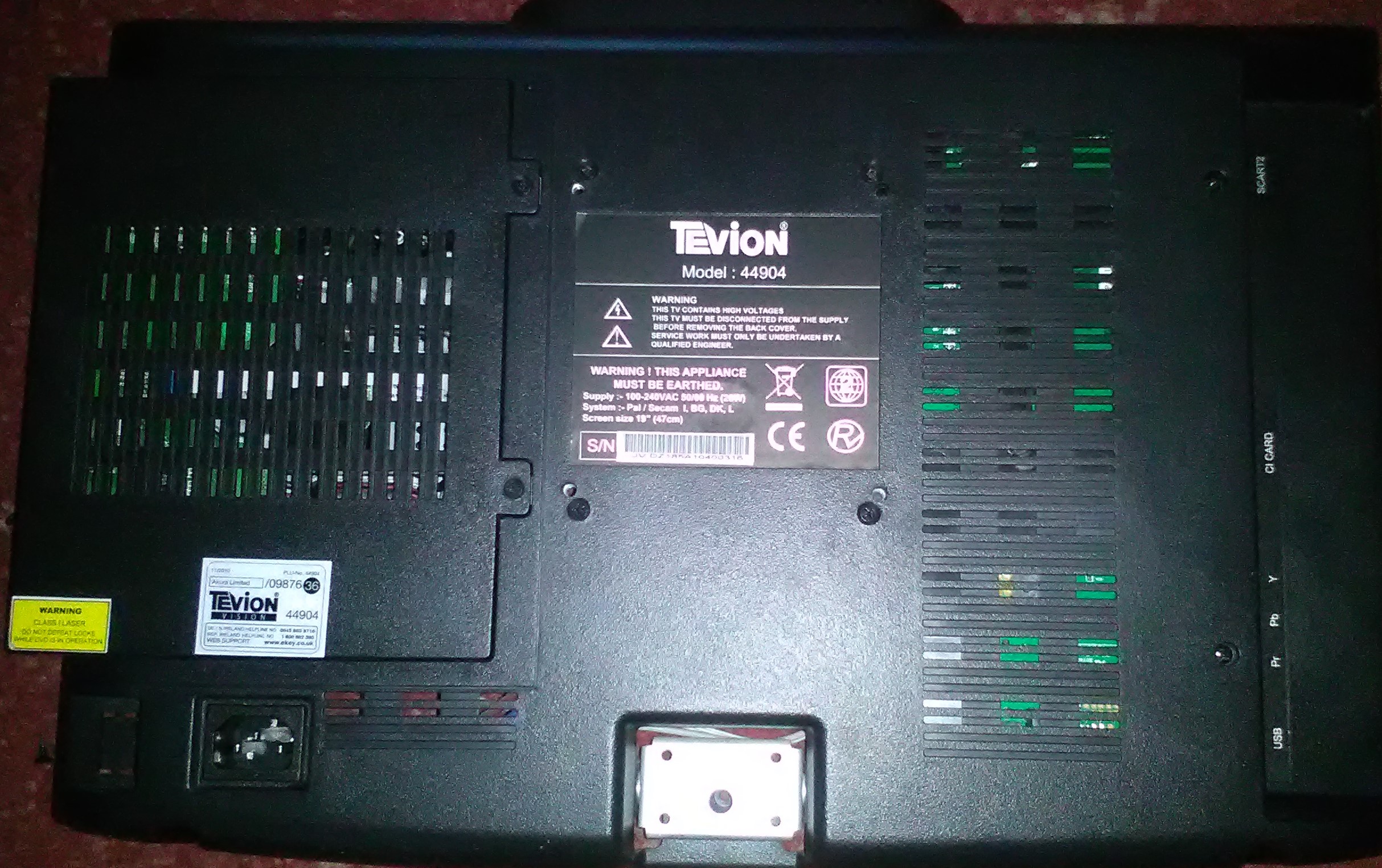

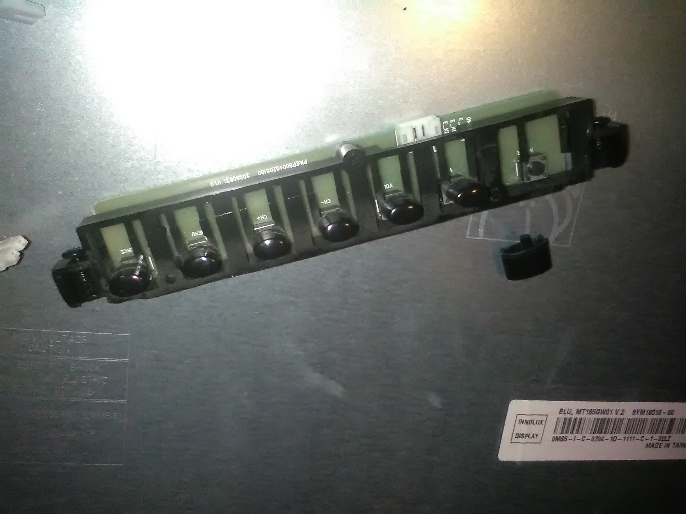

    Tevion TV/DVD combo model number, 44904.
    Urgent!!!!

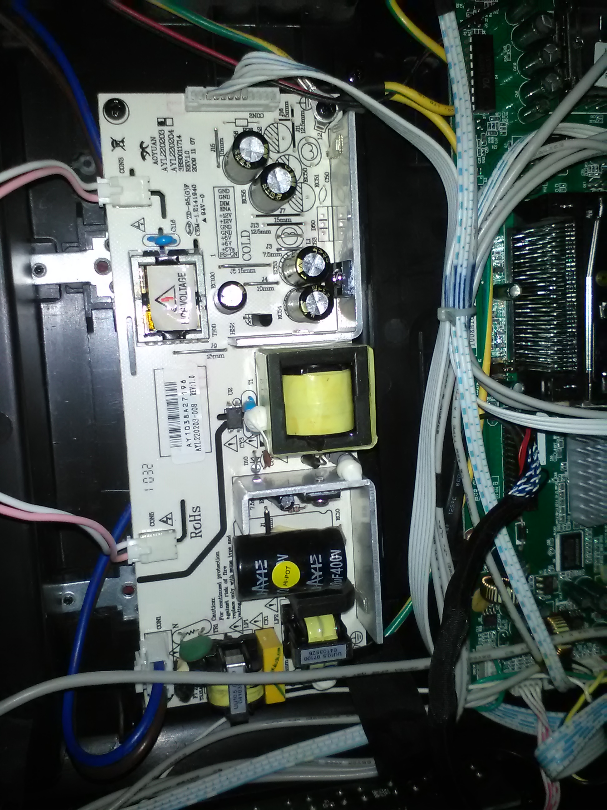

    I took apart this crappy TV/DVD combo thing, to fix the power button which fell apart!!!!
    Then this crap appeared they added this black round thing inside some cables to stop me open it up.
    I then saw two silver screws holders fell inside the thing, so need to get into this to fix that.
    What a piece of rubbish. Any HELP!!!!!!!!!!!!!!!!!!!!!!!!!
    Here's picture to show what I mean.
    http://imgur.com/nDxnP3D
    http://imgur.com/8pJ7HTi
    http://imgur.com/trz1xG1
    http://imgur.com/qydU0XM
    http://imgur.com/HDe8Tz5
    This I cannot pull cable through the slot.

      Re: Tevion TV DVD trouble
      remove the contacts from the white shell unwind the cable from the inductor.
      make a note first of how it goes back together!'
            look at the white plastic shell, normally you can bend up a bit of the plastic to "unlock" the contact so it will pull out of the back.
              look at the connector . there will be a bendy tab inside that locks the metal part in. bend it so it pulls out ..bend back to push back in .jewellers screwdrivers work well .
              if it was me i might get the case warm and push it all through the gap .or take back of tv to see if it can be done that way .
                Okay I got it out, then I glue the power button back on. I totally forgot what screw goes where.
                So I this TV/DVD combo I got to put back together.
                The LCD is easy just plug the connectors in the sockets.

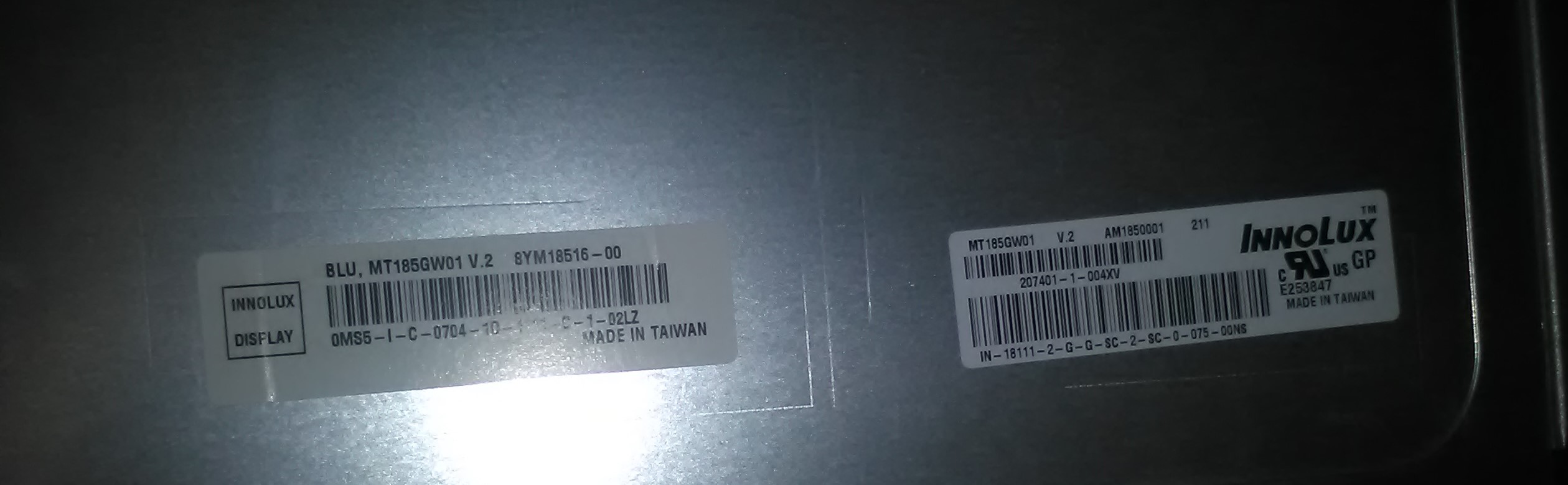

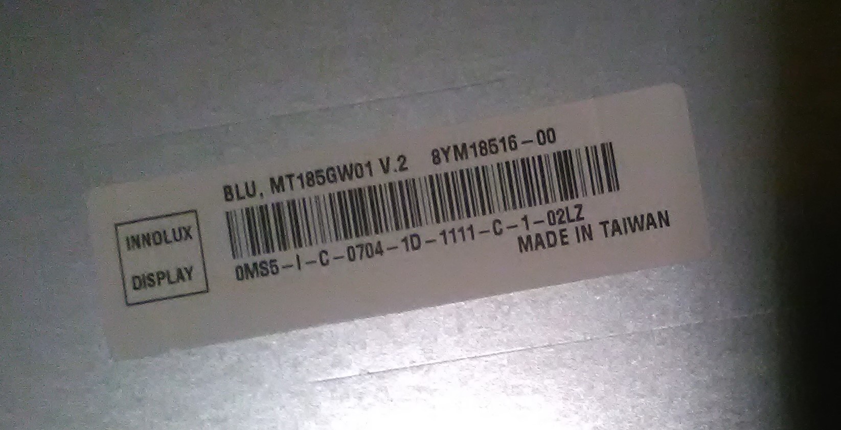

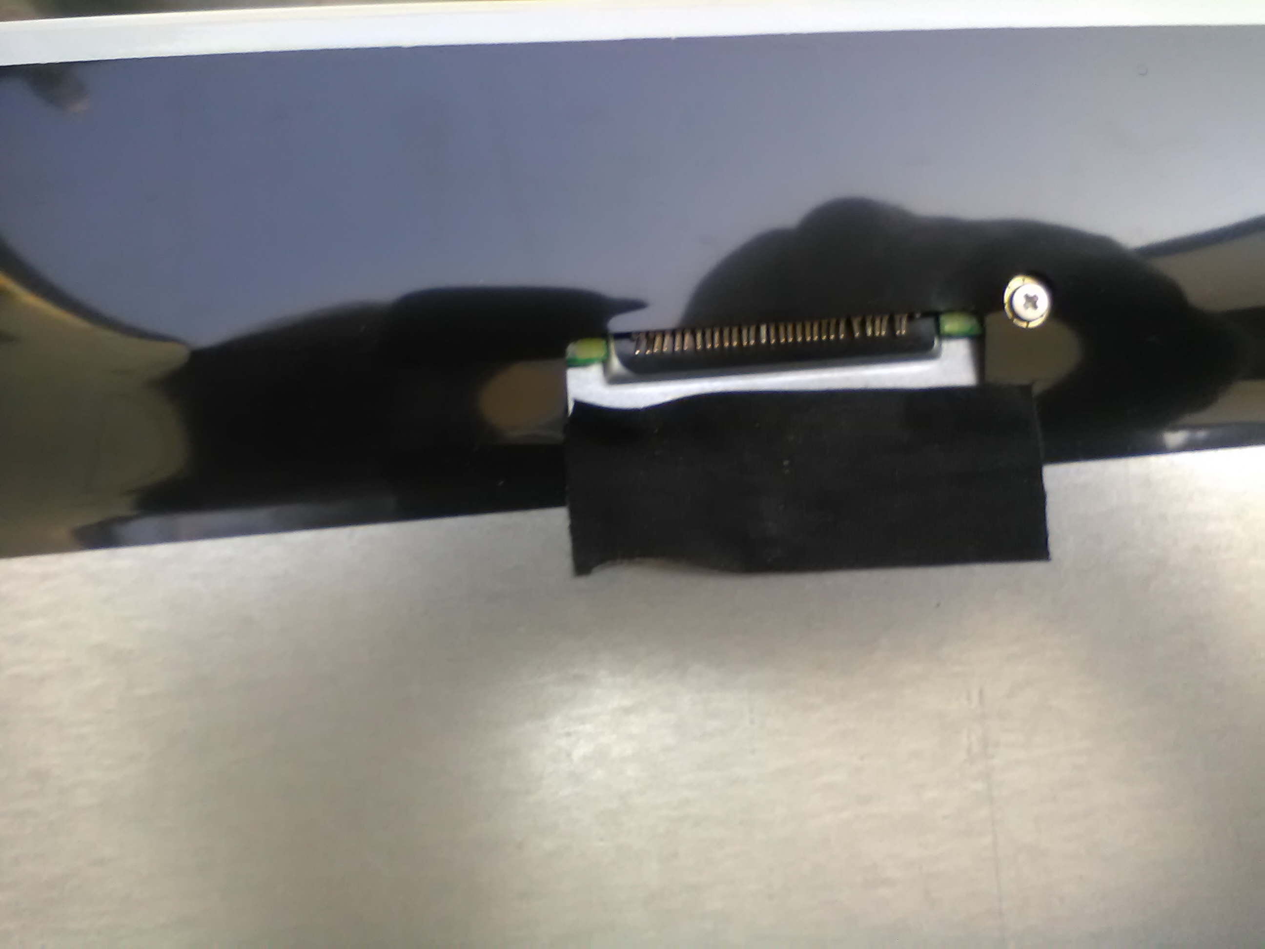

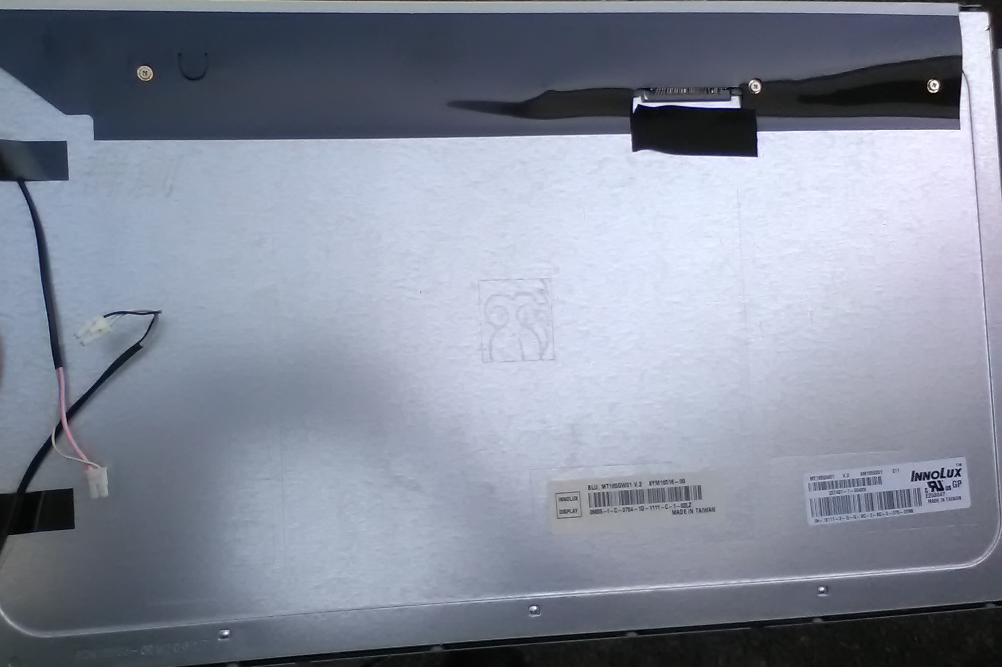

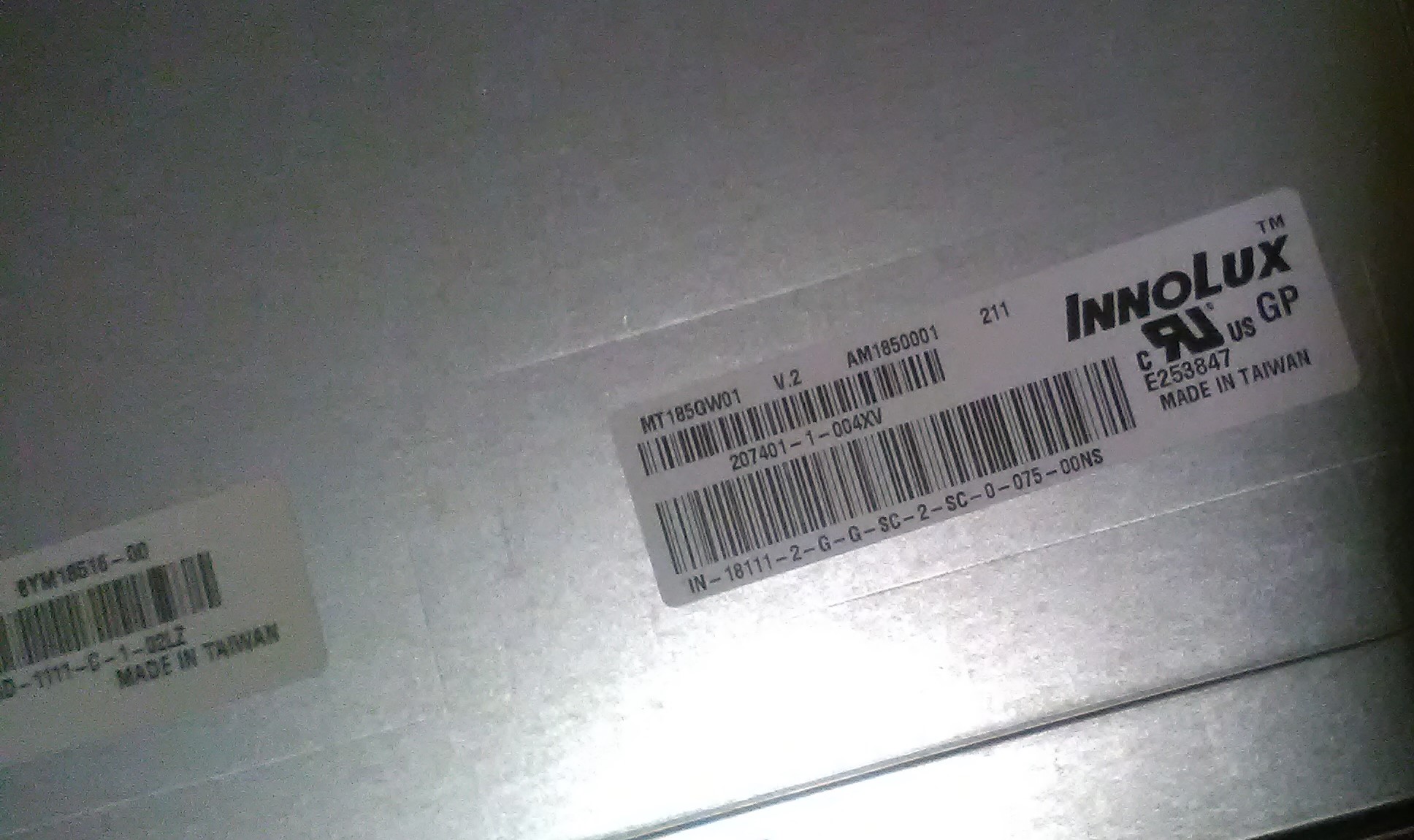

                  I broke the pins of the LCD part of the connector on the lcd itself, the cable is fine I hope.
                  Need to replace it. HELP?
                      if you have a broken panel, you can swap the connector.
                            How the fuck so you do that, and answer today.
