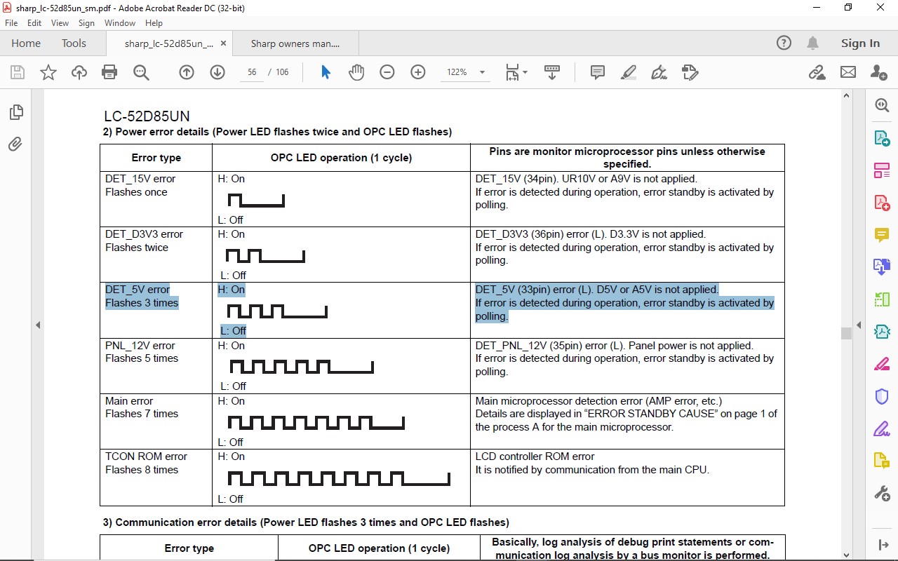

    I have a SHARP TV model LV-52D85UN
    The TV does not light up. OPC flashes 3 times, power flashes 2 times.
    Attached is a screen shot of the Service manual explanation for the symptoms my TV is exhibiting.
    I measured the voltages on the power supply board 12 pin connector PD.
    Pins 1 through 8 = 0 VDC
    Pin 9 = 3.0 VDC
    Pin10 = 0 VDC
    Pin 11 = 5VDC
    Pin 12 = 0VDC
    I also have the service manual and the operation manual if required. I'm not sure how to proceed from here and so I'm reaching out for some guidance please?

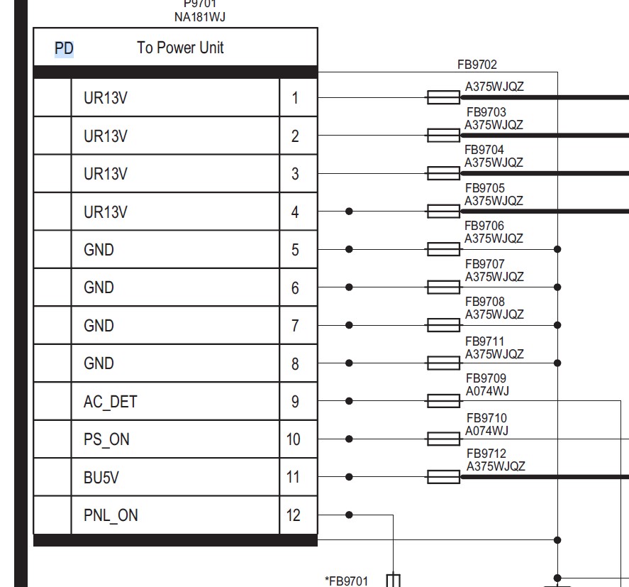

        • dick_barton
          • Aug 2015
          • 6643
          • Wales
          Re: Sharp LC-52D85UN that won't power on
          You give the voltage readings but not the pin names. Without a picture of the power supply or the service manual they do not mean an awful lot.
          Can you put the names alongside the readings you have given.

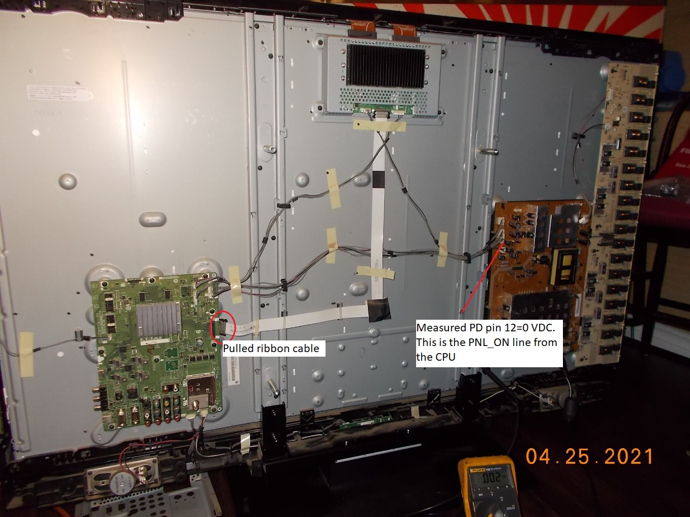

          • dick_barton
            • Aug 2015
            • 6643
            • Wales
            Pin 12 = 0 VDC
            This is the Panel On (PNL_ON) pin and is missing it's input voltage from the mainboard and looks like it's an output from the main BGA chip

            • Hendog
              • Apr 2021
              • 10
              Pin 12 = 0 VDC
              Edit
              This is from another website "Home Theater Shack"
              Thank you Dick_Barton. You're right I'm missing the PNL_ON voltage. I'll try to include more document details while I'm at it.
              I've been focusing on the power supply board given what I've read about them. The problem I have is my PC board component identifiers don't match up with the service manual schematic. On my power supply board RDENCA336WJQZ, I have a TNY264PN commonly found to be bad along with a couple resistors and a diode. So much so, repair kits are easily found on line which contain these components. I don't know if my TNY264PN is bad or not, but the surrounding resistors and the diode are good. I lifted one leg of each and measured them to spec. My schematics don't show these components nor is the naming convention the same. See the attached pic of my power supply board along with the two relevant pdf pages of the power supply board. IC7905 is not in the schematic, yet it's on the board.
              Anyhow, if I put that aside and look at that missing PNL_ON voltage, my next question would be: is my CPU faulty? I believe the PNL_ON is an output of the CPU: page 75/106 from teh sharp lc-52d85un manual. If you search the pdf for PNL_ON you will find 5 "hits".

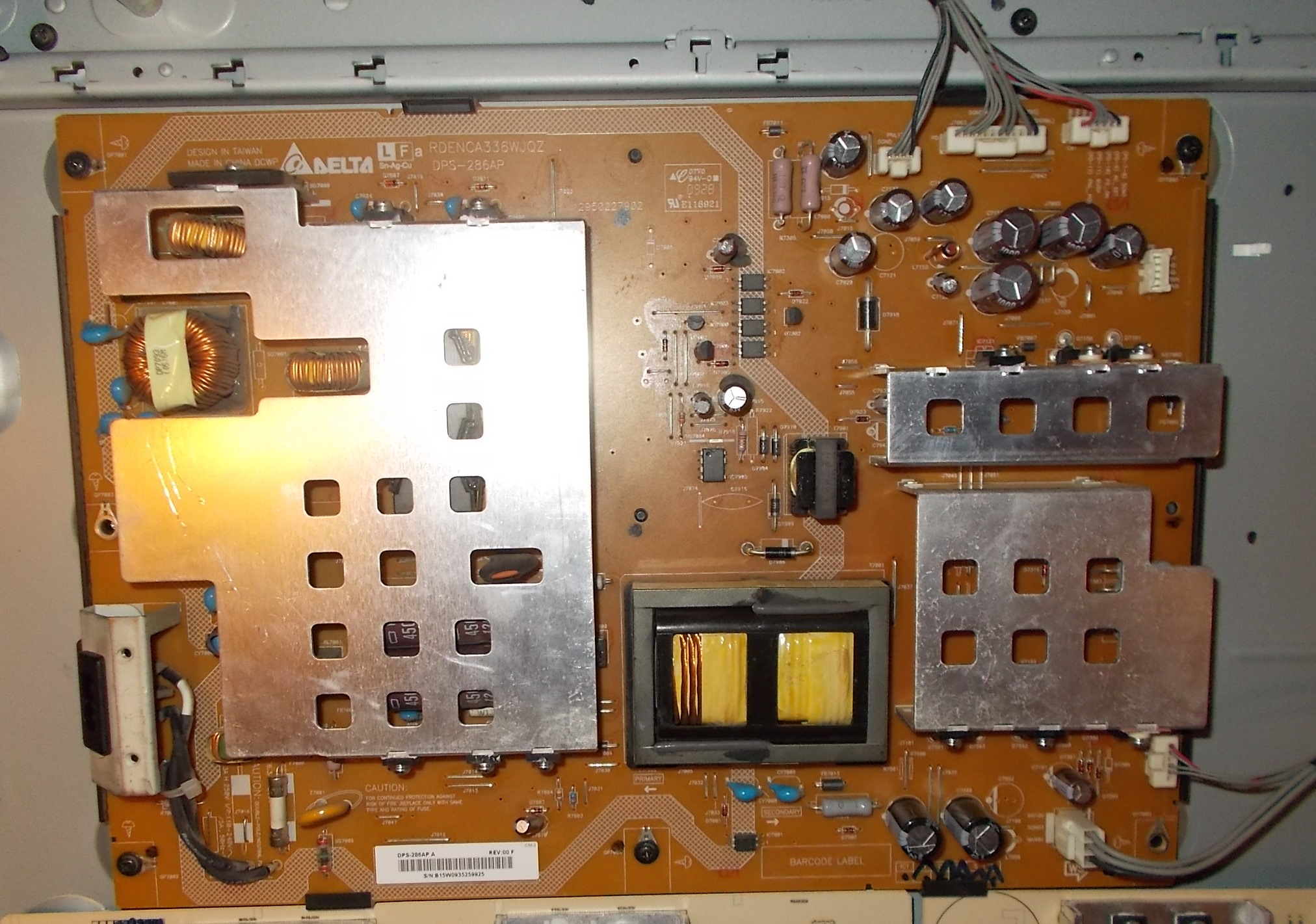

                • dick_barton
                  • Aug 2015
                  • 6643
                  • Wales
                  If your measuring the voltage on TNY264 then the ground connection for you meter would be the negative leg of the 450V capacitor. Your readings in post #4 appear to show negative readings so I assume that you used chassis as the groung connection for you meter.
                  A photo of your power supply could prove useful if it does not match what is given in the service manual.
                  What is the voltage between the two legs of the 450V capacitor under the large heatsink. It's normaly around 380V DC.
                  You appear to have all the voltages ie BU5V, +13V, PS_ON, AC_Det so it looks like your power supply is working. PNL_ON is sent to the power supply via the CPU as you noted again assuming that the mainboard matches that shown in the service manual.
                  It does initially look lke a BGA failure.
                  I would wait to see what advice others can offer before giving up.
                  • R_J
                    • Jun 2012
                    • 9606
                    IC7905 is the STANDBY IC, if anything to do with it was bad you would not have the tv turn on at all. The only thing PNL_POW does is control the regulator ic7121 which supplies PNL12V whos input is from the 13.5 volt supply
                    Try disconnecting the ribbons between the t-con & panel and see if you get PNL12V

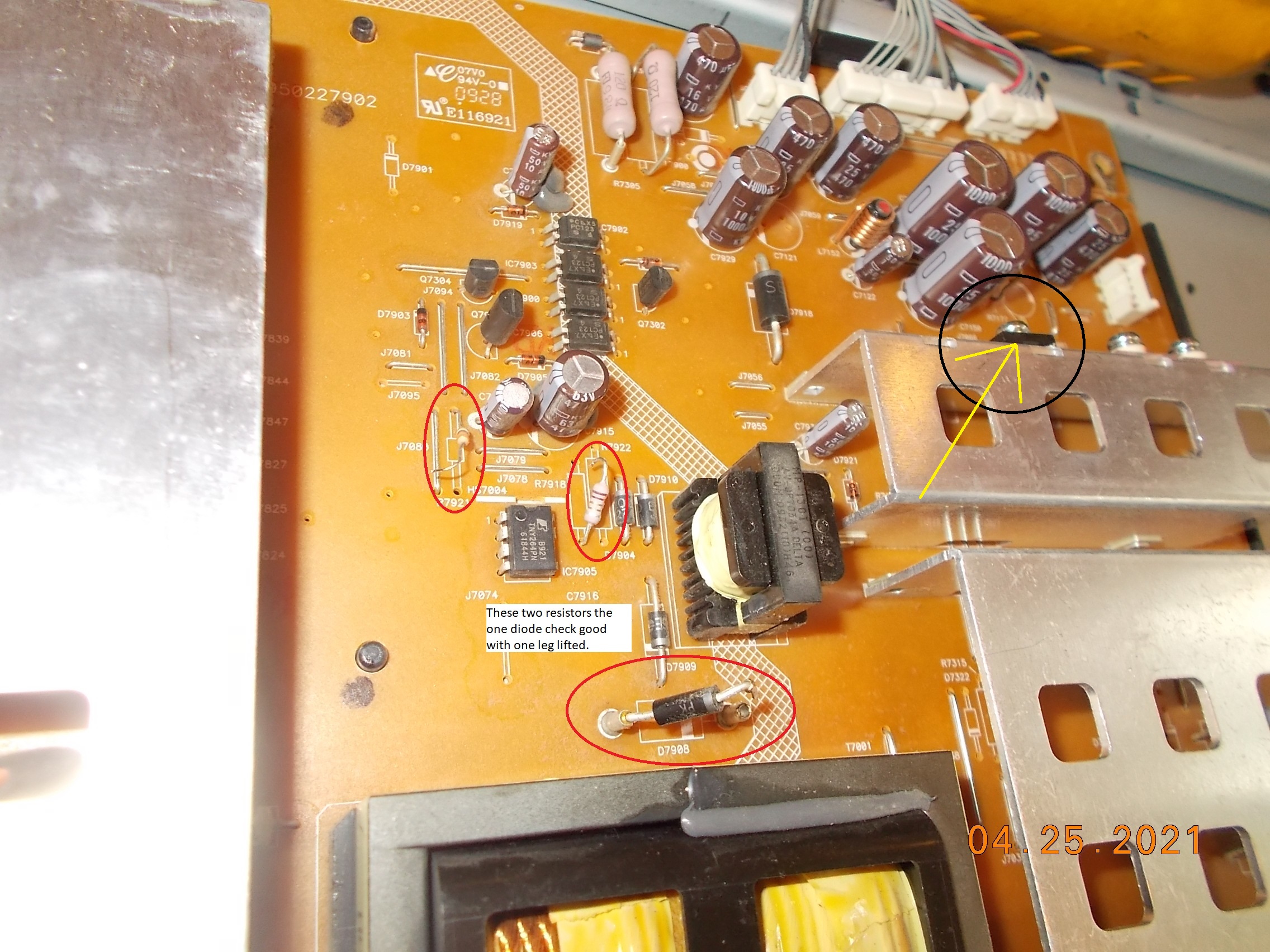

                          • Hendog
                            • Apr 2021
                            • 10

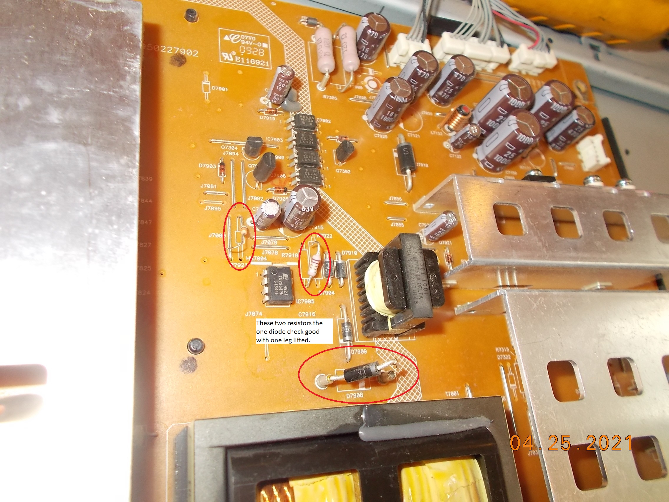

                            I have two large 450V caps there. I suspect they're in parallel but I don't know for sure. I'm measuring 380 VDC, and yes I was referencing chassis GND when measuring the TNY264.
                            See pic of power supply board.

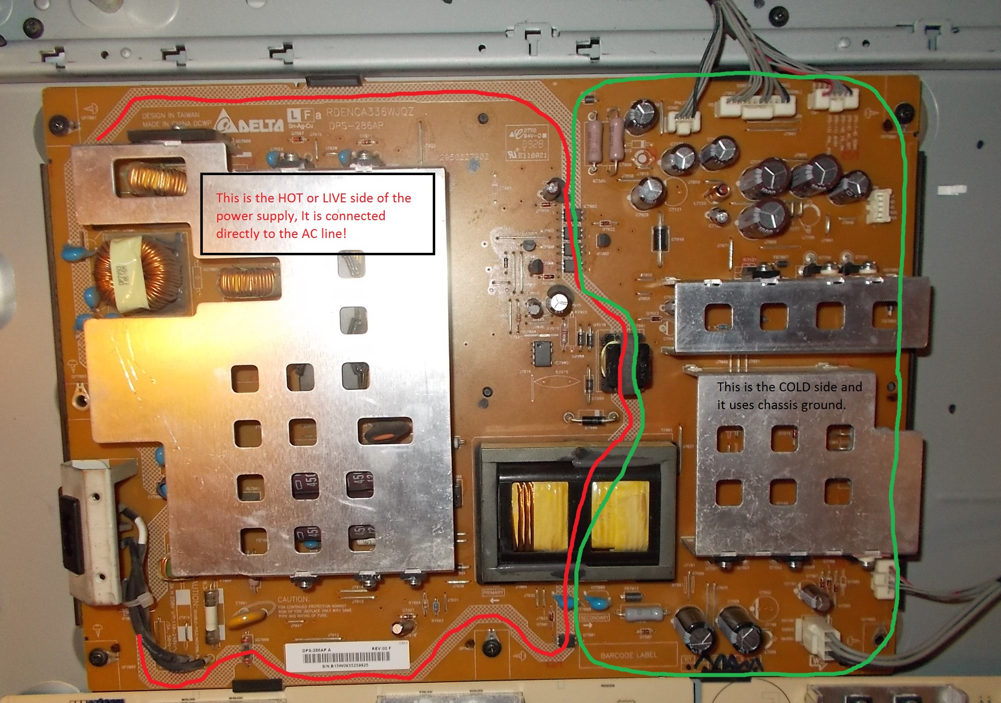

                              If you are so determined that the power supply is bad, order a replacement.
                              Then you will convinced that this is NOT where your problem is.
                              The large caps are in the primary and are NOT checked to chassis ground, you must use HOT ground (primary capacitor negative lead)
                              If you keep doing what you are doing, you WILL need a new power supply.
