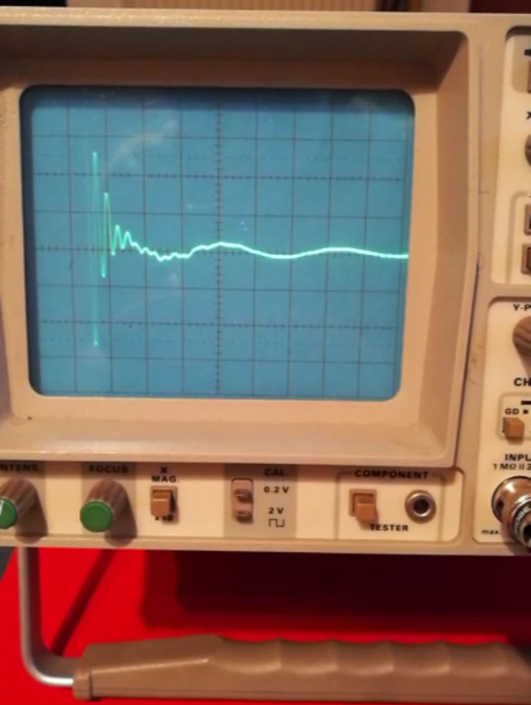

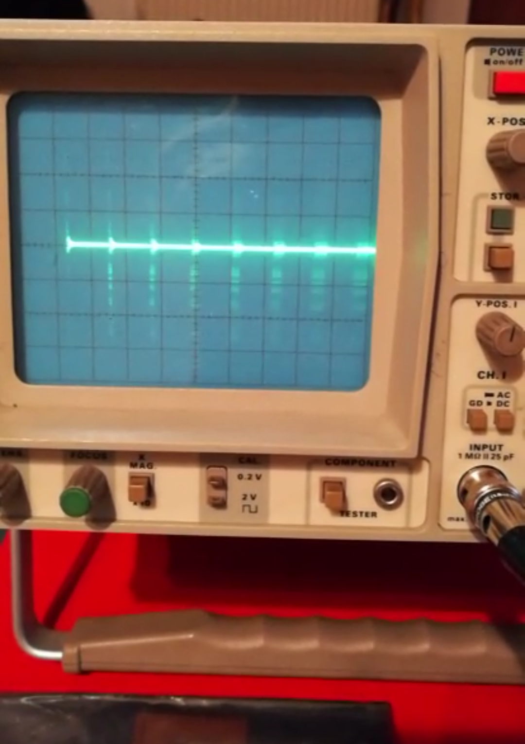

                • penspinner
                  • Jan 2017
                  • 8
                  Re: Philips 47PFL3605H/12 Power Supply Not Working (Not Even Standby)
                  Hi everyone,
                  I'm sorry if I'm being impatient, but just to let you know, I still haven't fixed the issue and am still working on it.
                  What I did was to disconnect the 5VSB output part from the transformer output (while keeping the control loop intact of course). There is still no 5V output.
                  I then tried to measure the voltage on the secondary side of T904 (pin 9 - 7) with my oscilloscope and there is actually some output! Every second or so, there are some ~50kHz pulses that oscillate a little bit and then decay (if that's the word? )
                  The amplitude was only a few mV though. I posted 2 pictures of the signal, one of the single pulse, and one of the multiple pulses in a bigger time frame.
                  Any ideas what is happening here?
                  Thanks, Felix

                      See page 4 of datasheet about auto-restart function. That's probably what you're seeing. Quite possibly feedback circuit saw full line voltage when the IC shorted. So yeah, check all the semiconductors around there.
                      Did you check the rectifier diodes as well? D917?
                      With T904 out of circuit there is no path between 5vSB rail and GND through D917 so it won't tell you if D917 is bad.
