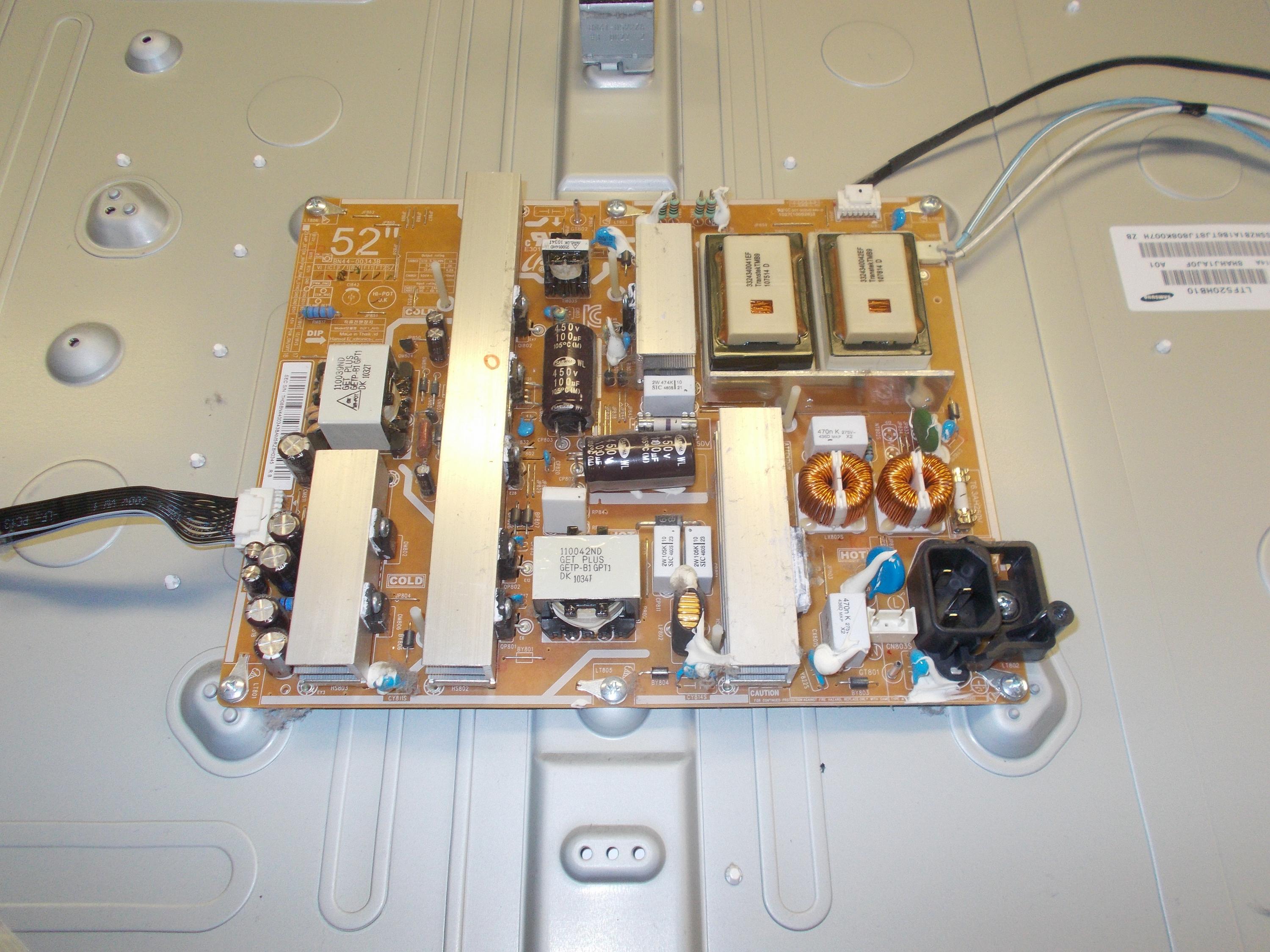

    Picked this up from my local recycling center.
    The TV turns on with no backlight. There is an image using a flashlight.
    There are 2 450v caps on the PS that I get 393 volts at with the set turned on.
    The power supply (BN44-00343B) voltages are as follows:
    Connector CN802 (from Main)
    Pin
    1. B13v - 12.6 volts
    3. B13v - 12.46 volts
    5. B13v 12.46 volts
    7. GND - 0 volts
    9. GND - 0 volts
    11. B5v - 5.1 volts
    13. B5v - 5.1 volts
    15. 13/18VS - 12.46
    17. 13/18VS - 12.46
    2. Lamp_Det - 0 volts
    4. 5w_Inv - 5.1 volts
    6. PWM_Dim - 2 volts
    8. H_sync 1.7 volts
    10. GND - 0 volts
    12. GND - 0 volts
    14. B5v - 5.1 volts
    16. B5v - 5.1volts
    18 Pow_On/Off - 0.88 volts
    Connector CNI802 (to inverter)
    1. 12v - 12.46 volts
    2. FB - 0 volts
    3. FB - 0 volts
    4. GND - 0 volts
    5. GND - 0 volts
    6. LD - 9 volts
    7. LD - 9 volts

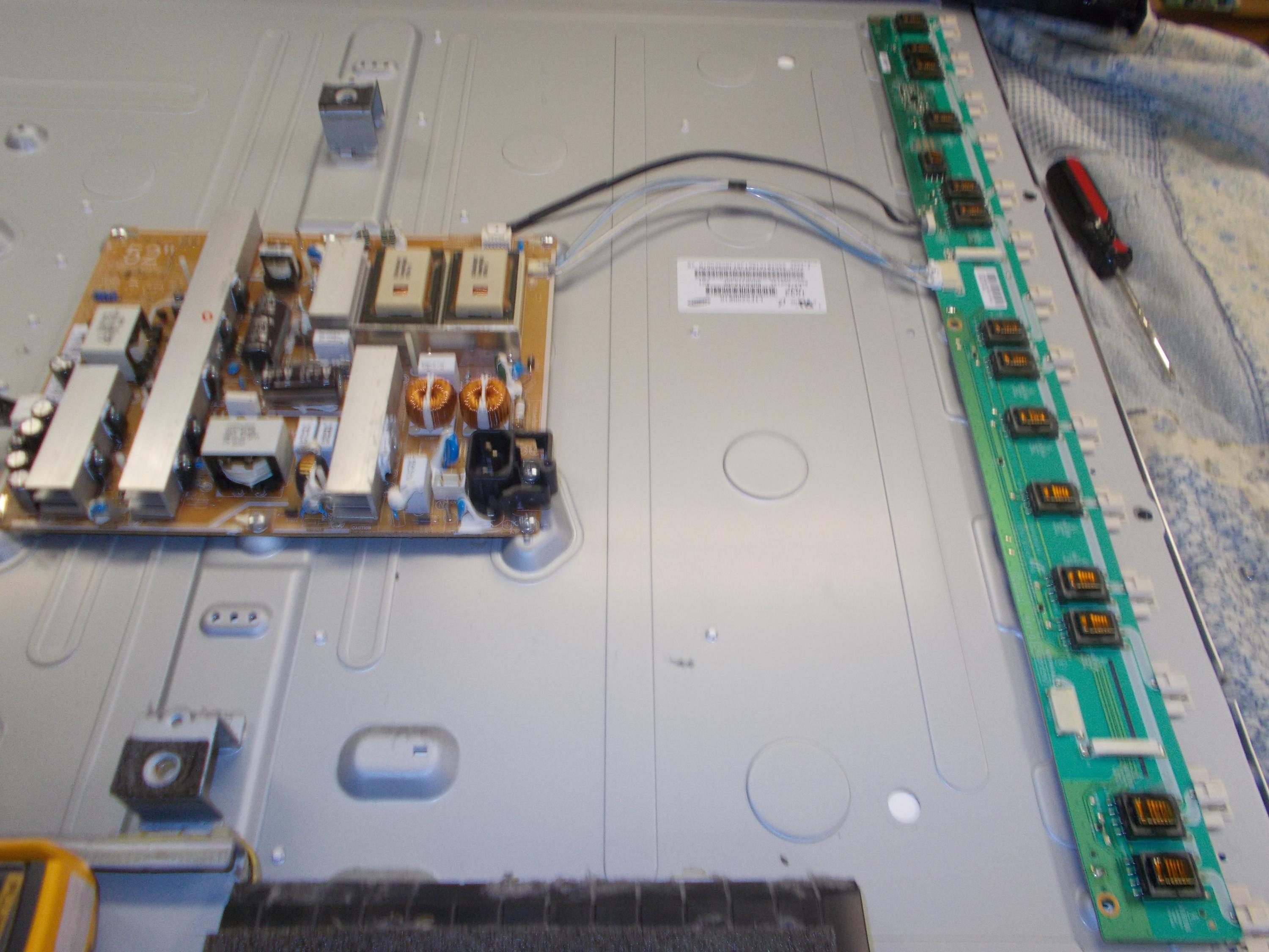

    Not sure the proper way to test the inverter.
    Looking for some guidance in narrowing down the issue and repairing it. Thanks for your help.

    Re: Samsung LN52C530F1FXZA No backlights
    Check the capacitance of that cap (gray cap with 474 printed on top) in the middle of the board next to the fuse, see if it has bulging sides and the capacitance is still OK, 0.47uF 450V.
      I'm unsoldering the cap to check capacitance. But looking at it at an angle it does look like one side is bulging. Did not see that before. Will report back in a few minutes after I get it unsoldered.
        That is the common failure cap in the SAMSUNG power supply, the cap is 0.47uF 450V Polypropylene type for that backlights inverter circuit.
          I unsoldered the cap, and yep there is a bulge on the one side.
          capacitance reads OL on the meter.
          Would this be a good one to replace it with?
          http://www.digikey.com/product-detai...174-ND/5881199
            That will be fine, best to go up to higher Voltage rating like 650V and up.
