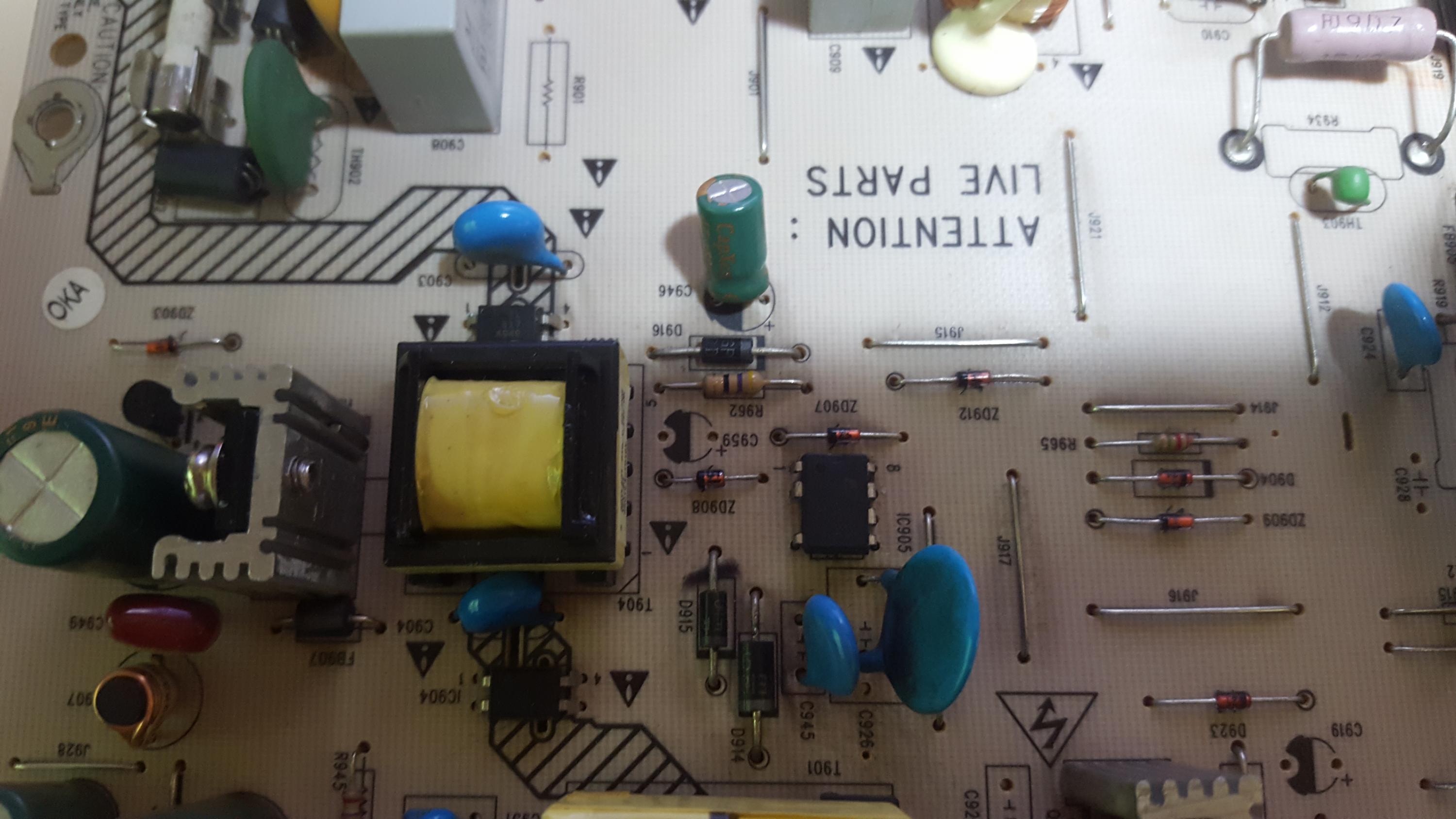

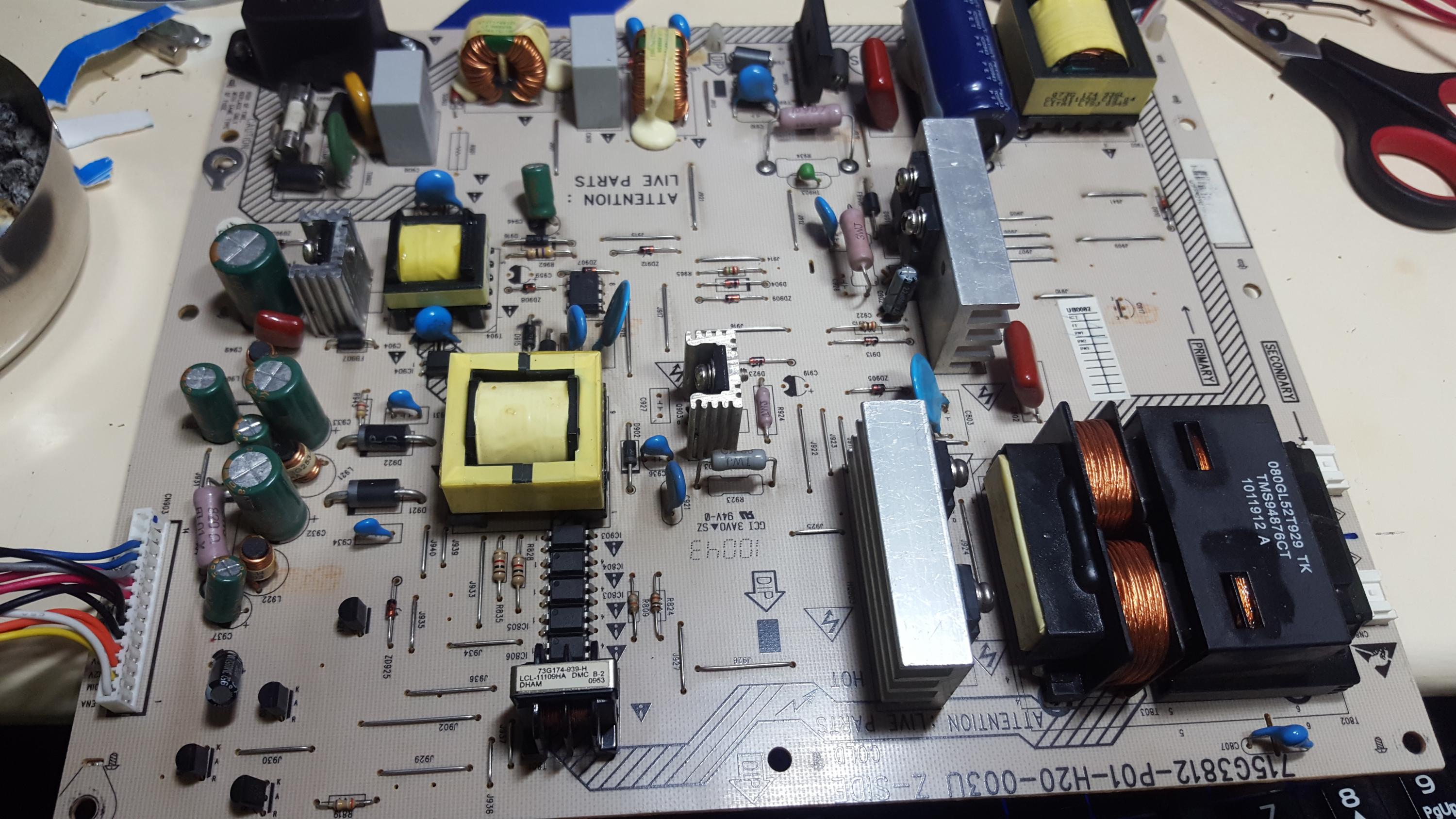

    I have a philips 42pfl3605/12 with chassis tpm4.1e
    It al started with no power up.
    When i opened the back it whas sure that the famous IC905 was blown out.
    I replaced IC905 but still no power. nothing at all, even not 5V
    So after searching en measuring i found that trafo T904 also was broken
    And suddenly after replacing the 5V was back
    But still no power up
    When i bridge the 5v with S/B its still doing nothing,
    There is also a ENA , can i bridge that one to power up the powerboard ?
    or someone has a tip to search the problem ?

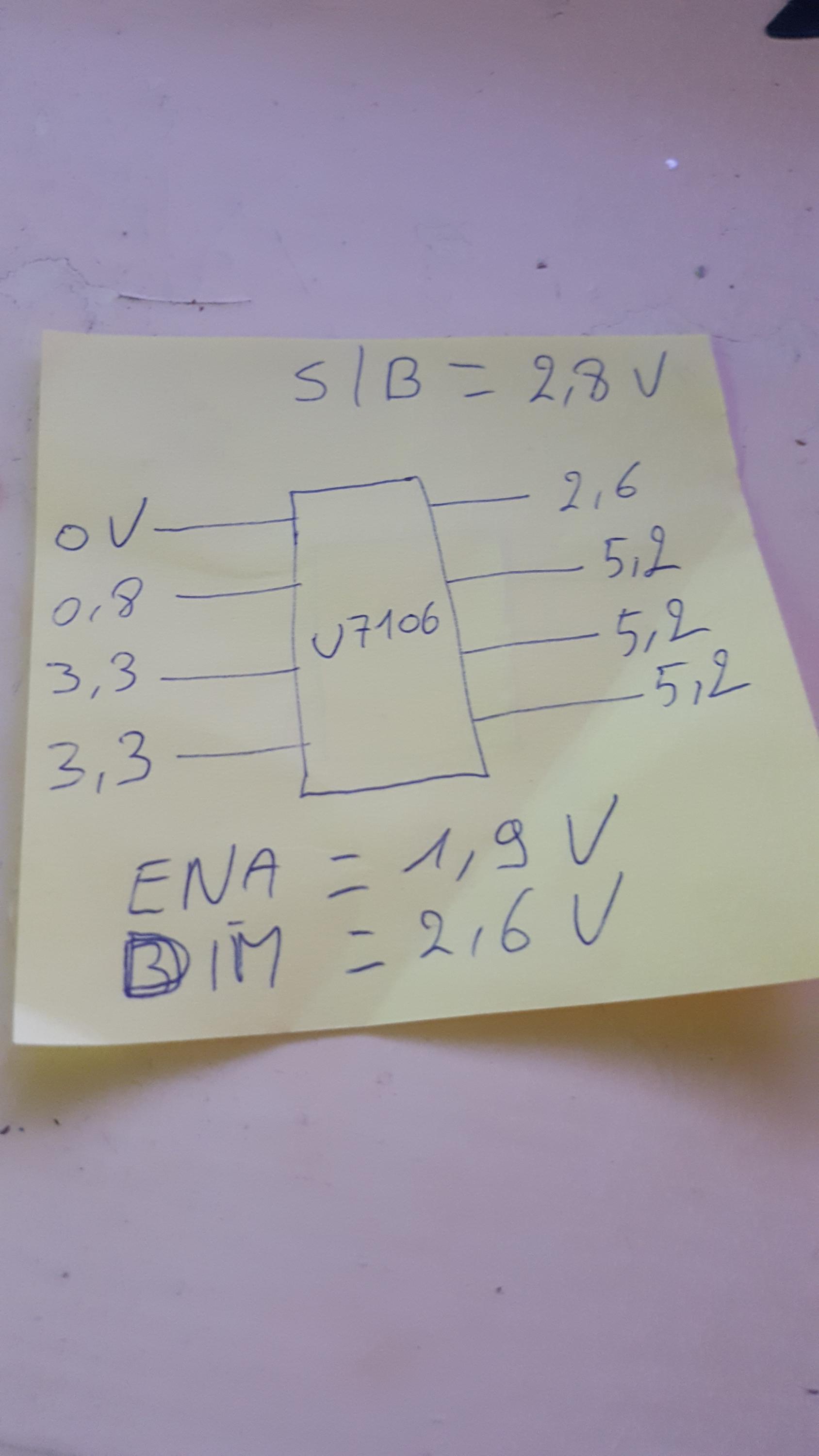

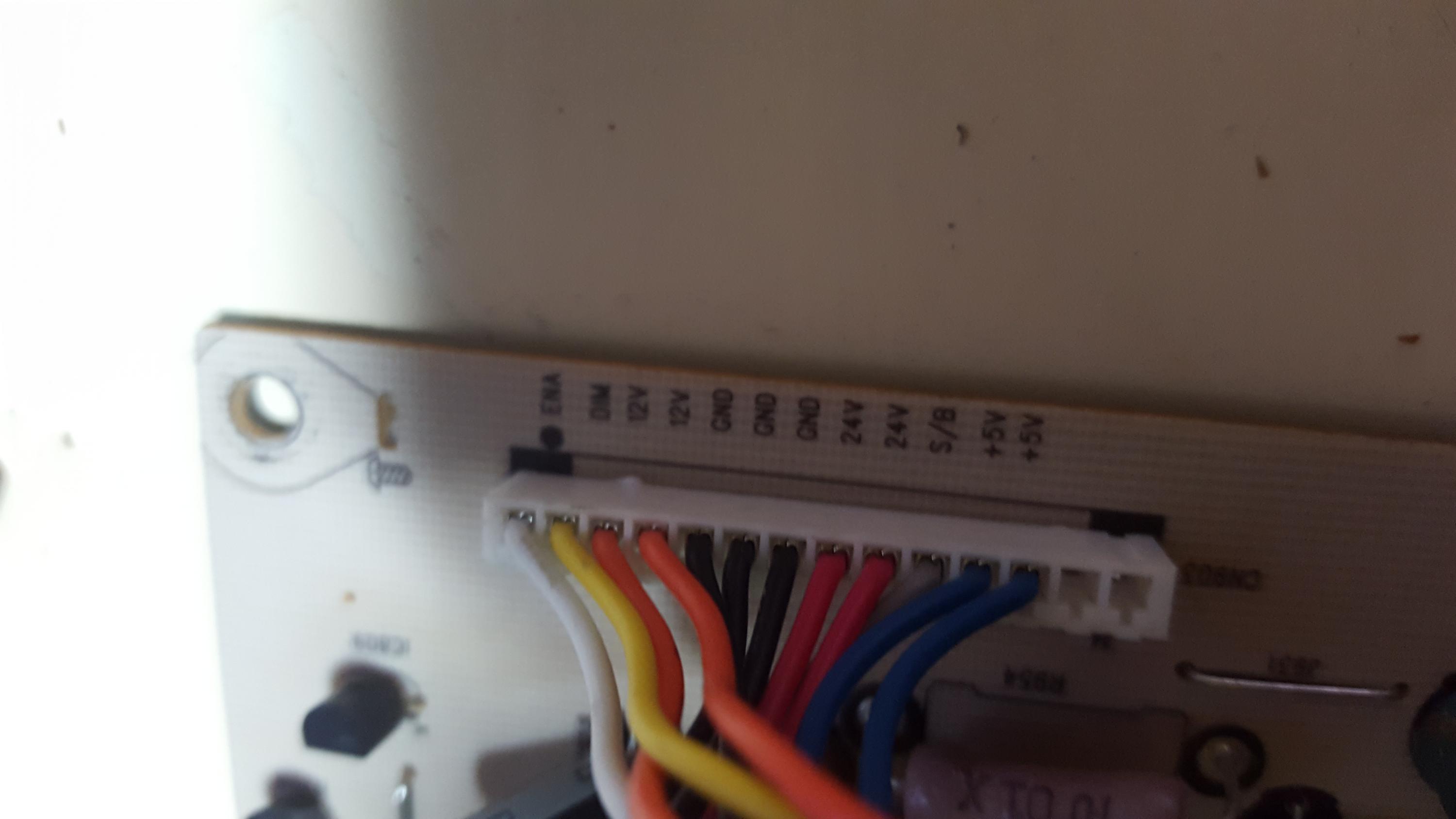

    So i think de U7106 is bad
    I meseared the chip and the voltages :
    S/B : 2.8v
    ENA: 1.9V
    DIM: 2.6V
    5V: 5V
    12V: 0V
    24V: 0V

          Re: philips 42pfl3605/12 power board problem
          thx for the reply
          the only thing i dont understand is that there is 5 v going in and 3.3 volt going out
          It's like the 3.3v dont fully reach the s/b and ena output
