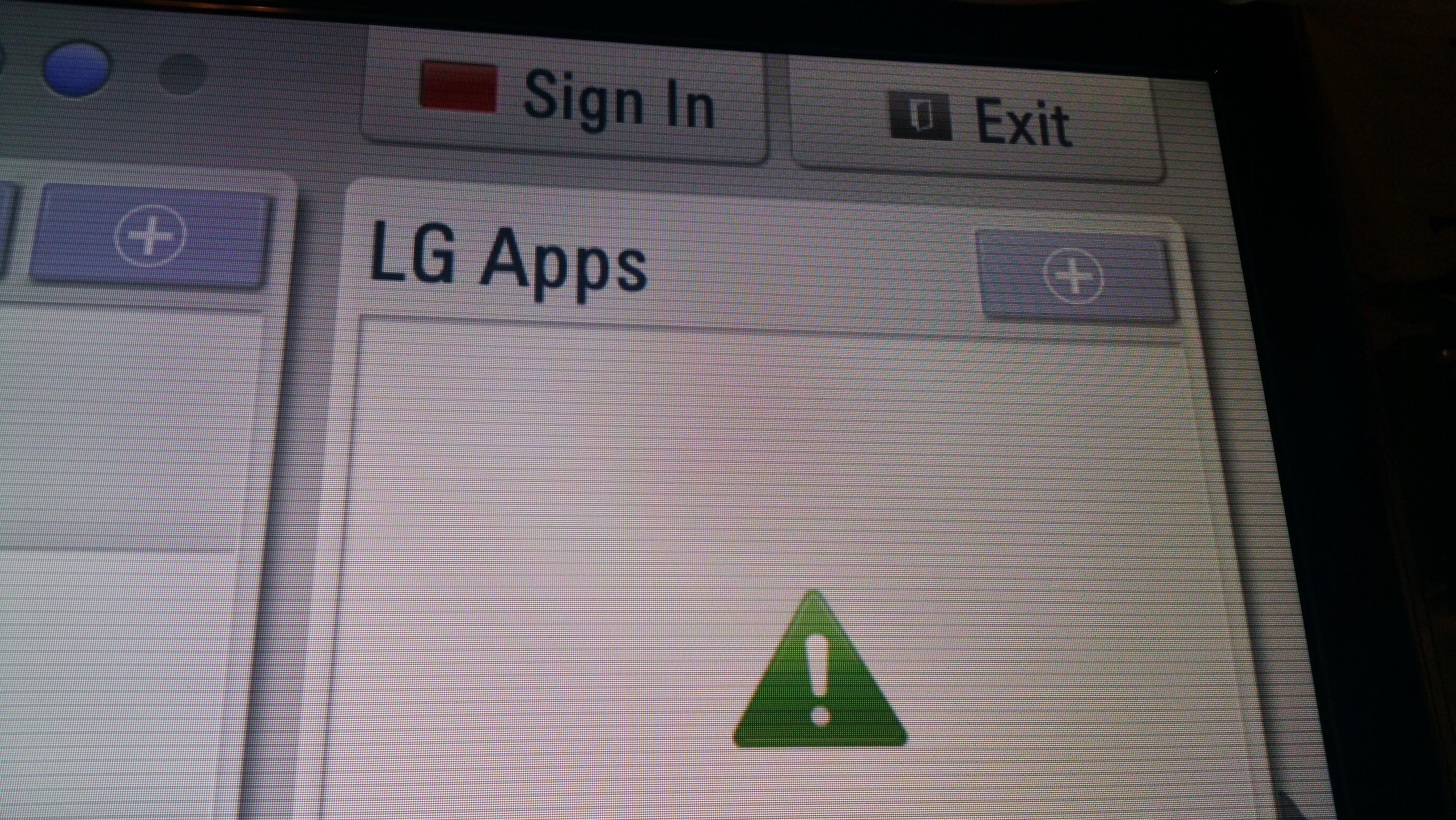

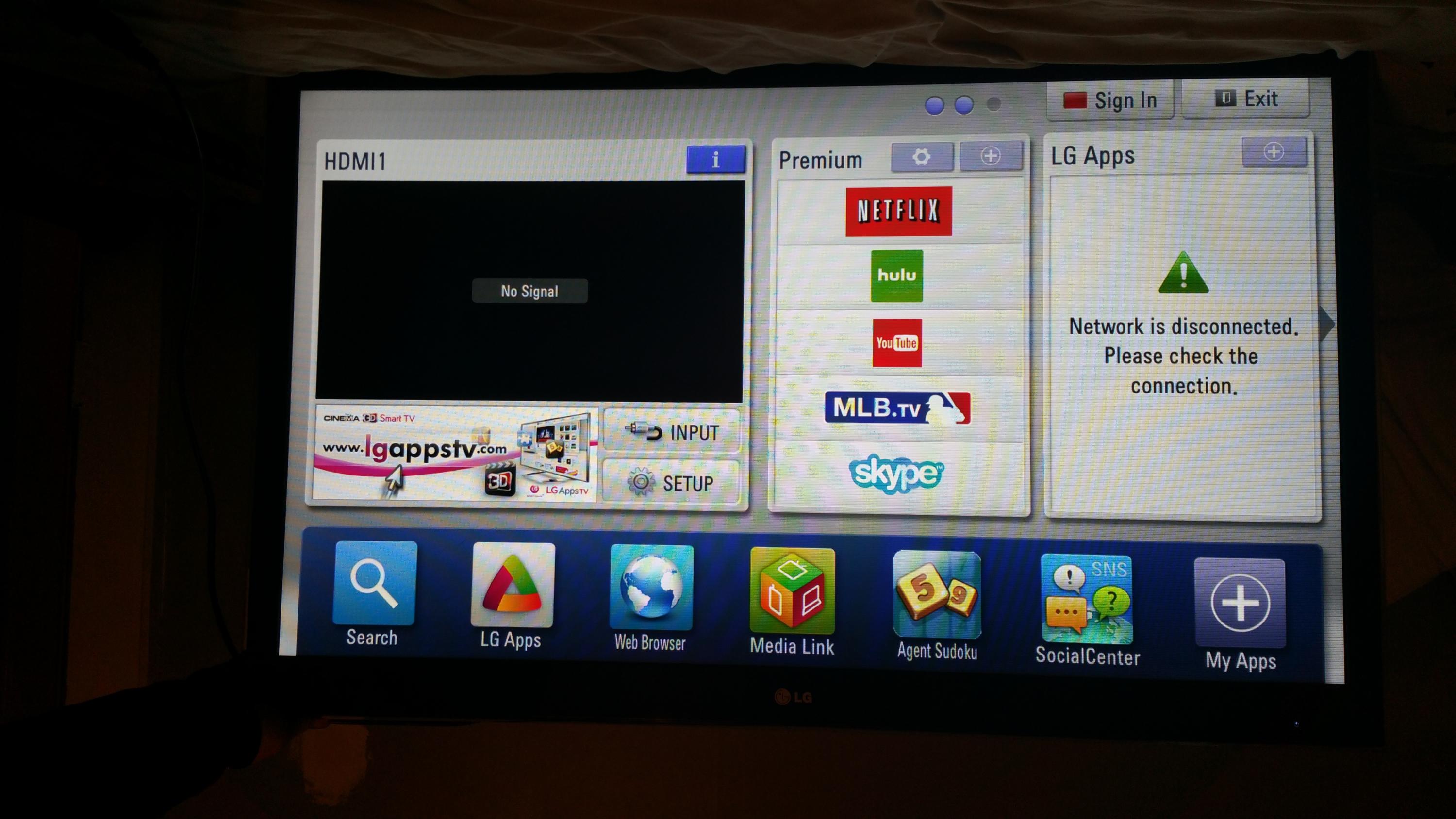

    I have been searching to find similar issues, but none are quite the same as mine. The horizontal lines I'm seeing are less than 1/4" apart, evenly spaced, black, and seem to become less prominent as you move from right to left when viewing. They are difficult to see for the most part, but they're much more obvious on a white background. There is no obvious wear on the ribbon, no oxidation, and every other connect seems tight. Any ideas? I recently drove the TV back from Atlanta to Charlotte to return it to a friend I had borrowed it from. It was secured and protected with cushions and pillows during the drive.

    Re: LG 47LW5600-UA - Thin Horizontal Lines...
    Ive had this panel failure not fixable
      I tried adjusting the ribbon cables connecting the tcon board to the LCD panel, and the lines went away...briefly. I tried readjusting the cable and it cracked in the middle. I'm going to try replacing the cable before all hope is lost.
          i very much doubt that it is your ps, you could try to run the test patterns to rule out main.
          good clear straight on pics of the whole back of the set and of each board will be a great start.
