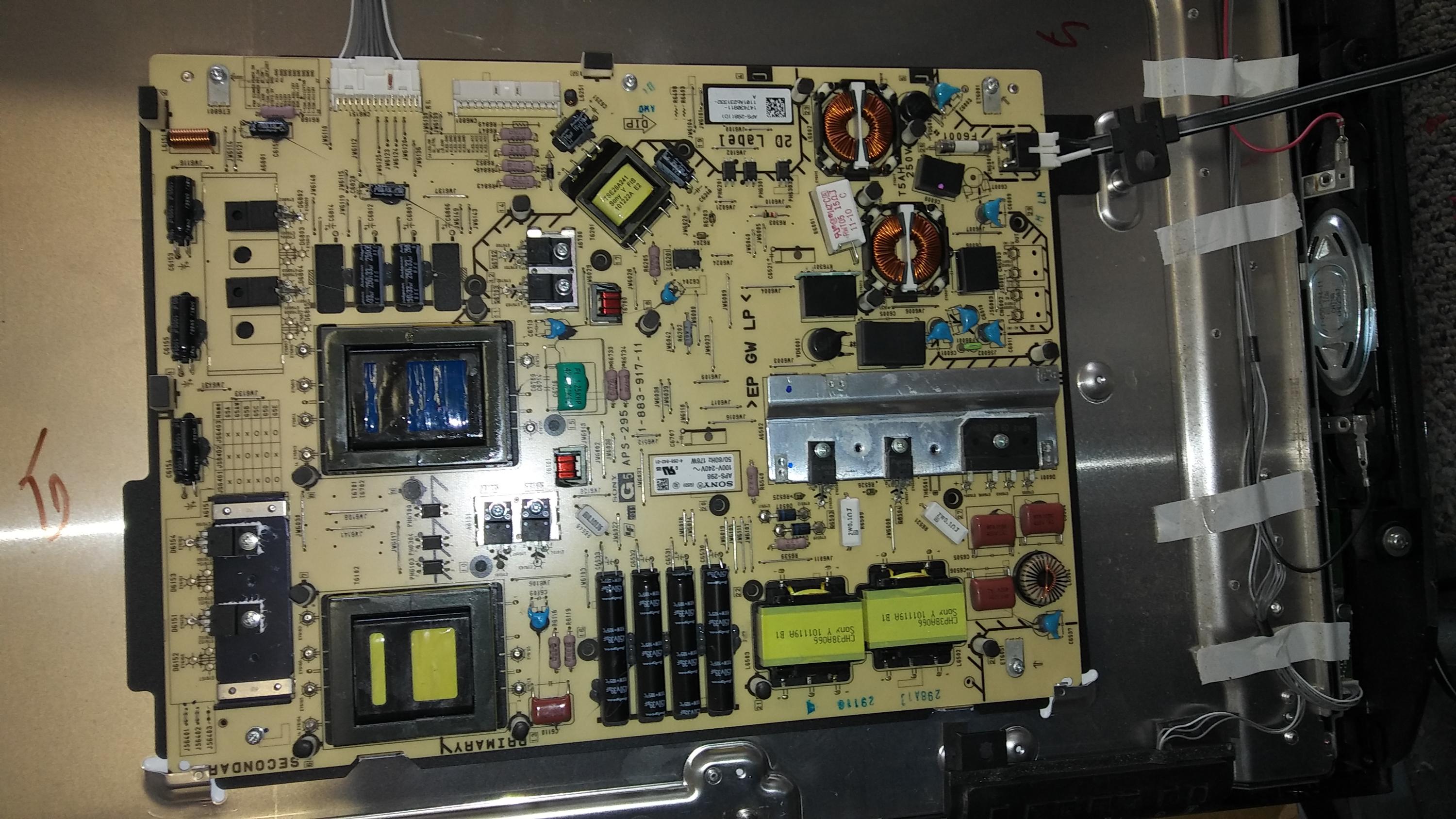

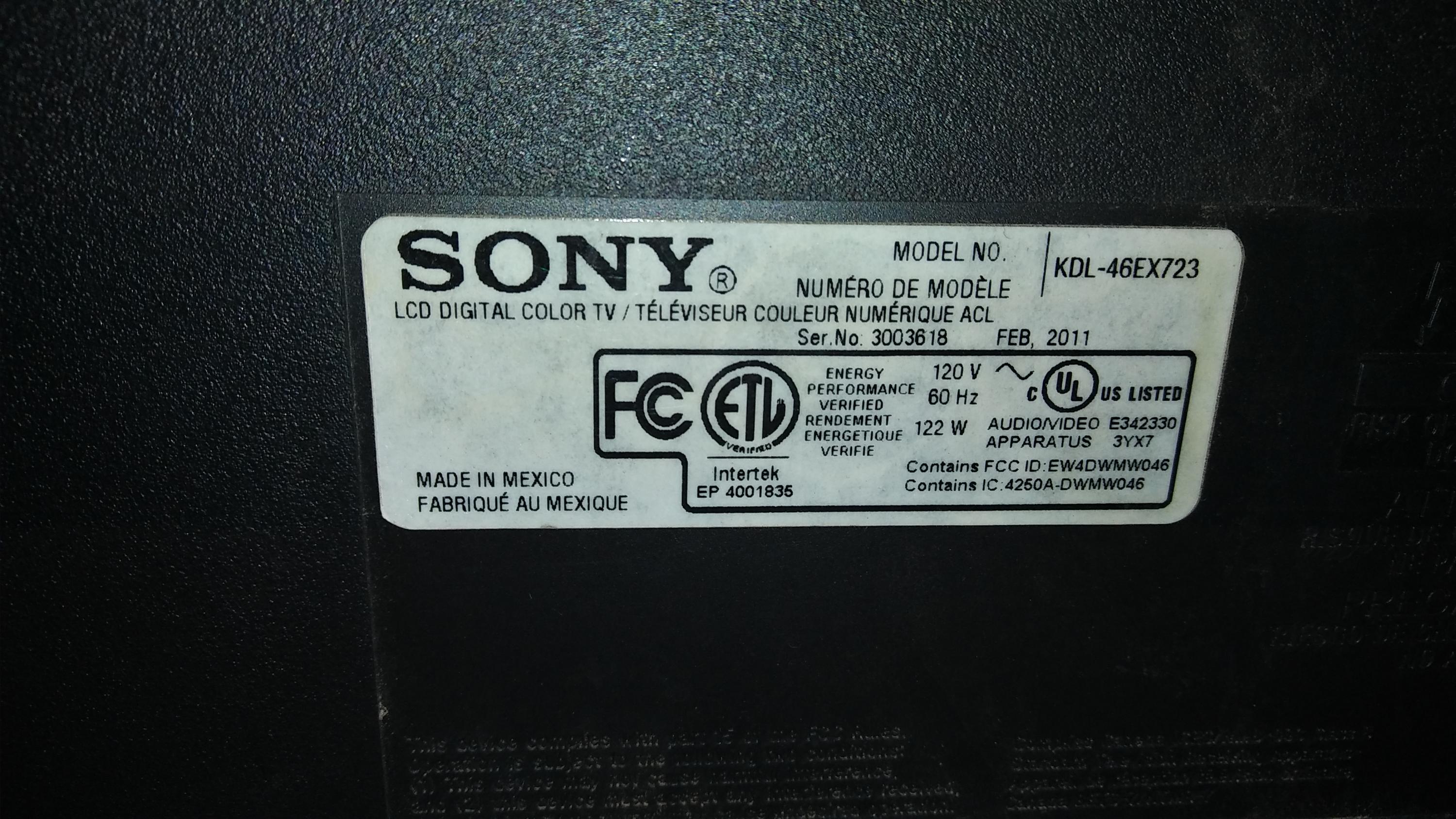

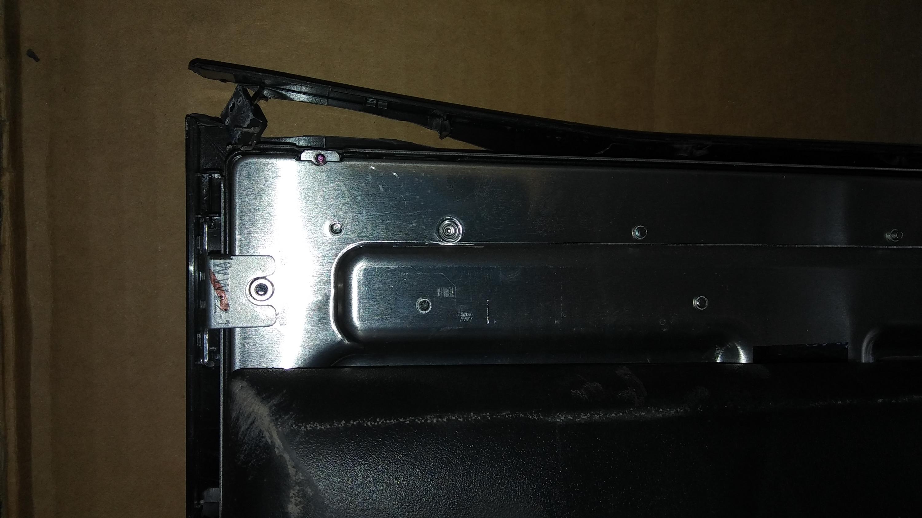

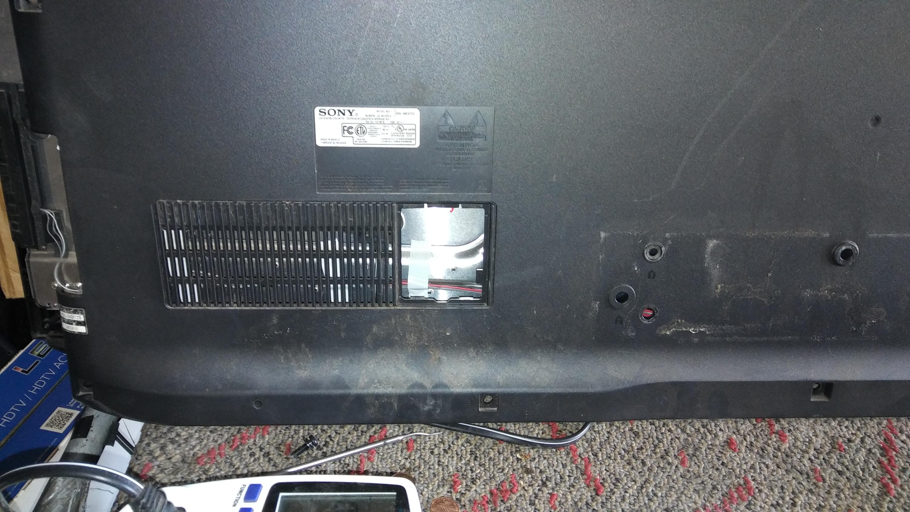

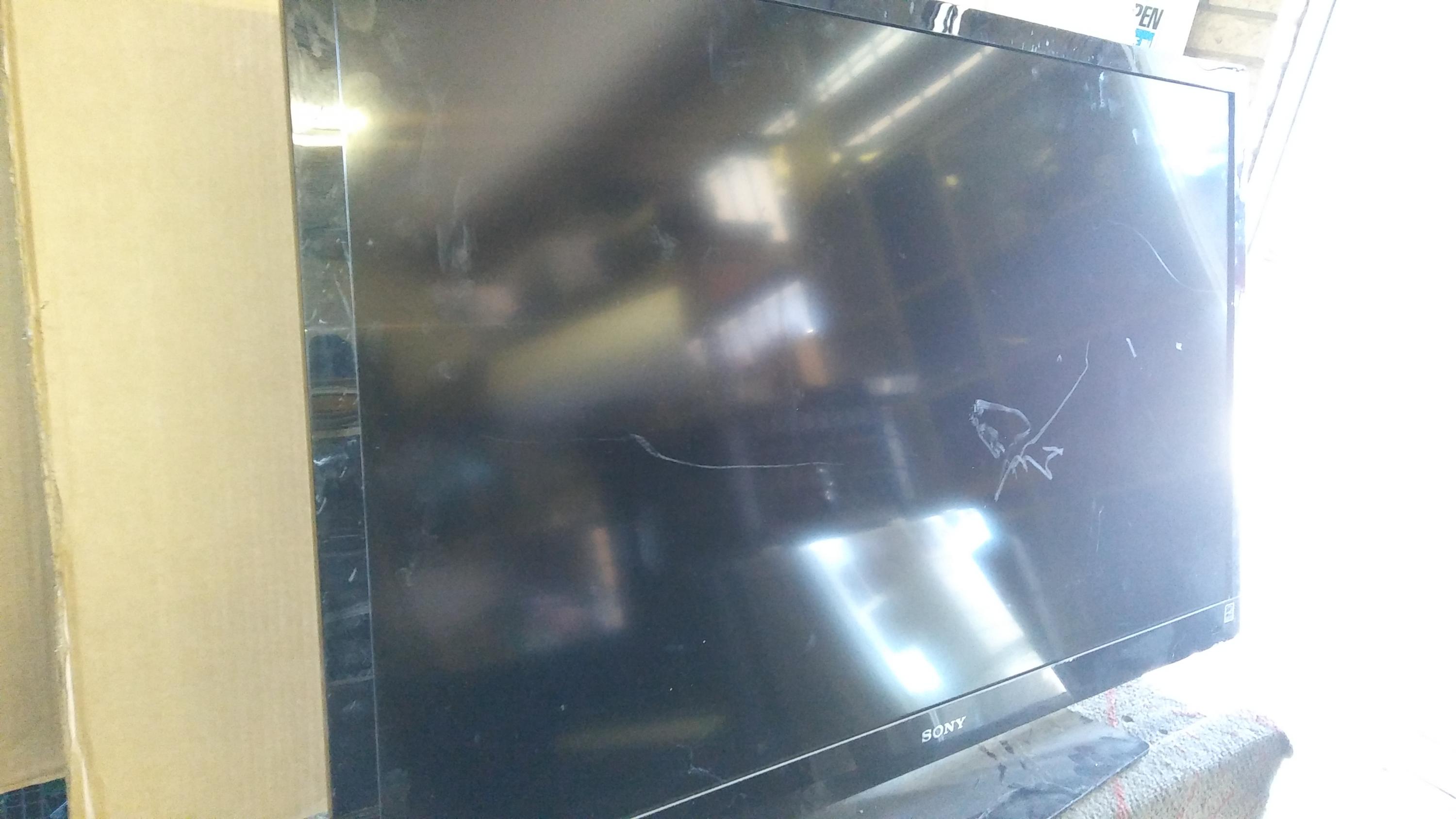

    Sony TV Bravia KDL-46EX723 no power, relay clicked (Feb 2011). which has been thrown in a dumpster.
    Just right now, It took me 10 mins to fix this TV. It take longer to write this Thread.
    Mine is totally different problem from this Thread.
    Sony Bravia KDL-46EX723 - 4 blink code
    https://www.badcaps.net/forum/showth...t=32245&page=2

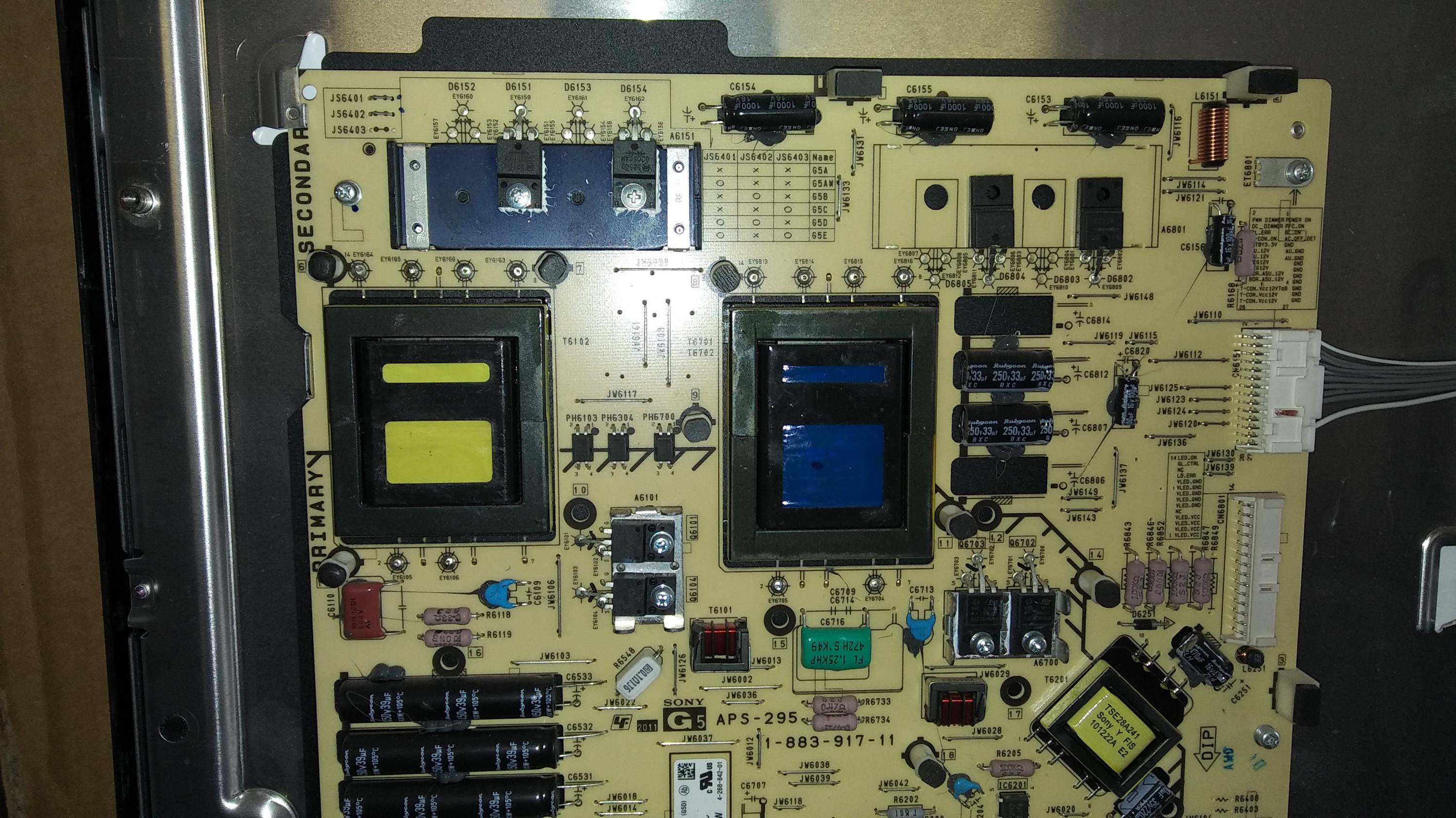

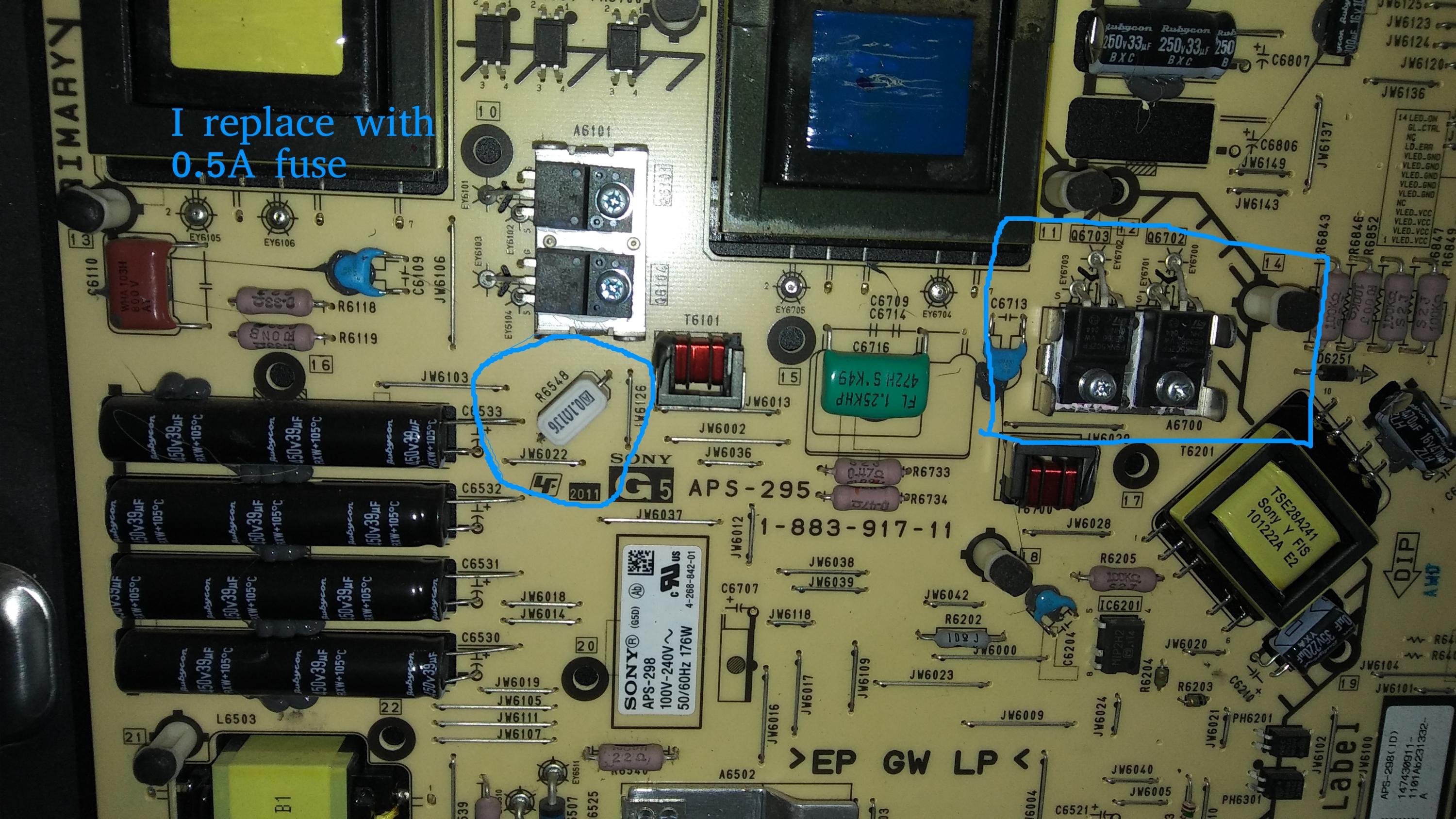

    I thought I could use for parts, then I inspected the screen it seems ok. Found R6548 0.1ohm resistor open (common problems, Sony use resistor as a fuse). Rule of thumb, never put back the fuse, check it out, found 2 Mosfets had shorted Q6703, Q6702 are
    p9nk50zfp. I said to myself, what the heck, they are all the same thing. I grabbed two FETs ( FDP18N50) randomly, change it, and the tv has worked since then.
    p9nk50zfp by STMicroelectronics N-CHANNEL 500V - 0.72Ω - 7.2A Zener-Protected SuperMESH™ MOSFET.
    FDP18N50 N-Channel UniFETTM MOSFET 500 V, 18 A, 265 mΩ
    https://cdn.badcaps-static.com/pdfs/...134f756552.pdf
    Forgot this: R6548 0.1 ohm resistor replaced with 0.5A fuse.

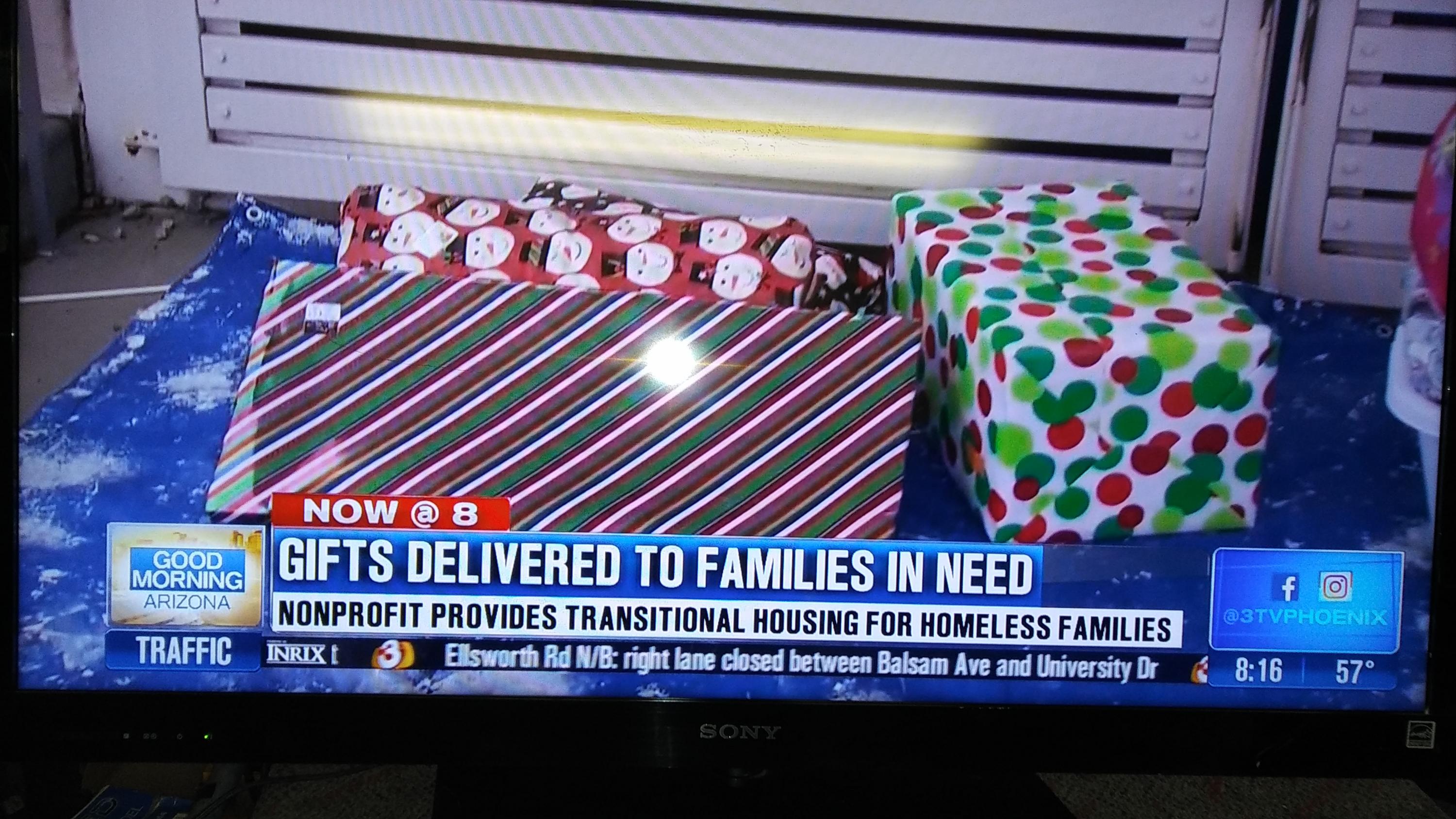

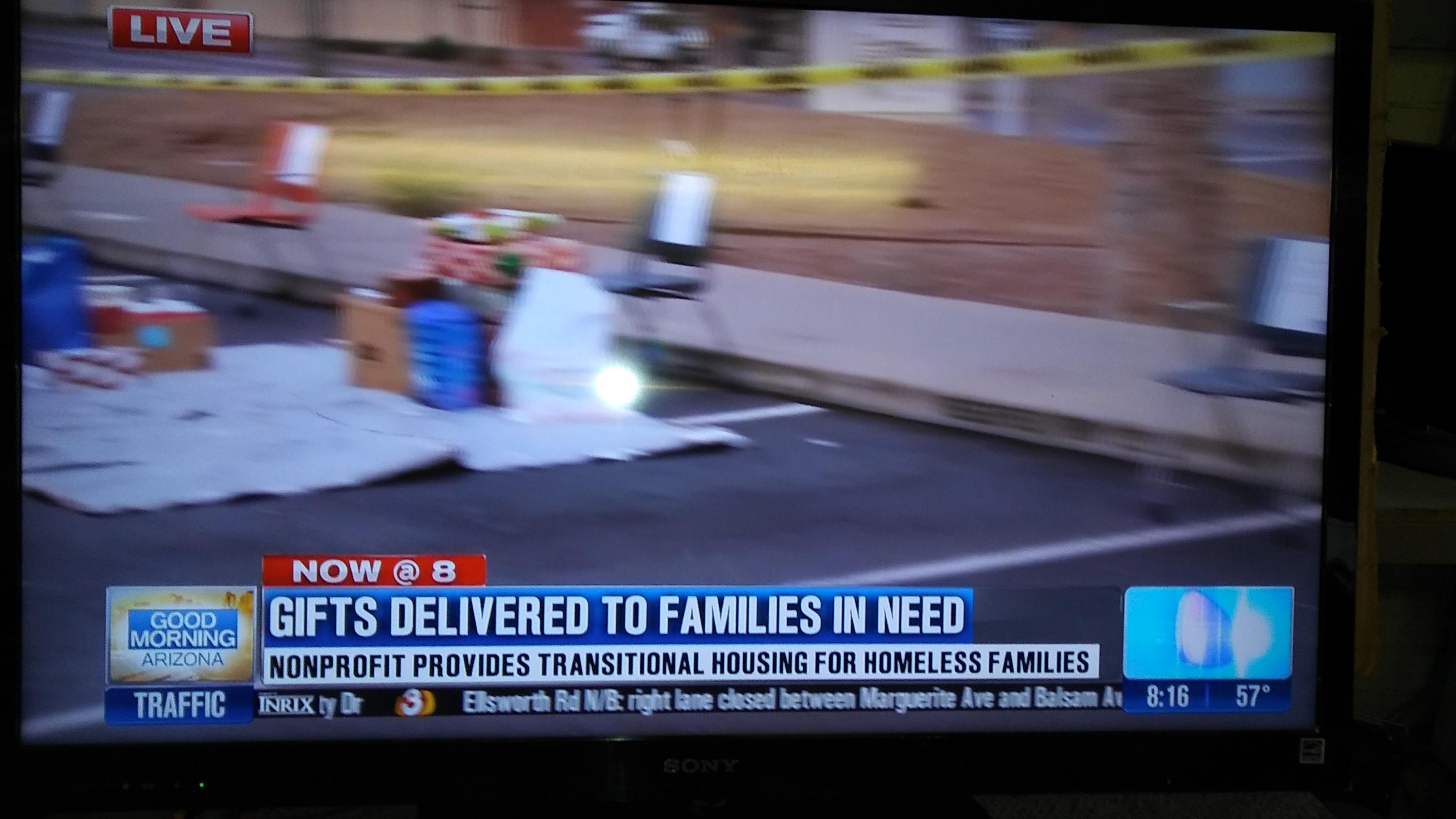

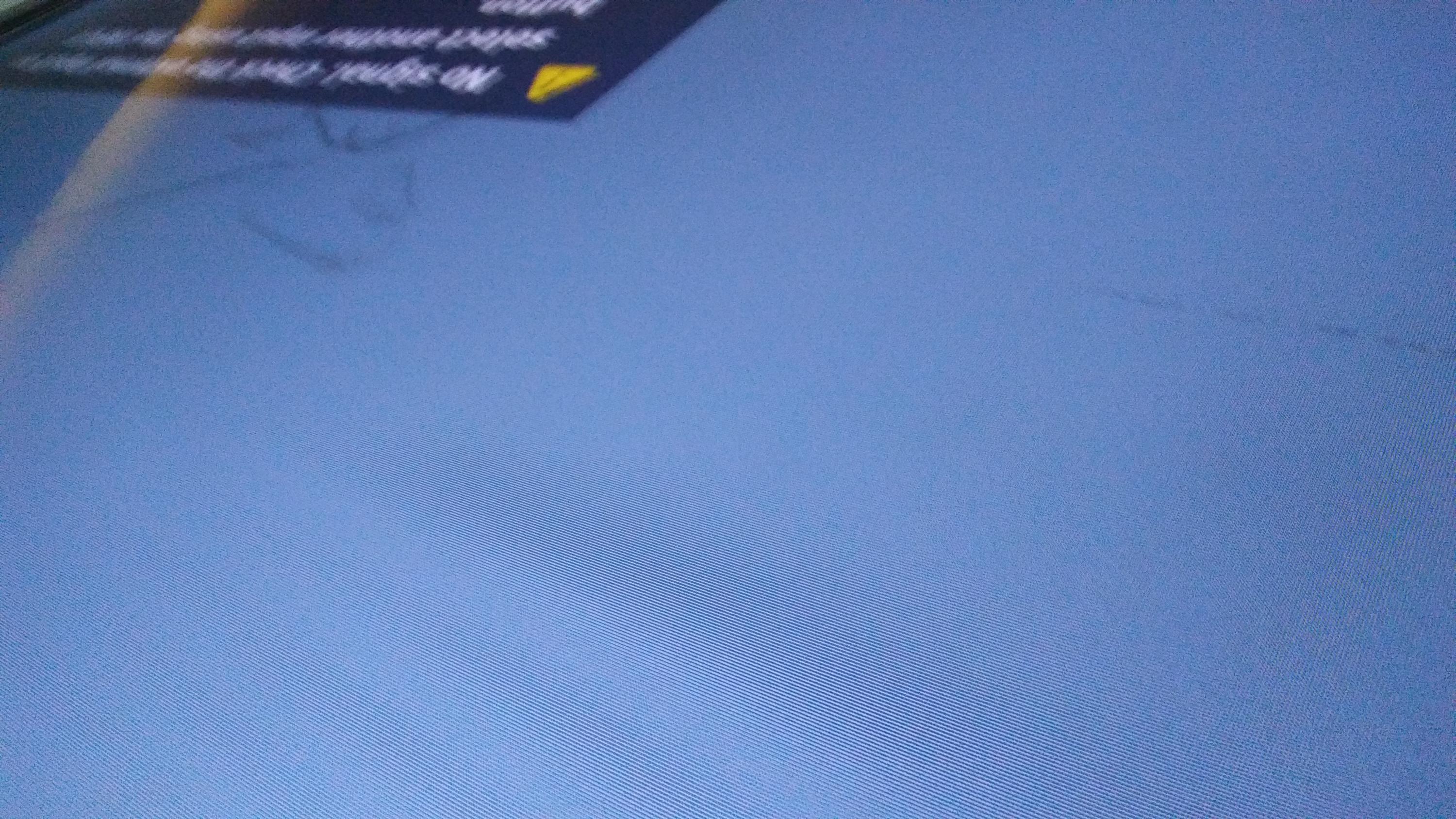

    Update: This Sony TV keeps going on....
    3 parts has been changed
    Q6703, Q6702 : p9nk50zfp sub randomly with FDP18N50 (near to me)
    R6548: 0.1ohm resistor sub with 0.5ma (maybe 1A is better).
    Skype client, WEB browsing, 3D this few functions I don't know how to use, need to order remote first.
    All the nice TV ,I fixed sell it first, kept only the old one for myself.
