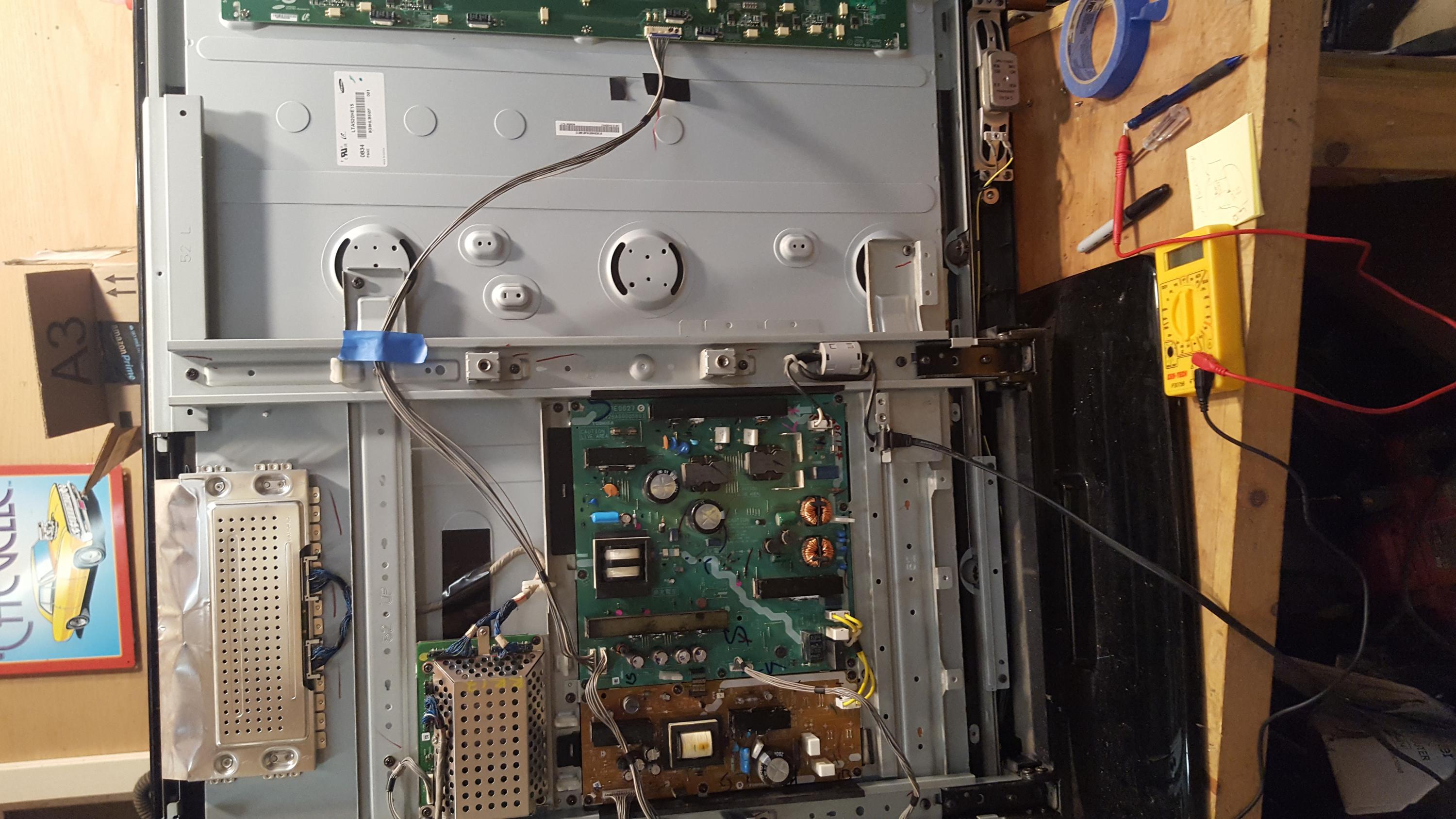

    i have this tv that i can see the menu on the screen but no backlight it has a master and a slave inverter boards i have 5 volts 12 volts and 24 volts were stayed on pc boards inverters have 24 volts on the pins that should be.. dont know if maybe the master inverter isnt working or if the logic board isnt turning on the power supply tv also has sub power supply logic board has connectors from main power and sub dont understand what logic is doing

    Check for small surface mount fuses right next to the connectors on the inverters. One or more may be blown.
      Re: toshiba 52xv545u no back light
      We need pictures.
      Beside checking the fuse, you need to find out if the inverter is getting the command signals or not.

          Where are the pictures I request?
          I do not have the TV in front of me to look to see what boards are being used and how they are hooked up together and what the labels are for the pins of the connectors, etc.

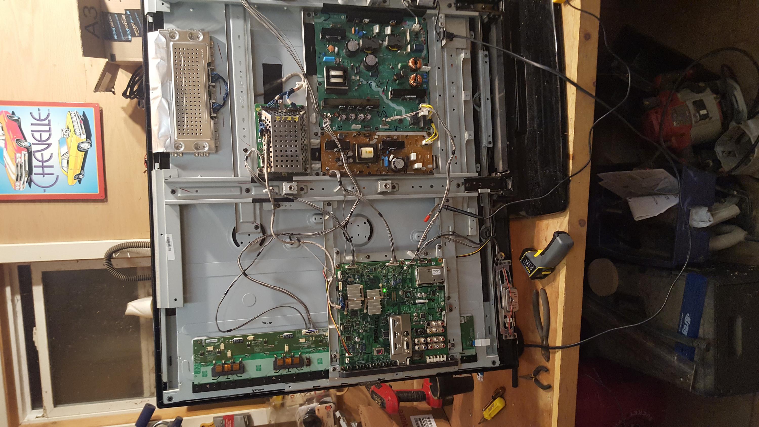

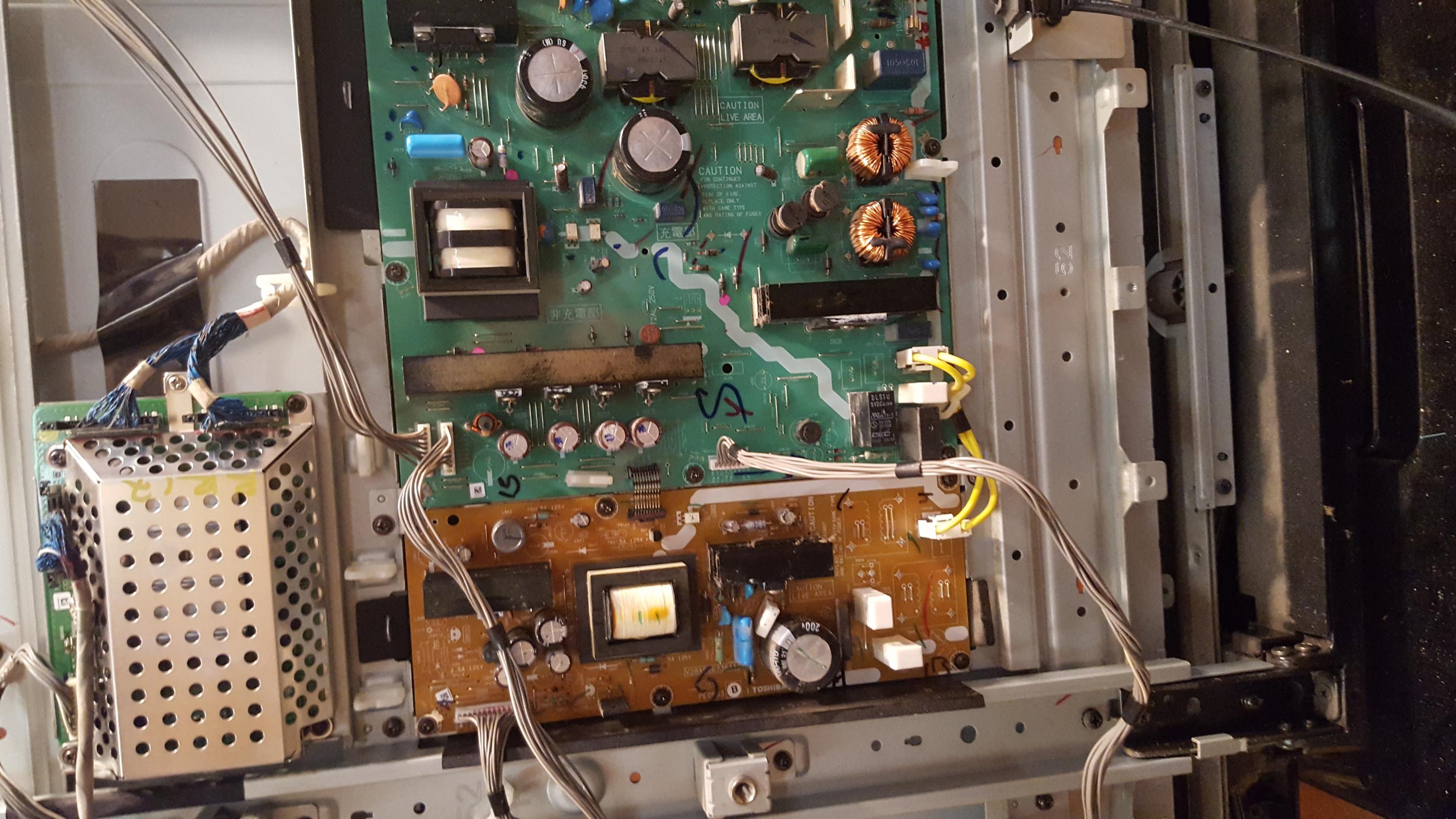

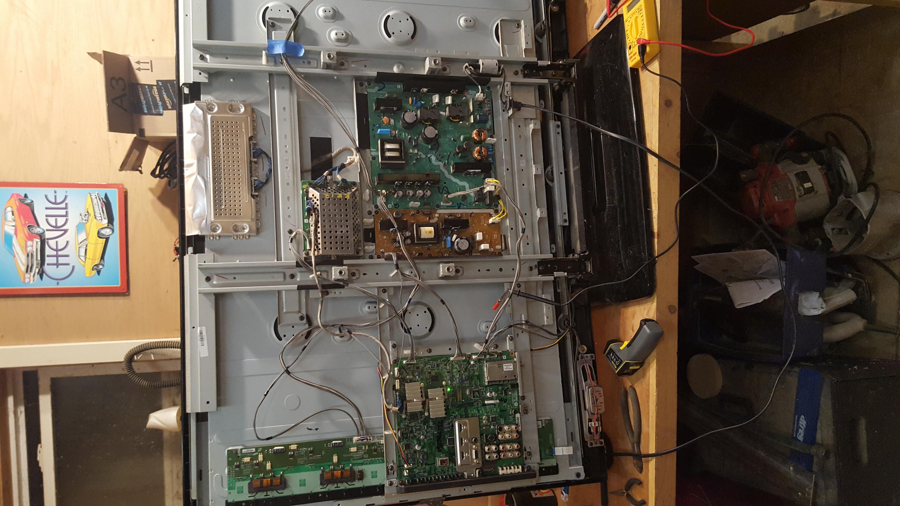

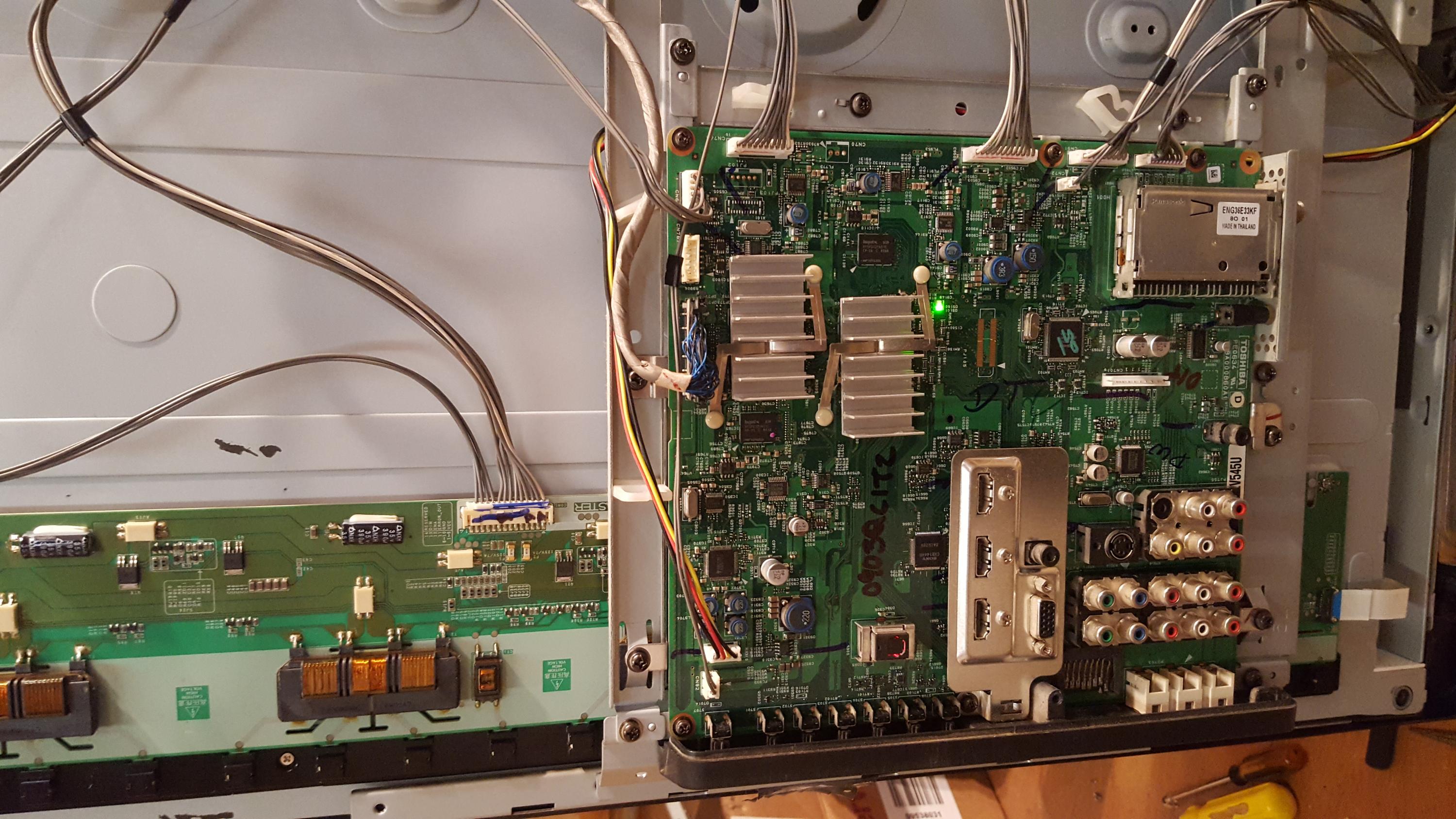

              Here are some pictures of set

                Are the inverter fuses good ? Do you have back light on signal ? You should provide us with this information plenty on this site showing how to test this. I feel like a broken record on here some days constantly repeating stuff that takes 5 seconds to search up.

                  I have 24 volts on small fuses on inverter boards except one on the master good on one side nothing out the other

                    Good, right theres a fault on the master inverter then. You can either replace it or we can help you diagnose it ?

                      What if I bypass the fuse with a wire and see what burns up

                        Sometimes, it's only the fuse. Do you have a digital multi meter? You can check the current draw when powered on by setting the meter to DC Amps and putting a probe on each end of the bad fuse. If it's only the fuse, the set should power on. If it's not only the fuse, you might blow the fuse in your meter or blow something else on the board.
                          I would get the spec sheet of those power MOSFETs used on the inverter board to get the pin out so you can check the resistance between Spin and the D pin to verify.

                            Well I tried the voltage meter across fuse. Sounded like power supply came on and then smoke from inverter board. Found master and slave on ebay. Hope didn't do any other damaged. Plus only had 3.2 volts for inverters. But after unplugging and plug-in back in had 23.8 volts on inverter pins on psu

                              New boards did the trick. Works great now. Thanks everyone
