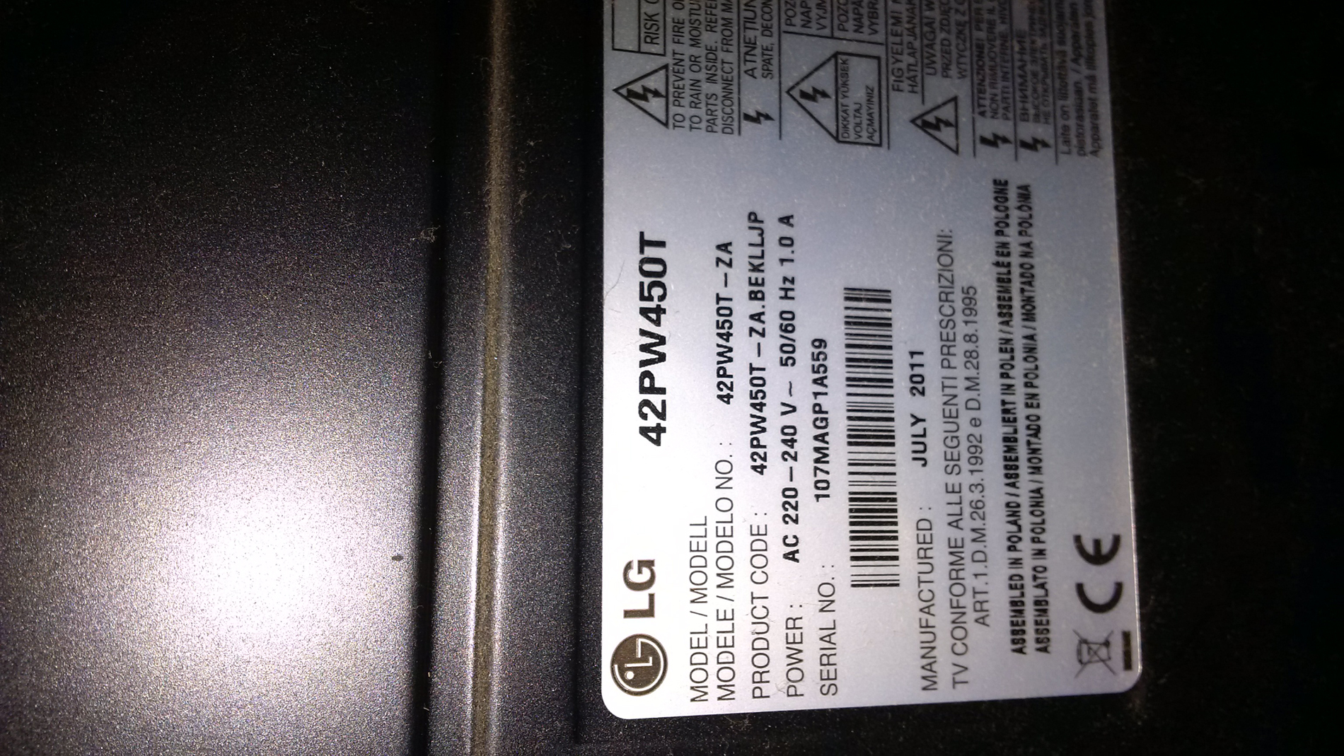

    I have a LG 42PW450T - ZA.BEKLLJP which suddenly would not switch on.
    The remote red flashing light works fine indicating that there is power but the remote will not switch it on and the touch power button does not make any difference.
    I've no idea where or what to check next and would really appreciate some help please.

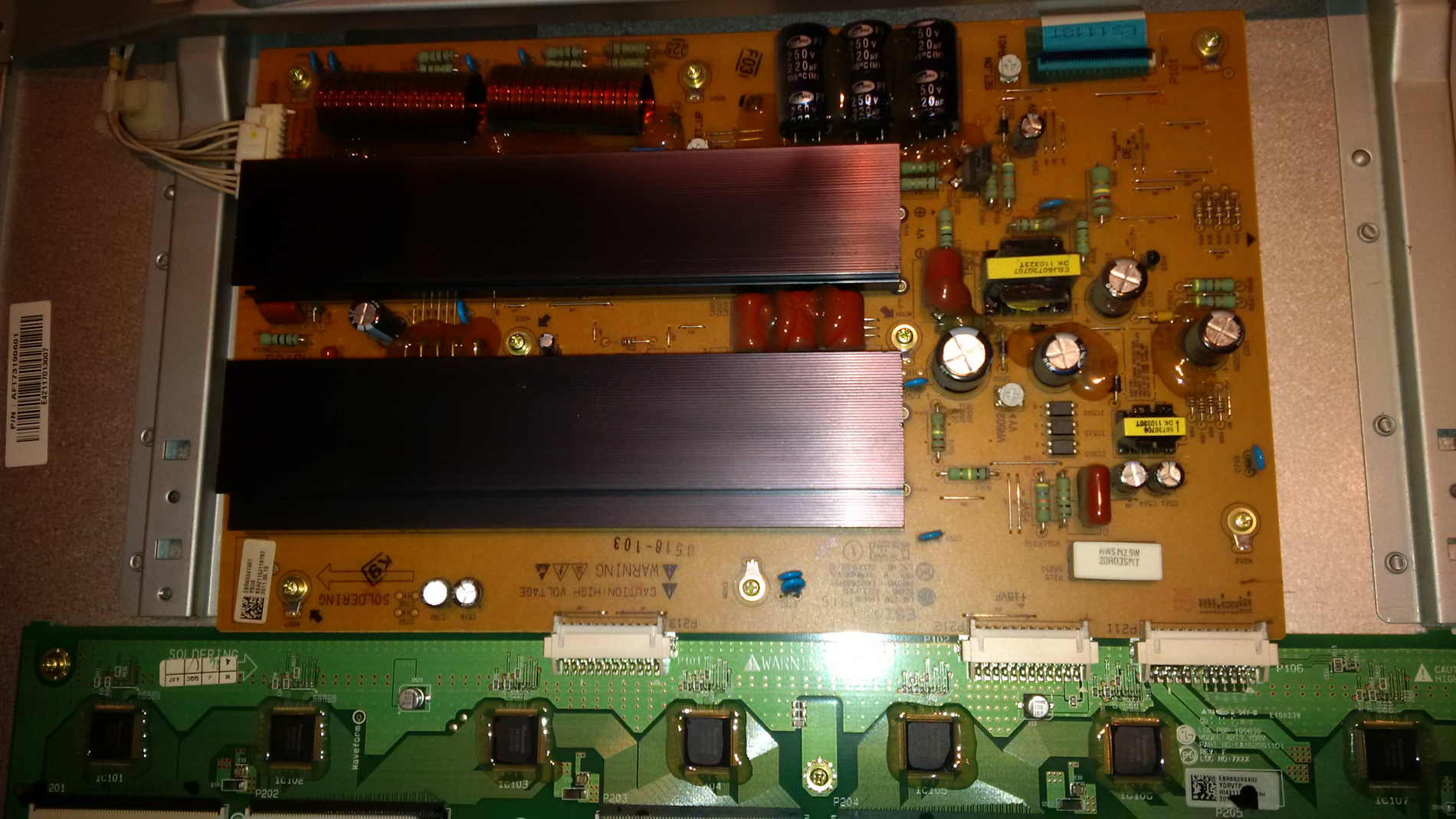

            Re: LG 42PW450T TV won't turn on
            Take pictures with the back off the Tv
            showing all parts this may help you more

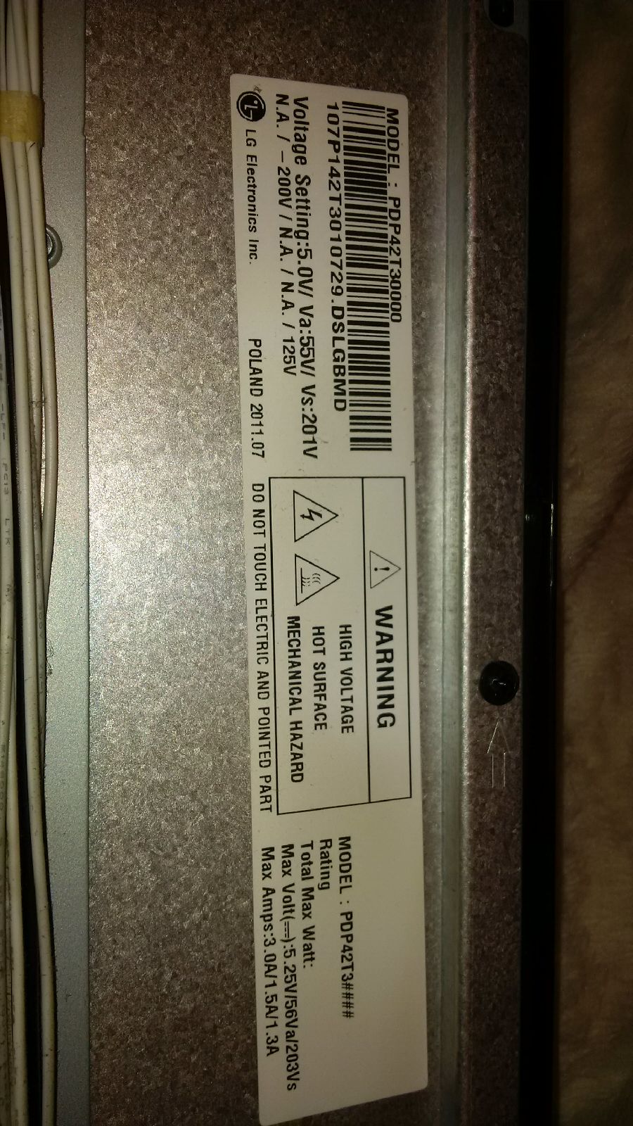

                OK. Do you have a multimeter and know how to use it. If you do then there are voltages written on a label on the back panel of the plasma screen saying what the corresponding voltages should be on the power supply board.

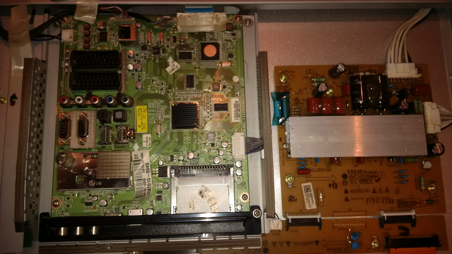

                  I've removed the back of the TV and hopefully attached some images.

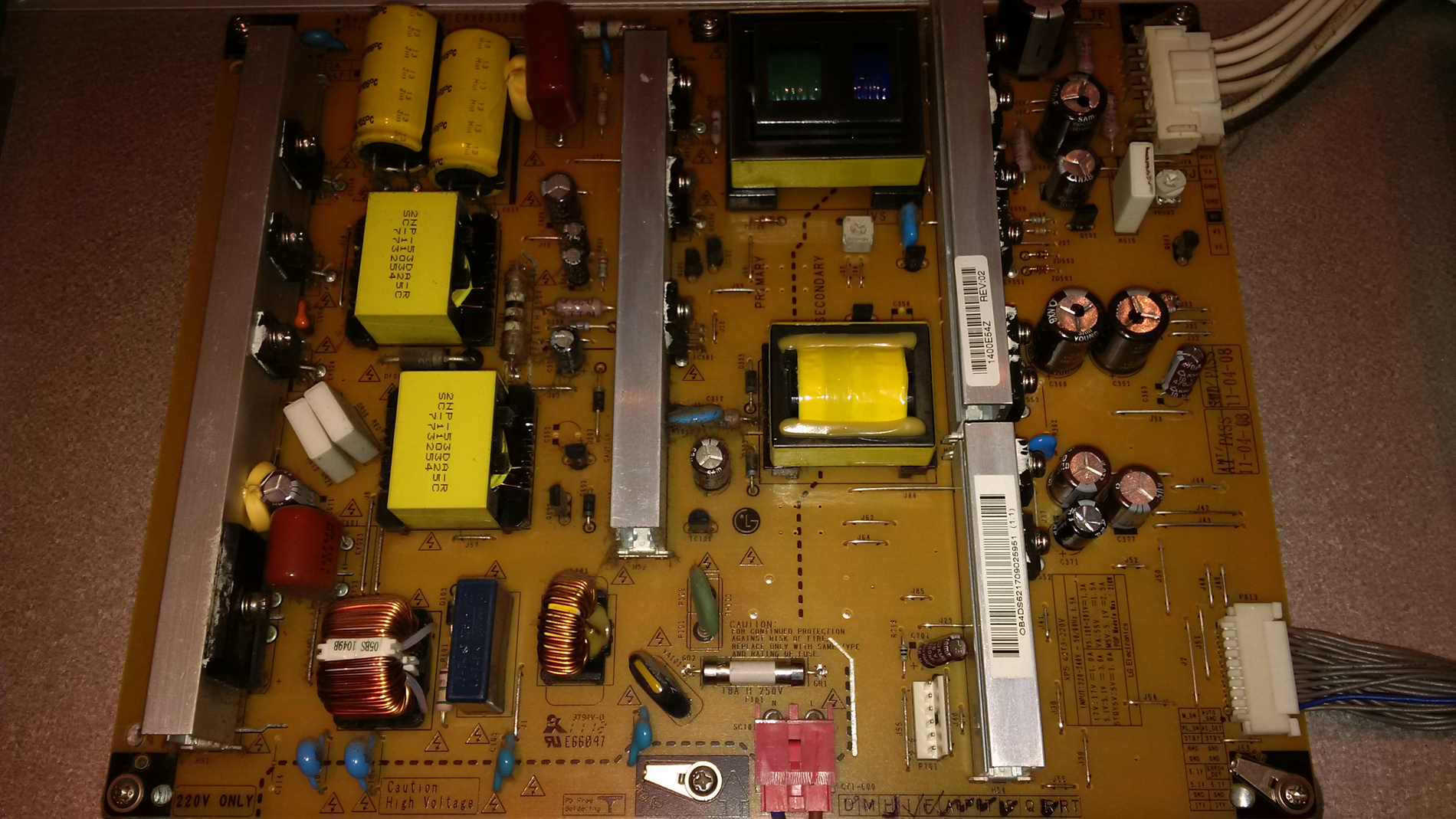

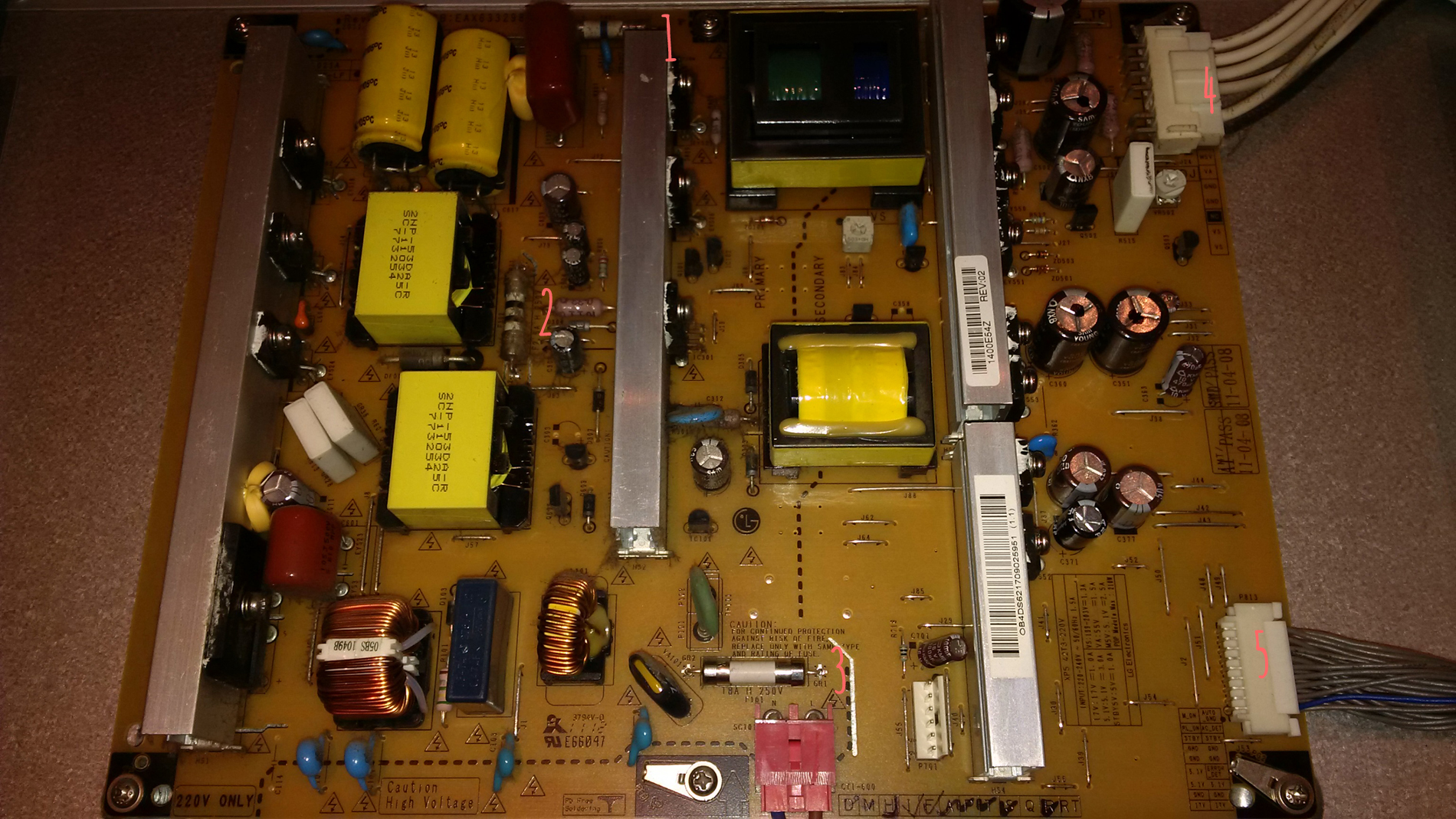

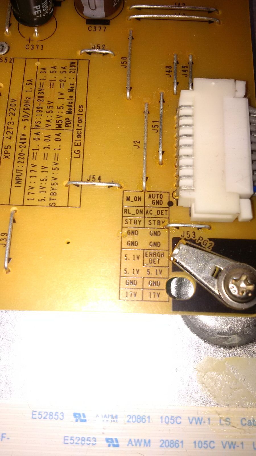

                      I'm afraid there were no voltages on a label on the back panel but I have taken some readings myself.
                      The attached images shows what I think is the main power board with markings 1 - 5 in red type and the readings with the negative probe earthed against the frame are -
                      1 There is 135V AC on either side of this fuse or resister (I don't know what it is)
                      2 There is 135V AC on either side of this fuse or resister (I don't know what it is)
                      3 There is 238V AC on either side of this fuse or resister (I don't know what it is)
                      4 There are 5 pins & they all read zero.
                      5 From the top pin to the bottom readings (DC) are 0.01, 0.03, 3.48, and the rest are zero

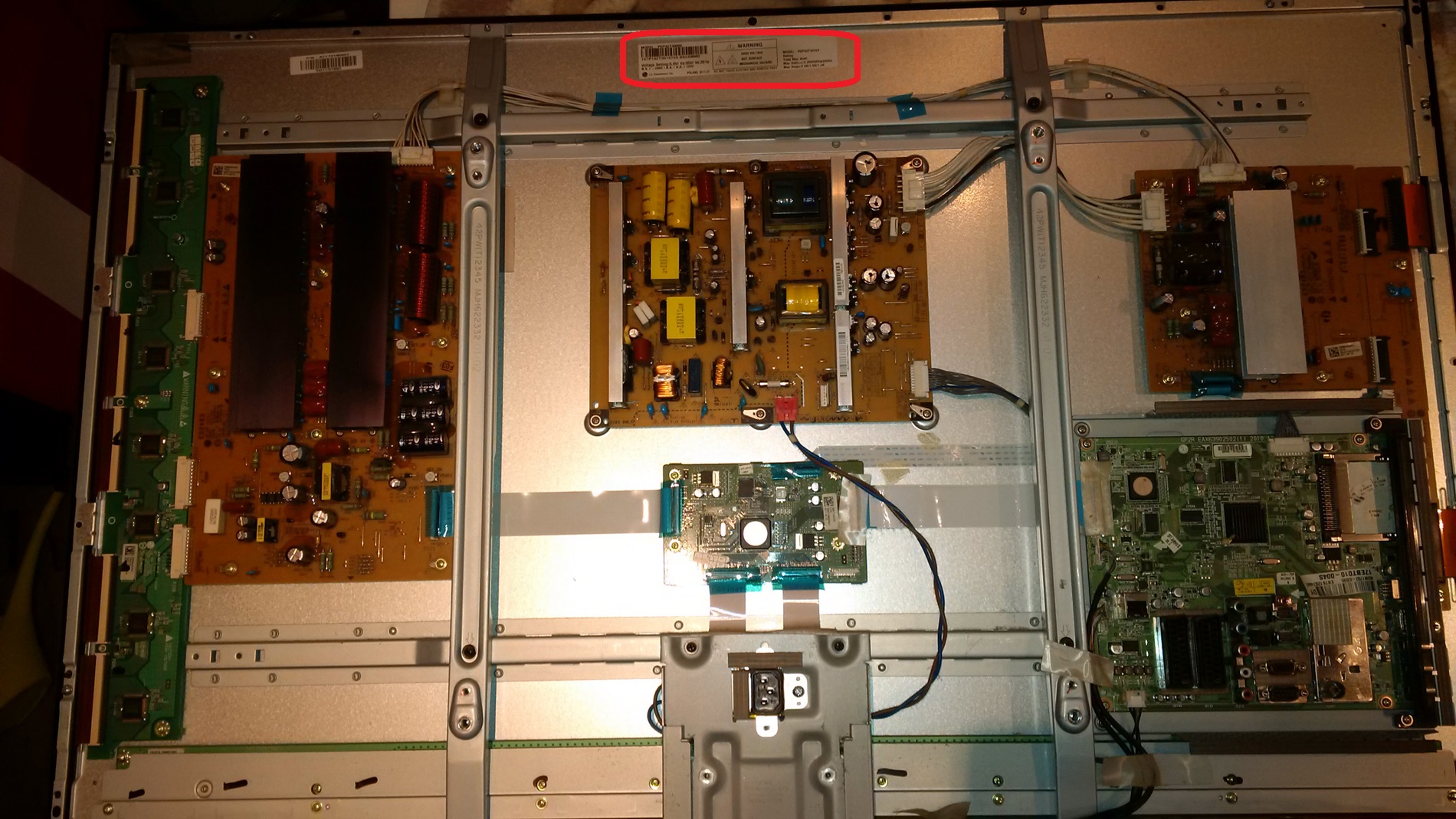

                        Can you post a picture of the label. There are normally test points labelled on the power supply where you check these voltages.
                        • stephenc
                          • Oct 2015
                          • 27
                          Images attached thanks.
                          • dick_barton
                            • Aug 2015
                            • 6643
                            • Wales
                            What do Va and Vs measure on the power supply.
                            Does a relay click in when you attempt to power the set up?
                            The white connector has 18 pins on it which correspond to the legend alongside. Can you give the voltage readings on the 18 pins when you try to come out of standby which may give a clue as to what is wrong.
