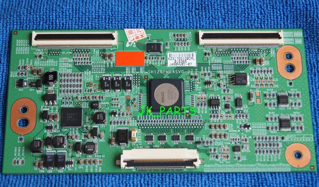

I have samsung 46 inches Led tv. There was no display it showing black screen with back light. i removed Right side panel cable from t-con board it shows half video with some lines and 17Volts on that connector and right connector also. i fix it again and i removed left side cable but when i connect there was no 17Volts in both connectors found on t-con board and its not showing video even half. i have doubt on T-con board. anyone having any idea ?

Where is the test point for that 17VDC? It sounds to me you may have shorted circuit in the LCD panel assembly if you lose the Voltage to the panel when BOTH ribbon cables are connected.Last edited by budm; 12-01-2016, 10:59 AM.Never stop learning

Pin 5,6,7 pins of the connectors (there are two of them that goes to the LCD panel) that goes to the LCD panel? I am talking about between the LCD panel and the T-CON board, not the LVDS connector of the T-CON board that goes to the Main board connector. Is that what you are referring to?
Try checking the resistance between those pins with ref to GND when all the cables in place and when the cables are removed.
As you can see in your picture, two connectors on the top edge of the board, one LVDS connector on the bottom edge of the board.Last edited by budm; 12-01-2016, 07:52 PM.Never stop learning
As you can see in your picture, two connectors on the top edge of the board, one LVDS connector on the bottom edge of the board.Comment

Same resistance reading with and without all the cables in place? What are the values?Never stop learning

BTW, what is the model of this SAMSUNG?Never stop learning

The picture of the board is not clear enough to read the labels of those two pins on the right side, they look like VCOM????
What are the numbers as printed on the barcode sticker of YOUR board?Last edited by budm; 12-01-2016, 08:17 PM.Never stop learning
