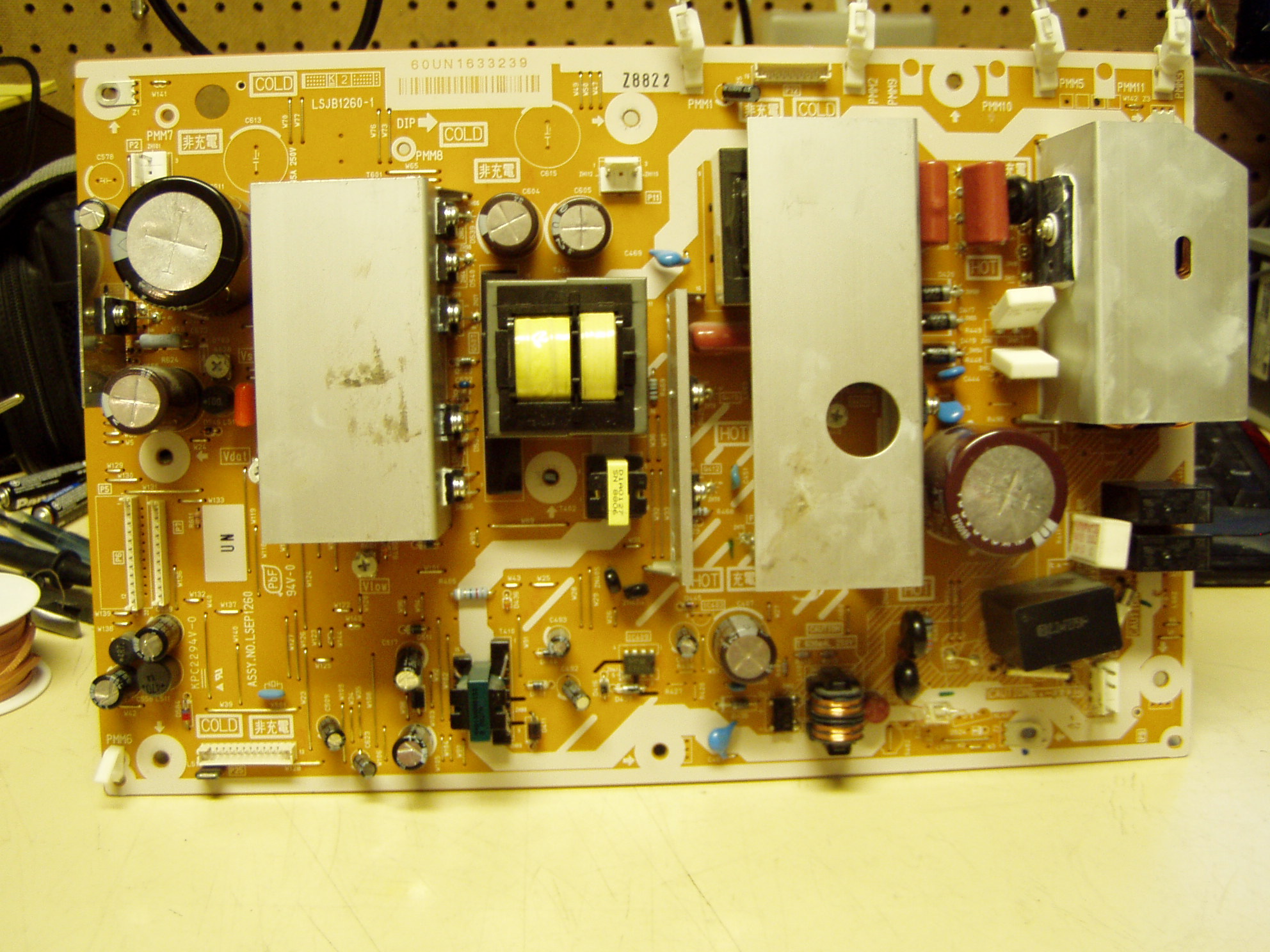

    My friend gave me this tv to repair. I know there was a problem with the psu. I replaced the fuses, the bridge rectifier, the 10 ohm ceramic resistor, and the problematic gate. After I did that the fuses never popped but the tv never lights up. I used the troubleshooting manual for a 42pz80u since that's all I had. So it told me before it shuts down do I have 15v on pins 7,8,9 on p6 and I did. I unplugged a1, a11, and a52 and I still received the same blinks and it still shut down. I'm sure it's still the power supply since I don't get any blinks on the sc or ss boards but the troubleshooting guide points to the a board. Ideas?

    U said u replaced the fuse, rectifier, ceramic resistor, and power mosfet. Only thing left to do is inspect/change the 3 power diodes.

      The three power diodes are reading normal. No shorts. This one has me stumped. I have metered almost everything on the board.

          Thank you Martino. I know I'm not getting any voltage going to the SS or SC boards. But I know I get 15v on pins 7,8,9.

            Double check the components again?

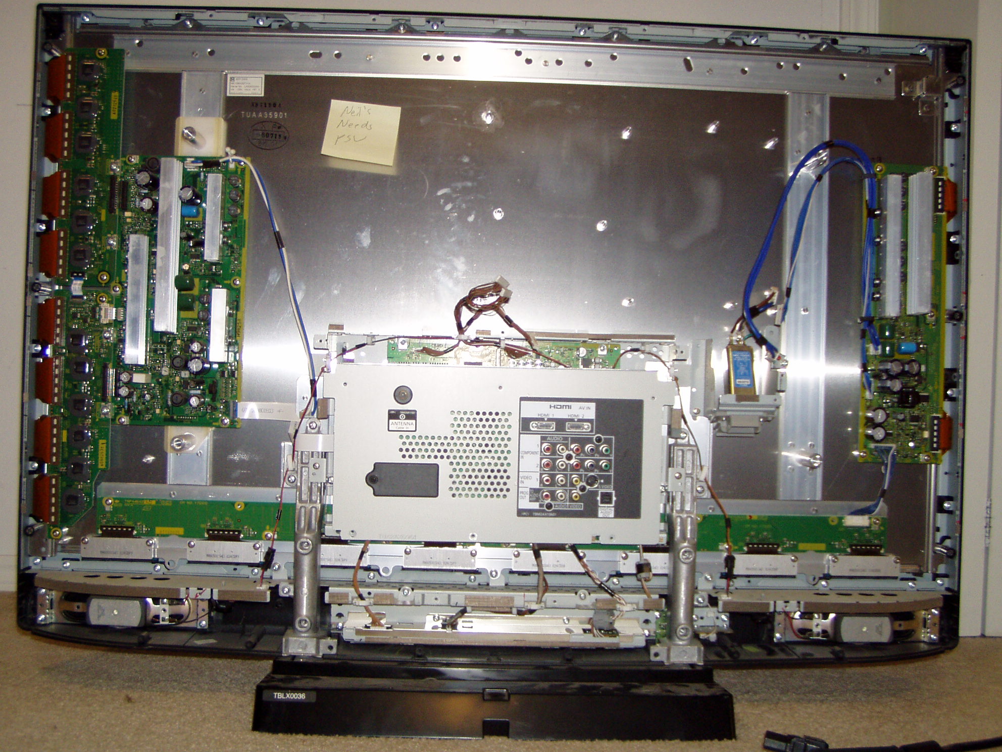

                I have just been reading a few threads on the internet a lot of people who have the 10 blink issue have found its a mainboard issue not a power supply issue.
                Not sure but maybe the 11th generation training manual will help?

                  The OP said the fuse blew on the power supply before replacing it.
                  What part did you replace the power mosfet with? original?
                  Are the ribbon cables seated correctly when you re-assembled?

                    may of been a victim of a lightening strike/power surge and damaged both boards?
