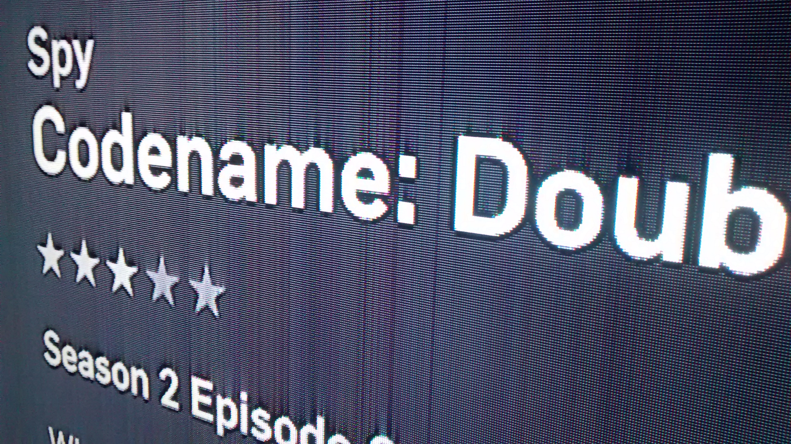

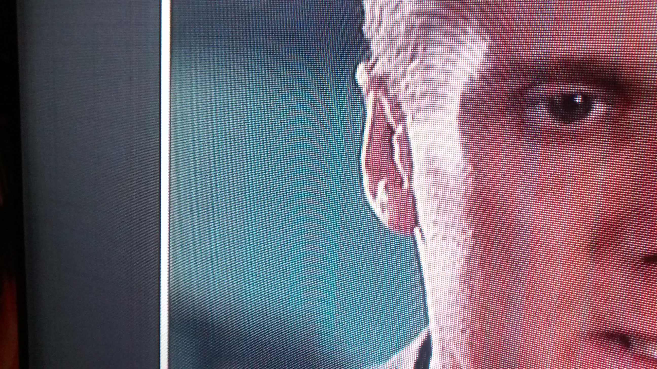

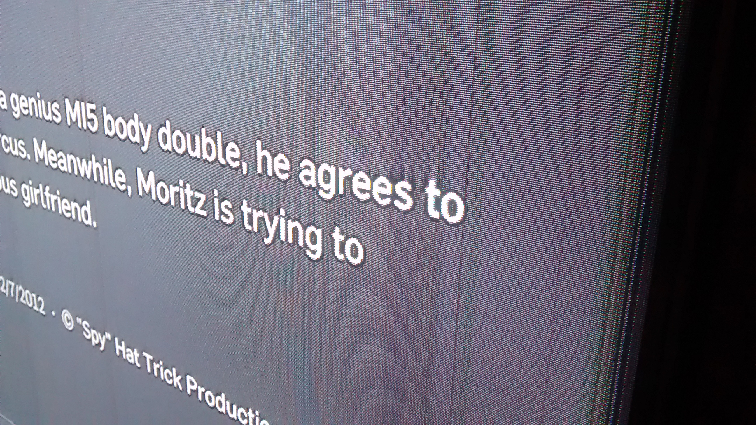

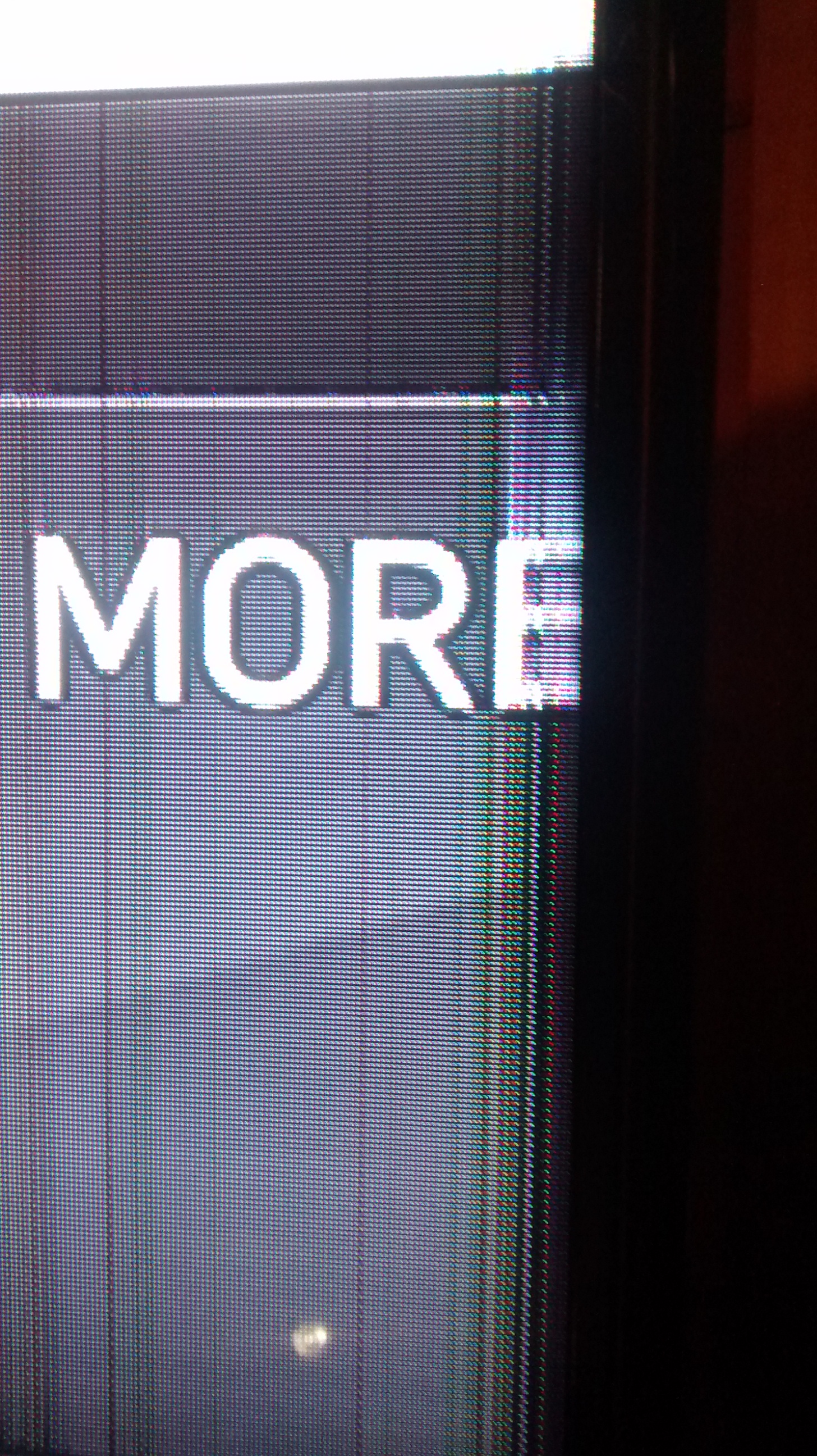

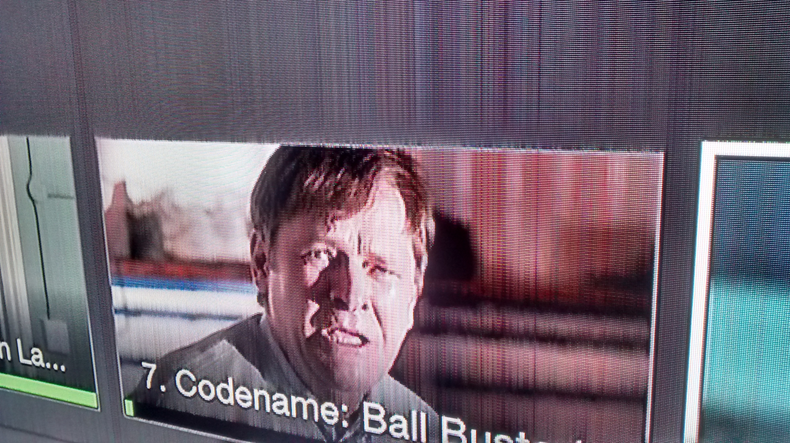

    Samsung un55d7000 vertical lines
    Hey all, very new to this and have these colored vertical lines across the tv. I started by replacing the t-con board and that fixed it for about a week or two. I've searched youtube and forums, including this one, and articles for help. I cleaned the ribbon connections, baked boards, tapped on everything, moved everything, and even tried messing with the bonding tabs and nothing changes. Hopefully these pics will show what I'm seeing and maybe someone can tell me what is causing a working t-con to fail the same way the last one did or if I'm fighting a losing battle altogether. Thanks!

      Re: Samsung un55d7000 vertical lines
      Did you try to freeze the BGA chips on the t-con board?
      You can do that by holding a can of air upside down.(like the pc cleaning cans)
      Spray in short bursts(you will see them freeze over) onto the 2 big chips in the middle of the t-con board while tv is on and observe picture.
      I'm thinking you bought a weak(very weak) t-con board.
          Often with BGA chips(and this looks like a bga fault to me)when you freeze them you get a different result,telling you your on the right track.If that doesnt help can also try to heat it up with a hair dryer,should get worse then.But I always freeze first,quickest and most reliable results.
          btw,if with freezing t-con nothing changes,maybe look at mainboard and freeze any large chips.
            I was wondering if the mainboard might be a culprit since a new tcon only fixed it for a week or two and resulted in the same fault. I'll pick up a can of aie tomorrow and see what happens. Thanks again!
              Often a certain model has a certain common fault. Hence why I'm thinking you bought a weak t-con board.
