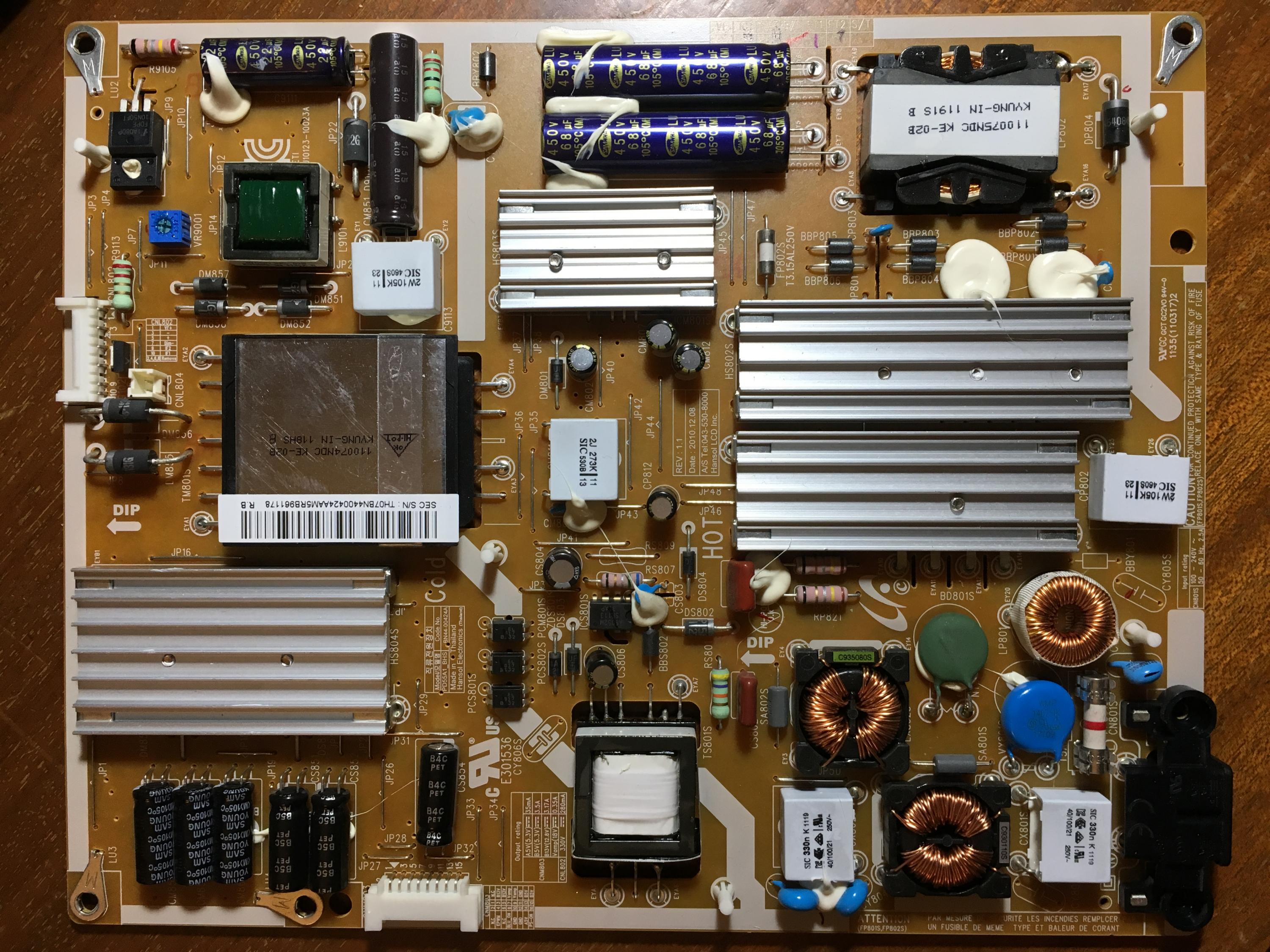

    Hey everyone, I've got a Samsung TV UN55D6003SFXZA that is not working. If I unplug the TV from the outlet, wait a few minutes, and plug it back in, the startup screen ("Samsung SMART TV") appears on the screen for a second before the screen goes dark. At the same time, the standby light blinks 5 times. And then if I try to press the power button, the standby light blinks once each time.
    I did a visual inspection of the power supply board and didn't find any issues. No burn marks, no capacitors that have exploded.
    I disconnected the main board from the power supply board, got the backlight to turn on and stay on, and measured the voltages at CNM803:
    1.) N.C. = 0V
    2.) N.C. = 0V
    3.) B13V = 12.74V
    4.) EPWM = 3.209V
    5.) B13V = 12.74V
    6.) N.C. = 0V
    7.) Vamp = 16.41V
    8.) BLU_ON = 3.005V
    9.) Vamp = 16.41V
    10.) GND = 0V
    11.) GND = 0V
    12.) GND = 0V
    13.) B5V = 5.37V
    14.) A5V = 5.37V
    15.) B5V = 5.37V
    16.) PS-ON = 3.359V
    I think it may be a main board issue? Ebay has one for $200 so I'd much rather buy a new TV.
    Power Supply Board: BN4400424A
    Main Board: BN94-05429D
    Any help is much appreciated!

    So far you have the correct dcv supplies and the control signals.
    So the next thing you need to do is to measure the DCV at each pin of the LED connector, you will leave the black probe on the chassis, red probe on the pin THEN turn on the TV to see what the Voltage jumps up to and then wait for a few seconds to see what it drops down to then turn off the TV, then repeat that with the rest of all the pins of the LED connector.

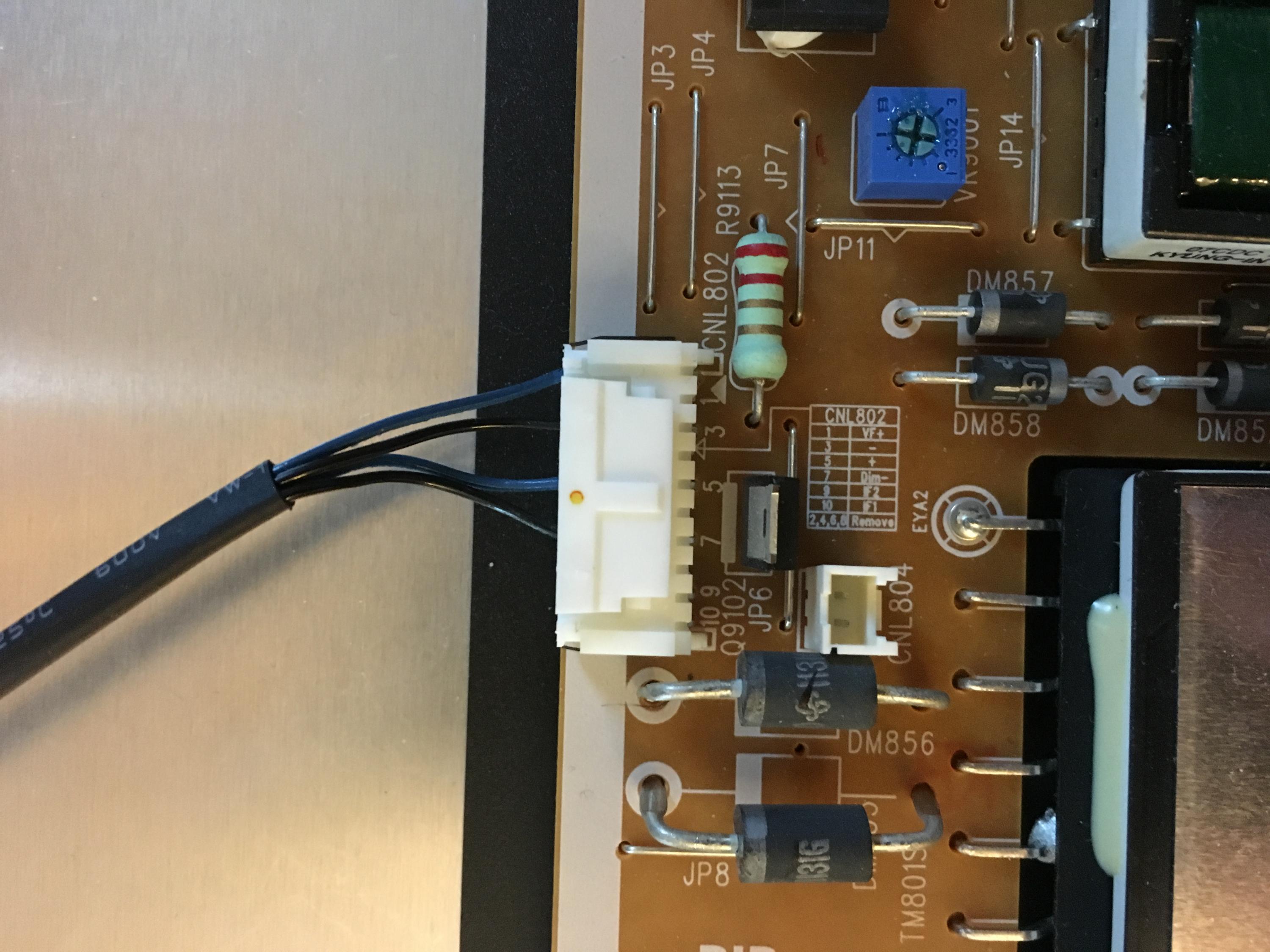

          BTW, I also need a picture of the LED connector with the female connector in place so I can see how many wires are on that connector. So far it looks like it only have one big long string of LED, thus only one LED driver circuit.
          Pin 3 and pin 5 should be the same since it is connected together electrically.
          Vf+ pin 1 is connected to the Anode of the first LED string, the - pin 3 is the Cathode of the first LED string which is then connected to the + pin 5 which is the Anode of the second LED string, the DIM- pin 7 is the Cathode of the second LED string which is the return line to GND through the power MOSFET Q9102 and the current sensor resistor R9113 to Gnd.
          So after the backlights flashes on the Voltage at VF+ is staying steady at 297VDC as long as you do not turn off the TV?
          Per DC Voltage chart on the board, the LED supply Voltage is 330VDC, it sounds like you have some shorted LEDs.

            Re: Samsung UN55D6003SFXZA not working
            Transformer TM801S solder connections look good to me.
            See the attachment for a picture with the LED connector in place. 4 wires on that connector coming in to Pin 1, 3, 5, and 7.
            When I plug it in, VF+ reaches 328VDC, backlight is lit only for a second, and VF+ drops from 330VDC down to 297VDC as long as I don't unplug the TV.
