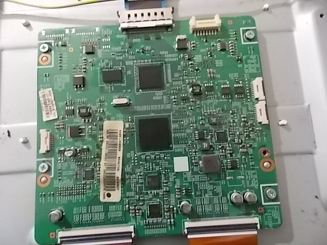

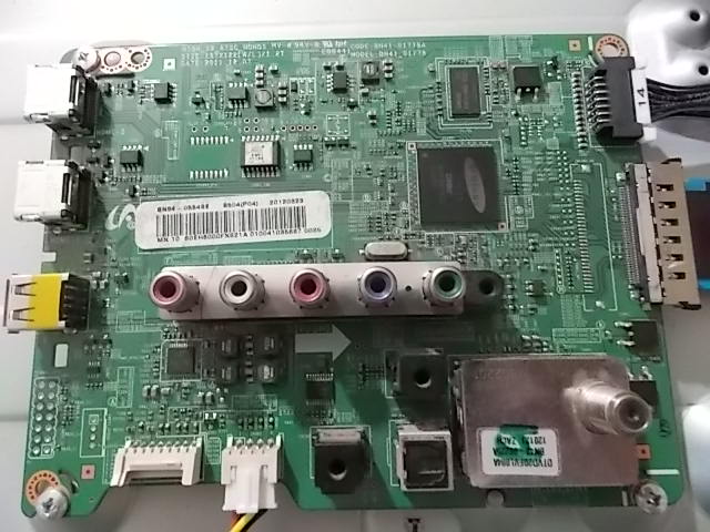

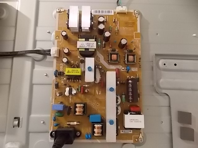

                                  OK I checked for voltage on the Tcon board.. The main board is getting 12 volt to the Tcon. I unplugged the tv, unhooked one side of Tcon going to Panel, turned set back on still just a light blue screen, did the same thing on the other side. Same thing. So is that good news? just a Bad Tcon? Here are some pictures of the set. If you need voltages I can get those too.
                                  • taft1957
                                    • Oct 2013
                                    • 95
                                    Re: Samsung LED TV UN60EH6000F NoVideo
                                    Here are pictures of Samsung UN60EH6000F

                                      defently sound like a t con fault maybe if you cant find one at a good price look into if anyone offers a repair service for it.
