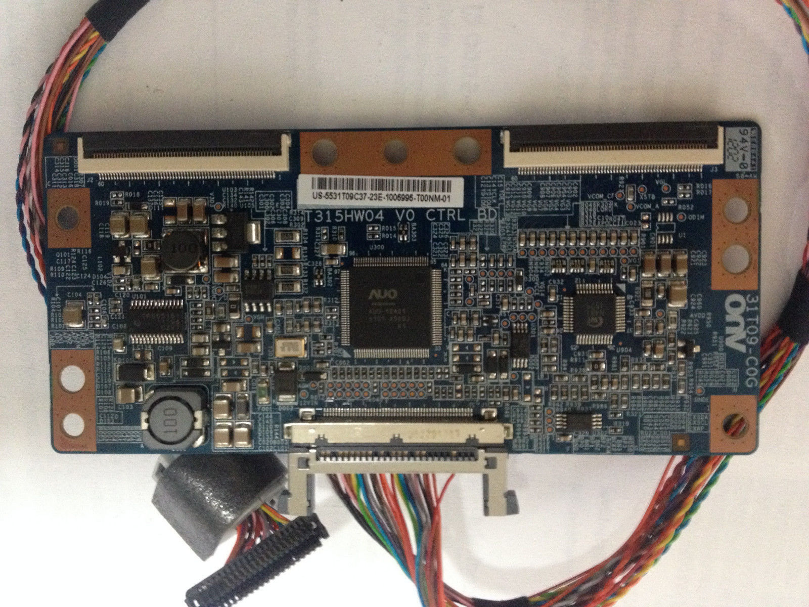

    I have a Samsung UA40C6900 with washed out picture. is it a T-con board issue or panel issue?
    Also, what is the fault when the whole screen is white with no picture at all?
    Thanks all.

    gamma ic on t con board? can you upload a good clear picture of the t con so we can see what ic it uses

      Check the following Vdc on the T-CON Bd:
      1. VGH/Von: 20~30Vdc
      2. VGL/Voff: -5~-8Vdc
      3. VDA/Avdd: 3.3Vdc
      4. VDD/Vlogic: 13~20Vdc
      Your measured voltages should be very close to these values.
      This problem can also be caused by a 'bad' Panel.
      Does your screen carry both X and Y TABS maybe we could try a 'bypass' method?
        I think it has this T-con board.
