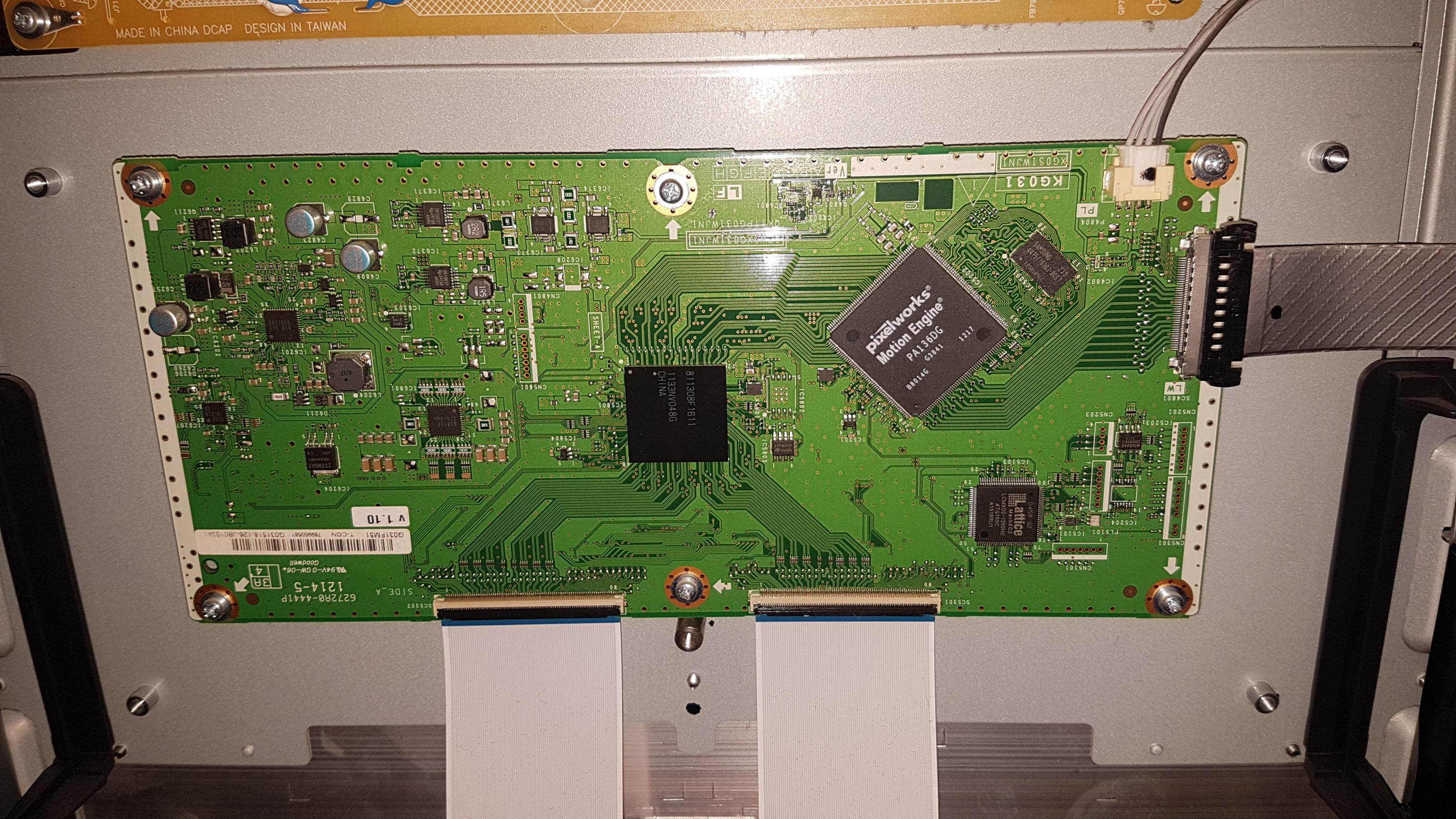

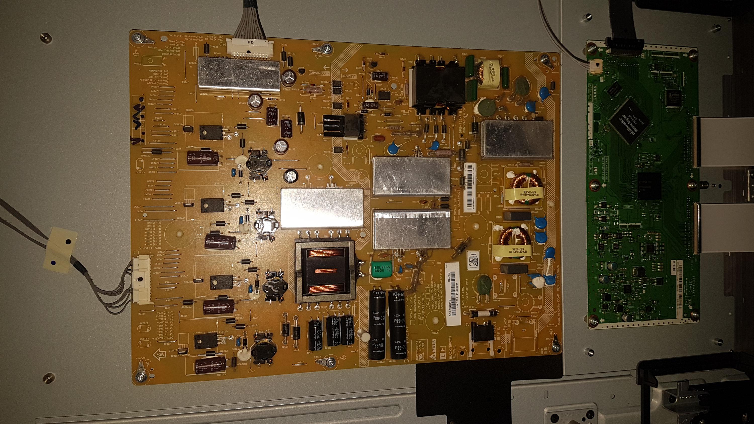

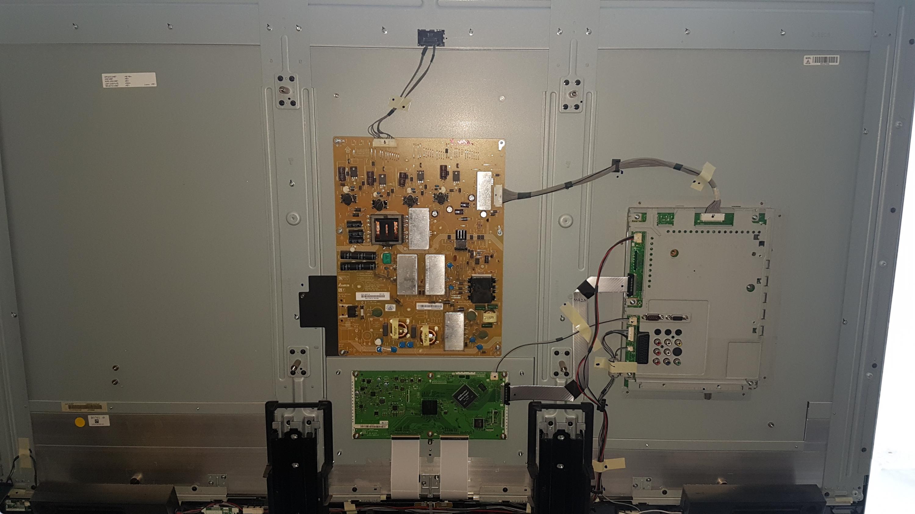

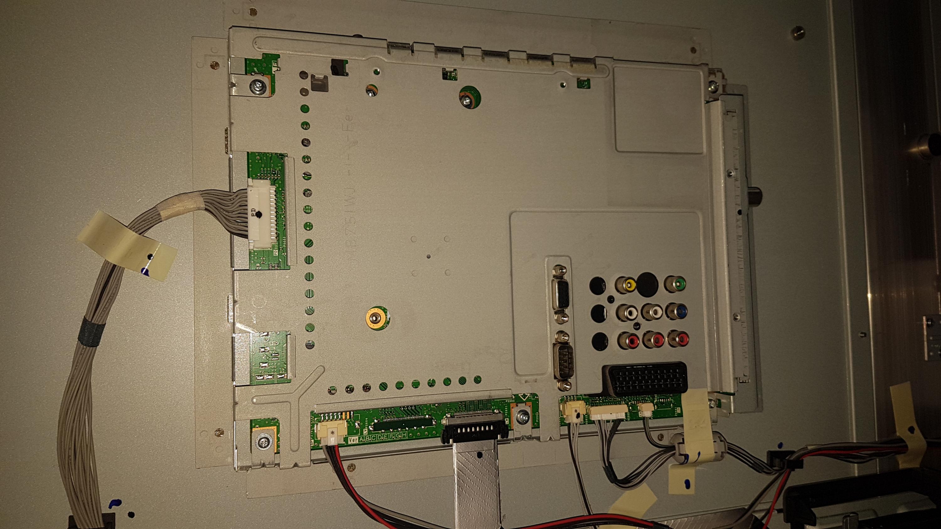

    Hello
    got this tv today picture is perfect then once the tv warms up after 10 minutes you have a loud and i mean loud screeching noise which im thinking is the speakers and the pictures will then go off
    has anyone come across this fault before ?
    uploading pictures as we speak
    thanks

      Can you monitor the audio supply and see if that is dropping possibly due to a fault either in the audio circuit or power supply itself.

          Does anyone have a schematic for this power supply i cant seem to find anything RUNTKA935WJQZ DPS-171CP A
          update: its definitely the speakers thats making the loud noise sometimes it does that or just the backlights that switch off voltages on backlights start at 100 volts then drops to 62 volts but steady
          • sordids999
            • May 2013
            • 2149
            • uk
            Re: Sharp aquos lc-60le741e
            update:
            fingers crossed
            reflowed the BGA and tv has been working over an hour now
