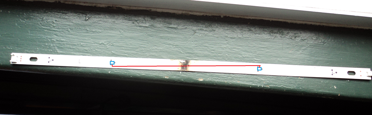

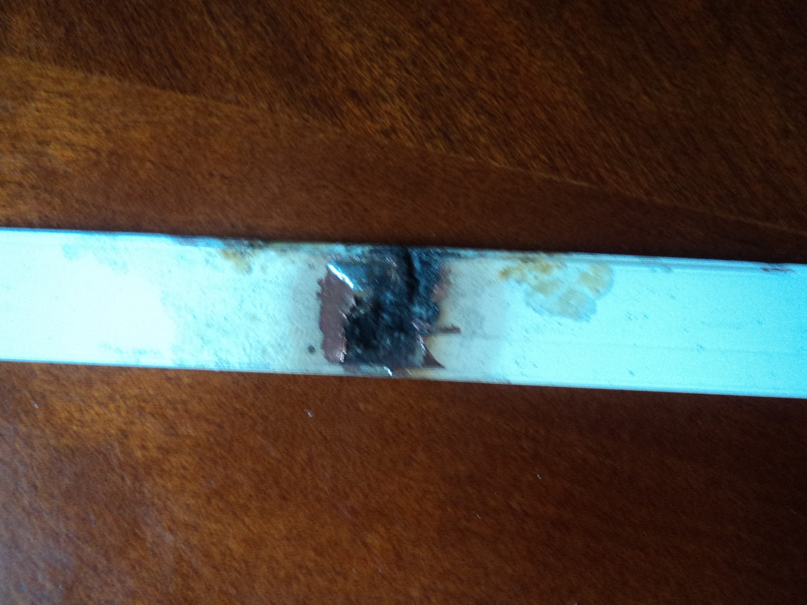

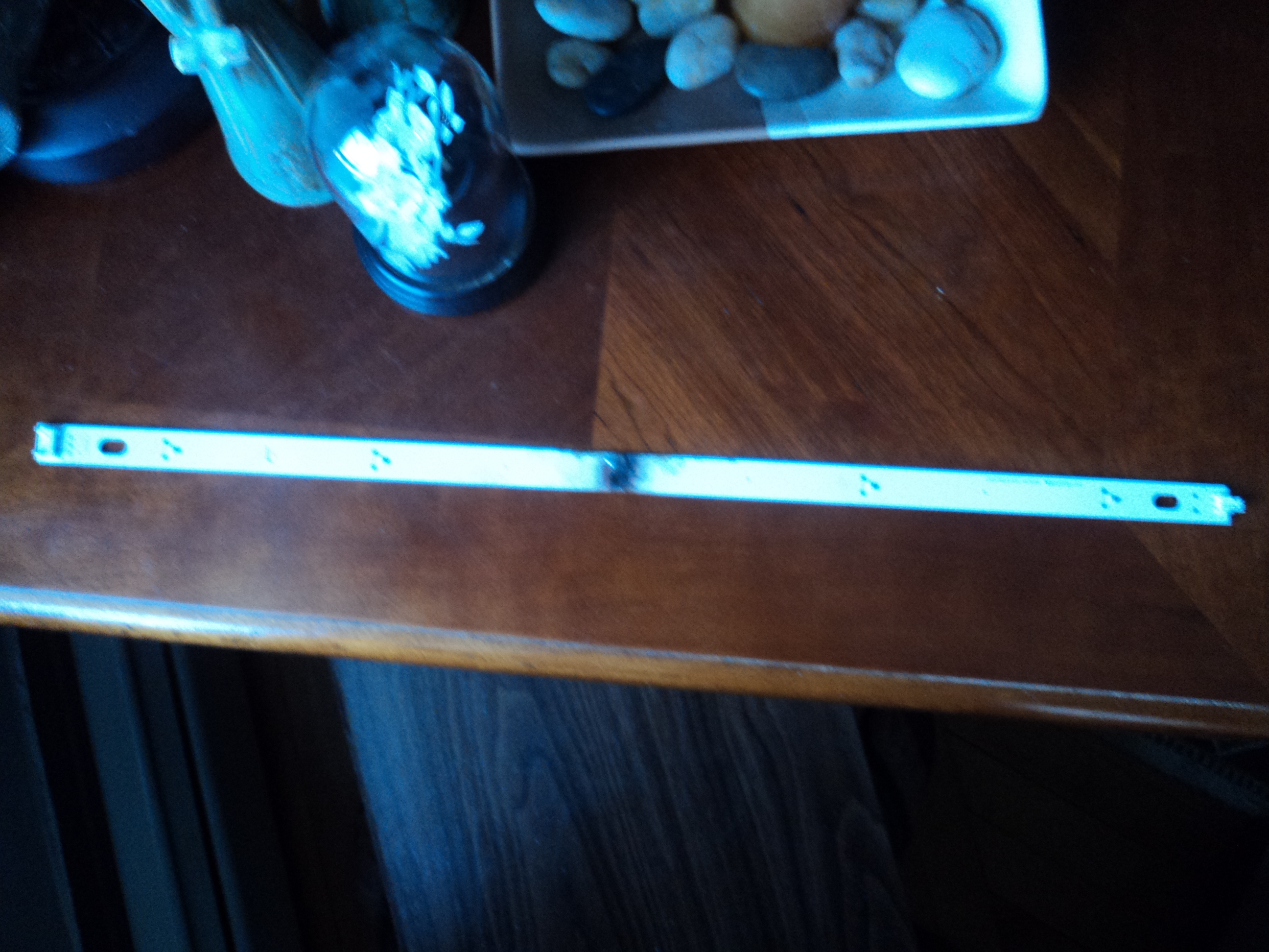

    Hi guys i'm in need of LG 50LN5100 back light strip, L
    HEESUNG HC500DUN-VCF1-11xx
    LG Innotec Polar A2.0 Revo.0.0.L typo 2013.02.07 GC 3V vo 94V-0 1316
    since i can't find the exact #, is there any of those that are available i can use? ,thanks in advance

    You could repair the strip using the stacking method.

      New LED strips are not available at all.
      Best you'll get (IF you're Very lucky) is one from a duff/cracked screen set, with X hundred/thousand hours on it.
      Best fix is to get just the strip--from any large screen LG and cut it up for the LED's complete with lenses, remove the original and fix the replacement piggy-back style using heatsink plaster.
      Like all LED sets, Regardless of make--They are Utter Crap, designed to fail--so when fixed--Turn Down backlight to minimum--or you'll be fixing it again in a few weeks when another pops it!

        Re: LG led Strip please
        hi Hamie is this what you're talking about?
        https://www.youtube.com/watch?v=RxwdC7V5Ue0
        Wouldn't be easier to get these leds instead of doing the stack fix?
        http://www.ebay.com/itm/15-pcs-Diode...3D322299906380
        do yo know if these leds are good for my LG 50ln5100 ?
          Hi guys ; do you if this will work?
            You accidentally the whole question
            That could / would work, but on one hand, you'll have a dark spot where the LED's missing, and the whole rest of the strip will end up being slightly brighter than before / the other ones.
              That will also cause the other leds in that strip/series to fail prematurely and most likely with in short time.
                Thanks guys; i thought so.
                  Hi guys; forgive me to be so presistent on this ,I was thinking of ordering those leds and try repairing this strip, maybe punting some silicon paste to cover the hole and burn then solder wire pig tails to the led and solder it to the strip right in place and to get it firm to the strip maybe use some glue, what you guys think?
                  Also i was thinking to buy from amazon,are these the same as the Ebay?
                  https://www.amazon.com/Chanzon-100pc...QF59SV1JBGVEWP
