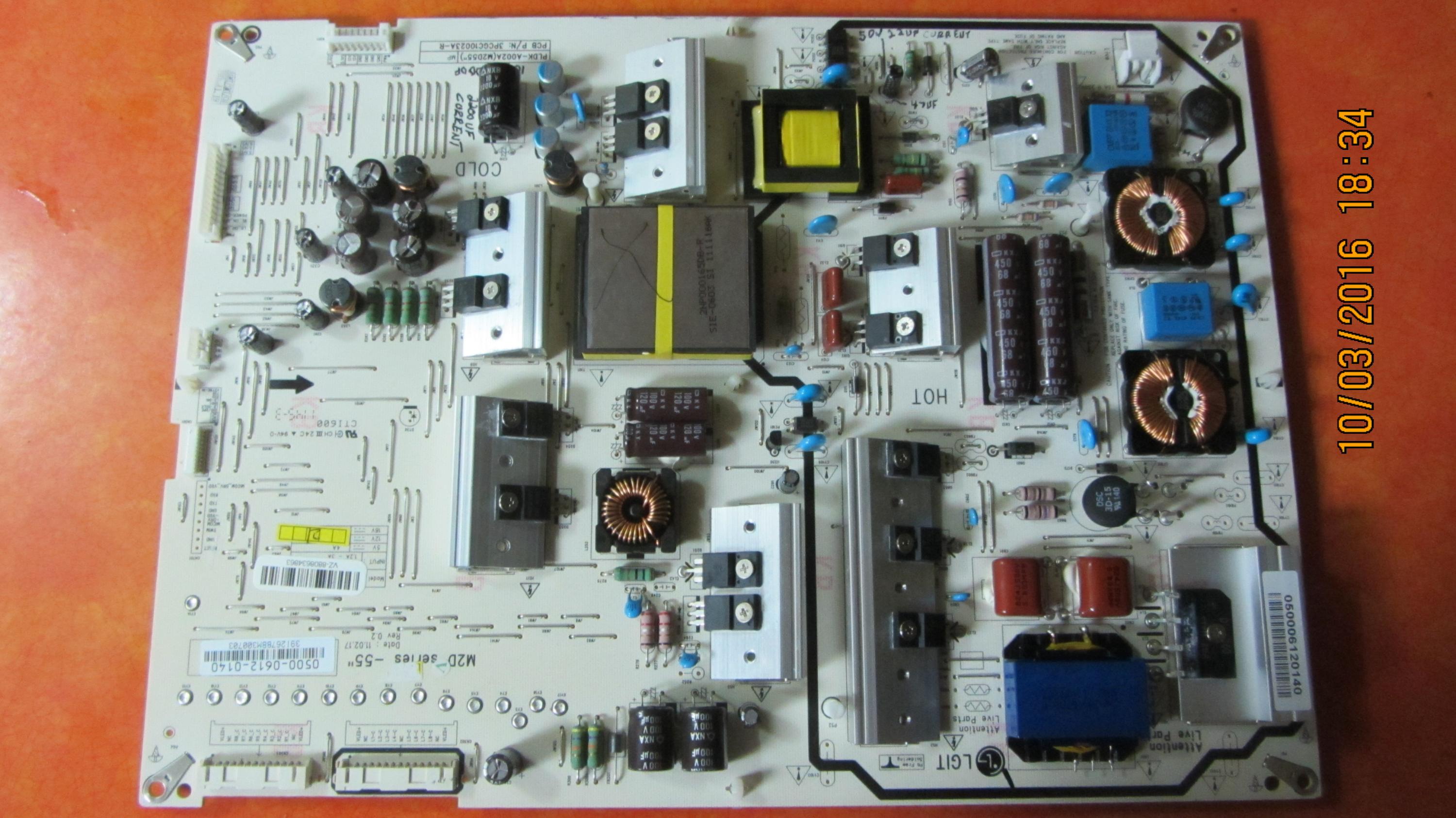

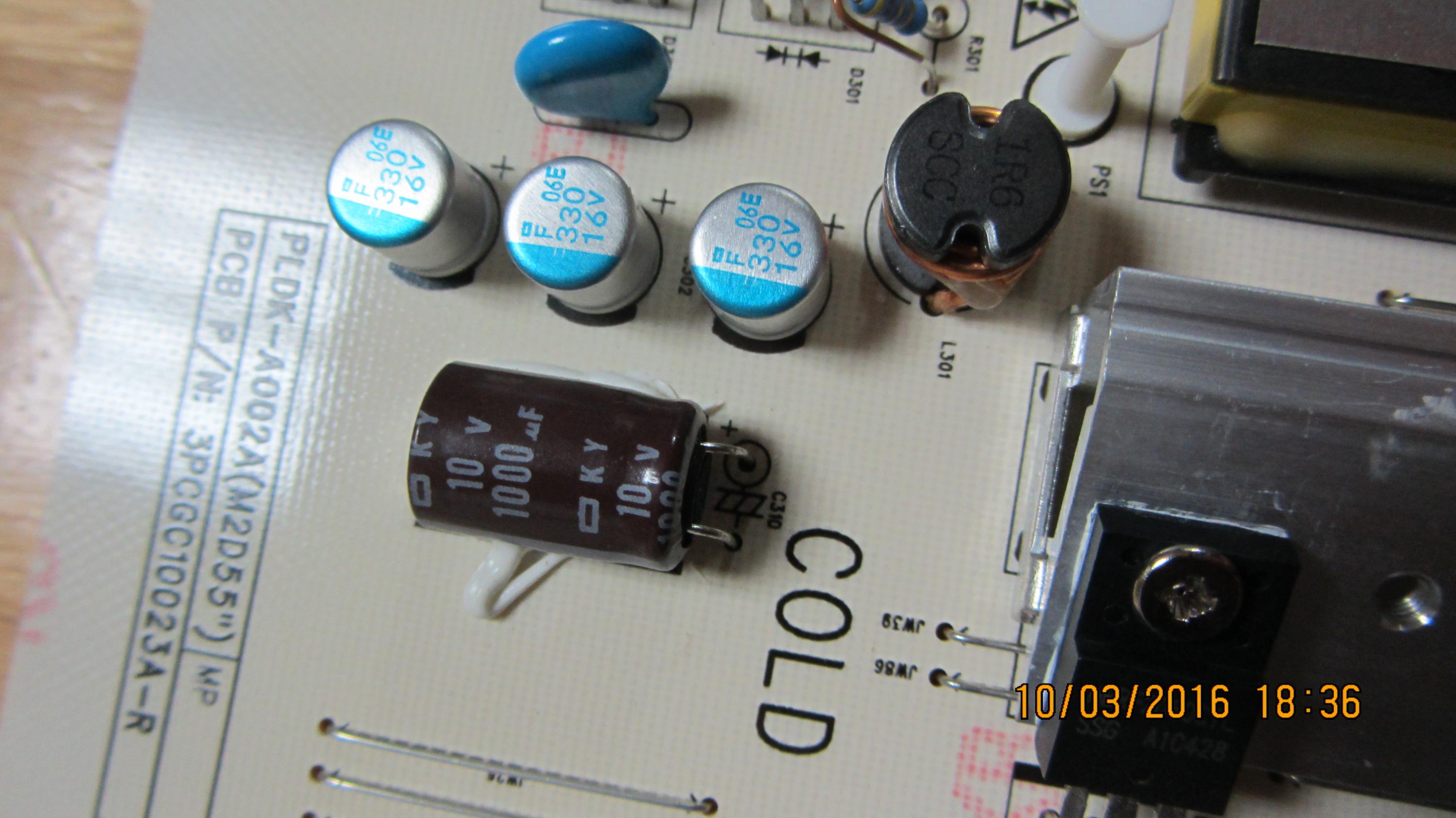

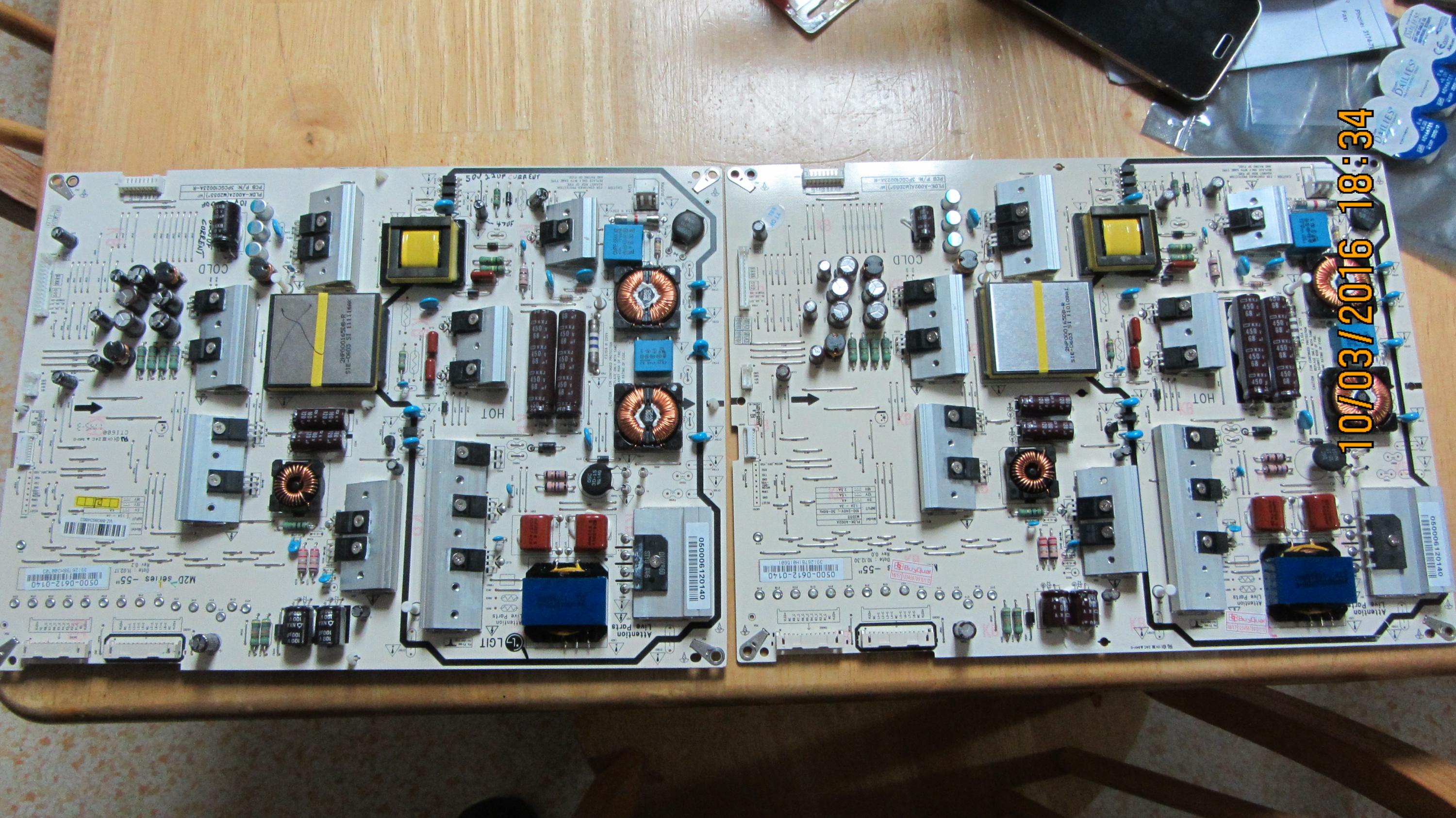

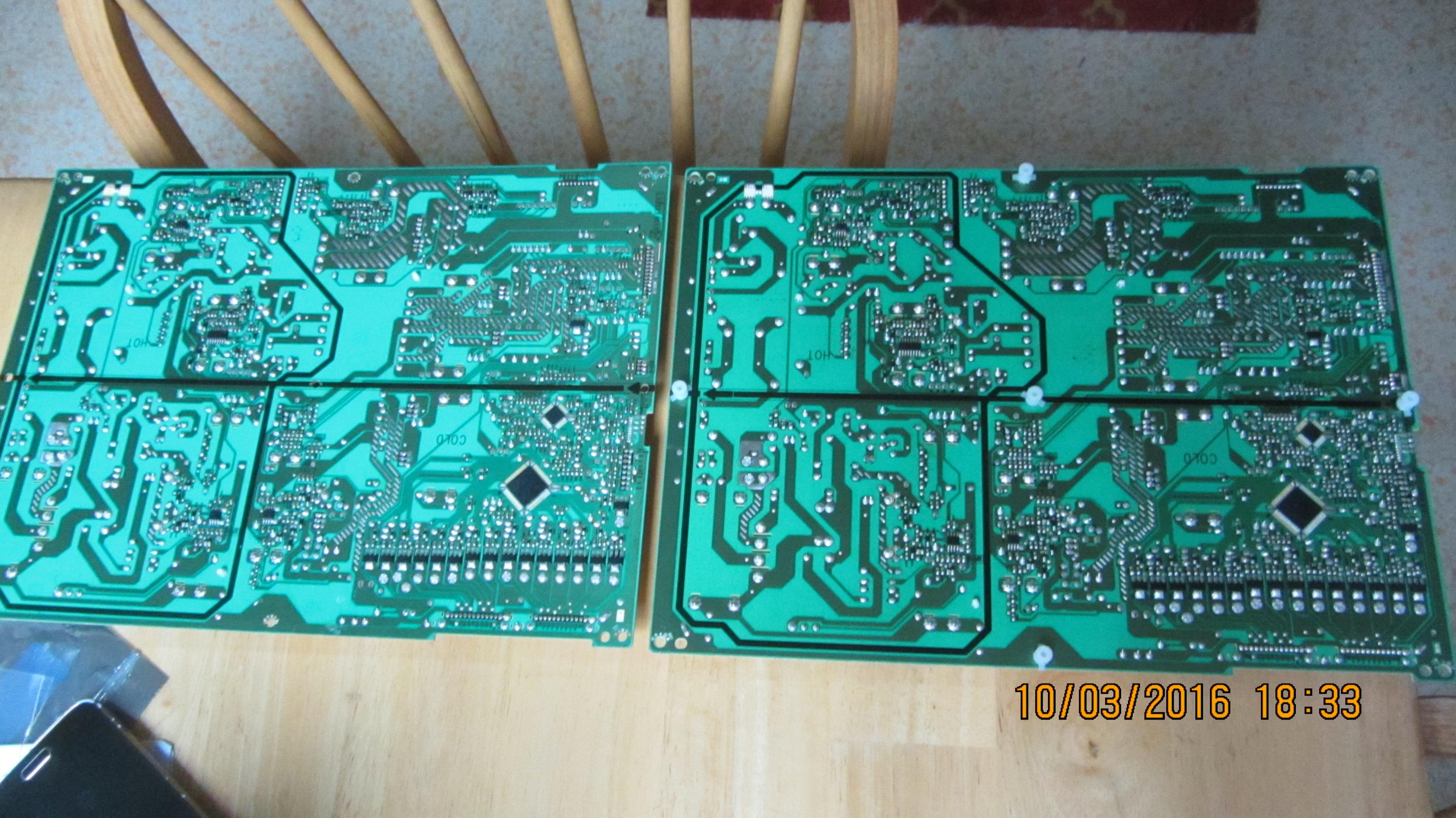

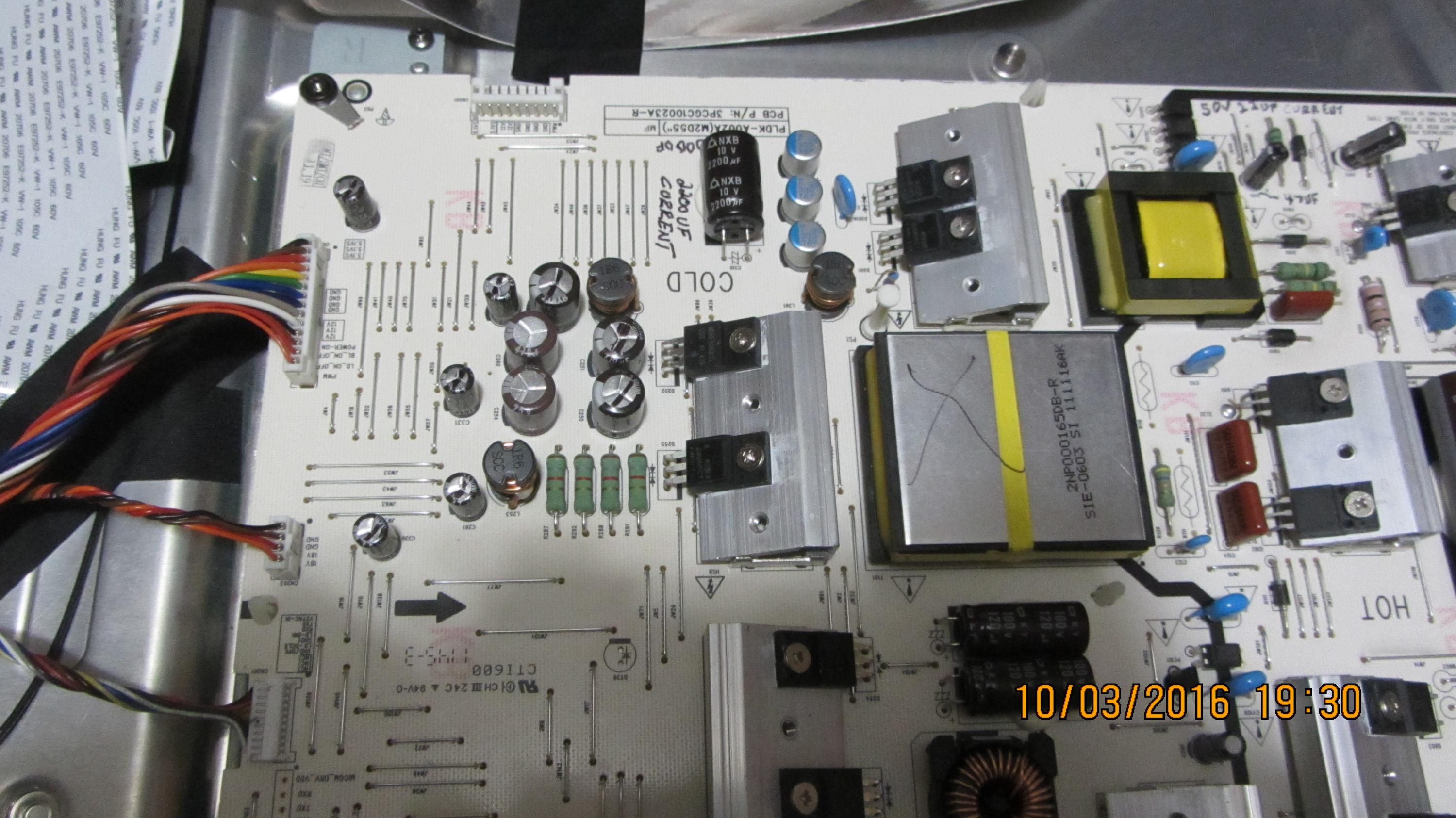

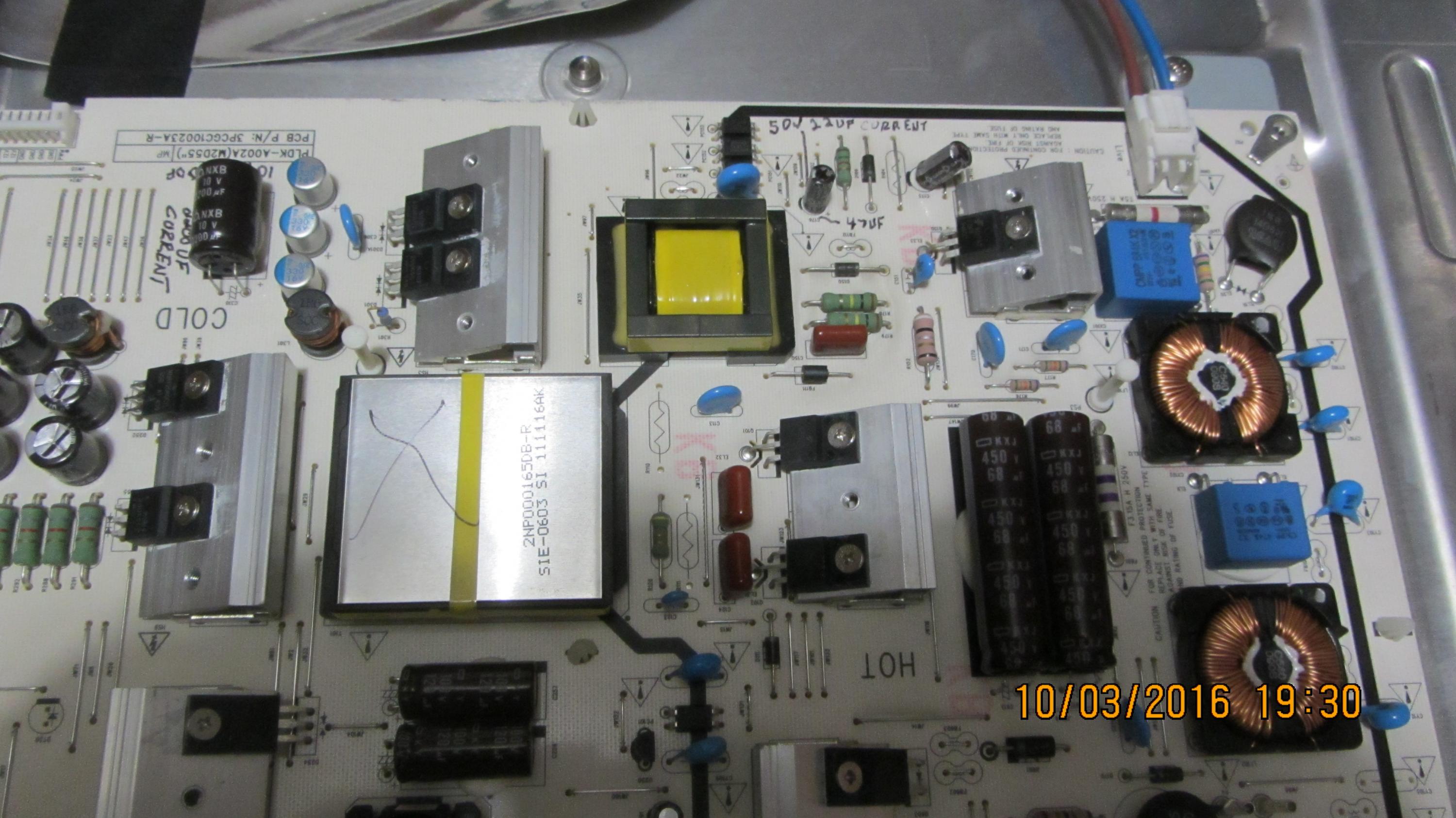

          Confirmed it is the power board I managed to get someone to let me use there power board for the night out of their same model TV!

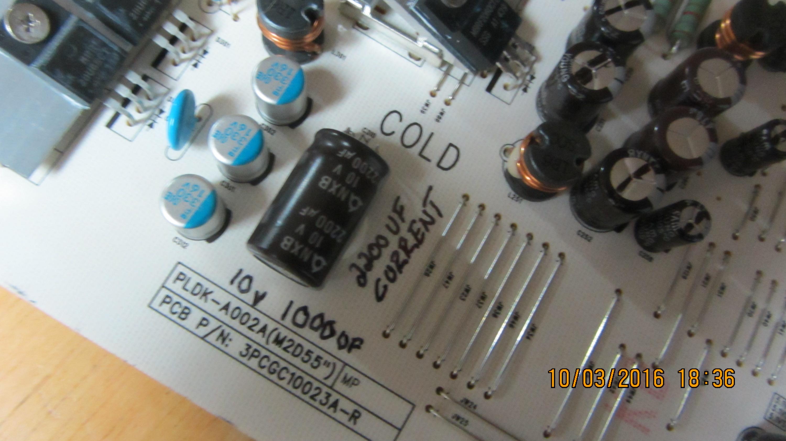

          Now there are a couple of oddities his was an after market and there is one capacitor 2200uf that has been replaced with a 1000uf cap and it looks like all of the smaller caps were replaced some of them beefed up voltage wise which don't hurt nothing but what has got me going is this cap they swapped out with less uf's I thought this was a no no in the cap world then again maybe the guy that repaired this TV the first time put the wrong value cap on the power board errrr I so wish I had a schematic with a parts listing anyhow. As far as cracked joints I seen one joint on the transformer that just goes through the board that is not soldered but it isn't on a trace either so I am assuming it does not get connected.
          Still analyzing but I shall take some measurements and post back. Would be great to get this thing diagnosed while I got a day with a power board I'm going to mark all the caps that are different for sure and make some notes for starters.
          I should just take some good quality pics To make life easy as well bbiab thanks for slumming it with me on my TV issue god old budm helped me with an old RCA I had it just crapped out again and this one as well so I am down two TV's I only really need the computer but its nice to have one in the other rooms as well at times so I don't have to drag friends PC's into here when they nag me to try and fix them.
          You know might actually make some headway tonight we will see.

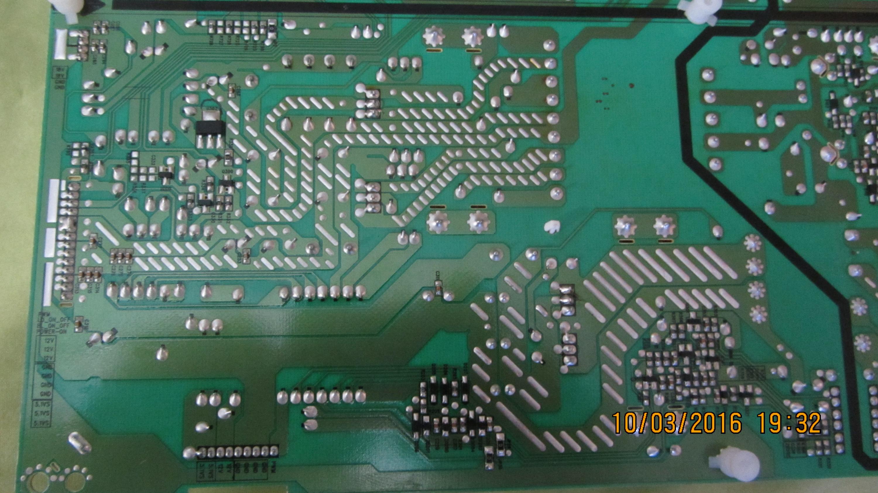

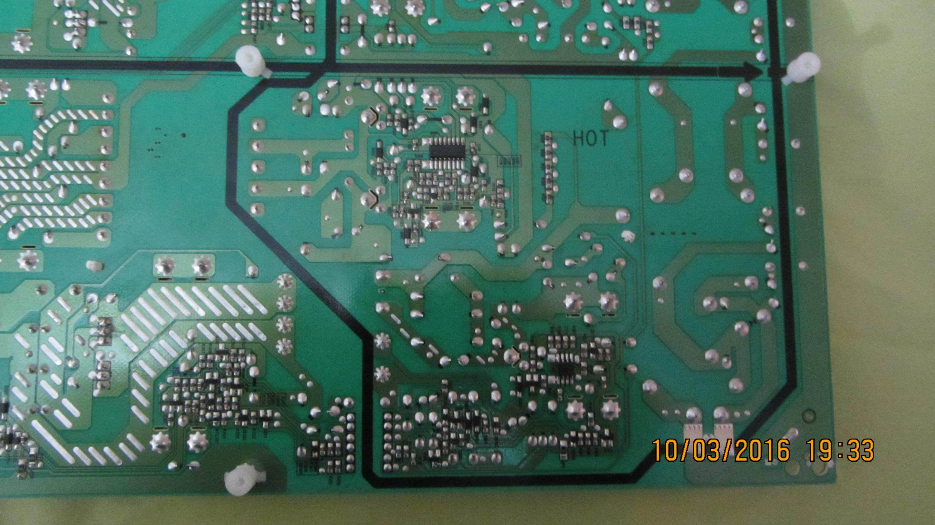

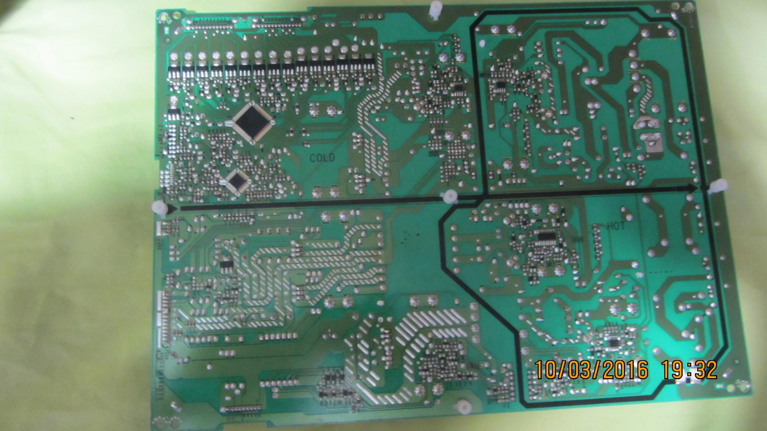

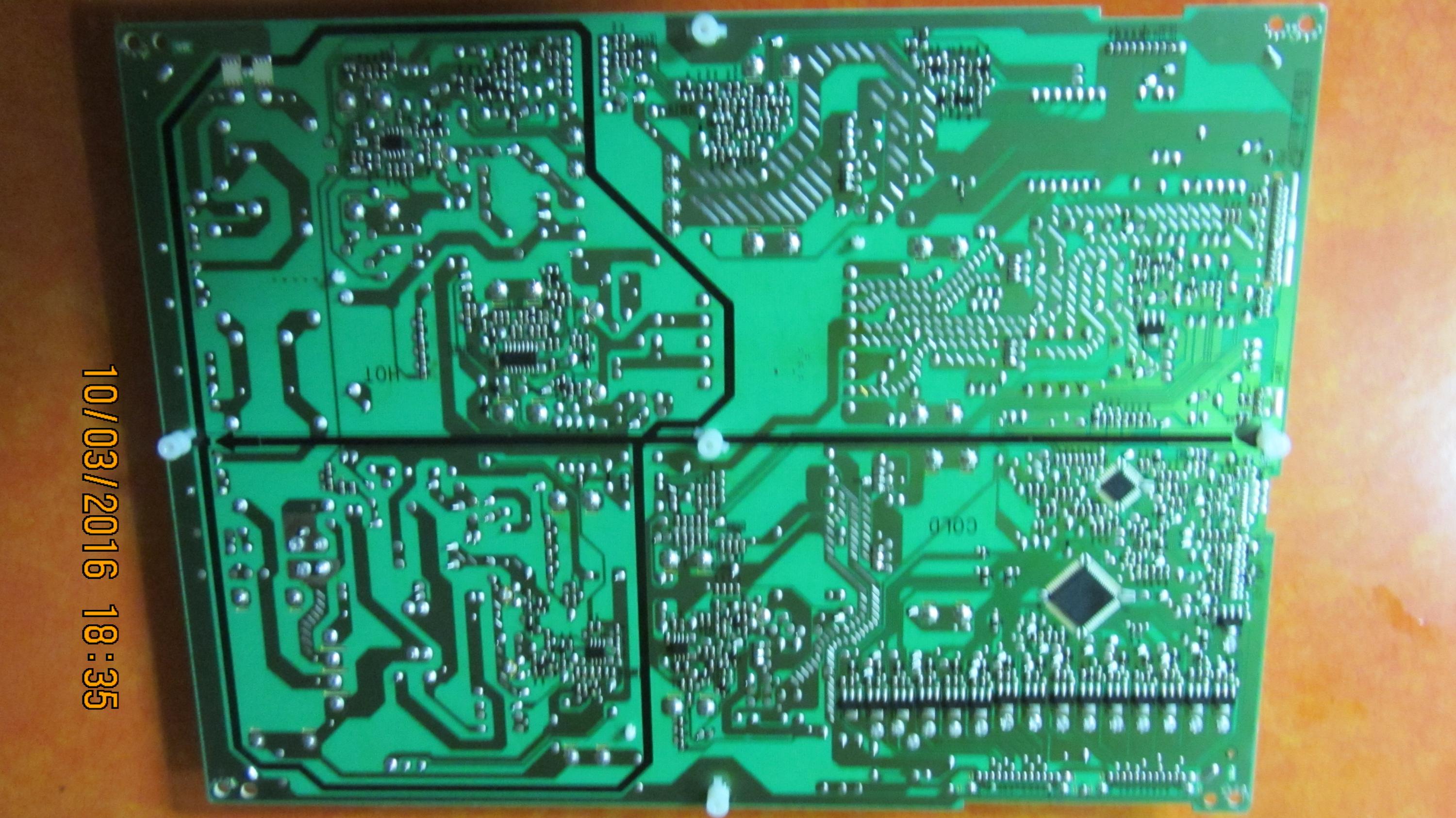

            Make some high quality, straight shot pictures of the front and back of the PSU. Also note down the pin names and voltages of the bad PSU connected to the main.
            At least you found the problem board.

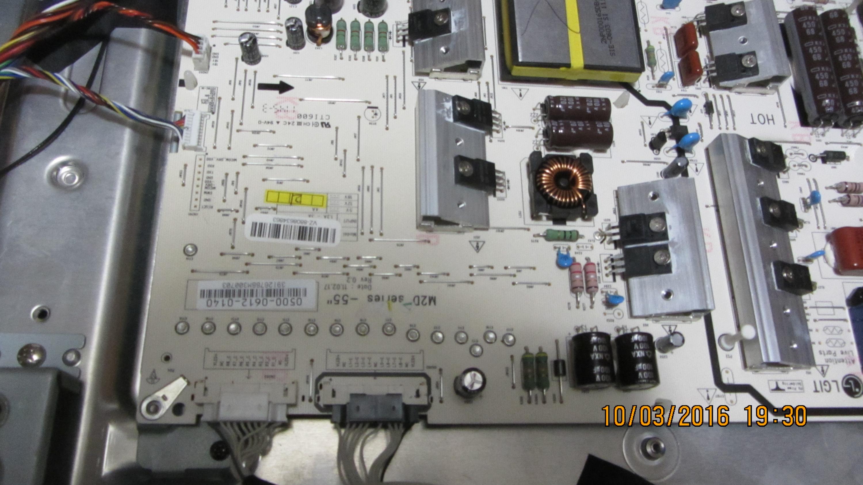

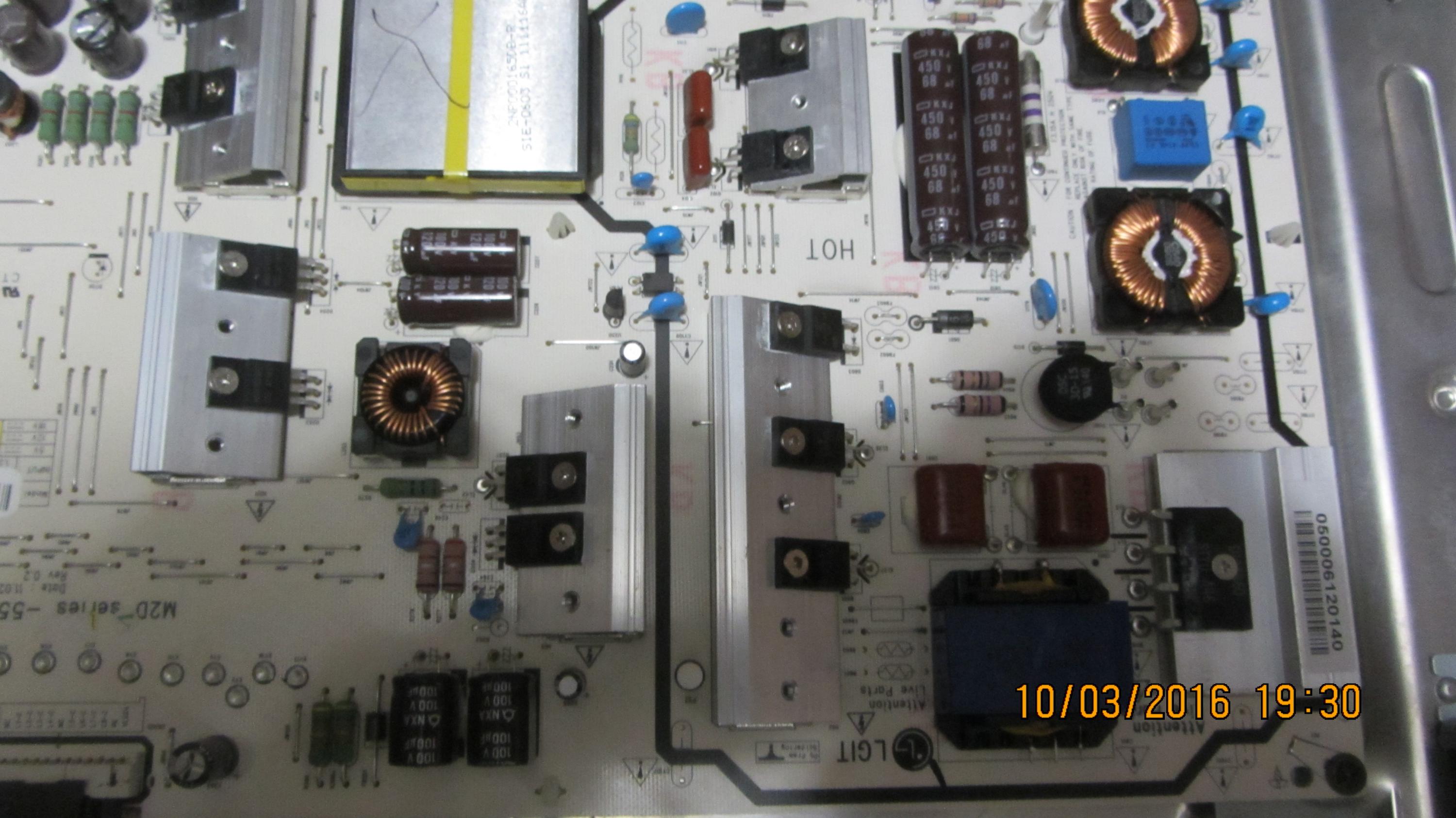

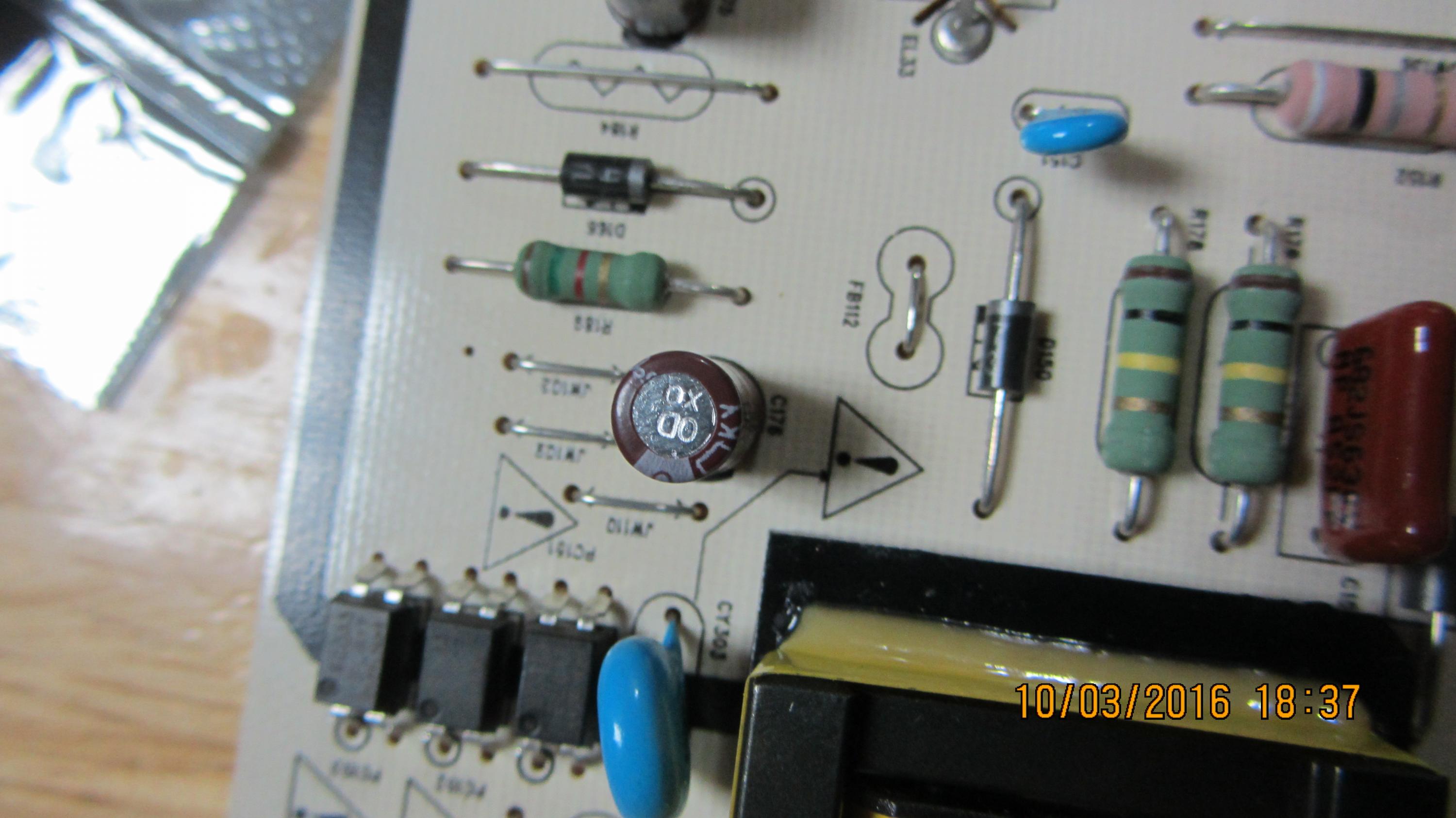

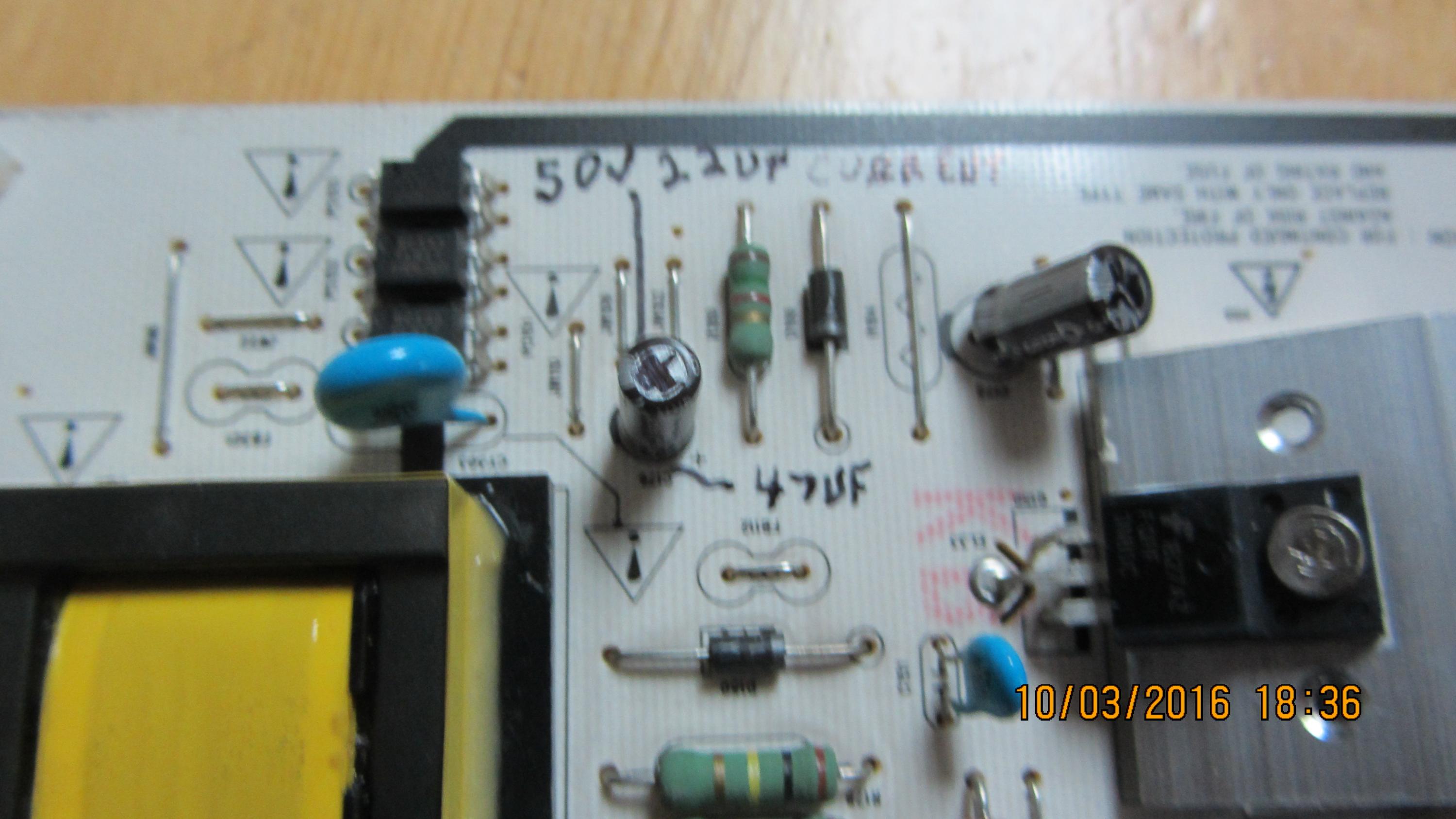

              On working board I notice a few differences.
              12V pins are NOT bridged like non working board
              LD ON OFF & BL ON OFF ARE bridged on WORKING BOARD
              There was 2 Caps with different values than non working board I have them marked on board.
              Non working board is board with X
              Measurements are up next but something to take a look at at current a very curious deal for me having access to another board is interesting never thought in a million years I'd get this lucky.
              Time to run some measurements though while the night is still a bit younger.

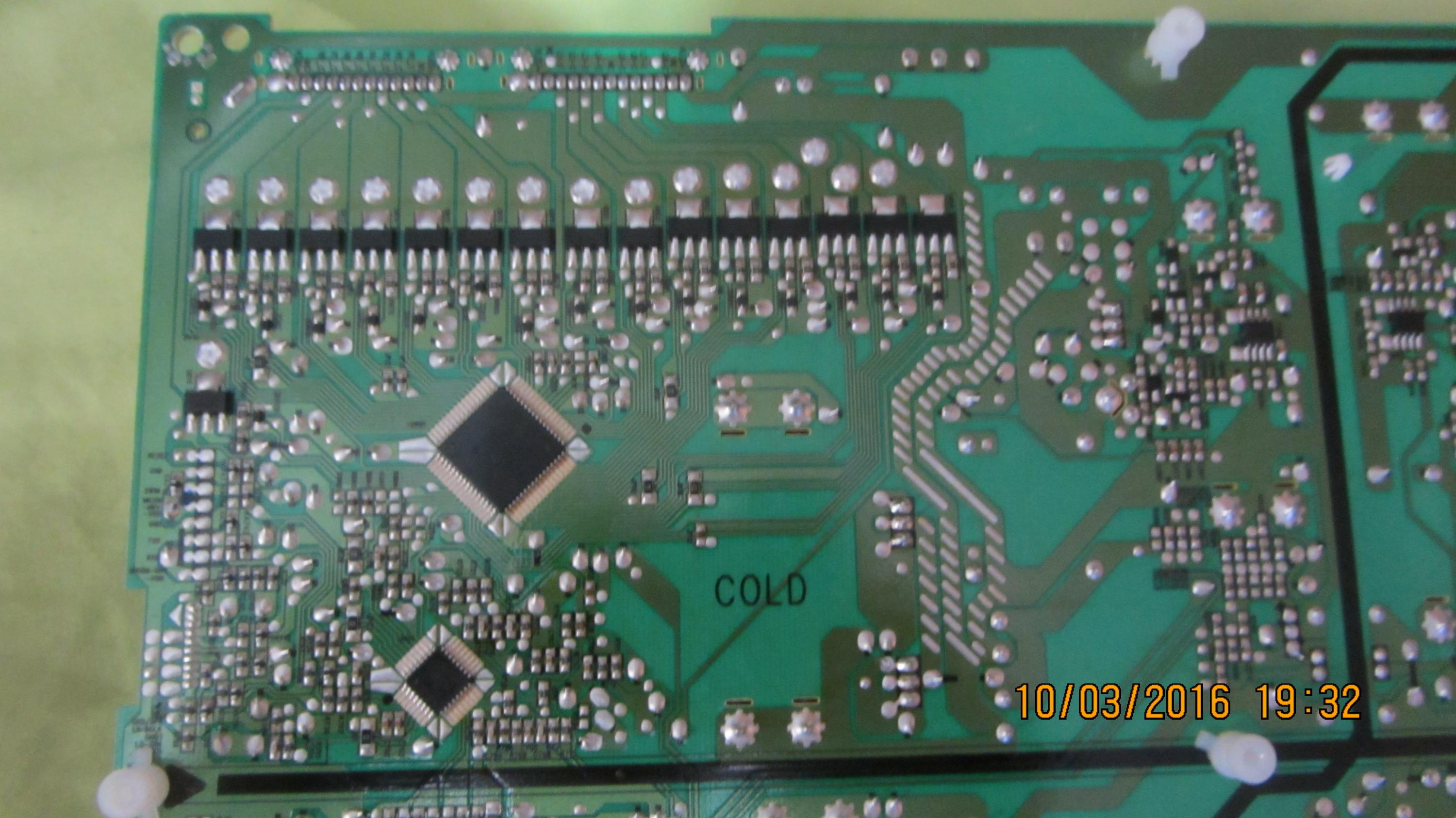

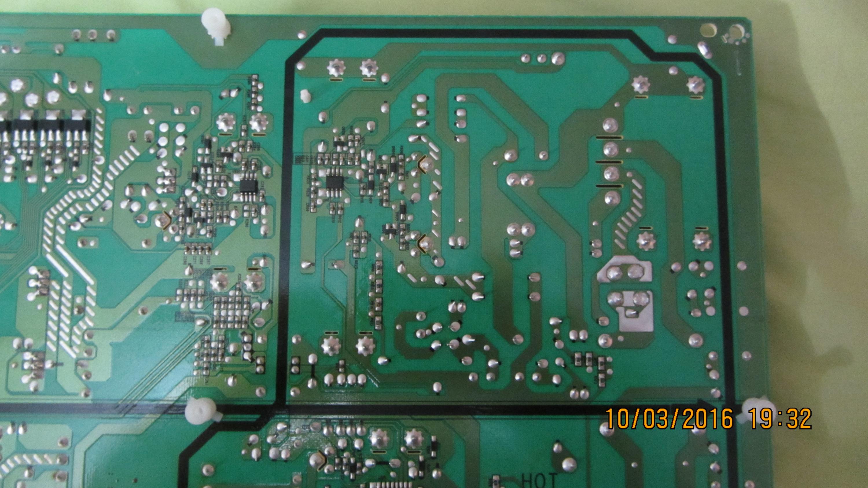

                  Better pics of the back etc....

                        See... you got the right idea. What you are looking for is to measure the voltage rails continuously until the problem arises. You can easily do that with a DMM set to measure DC and activate the min/max setting.
                        Also check the DC voltage on the 2x 450V main filter capacitors and do the same trick there.
                        Btw, your pictures are good in size, but not sharp.
