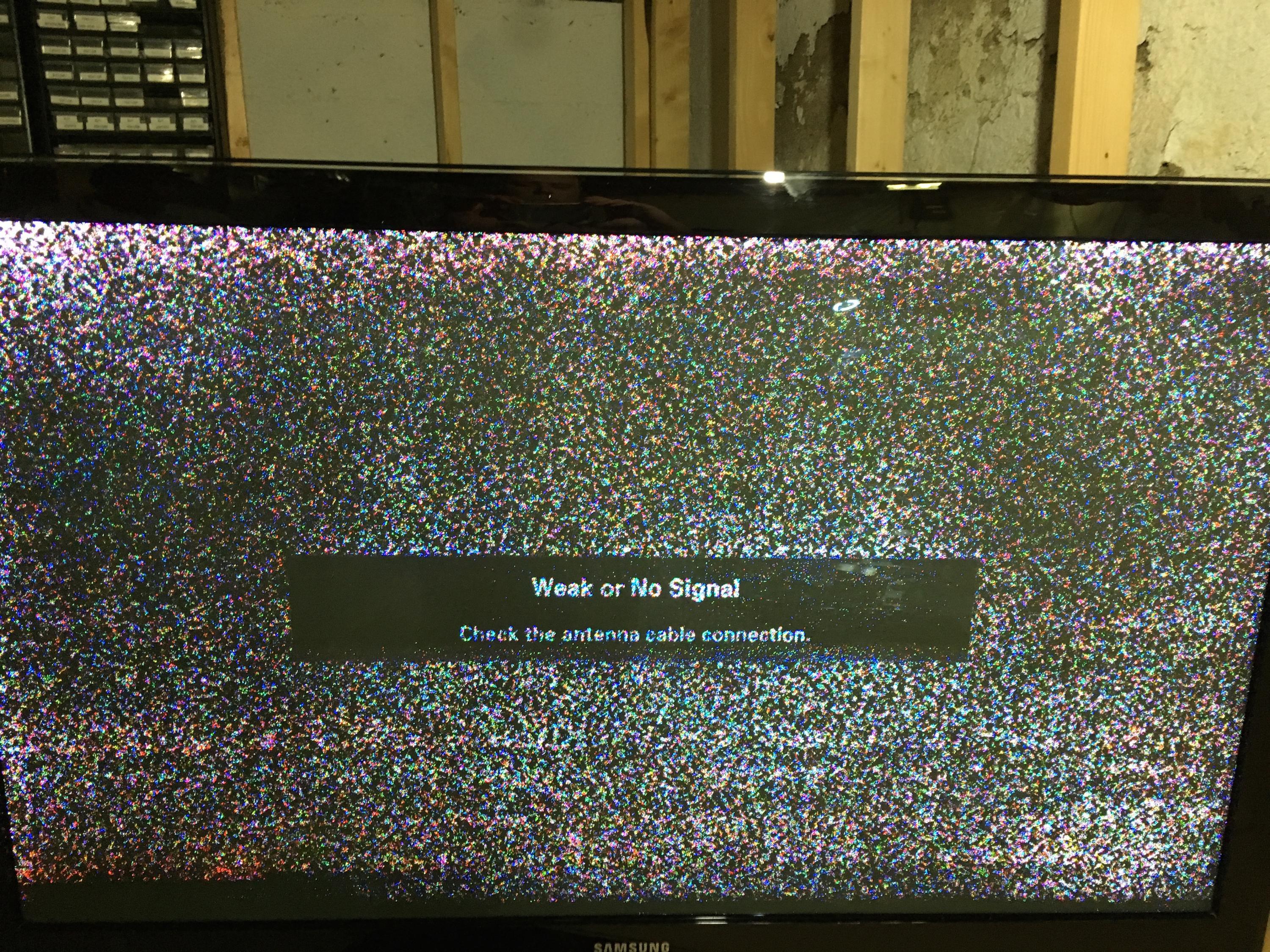

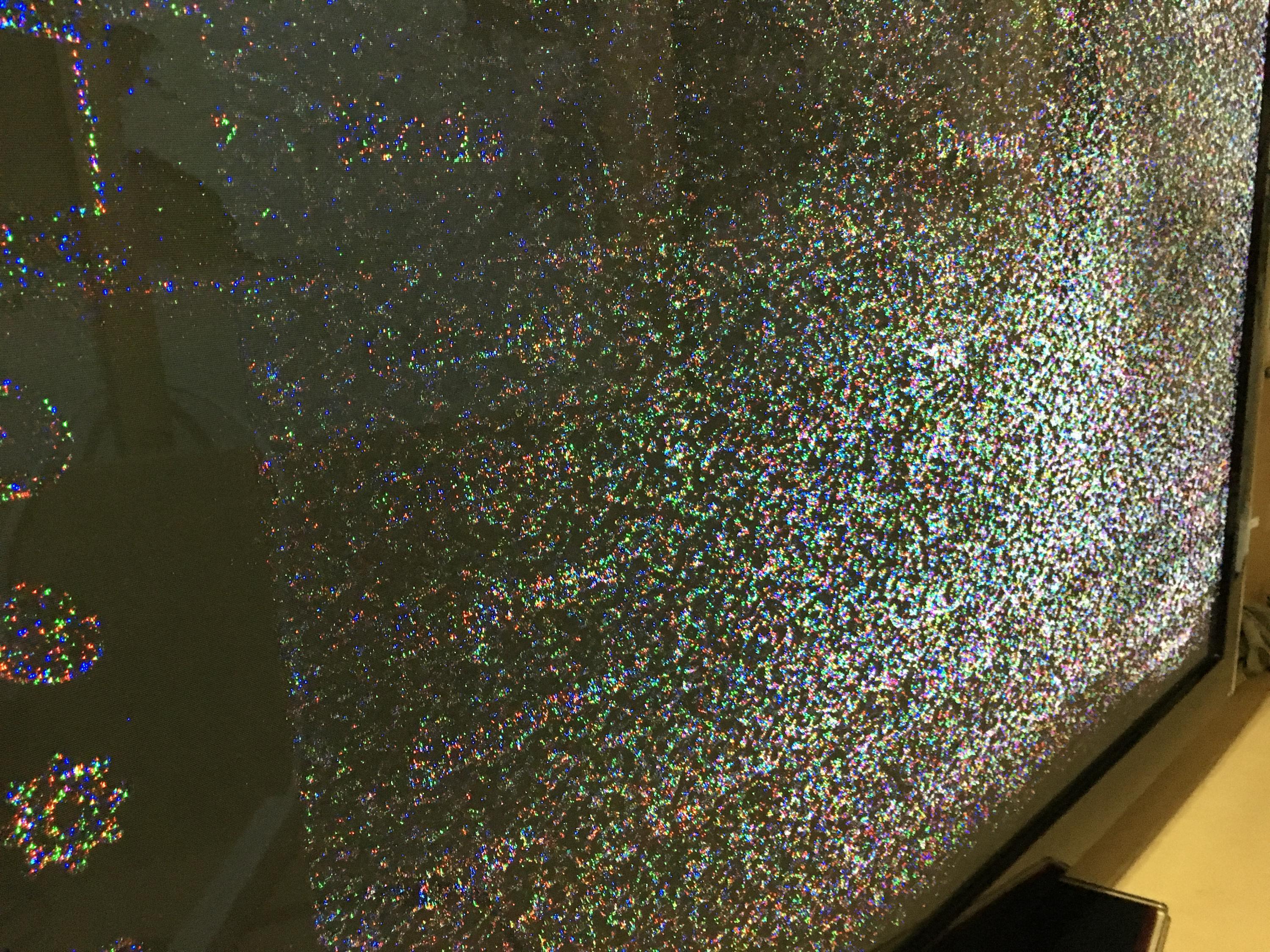

    Samsung PN50C540G3FFXZC snowy picture
    Never seen this before so posting again. I get this even when I hit the menu button, which is on the bottom picture. Is it tcon, main or panel.

      Re: Samsung PN50C540G3FFXZC snowy picture
      Voltages all im saying.
        I checked all the voltages and they were good.
        Can someone tell me what the YSUS and XSUS boards do? Could one of these boards cause this issue?
        Sorry I don't have pics. Been busy with school and fighting a nasty flu so hope someone can give me an idea.
          Run the test patterns but I'm leaning toward xsus.
