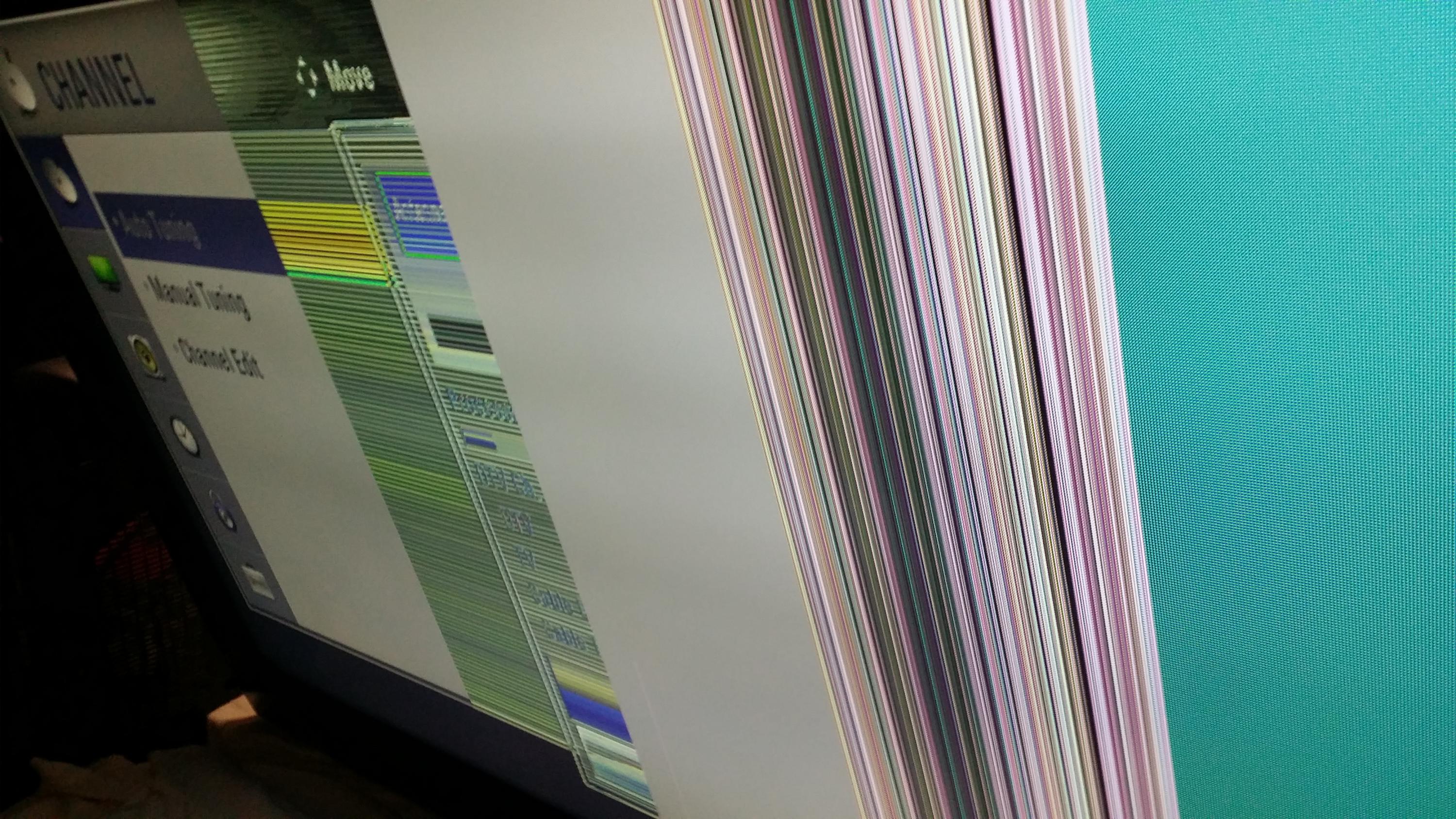

    Good afternoon!
    My friend brought me his LG 55LD520C-UA over with the symptom of goes from Red Stand by to blue on but no audio or picture.
    I check the voltages and it was not getting the signals to the Power Board from the main board. Ordered a new main board from the LG distributor. I received it. Plugged it in. I now have a picture, audio and all controls, inputs work.
    There is a pink veritical line up the middle starting at the bottom of the screen and going up only 1/3. The main board has the TCon integrated.
    Bad panel? Bad tcon cables?
    Thanks!

    My bad about the tcon integrated. New main board went out after 4 days. Got it replaced under warranty. Plugged it in.... now i am playing the game of bad main,tcon, cable or some of the above.... what are your thoughts?

      Can only suggest cleaning the LVDS cable with alcohol and reseating it carefully at both ends.

        If you carefully apply pressure to flex the corner of the panel do the line go or change indicating a tab problem, otherwise I can only suggest cleaning the LVDS cable with alcohol and reseating it carefully at both ends.

          Panel failure possibly tab bond issue.
