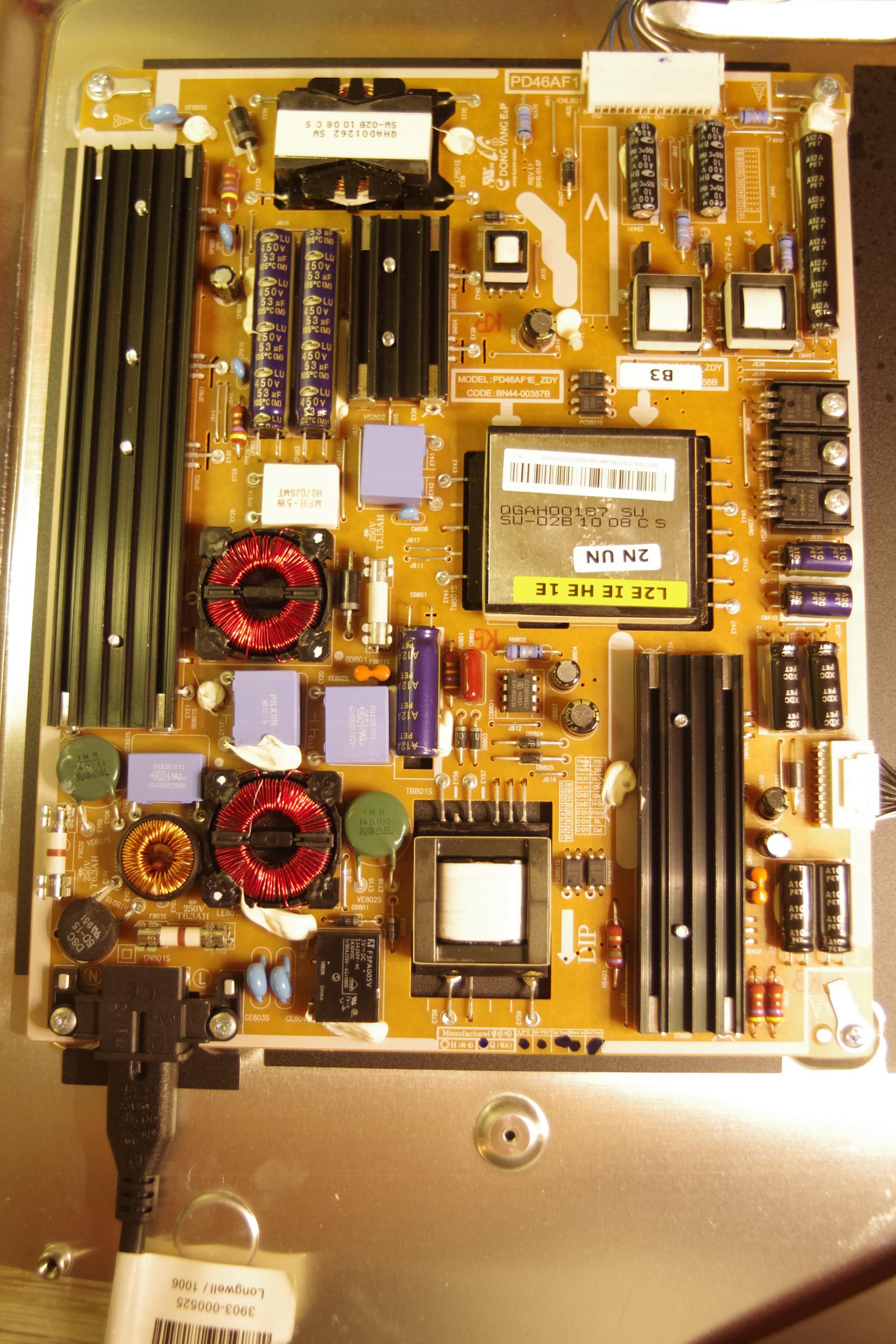

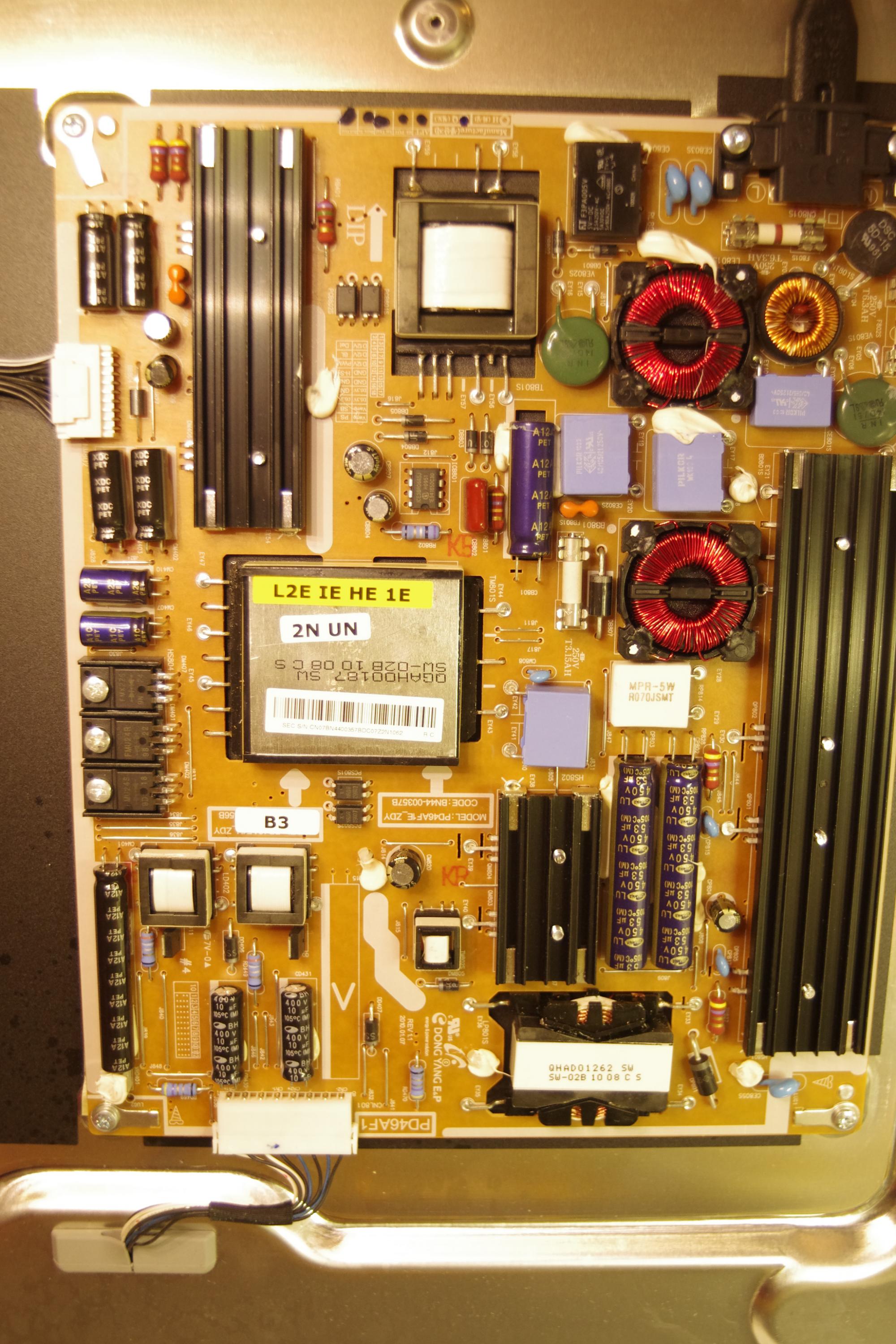

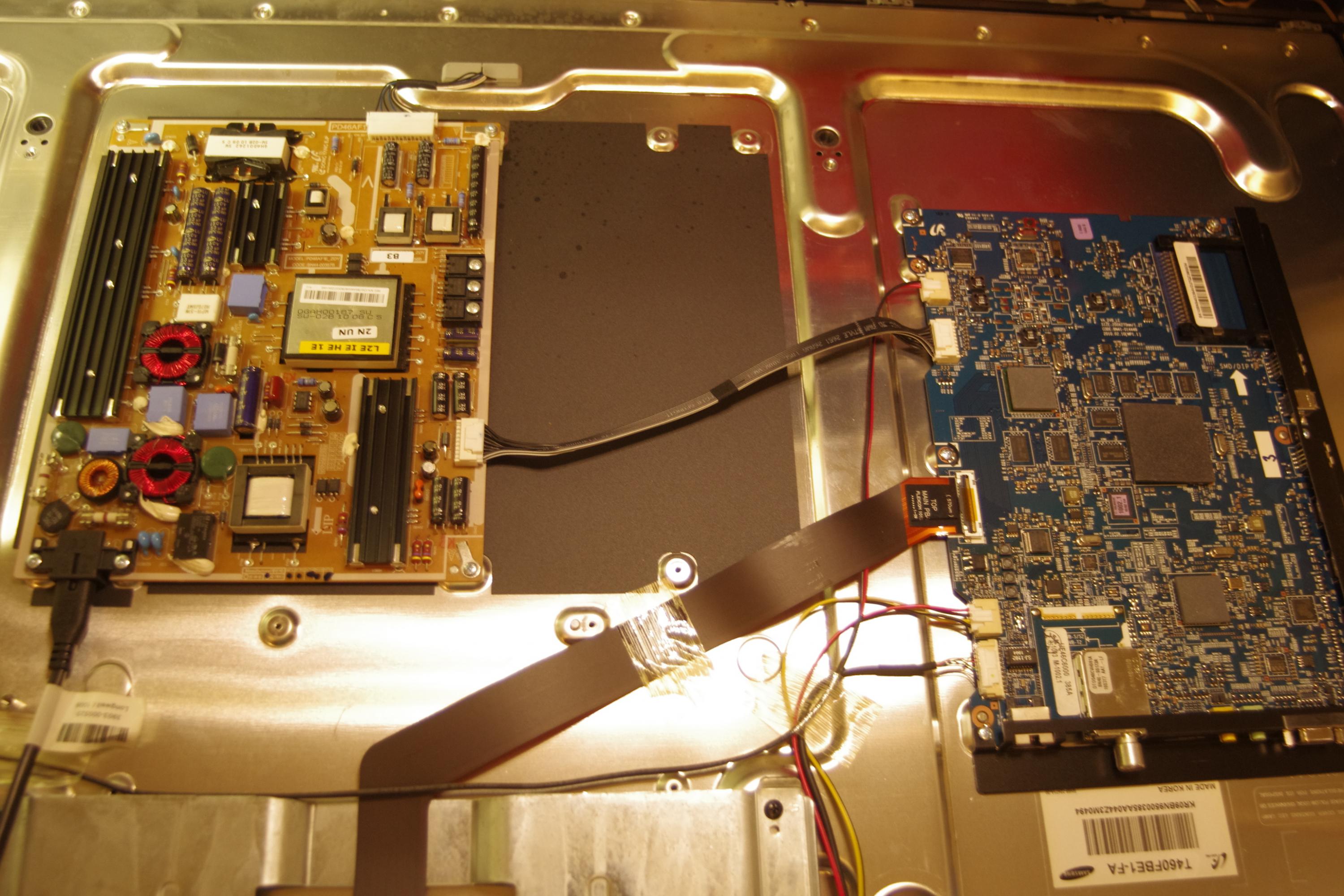

              So if you do not see the backlights come on and stay on when the cable between the power supply and the main board is removed, then we need to good clear pictures of the whole backside of the TV showing all the boards and then good clear pictures of the power supply board so we see good clear labels and traces on the board.
              • Stanem
                • Sep 2016
                • 22
                • sweden
                Re: Samsung UE46C6005 only clicking
                I put the pictures as attachment - don´t know how to do else... not my best pictures but in evening it´s problematic with the light but I hope you can see.
                  I saw your mainboard and i ran upstairs to my scab boards. I got 4 of them , all DEAD.
                  Looks like a common issue with these boards. Going to keep an eye on this thread and see if i can fix the boards.
                  • ReeceyBurger123
                    Never Give Up !
                    • May 2014
                    • 7325
                    • Britain
                    It will probably be the Bga soldering on the main cpu thats failed. My advise reflow the mainboard see if helps. Samsung were able to make a nice flat Tv but they failed at properly cooling the hot running parts which leads to failure.
                        BN44-00357B POWER SUPPLY/LED driver board.
                        These boards are known for bad solder joints on the rivet through hole solder joints, you can them on TM801S transformer. I would resolder all those transformer legs and any devices mounted on the heatsink.
                        Run the power supply board by itself and then check the DCV on the LED connector CNL801 Pin 1~8 to see what kind of DCV you have to the LEDs.
