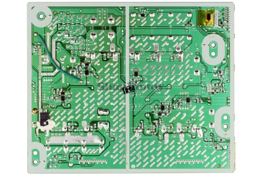

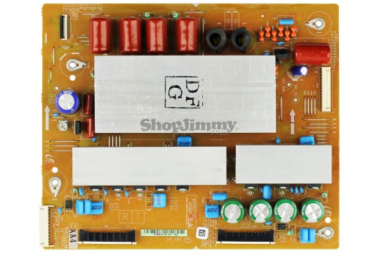

    I've got a bad Xmain, BN96-16523A (LJ92-01763A) to repair. I know the D series has tons of trouble and the firmware update. Only the board has been given to me to repair, not the whole TV.
    A replacement Xmain is hard to find and I need to get that one going.If I measure the diodes and IGBT's in circuit, they are almost all shorted.
    Question is with what did you guys come up with to replace the IGBT's: RJP30H1 and 30G124 at Digikey, Mouser ETC? Haven't too much luck yet.
    I think the SF10A 400V and the RF1501 ultra fast diode shouldn't be a problem to substitute.

    Had a bit more time:
    Q4104
    Q4101
    Q4503
    Q4202
    Q4301
    Q4302
    all shorted. The diodes are O.k.
    found them all on Ali.

                    Same set here today, same issue. 6 fets toast:
                    2* RJP30H1
                    2* 30G124
                    2* 30F124
                    All shorted, cheaper to replace board than fix it and quicker too. Panels in these are junk anyway so expect panel to fail shortly after Xmain is done.

                      Came across a few of these. I highly recommend not plugging in the ribbons that lead to the panel on your X-main once you have performed the repair. A bad panel can cause that x-main to short out immediately and these panels an above average panel failure than most Samsungs I have seen. The reason you don't want to plug in X-main ribbons yet is so that you can check the output voltage of your X-main to the panel and make sure that indeed it is giving out the correct output voltage. Once you know that you have successfully repaired the board then go ahead and proceed to plug in the panel once the set has had time to discharge.
                      Like that if the board keeps blowing on you, you know its panel failure and not due to a bad/incomplete repair.

                          My Xmain doesn't have any 30F124 IGBT's in it at all. I've received today the RJP30H1's and I replaced those. Still waiting for the 30G124's

                            Well G and F 124's are basically the same fets so they probably just used what they had laying about. Also dont forget to check the Ymain over Capleaker these use combined ERC so Y can kill the X after repair.

                              I replaced the components that CapLeaker said in the above post and my tv now works! Had to get the parts from China so I had to wait a month but it worked!

                                  Got my 30G124 IGBT's today. Got a working X-Main to report!
