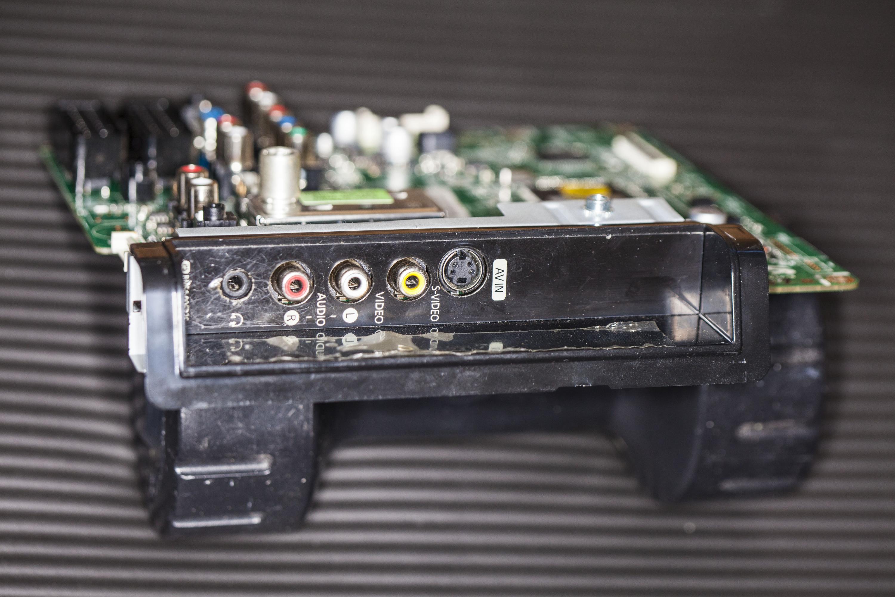

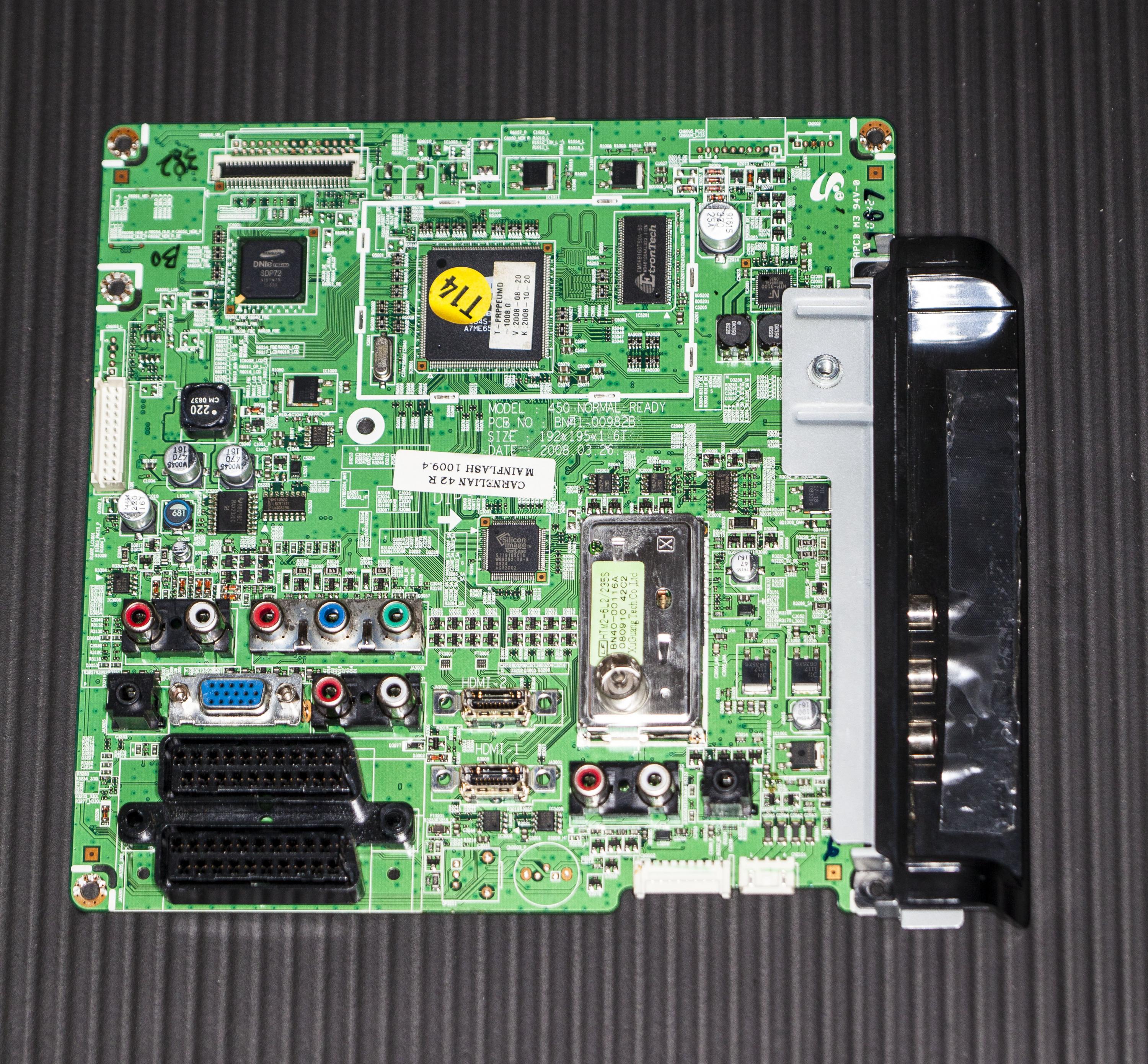

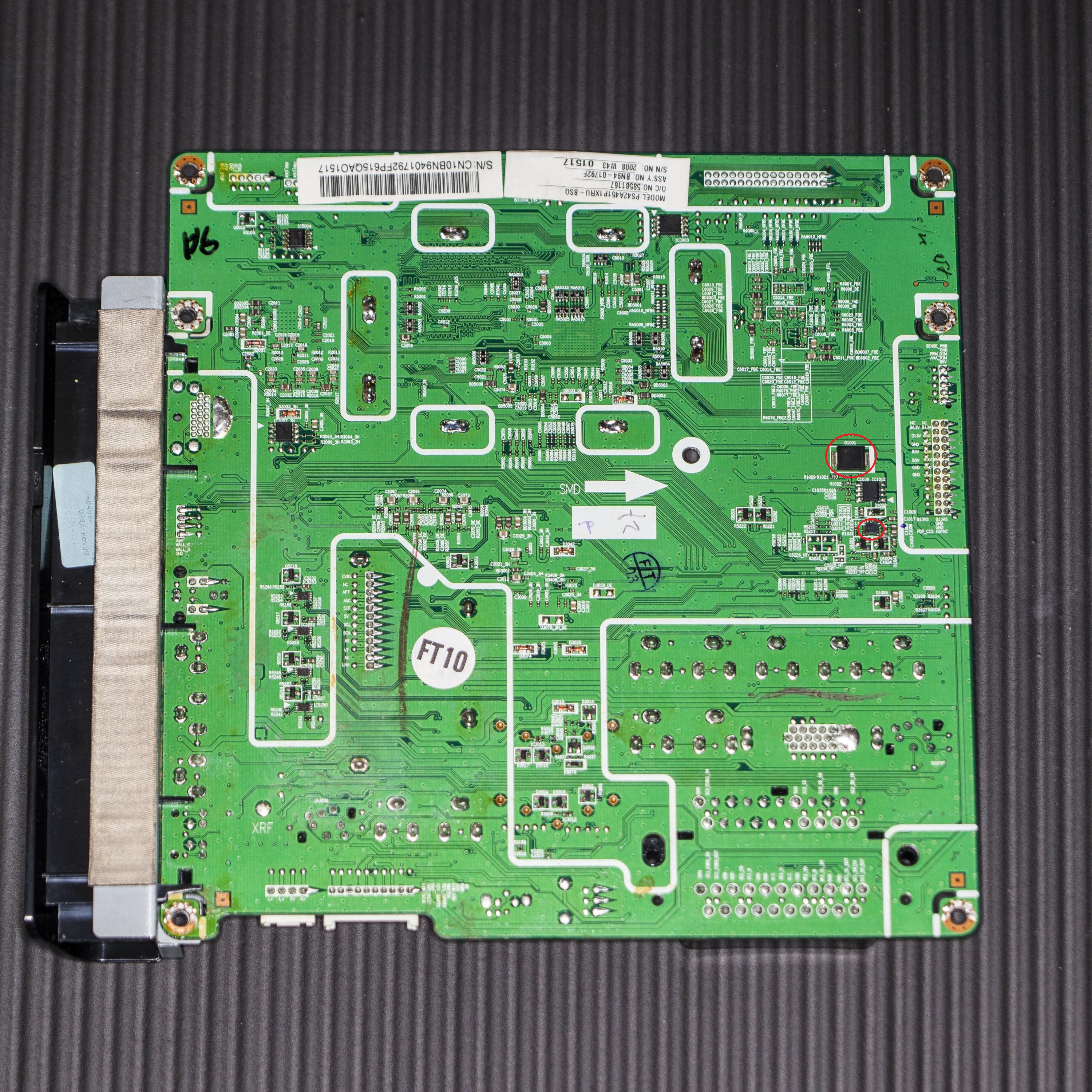

                    i don t see this eeprom any where!!!
                    Near the main CPU. Make hi-res photos of the board from both sides.

                      as you can see there is no gate for a usb stick to put firmwere on!!!!!???

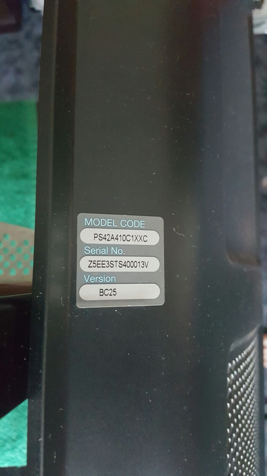

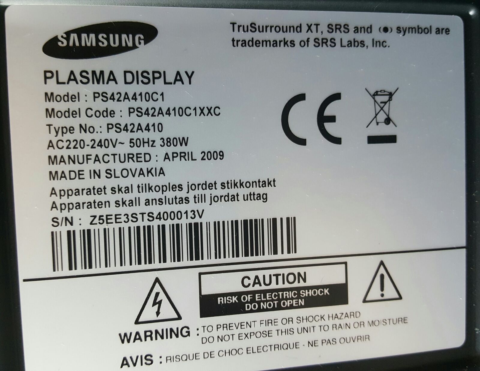

                        can you upload a picture of the information on the sticker make/model etc from the back of the tv thanks
                          Re: samsung PS42A410C1 turns on and off
                          this is from the back!
