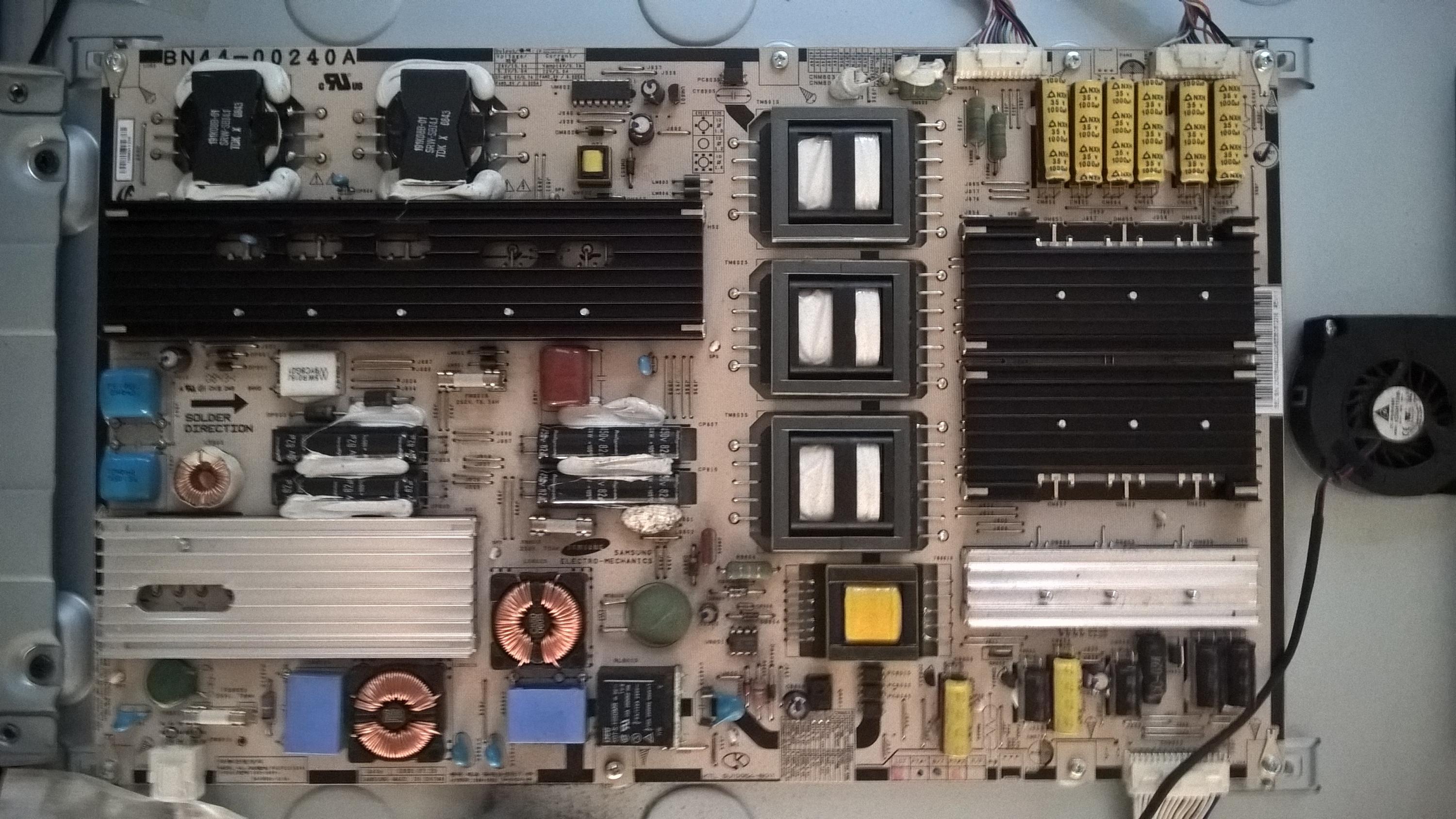

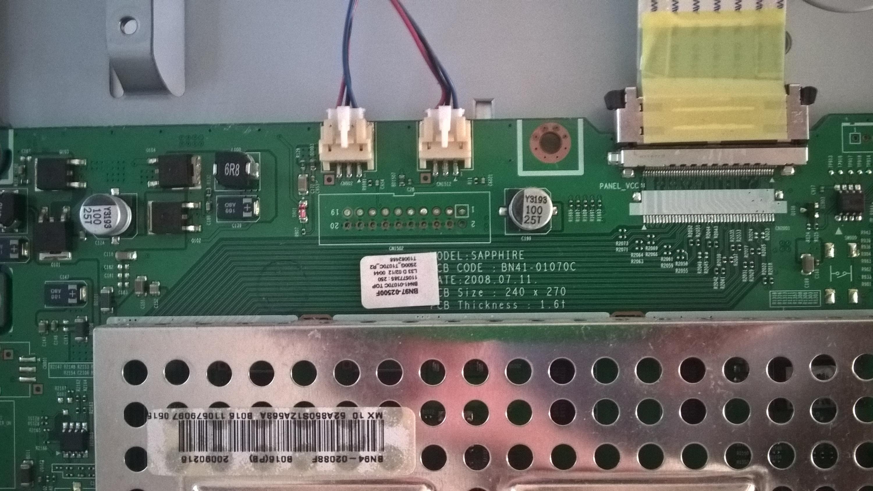

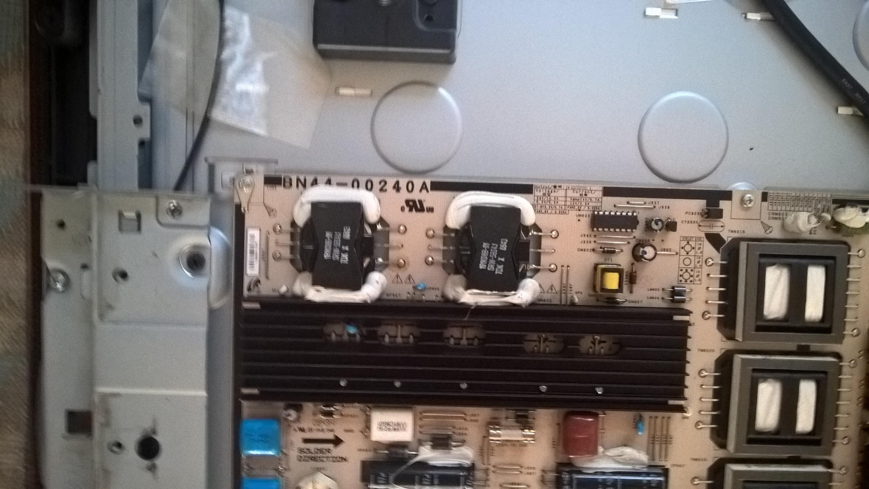

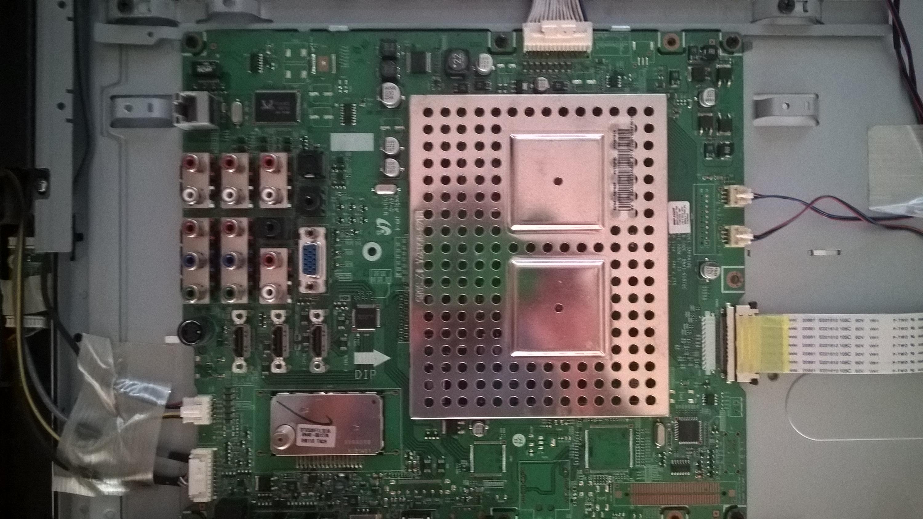

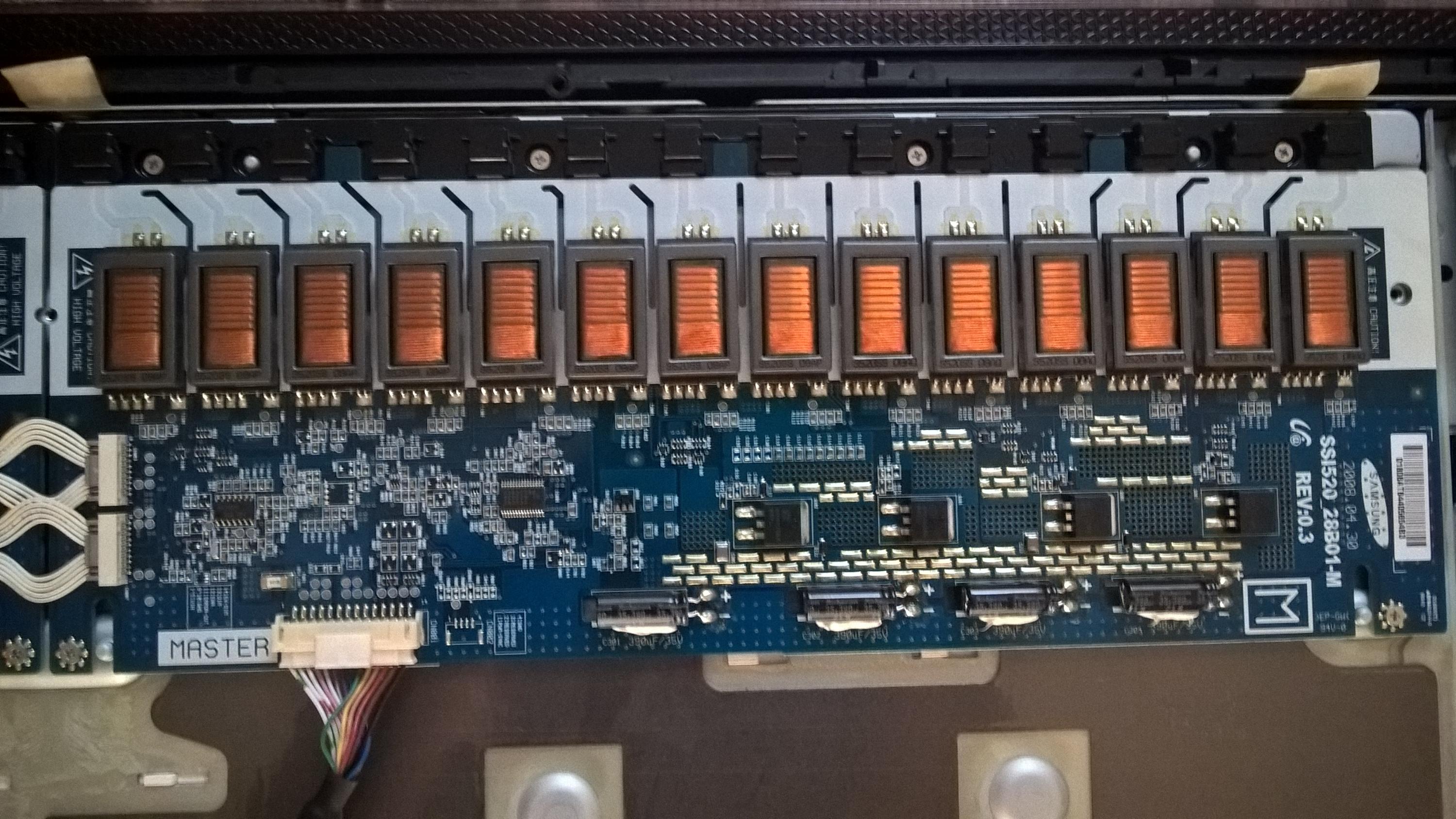

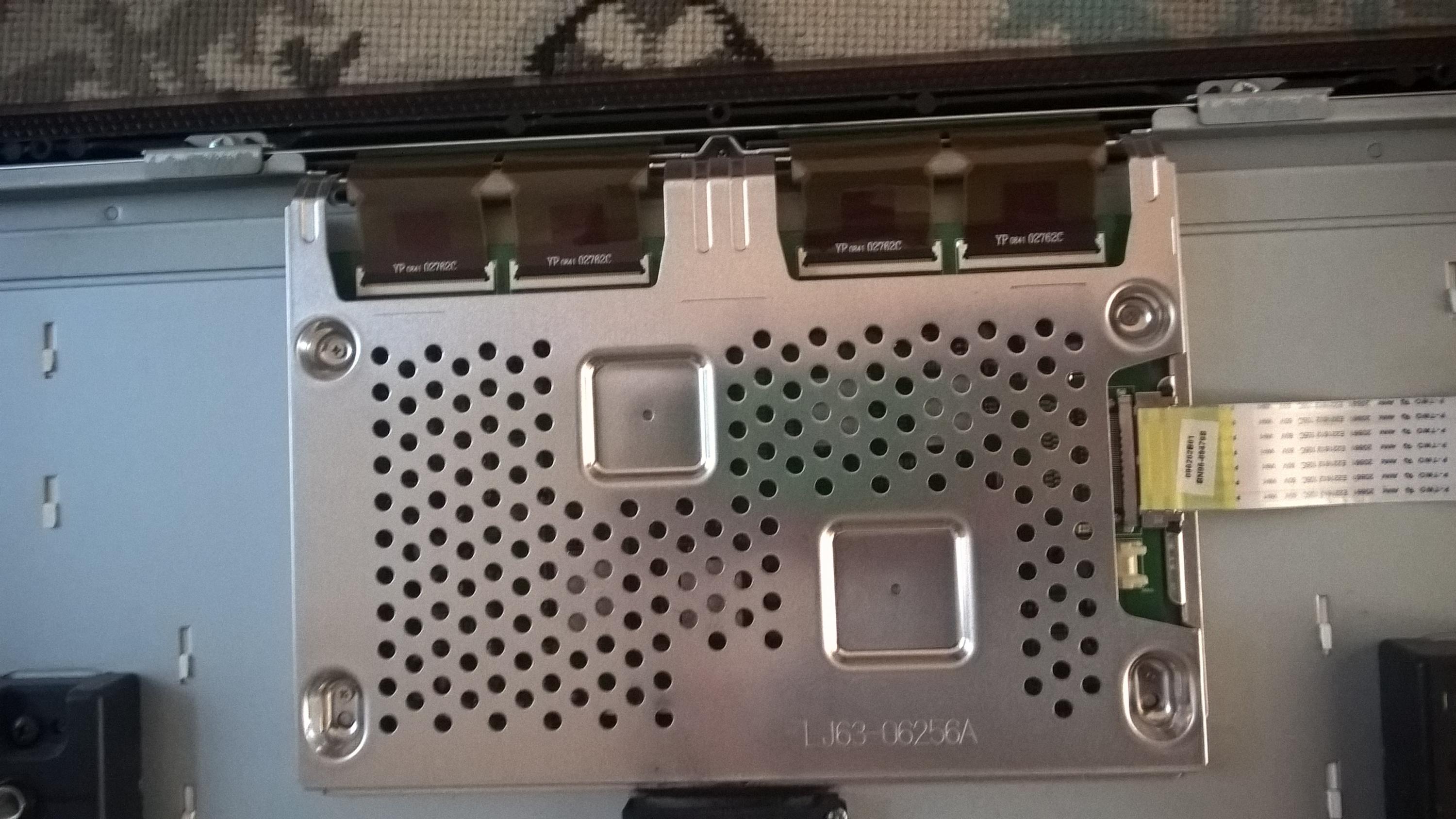

    Hey all,
    I am having trouble with my Samsung LN52a850s1f. I just finished the tab bond repair and the screen is working 100%. I still have one other issue that has not been rectified through the repair. I occasionally get a black screen while watching it. The screen remains lit, its just black. The audio will remain and the screen will return if I power cycle. When the screen is out, I cannot get the menu to display either. It seems to happen more when I first start up the tv. Yesterday and today and within the first 15 minutes it happened 4 times then 3 times respectively. I picked up a used t-conn and power supply board and swapped them but no change. Any ideas? I am thinking of new capacitors next.
