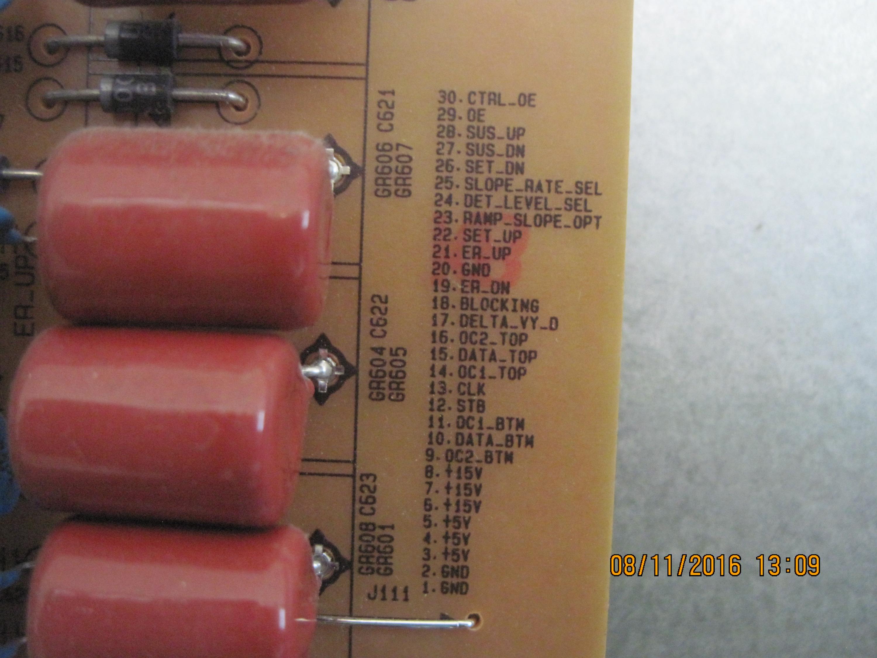

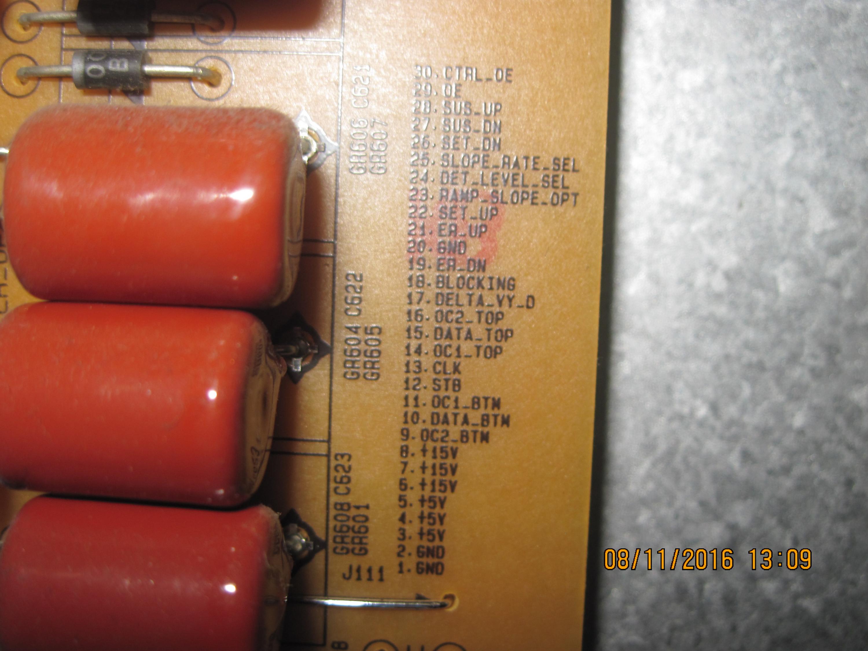

    I have this LG 50Pt350. It has standby light but i press the power on no picture.
    I want to know what is ctrl_0E and what is the voltage on that pin.

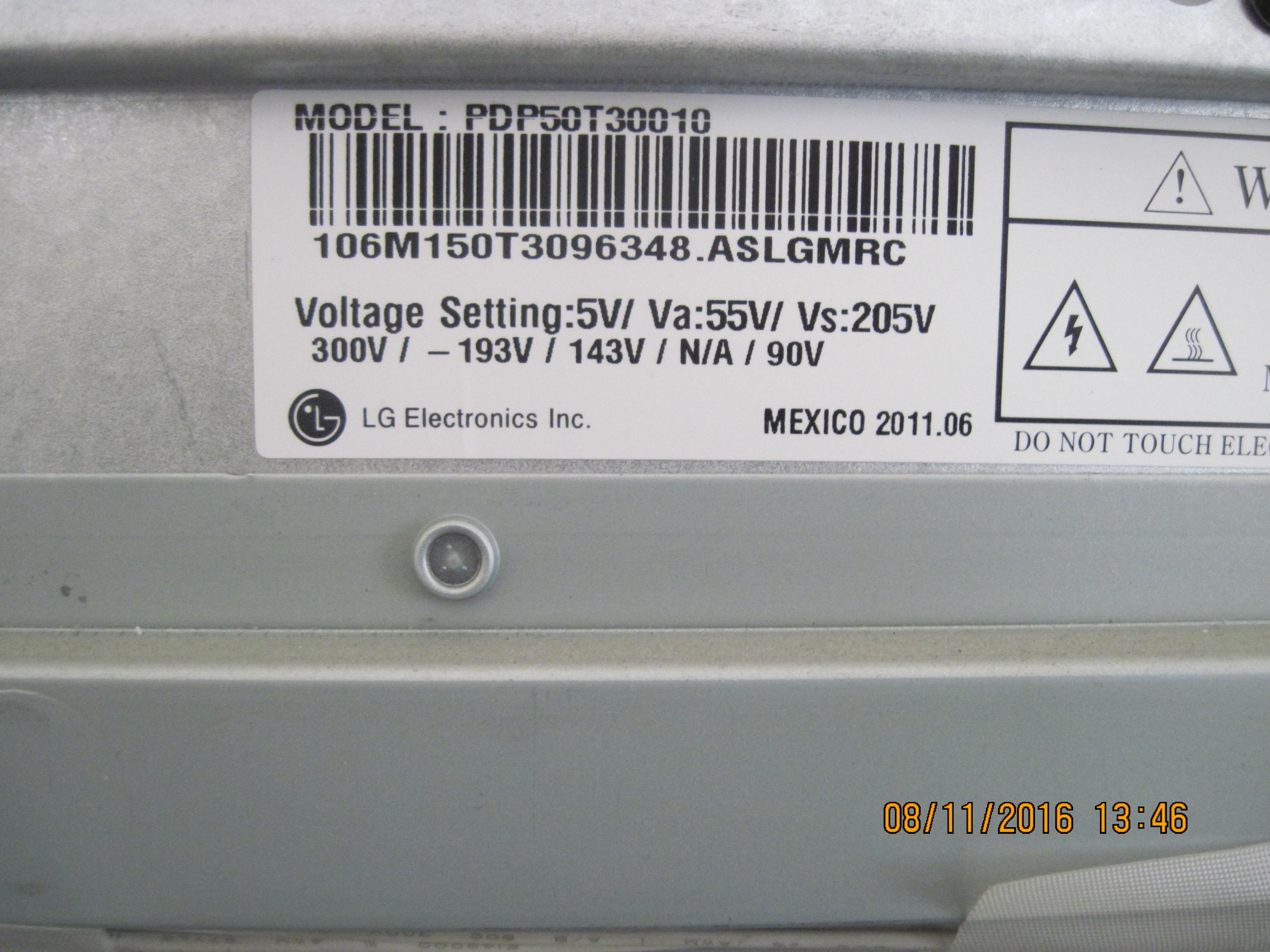

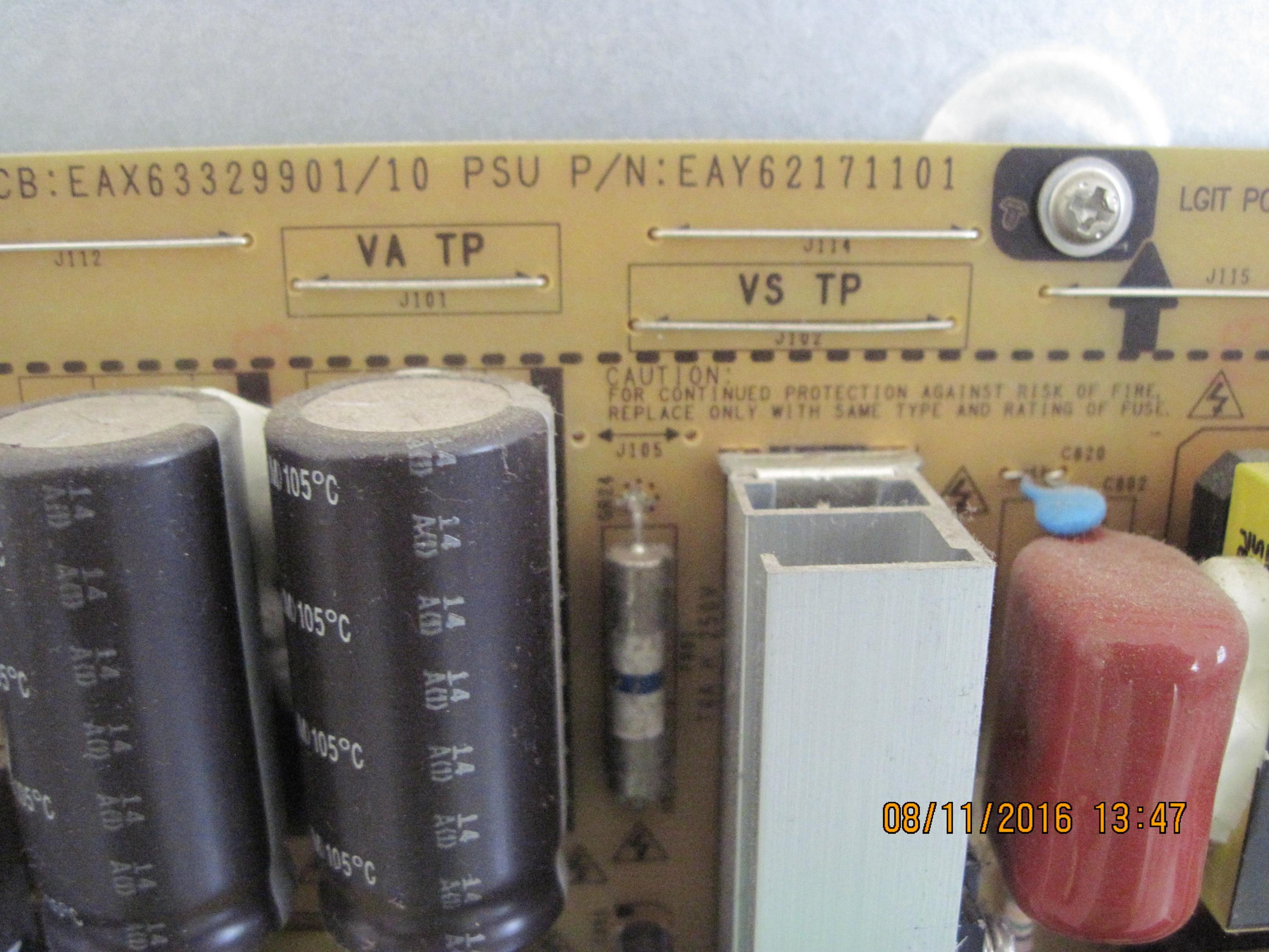

    I measured the va and vs voltages.
    va 120vac
    vs 450vac
    Any suggestion?

      Re: 50pt350
      you need to measure in DC then look at the panel sticker to see if VS/VA match up etc etc

        Re: 50pt350
        Those voltages are roughly double what they should be. Are you sure your meter is reading correctly. Have you measured some of the low dc voltages to see that your meter reads them correctly. CTRL_OE possibly "Control Output Enable" but just a guess.

          Re: 50pt350
          sordids999 thanks, vdc 200 vs and 53 va

            Re: 50pt350
            Slightly low but I don't think enough to stop it working. There will be other voltage test points on the boards. Vsc, VE etc. Can you find and measure the dc voltages at those points.

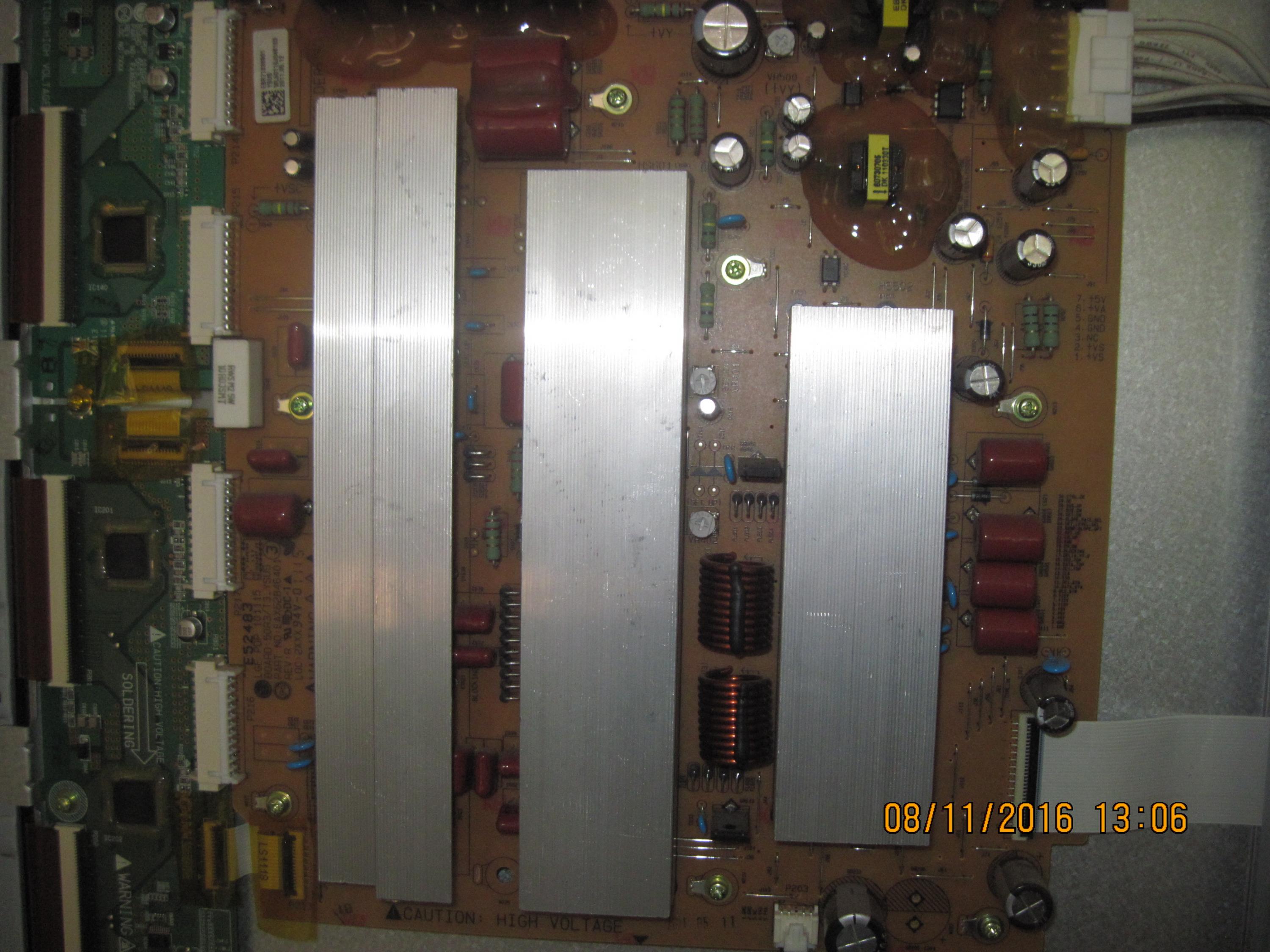

                Re: 50pt350
                the vsc voltage is bouncing from 0 to 202.
                vzbis 88

                  Re: 50pt350
                  Ysus or buffer issue then, remove buffer modules one at a time (upper first then lower) and and restest Vsc you might even get an image if one of the buffers is short and you remove it on one half of the screen.

                        Re: 50pt350
                        Ok, I think it is the ysus and not the buffer. Cause the voltage still bounced around with the upper and lower buffers removed.

                          Re: 50pt350
                          Reeceyburger123, can you answer what is ctrl_0e it run from the control board to the ysus? I don't have any voltage at that pin.

                            Re: 50pt350
                            Replaced the ysus board and there was a puff a smoke coming from lower buffer. still no picture top or bottom.

                                        Re: 50pt350
                                        hey the vs test point and va test point on the pbd never balanced. va 55vdc and vs 205vdc
