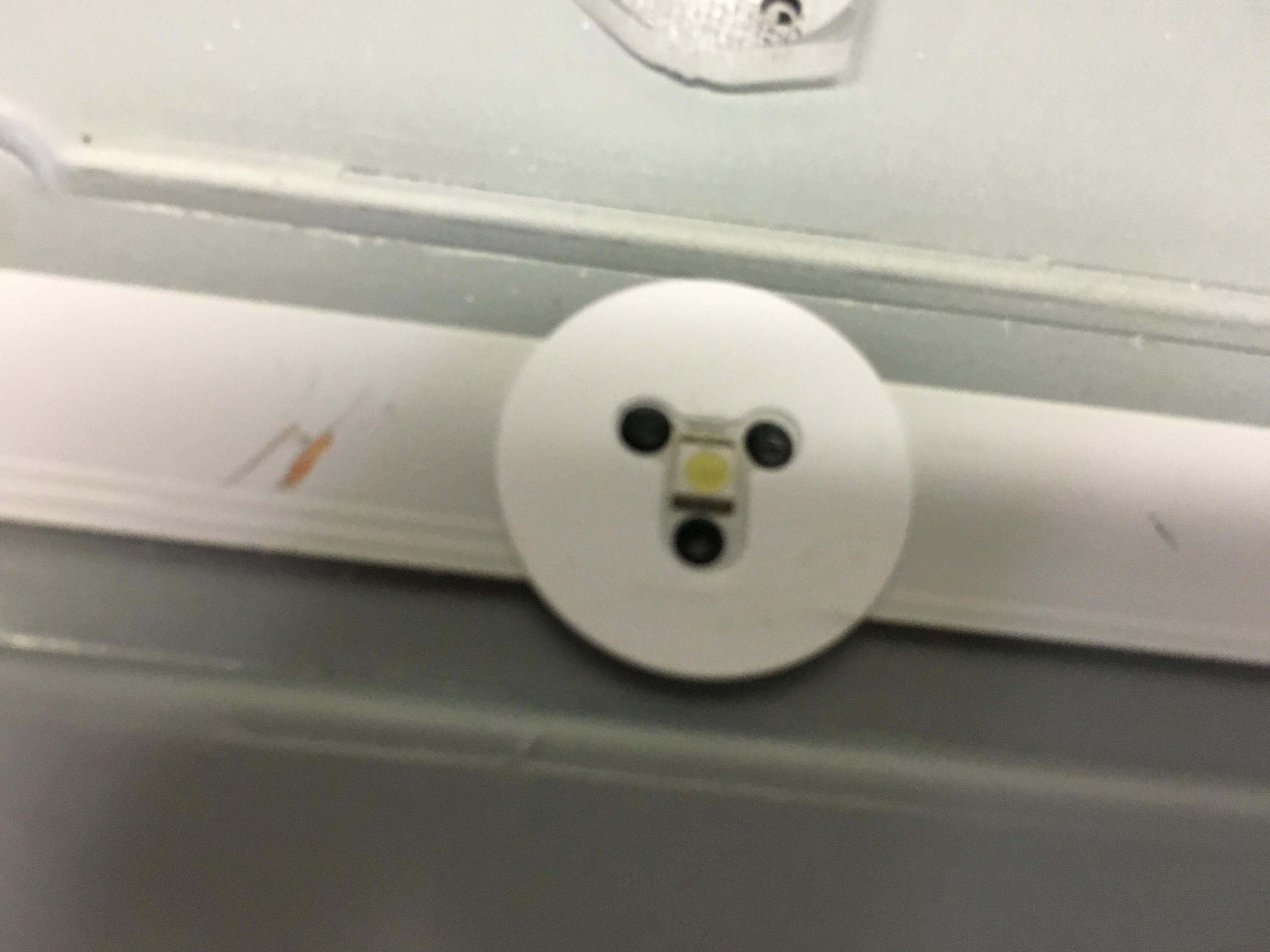

Hope this pic is ok. I did find the R1 strip for this on SJ, but I would rather buy a bunch of LEDs since the strips are expensive.
Would these work?
http://www.aliexpress.com/item/LG-In...de0c82fa&tpp=0Last edited by tech2014; 08-10-2016, 05:02 PM.Comment
Re: LG 50LA6205 No Backlight
They will work indeed, and let me thank you for that link because I've been trying to find proper rated ones for fucking ages ! Thanks
Hot air them on with flux at 380-400d air, then reapply fresh double sided tape to the reflector stick that on, then glue the lense on. Will you order those ?Please Do Not PM My Page Asking For Help Badcaps Is The Place For Advise, Page Linked For Business Reasons Only. Anyone Doing So Will Be Banned Instantly !
