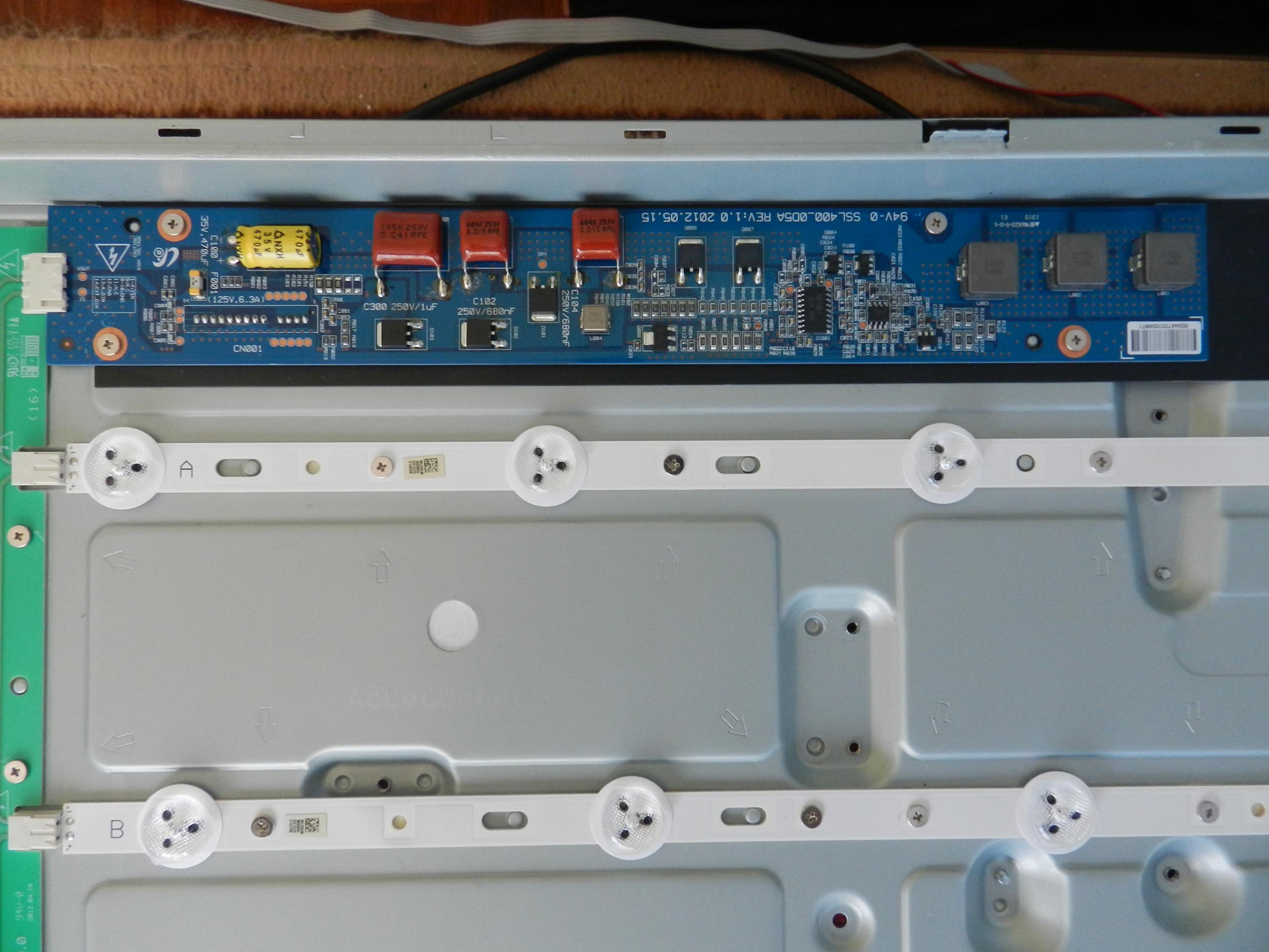

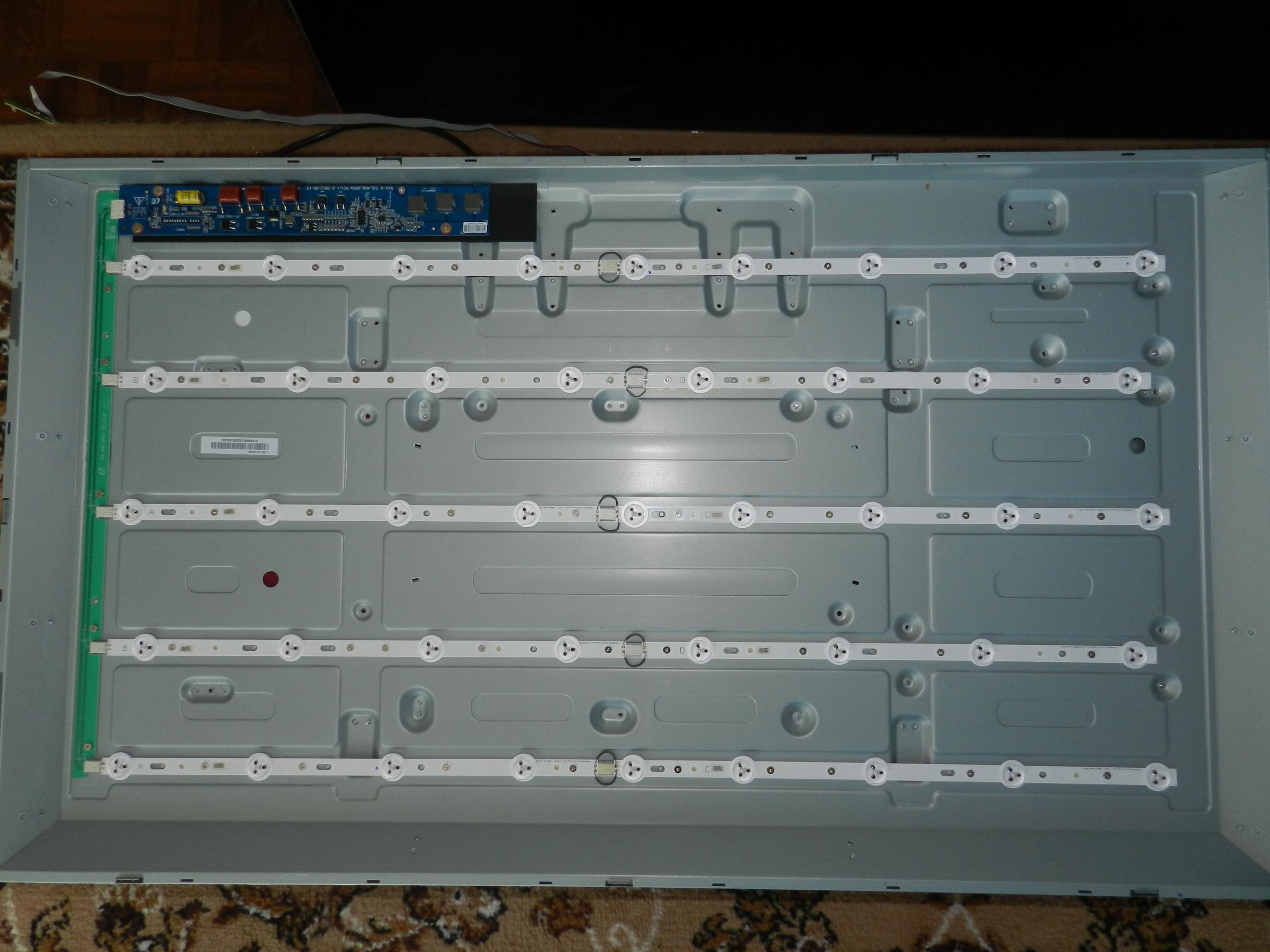

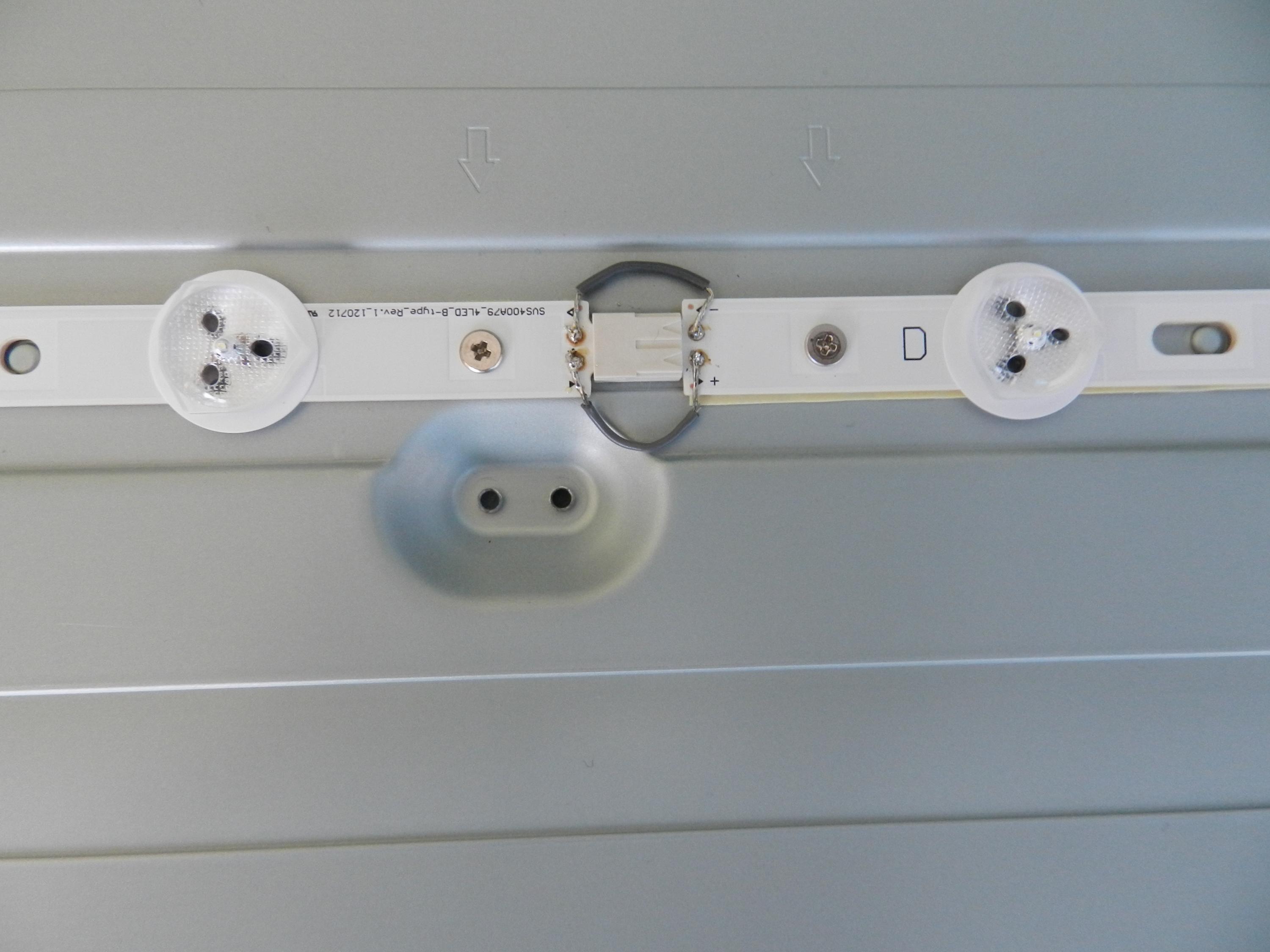

    I have a Toshiba 40L1333B with 4 failed Leds. It looks as though the set has been worked on before since the strip connectors have had wire jumpers fitted no doubt because of the poor connections.
    Before I buy a 5 led strip from Ebay (SVS400A79_5Led_C-Type_Rev.1_120712) has anyone in the UK a trashed set willing to sell the led strips at a reasonable price.
    If you can then please PM me.
    Many thanks

    Got to love that soldering, why dont you just replace the bad Leds with ones off another strip using hot air ?

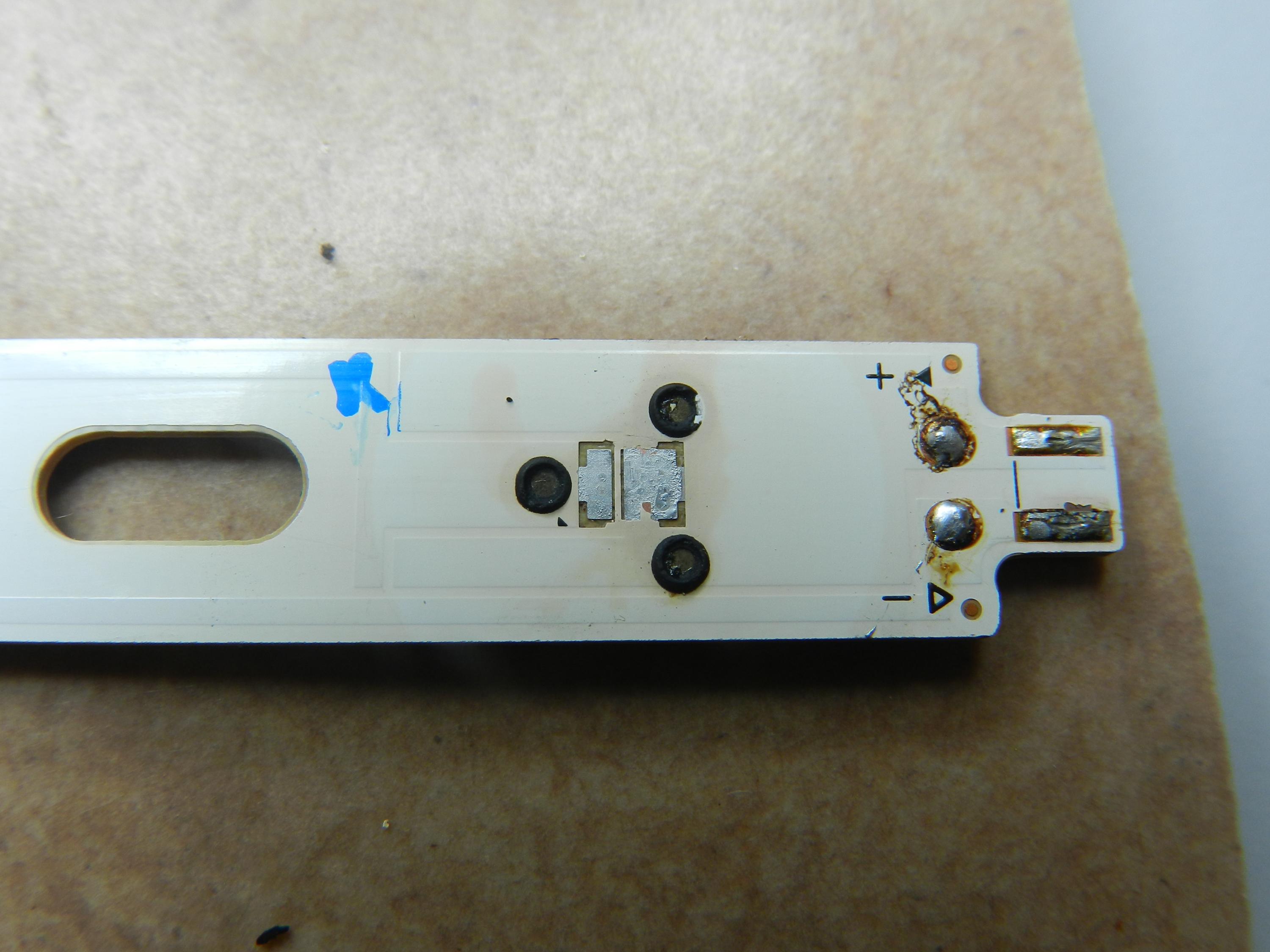

      Hello ReeceyBurger123
      I think it may have been a lot easier removing the faulty leds knowing that they are already duff but I'm afraid that I may have some failures in removing working leds off a strip to use as replacements for the faulty ones.
      I can buy a 5 led strip off Ebay and use that to replace the 5 led strip I already have that has 2 faulty leds on and then use the remaining 3 good leds from that faulty strip to repair the other strips. That would allow me one mistake.

                                      Well I must admit it was a lot easier than I thought.
                                      Removed the 3 working leds from the 5Led strip and used them to repair the two other faulty strips which have been tested and are up and running.
                                      Now I'll order a 5 led strip to and I should be up and running again.
