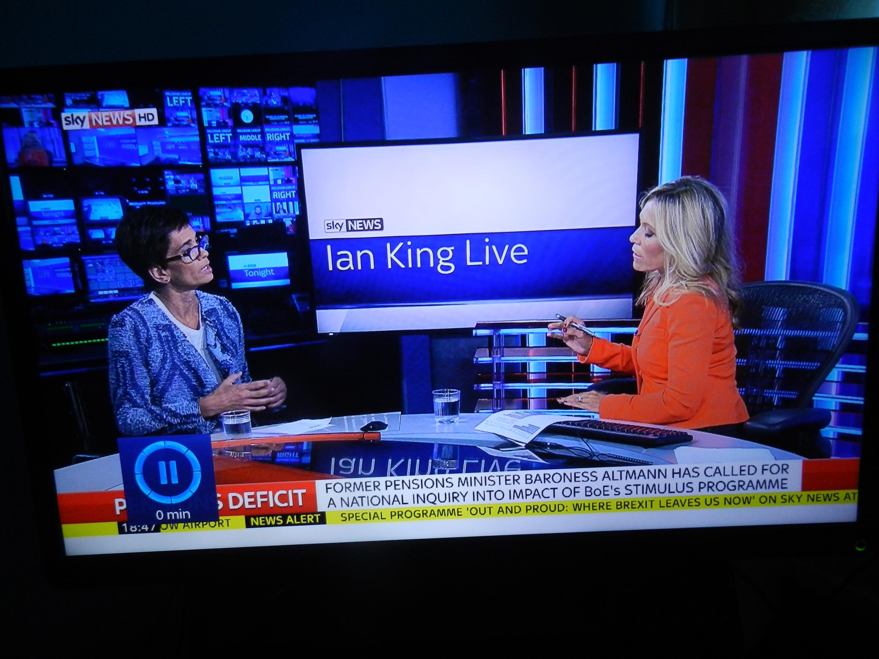

    The 2 replaced leds were done by direct replacement so I'll order a 5_led strip and job done. (1 left as spare)

      Innit funny........
      Ive got the same set here also been worked on before--and oddly with the same grey jumpers between the led strips...
      mine had 7 faulty leds....

        Re: Toshiba 40L1333B -Led Strips
        Not a very good advert for Toshiba.
        My 4 faulty leds were spread over 3 strips. 1 on Strip_A, 1 on Strip_B and 2 on Strip_C
        Repaired Strip_A and Strip_B using leds from Strip_C which was a 5 led strip having 2 faulty leds.
          Even worse for whoever worked on these two around here--and Didn't replace the S/C ones, only the O/C one!
            Thats sounds like a poor repair and I wouldn't have put my name to it.
              reece has a good video on the stacking method i know flocko sells replacement leds if needed, the only diffrent thing i did was once i removed the old led of the strip i placed a bit pf kapton tape over the old led pads then i just fix the new led via the stacking method.
                Cheers Vince, also these panels-LTA400HM23 are total trash I have a 40" Technika 40-E271 in atm same panel. Epprom is corrupt meaning Tv stuck in standby however I will be tearing the panel apart and bridging them little contacts over and checking for any SC Leds.
                This is a must do on these LTA400HM23 panels if not the set will fail in no time flat. Junk !
                  Set up and running. Job done.
