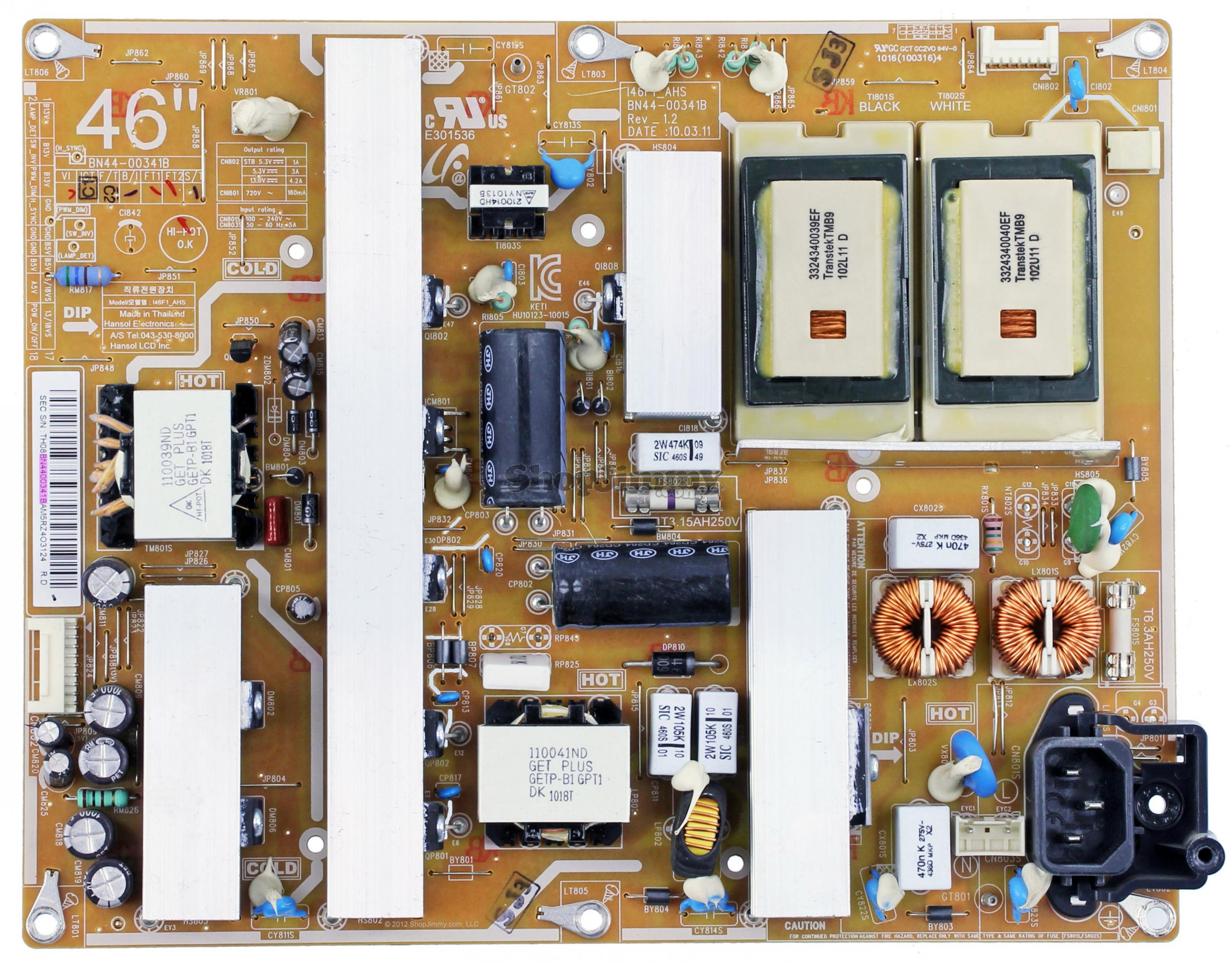

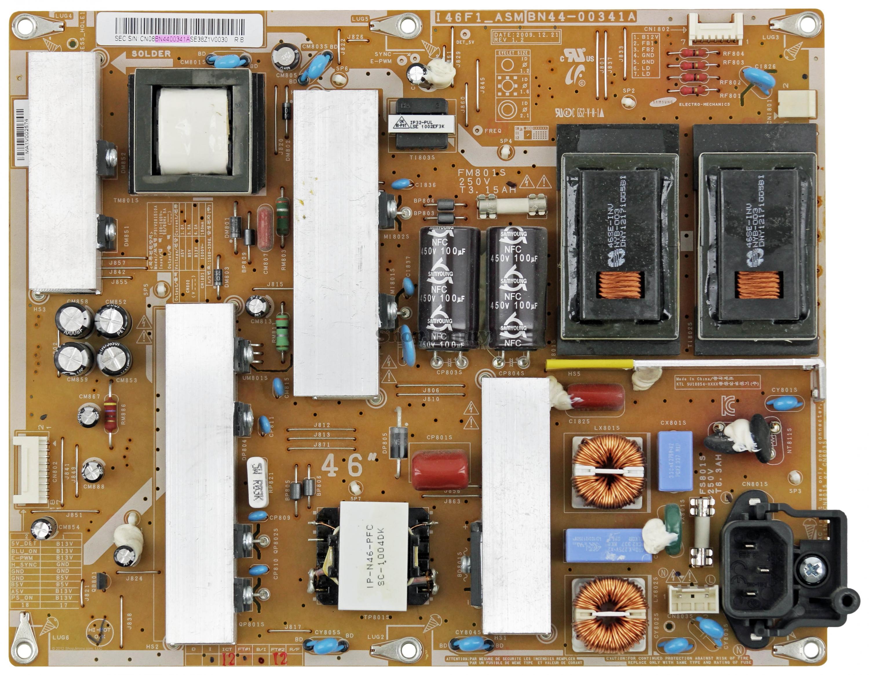

    Hello Guys and Gals,
    I have a 46" that wont turn on, standby light flashes four times slowly then one time fast then repeats. No clicking or noises from back of TV.
    All caps look good and voltages look good. When Mainboard is disconnected from PSU and power button is pressed the backlight comes on. Another forum post suggested this shows it is a mainboard issue.
    I found a burnt 5w resistor on psu and a few of the mosfet leads around this resistor look dry, I have resoldered the connections but not replaced the resistor.
    The resistor is marked 5WR05K what Ohm value is this? 5w 5k ohm resistor?
    Do you guys have any past experience with this model of TV or PSU?

    Re: Samsung - LE46C750R2K - BN44-00341A PSU - No Power
    Posting pictures of the back of your tv showing the boards with clear pictures may help you more with fixing your problem
      a shopjimmy picture is here showing the resistor in question RP821
      http://assets.shopjimmy.com/media/ca...341a-top_1.jpg
      I have had a quick look but cant find any information regarding it im sure budm maybe able to advise on what can be fitted there.

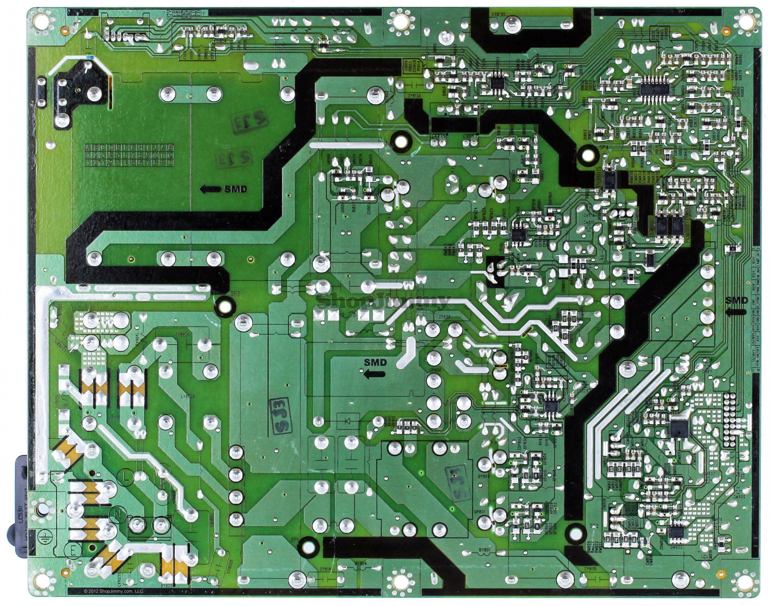

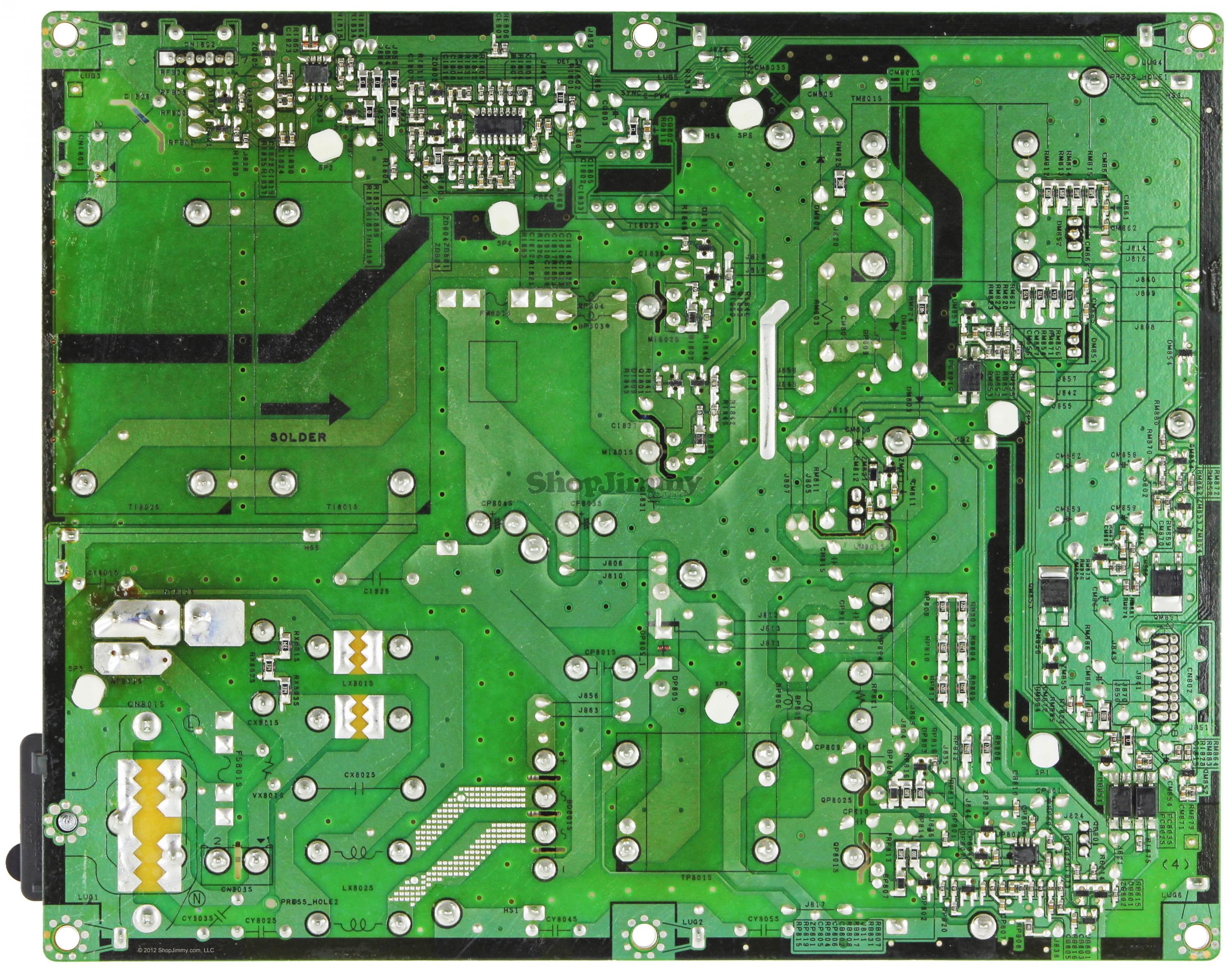

        Spot on Vince, it is RP821 but that shopjimmy link doesn't work for me. I can only find board schematics for the B Revision of the PSU and RP821 on the B revision is a completely different resistor.
        Images below, let me know if you need any more detailed pics I have a DSLR at home
          0.05 Ohm 5W 10% TOL.
          That section is the PFC Voltage booster circuit, the resistor is connected to the Source pin of the PFC MOSFET.
          Does it show open circuit?
          Pictures provided by shopjimmy.
          Your pictures are too blur for me.
          You have to report the DCV readings on the connector of the power supply board that goes to the main board first, make sure to put the pin names and pin numbers follow by the DCV reading so we can see what are missing.
