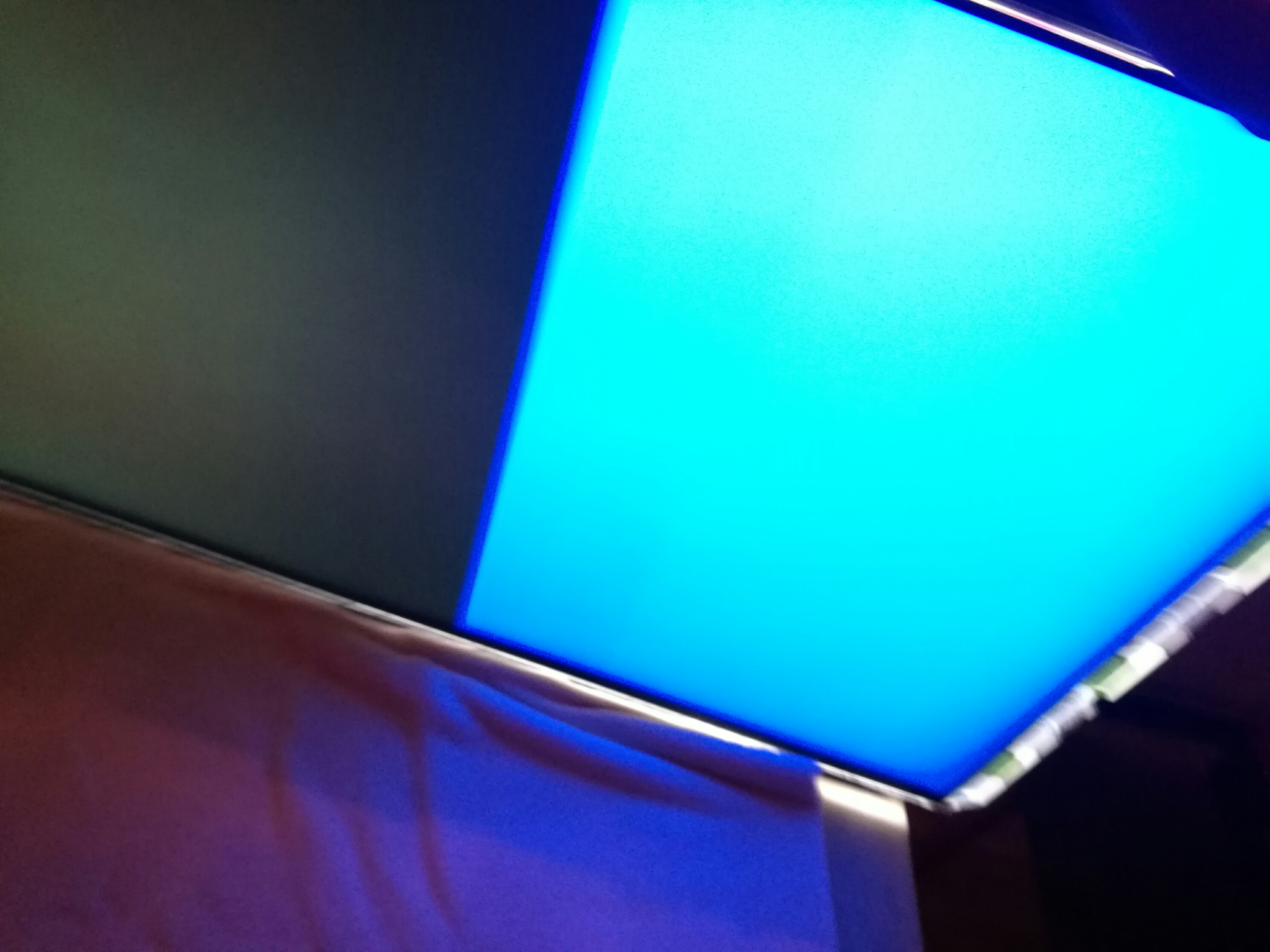

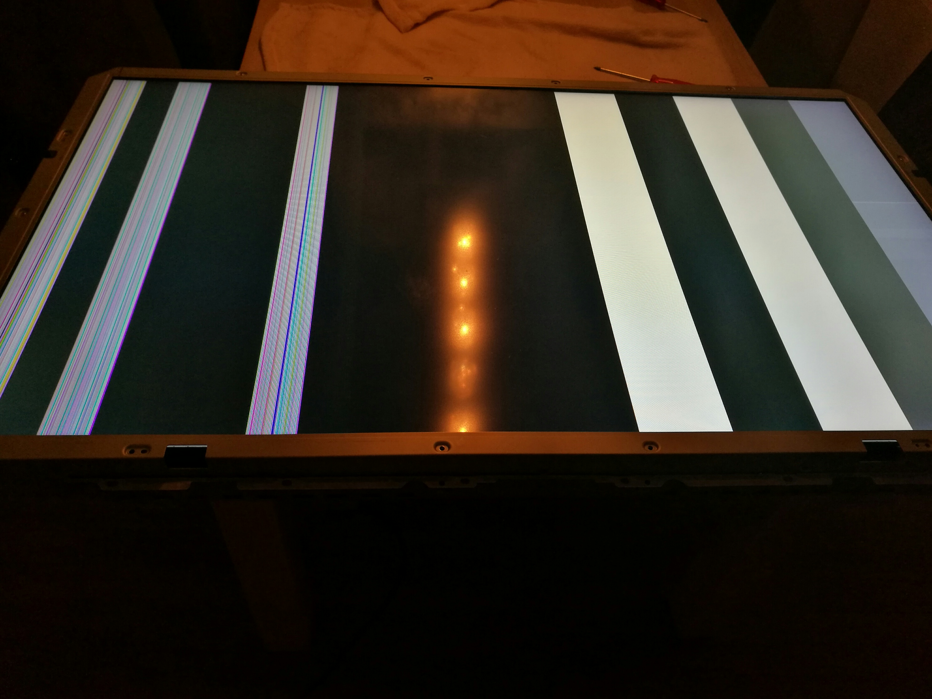

    On cold start it comes on with a half dark image with "no signal". Looks like half of the backlight is not working and then the image changes as on the pictures.
    Thought it was a panel problem so i removed the bezel from the lcd and pressed on the tabs but nothing happens. I do see some minor changes but thats just the pressure.

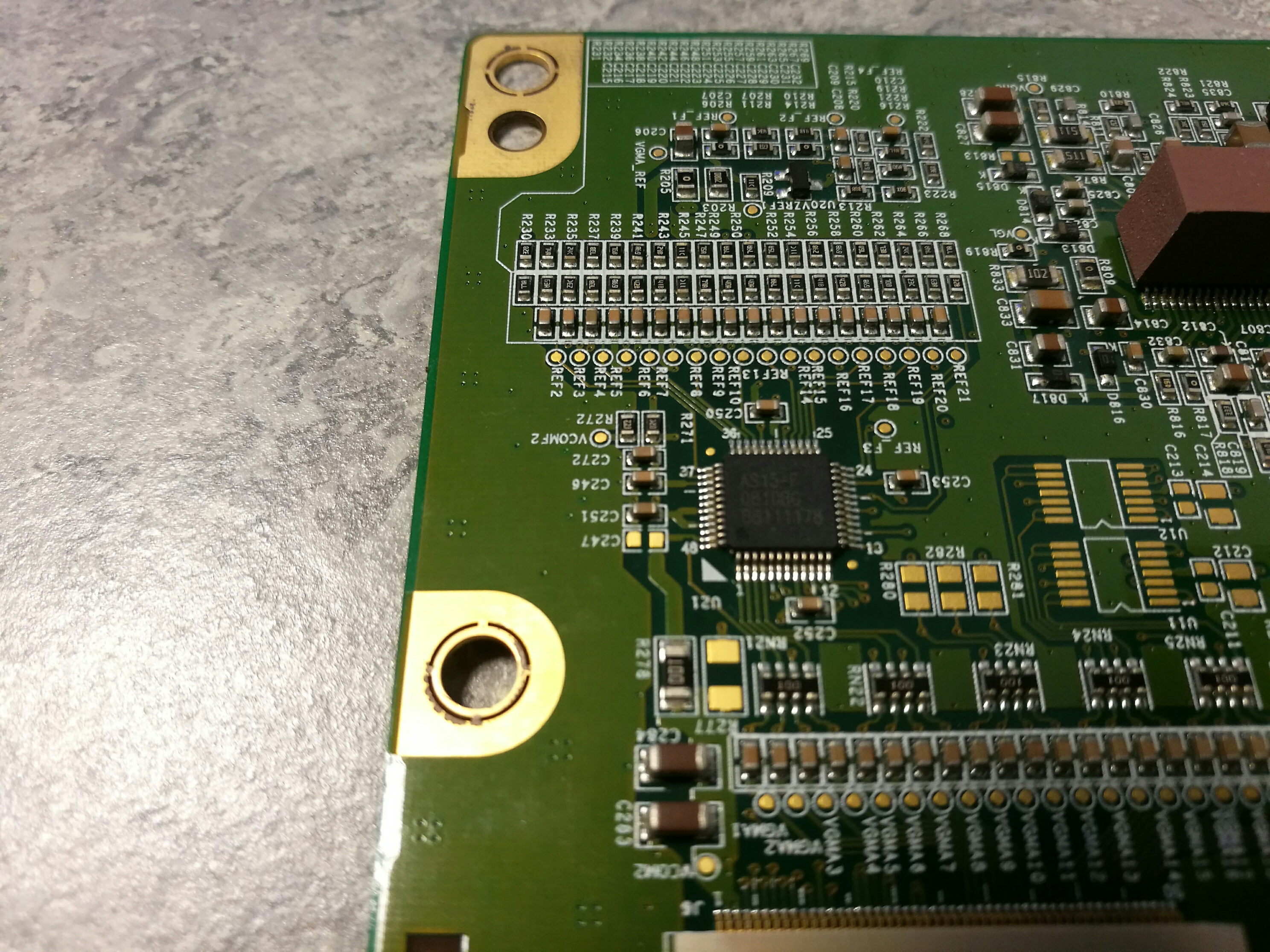

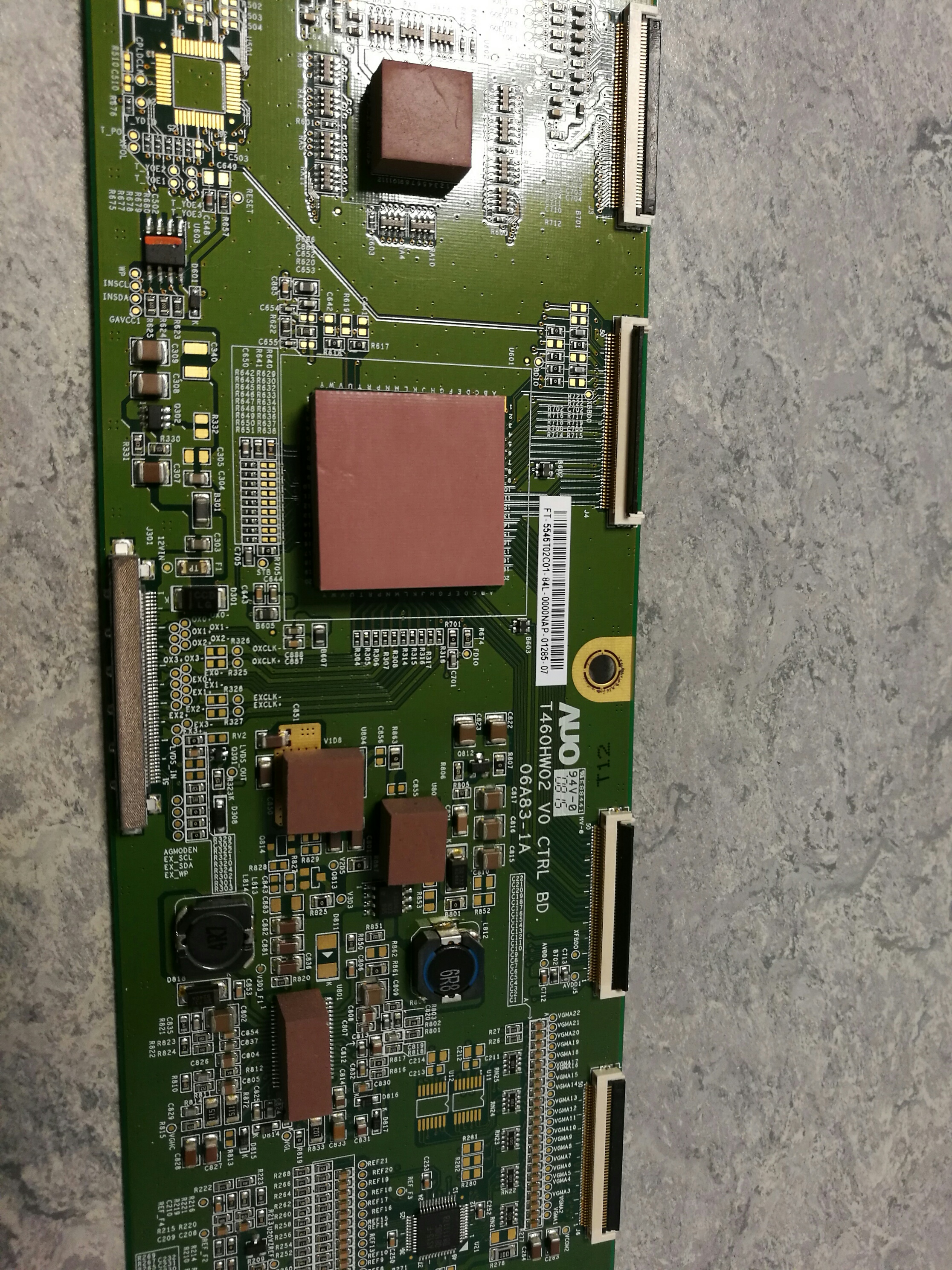

    T-con is the T460HW02 V0 CTRL BD / 06A83-1A
    Fuse on the T-con is ok , i did not have the time to measure the gamma voltages but was wondering if this is a known problem for this t-con board or do i have a bad t-con?
    No bulged capacitors on the powersupply , will replace them just to be sure.
    Will replace the AS15 chip tonight.
    Any suggestions?

    Seems like Tcon to me, got a scope to check the lvds output from it ?

      Replaced the as15-f chip but same symptom. Removed the tcon from the tv and reseated the cables and now it wont turn on with tcon board connected to mainboard.
      Removing tcon and tv turns on with just backlight. So still bd tcon or lvds cable or mainboard....
      How can i test this?
