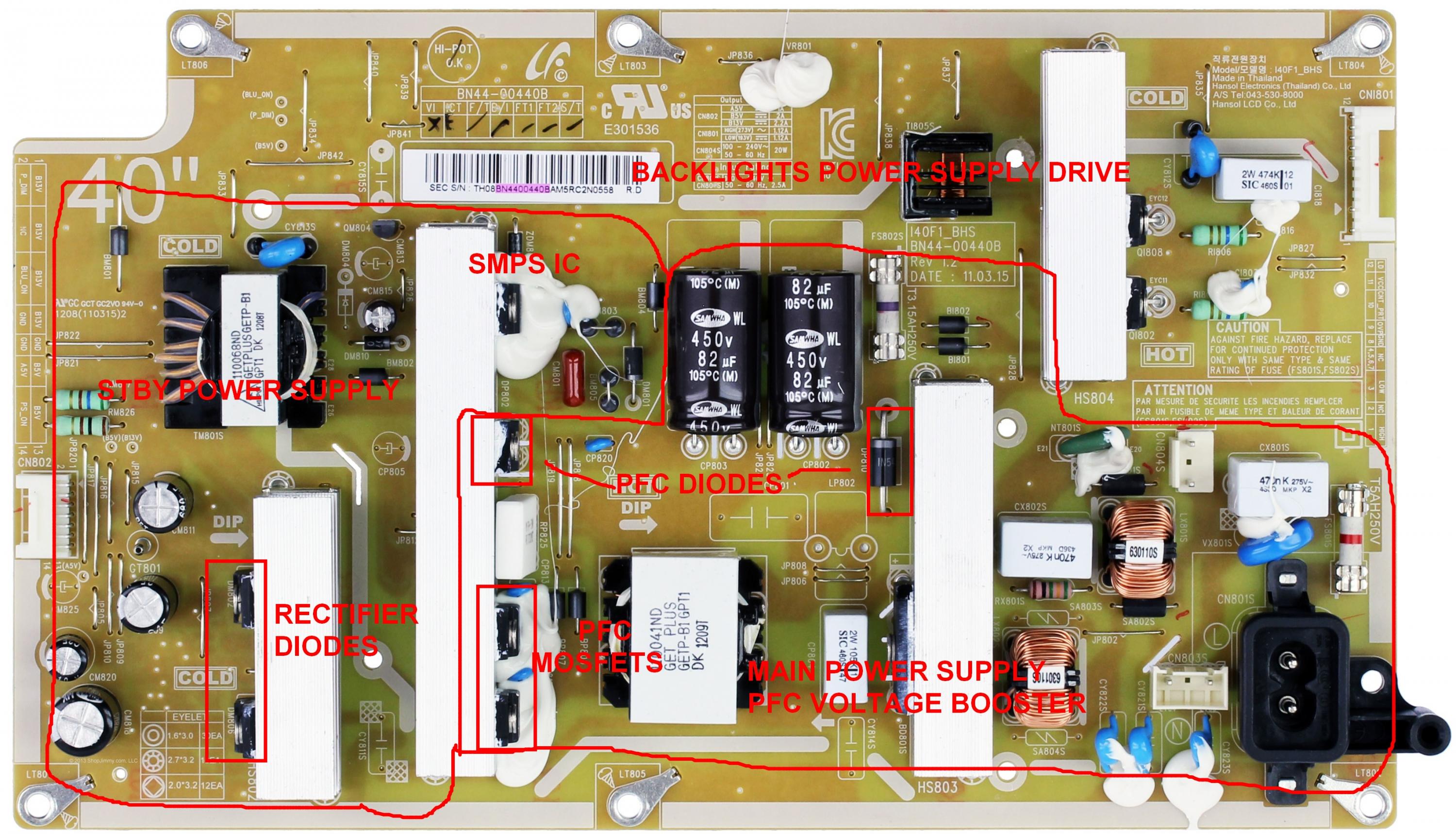

LN40D503F6F with no standby voltage(or light). No standby voltage on pin 13 (disconnected nor connected). Found the BN44-00440A schematics however some of the part have changed on the board. (ex connector CN802 on 00440A is an 18 pin and the 00440B is a 14 pin). Scats would be helpful and thanks.

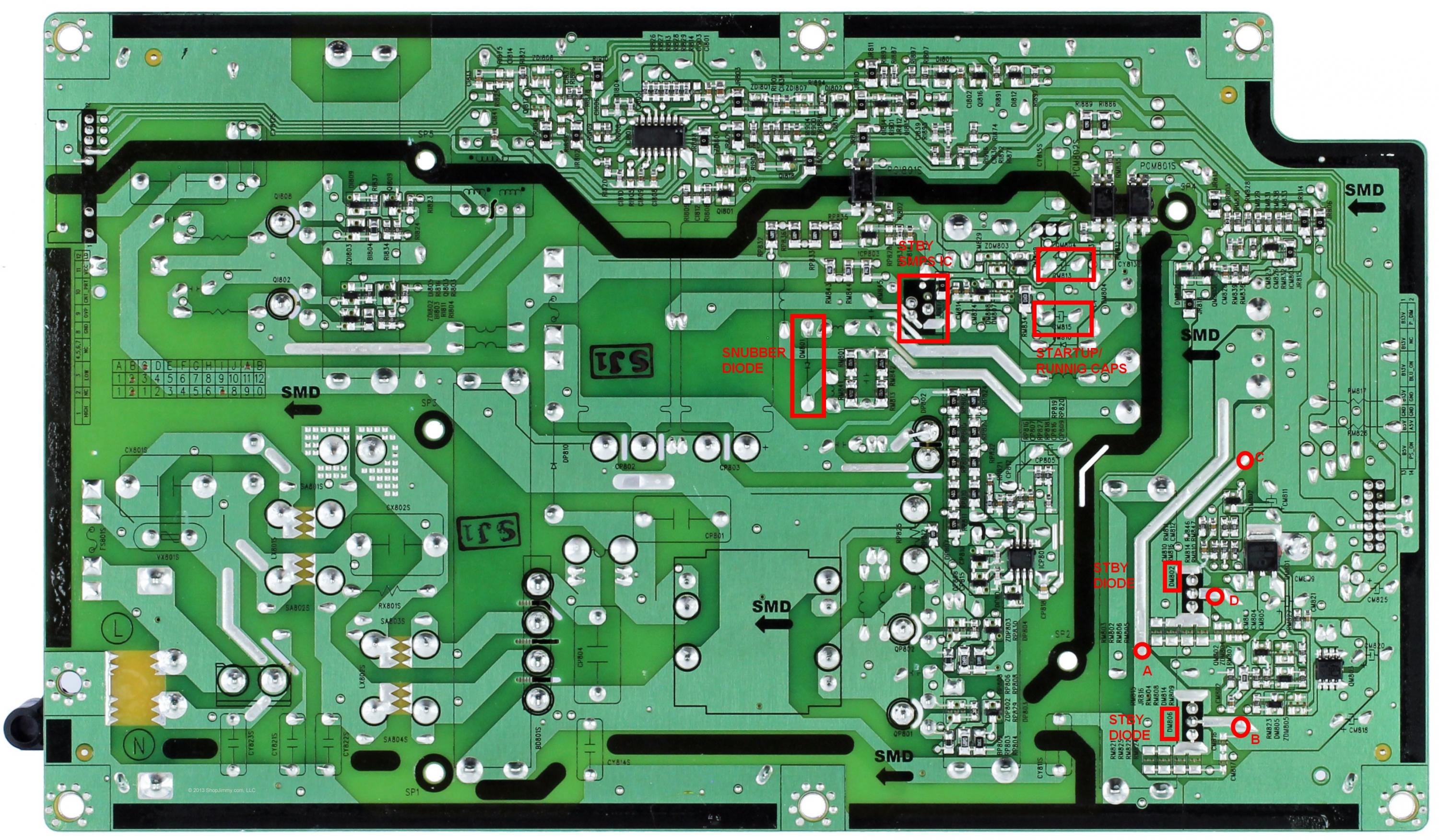

You need to check the resistance between point A and point B, point C and point D.
Check the capacitance and the ESR of the two startup/running caps.
Check the snubber diode.
Get the P/N of the STBY SMPS IC.
Pictures provided by shopjimmy.Attached Filesif you find these attachements useful please consider making a small donation to the site

No need to lift any parts' leads yet, just the resistance check between the two points to verify if the diodes have low resistance reading between the legs.
If it shows low resistance in both directions then it will have to be removed and retest. We just want to know if those two rectifier diodes are bad or not.Never stop learning

A-B: 135 ohms both directions
C-D: 1.5 Mohm reverse 2 Mohm
Both starting caps: 5 ohms
snubber diode: 46.8 kohms
P/N of the STBY SMPS IC: looks like D8230DS or DB230DS but I couldn't find online as it was difficult to read.Comment
Re: No power bn44-00440b
"A-B: 135 ohms both directions"
This reading for the rectifier diode DM806 is not right, you need to remove it and test it off the board.Never stop learning
