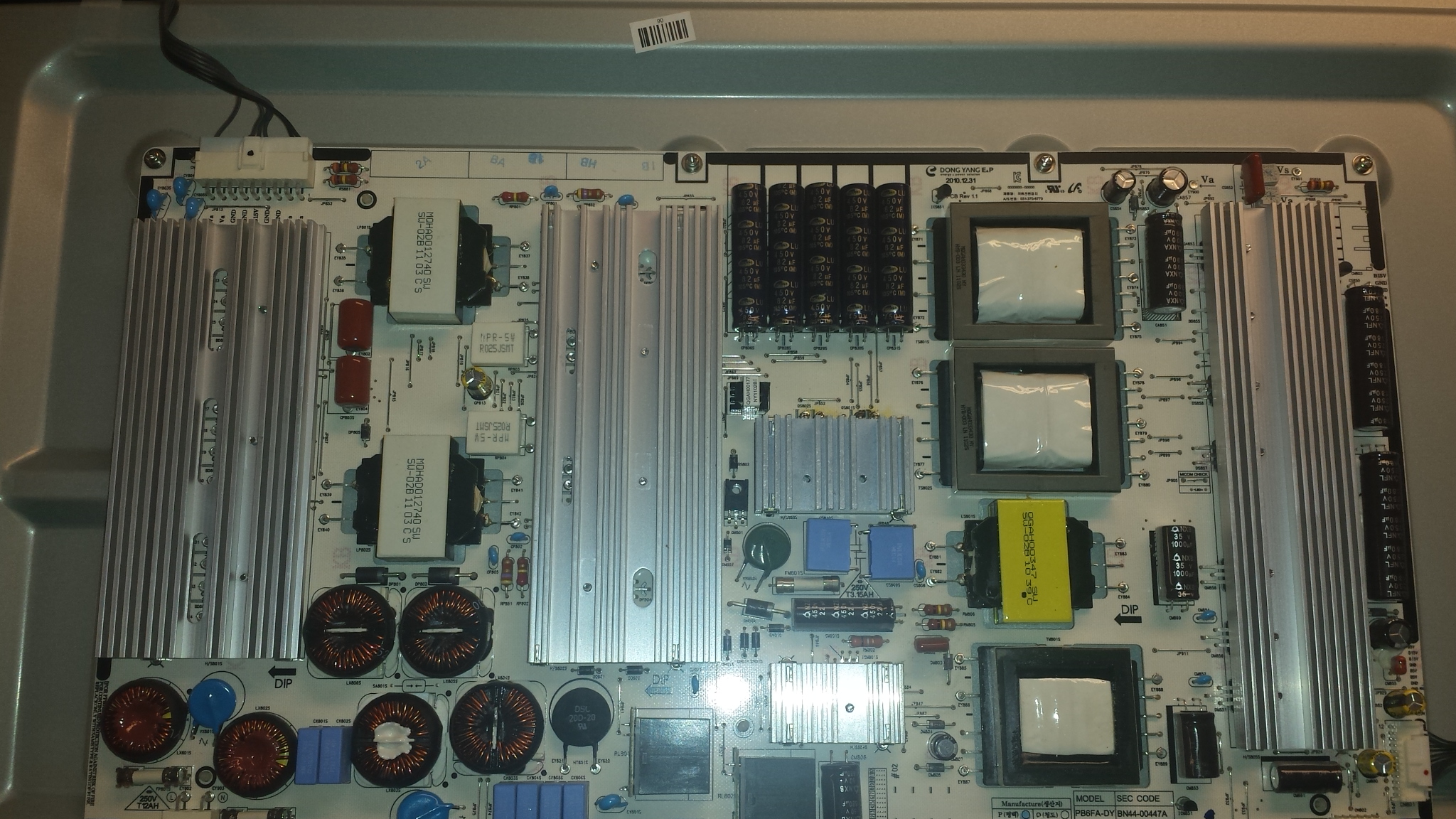

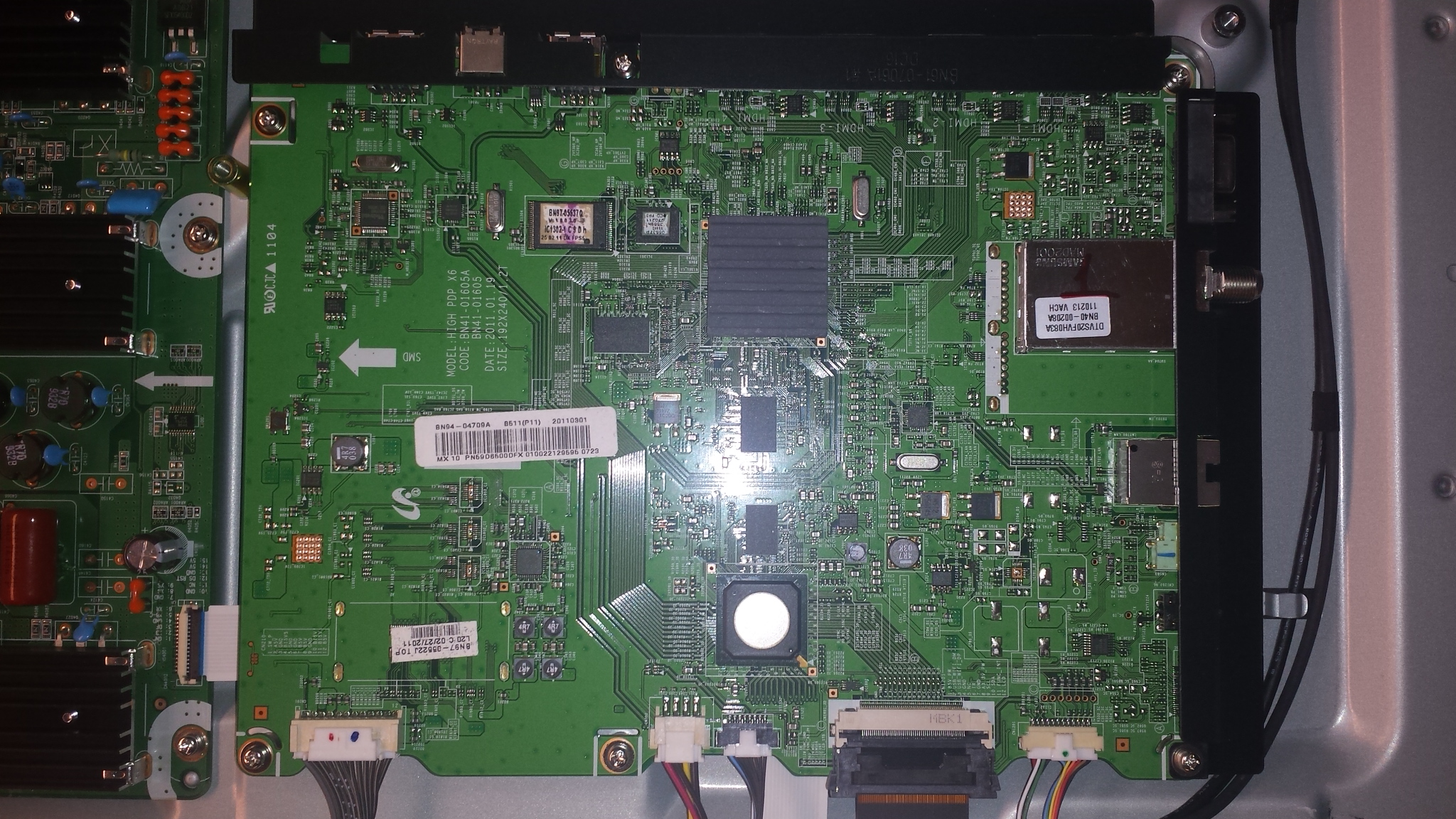

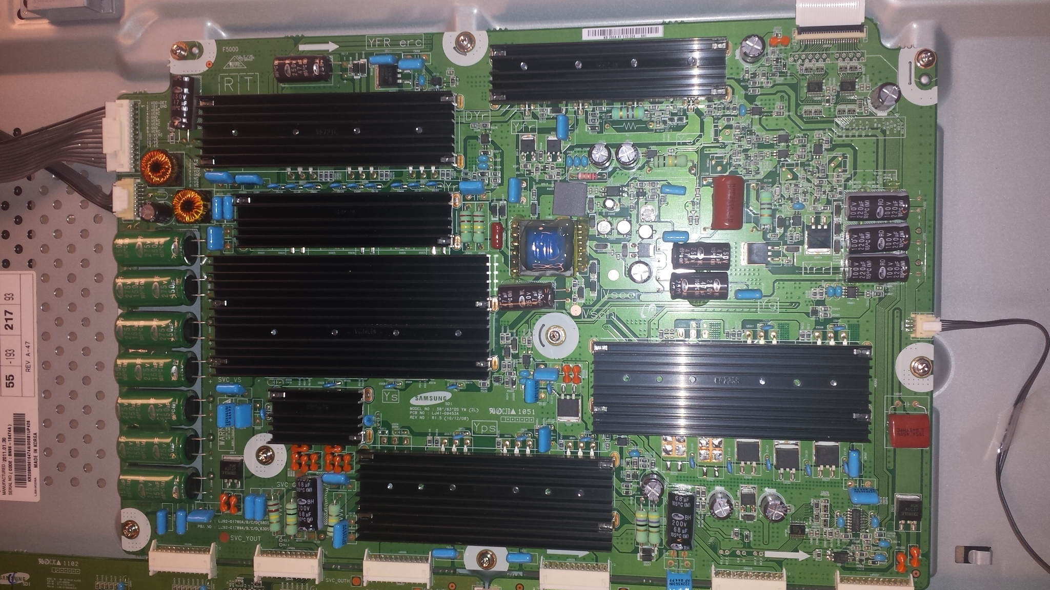

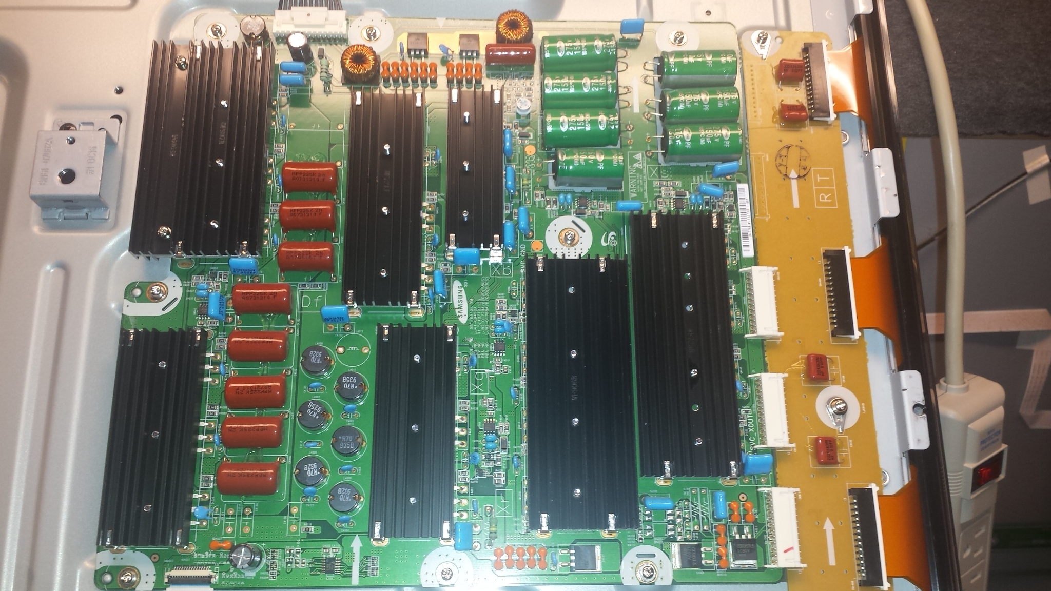

    PN59D6500FXZA Clicking On/Off
    M.B. BN94-04709A. Y board not shorted, Z not shorted. Vs 217vdc, VA 55vdc. P.S. cycles on/off. CN801 #1 low and CN801 #6 3.2 vdc. The swap low/3.2 vdc when cycling.

    Re: PN59D6500FXZA Clicking On/Off
    Sorry CN 801 #1 and CN802 #6 swap high low.
      Really late to the party here, do you still have issues with this model?
      I don't want to just call it in advance but you more than likely have a bad main board if the tv turns on stays on for a few seconds to a minute and then shuts off and cycles back on.
      All these model main boards are compatible with one another
      BN94-04689A
      BN94-04689B
      BN94-04689C
      BN94-04709A
      BN94-04728A
