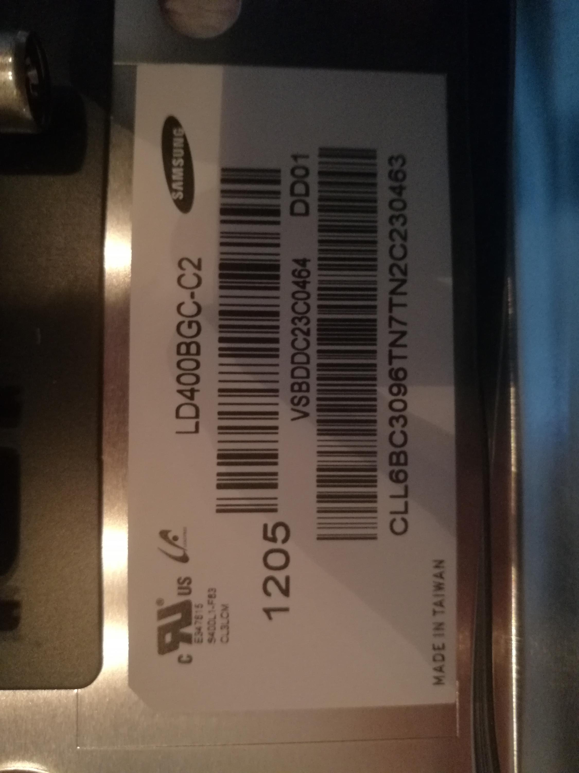

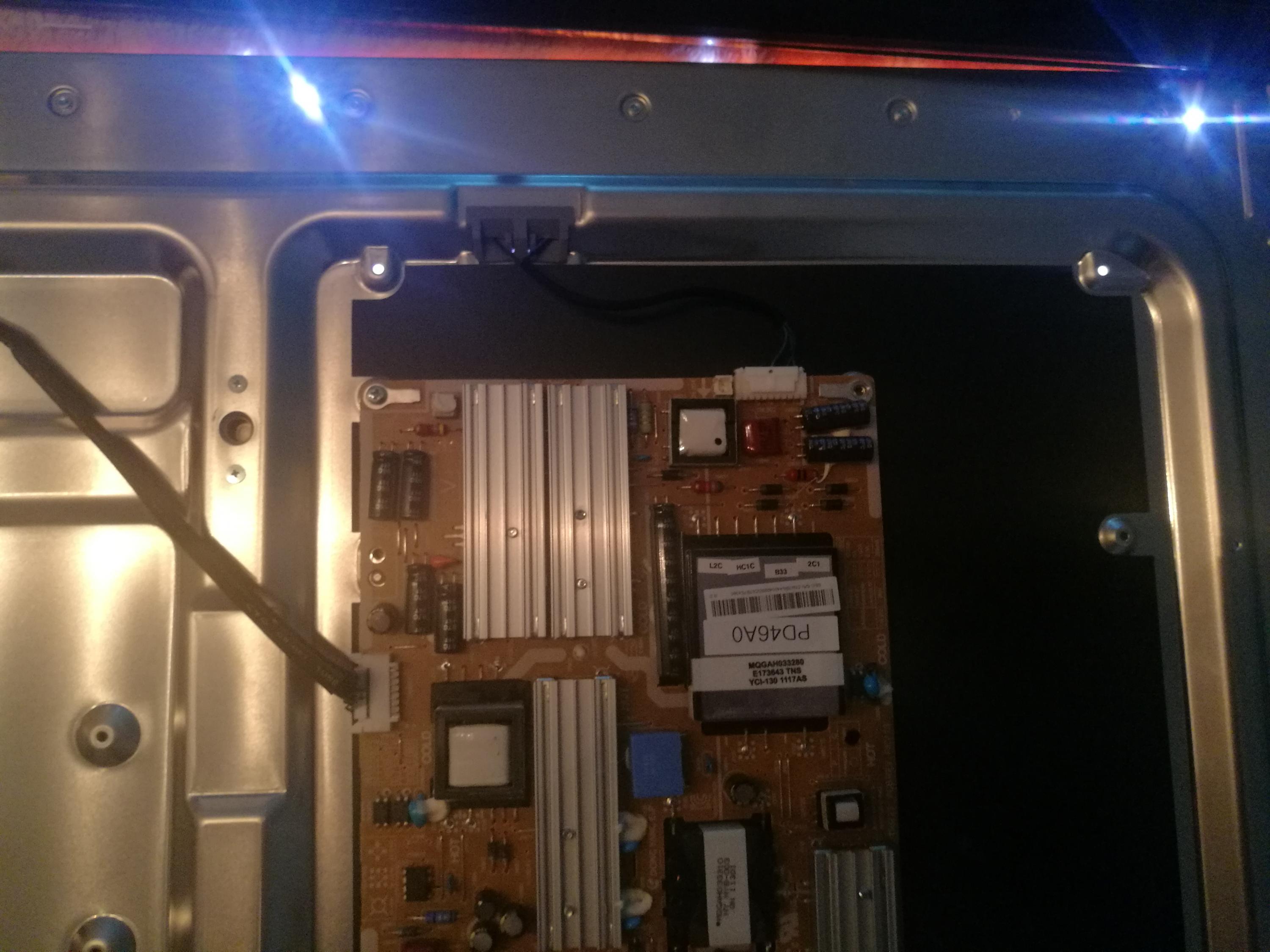

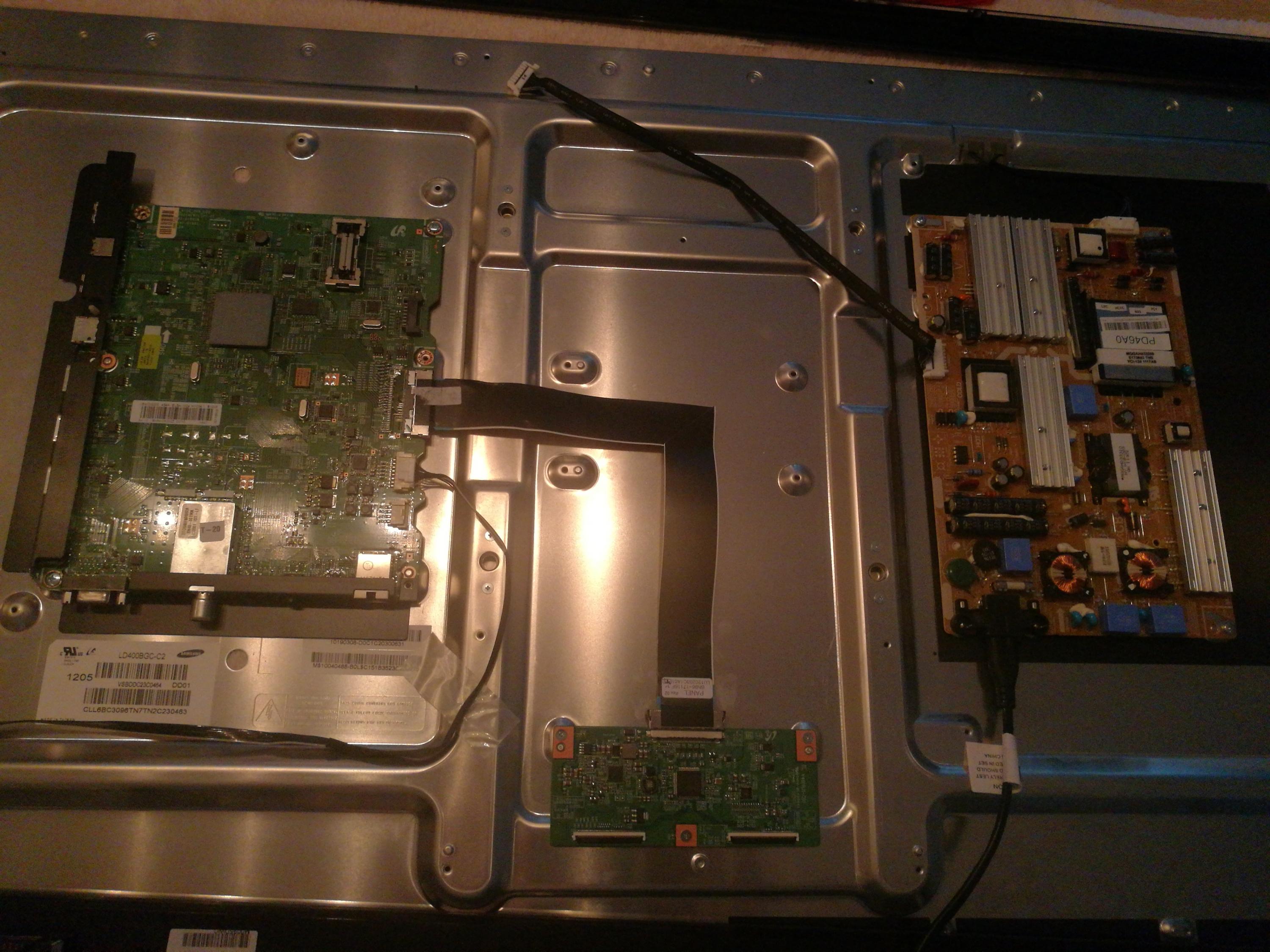

    Hey guys ,
    Working on my very first LED tv repair.
    Bought it with the symptoms that the screen just went bla k.
    After searching this forum i found out that this model has alot of problems with the led failing.
    I removed all parts carefully untill i reached the leds and they are visibly ok.
    Reinstalled the boards and nothing but 5 blinks. No backlight.
    Removed the cable between the mainboard and the powersupply and the backlight turns on. All leds are working.
    This make me believe that the mainboard is not turning on the backlight OR tv. I dont hear any sound and there is no image visible on the lcd with a flashlight.
    Bad mainboard?

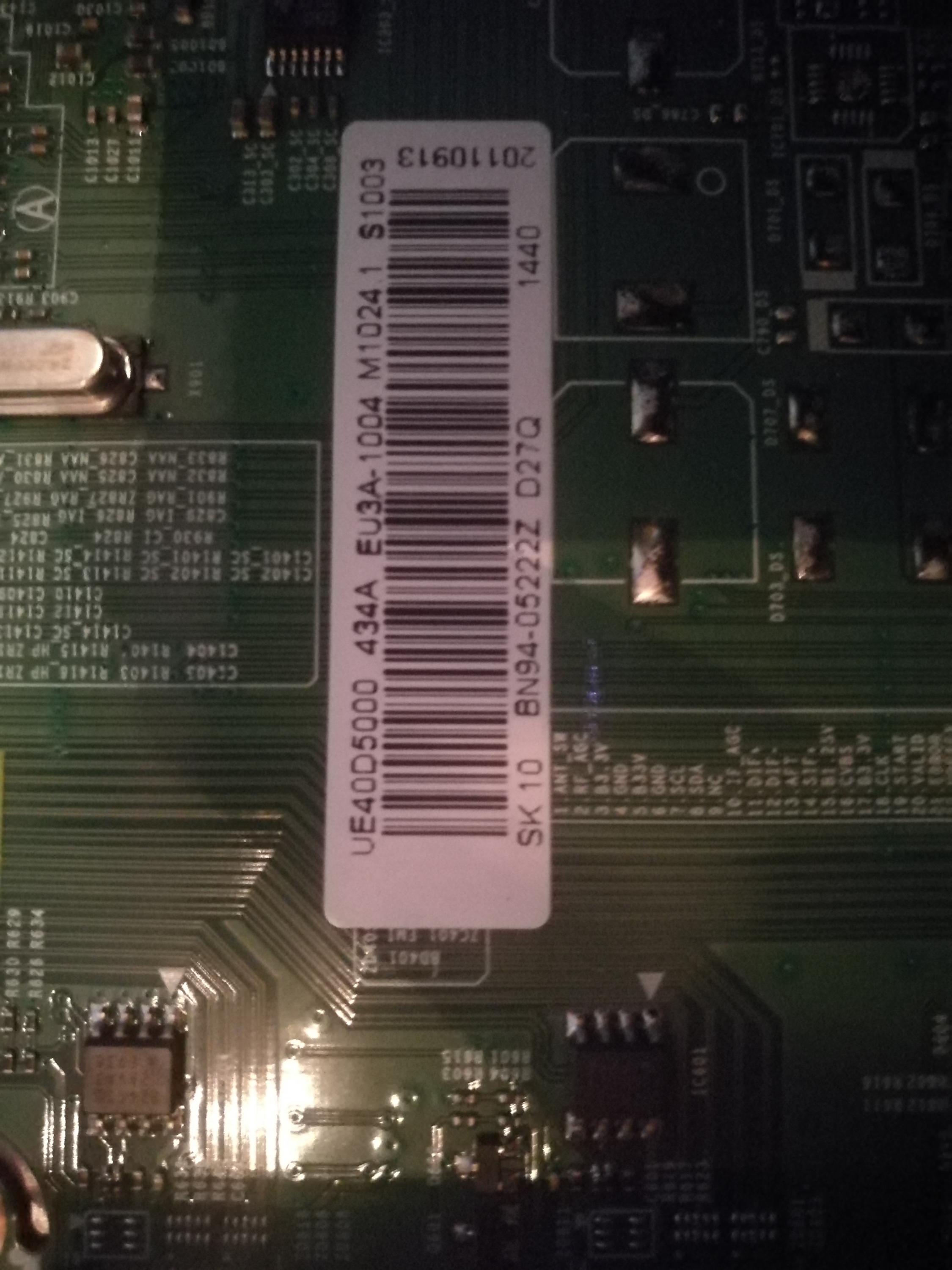

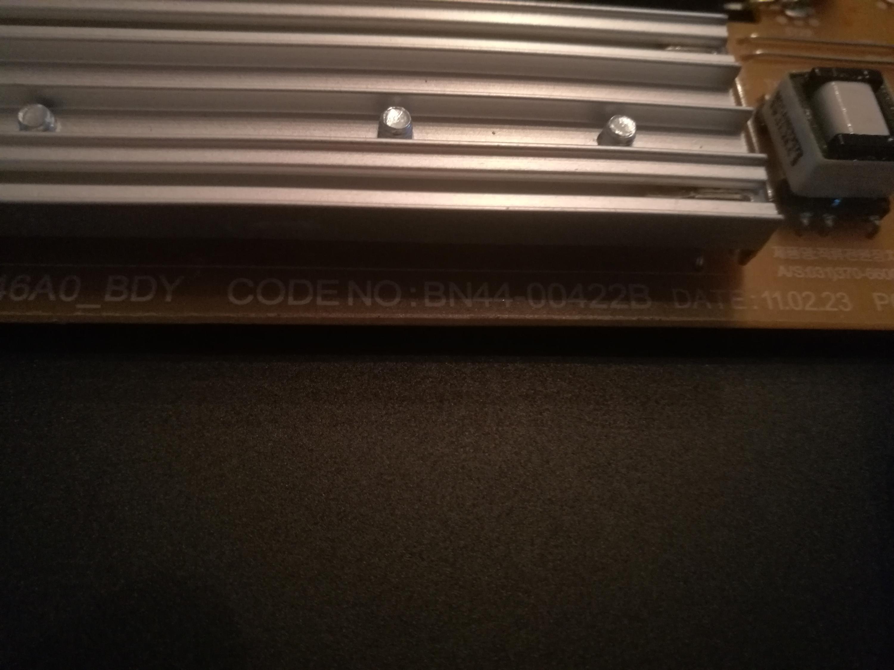

      Ps , voltages on the powersupply are all good. 13 and 5v present.
      When i turn on the tv the led is blinking 6 times and then goes away. Only responds to the remote , not to the touch.
      Already tried a eeprom reset but still the same problem. I'll reflow the cpu and see what happens.

        Common issue failed Bga solder on the cpu, have the same model same issue. Also had the C5000 same issue crappy small heatsinks on bga chips never good.

              Re: Samsung UE40D5000 , Does not turn on.
              Thanks Diah but its not a shorted touch panel.
              I did what Reecey/Budm said and reflowed the cpu. Added some flux and heated the cpu for 3 miutes and let it cool for 20 minutes.
              Installed the board and backlight came on. Will install the panel tomorrow and see if its working properly.
              Thanks buddys!
