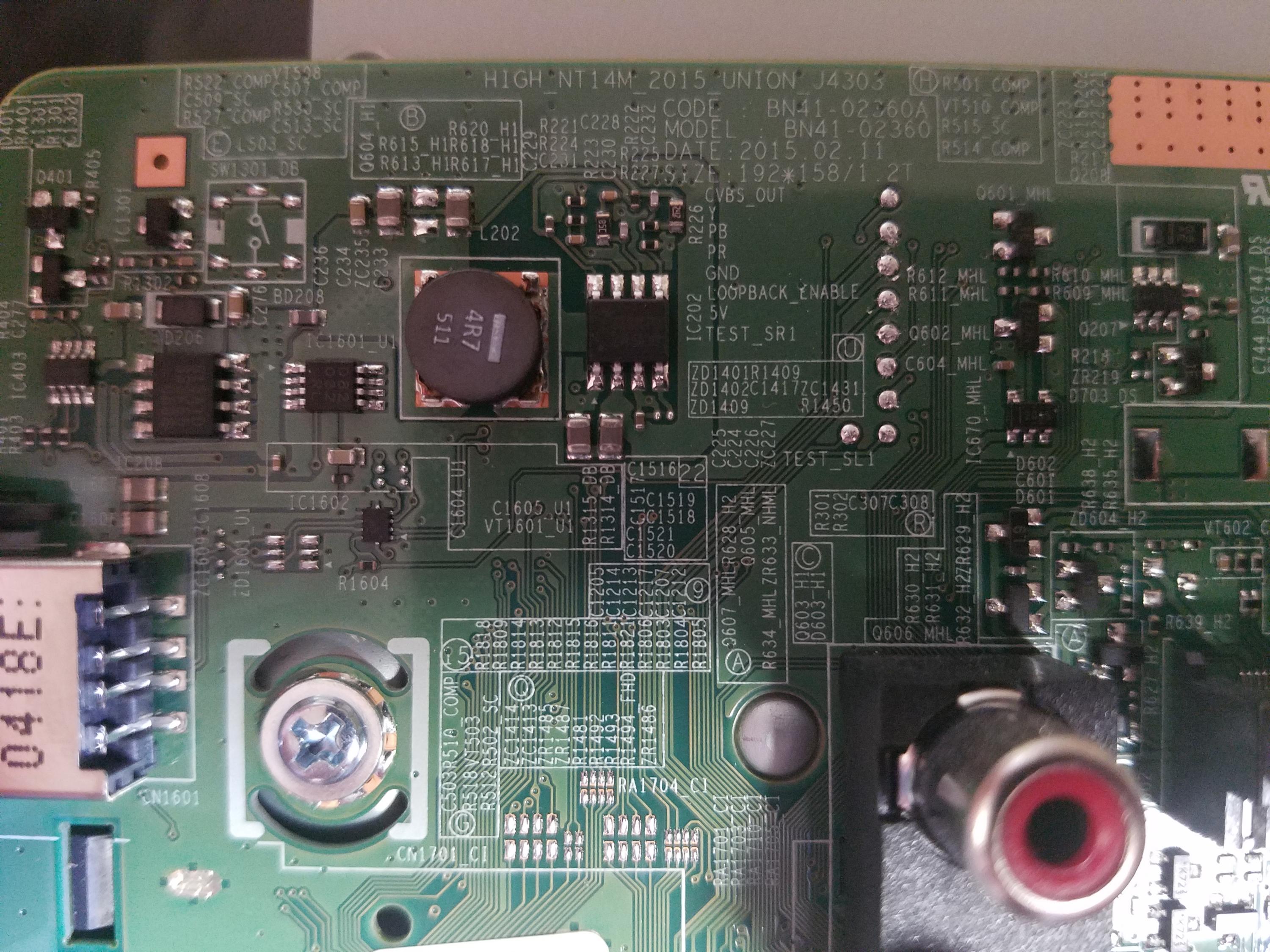

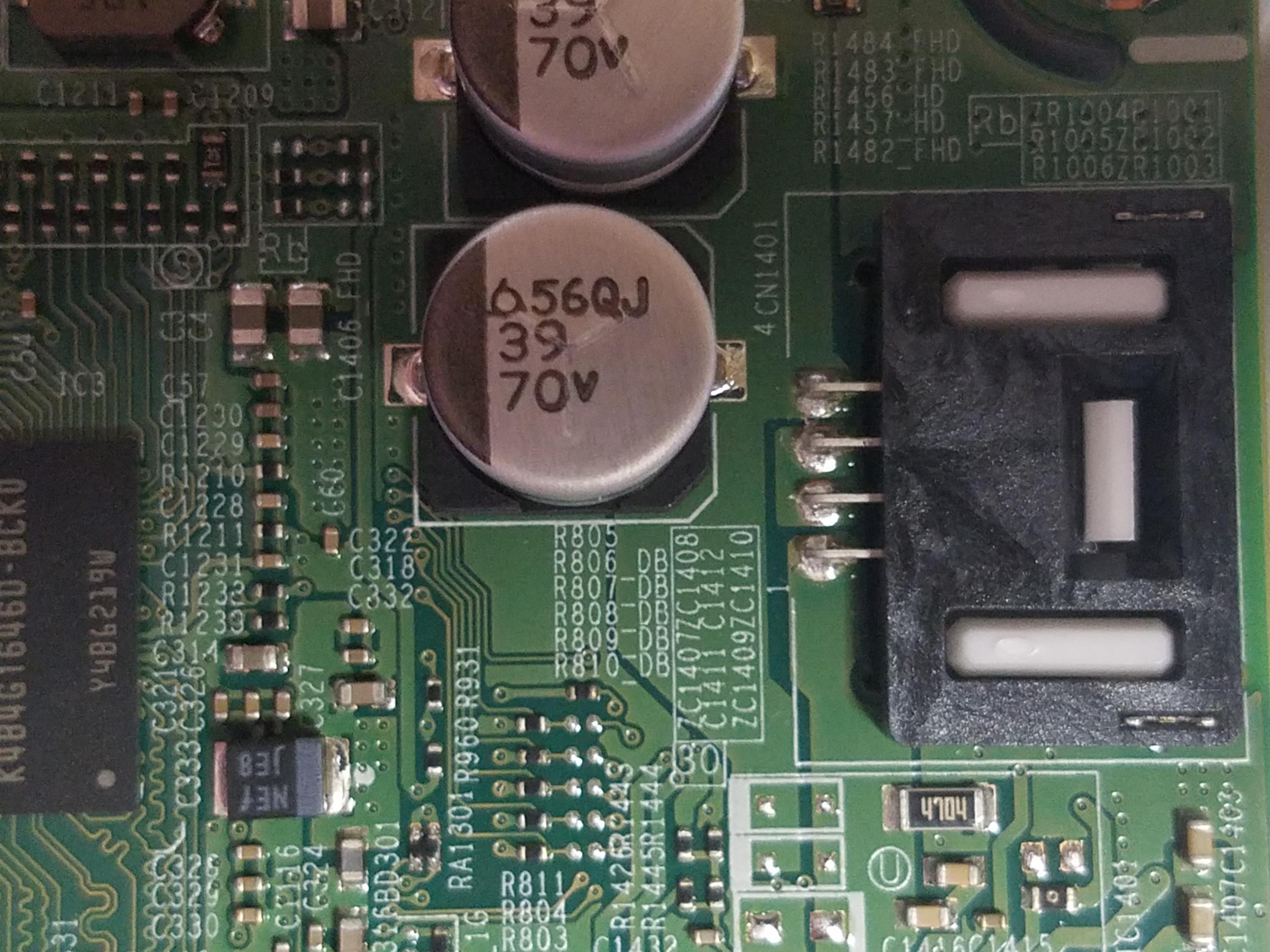

    I have a 32" Samsung that will not turn on. I have power. The power button will light and flash like every other samsung when it starts. I do not have back lights or a tone when the tv starts. The power supply it built into the main board. When powered on the digital audio out lights up. There are two blue led lights on the t-con board. If all hooked up both lights stay on steady. If either lower cable to the screen is unhooked only the top light lights up. I have unhooked both lower cables, the cable to the t-con and unplugged the led lights and still no power on chime. I believe this is a bad program on the main board. Testing showed these voltages on the pin outs.
    cyb5_out .566 v
    y 51.7 v
    pb 51.7 v
    pr 0 v
    gnd 0 v
    loop back_enable 3.321 v
    5v 4.92 v
    test_sr1 0
    test_sl1 0
    Top to bottom of the led power supply pins
    14.04
    .674
    .672
    3.96
    I could not find any similar tvs to mine listed in the forums.

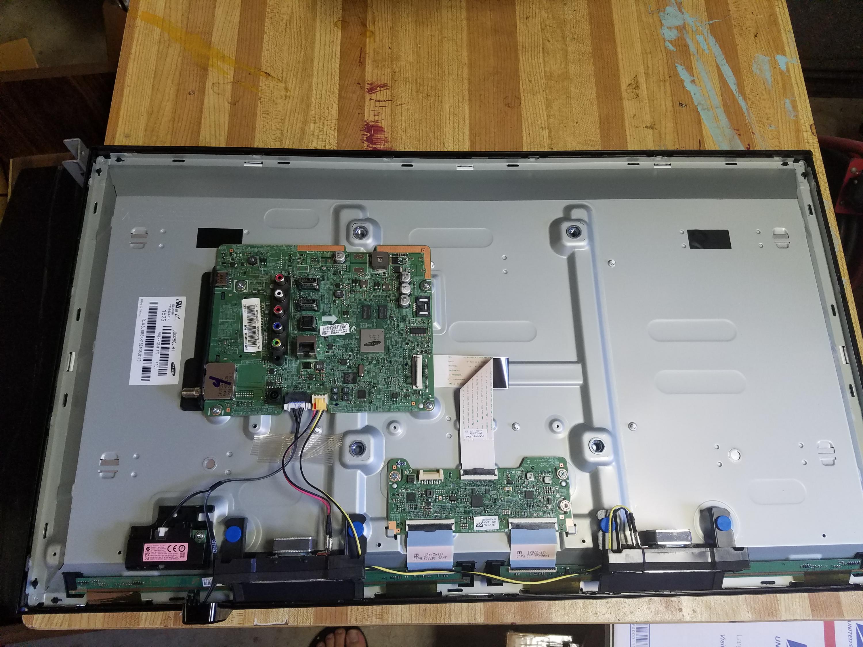

    You have a failed Led in the Lcd screen, would you like a link to the video on how to test them ?
    • johns1mj
      • May 2015
      • 242
      Re: Samsung un32j5205
      If i have a failed led would disconnecting them bypass them allowing the tv to start or does the circuit need to be complete?
      • CapLeaker
        Leaking Member
        • Dec 2014
        • 8044
        the circuit needs to be complete. The LED's are strung like a X-Mas light chain. One goes out, the whole string goes out. So you have to take the panel apart and find the bad LED and replace it.
        • johns1mj
          • May 2015
          • 242
          used two batteries for 2.5 volts. tested all 21 leds. they all lit up.
          • johns1mj
            • May 2015
            • 242
            Sorry 14 led two strips

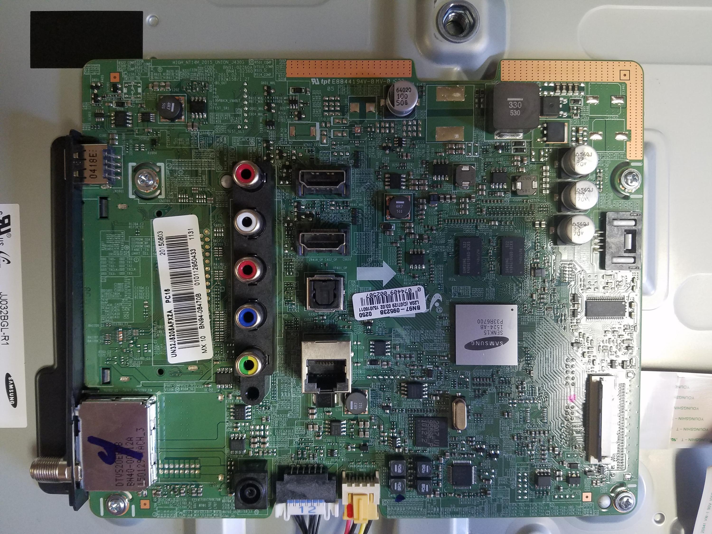

                Were did you get this set? as UN = Samsung supplied to US market? can only find BN94-08470B main board from USA ?
                • johns1mj
                  • May 2015
                  • 242
                  ok, lets start at the beginning. The tv power light will flash 6 times, I believe this is standard for samsung. I have no startup chime or display.
                  • johns1mj
                    • May 2015
                    • 242
                    yes they are like $20 on ebay. That is the correct board for my tv.
                          Solved!!
                          Check your power supply. Mine was only putting out 14v. The TV needs 19v to run. I replaced the power cord and all problems were solved.
