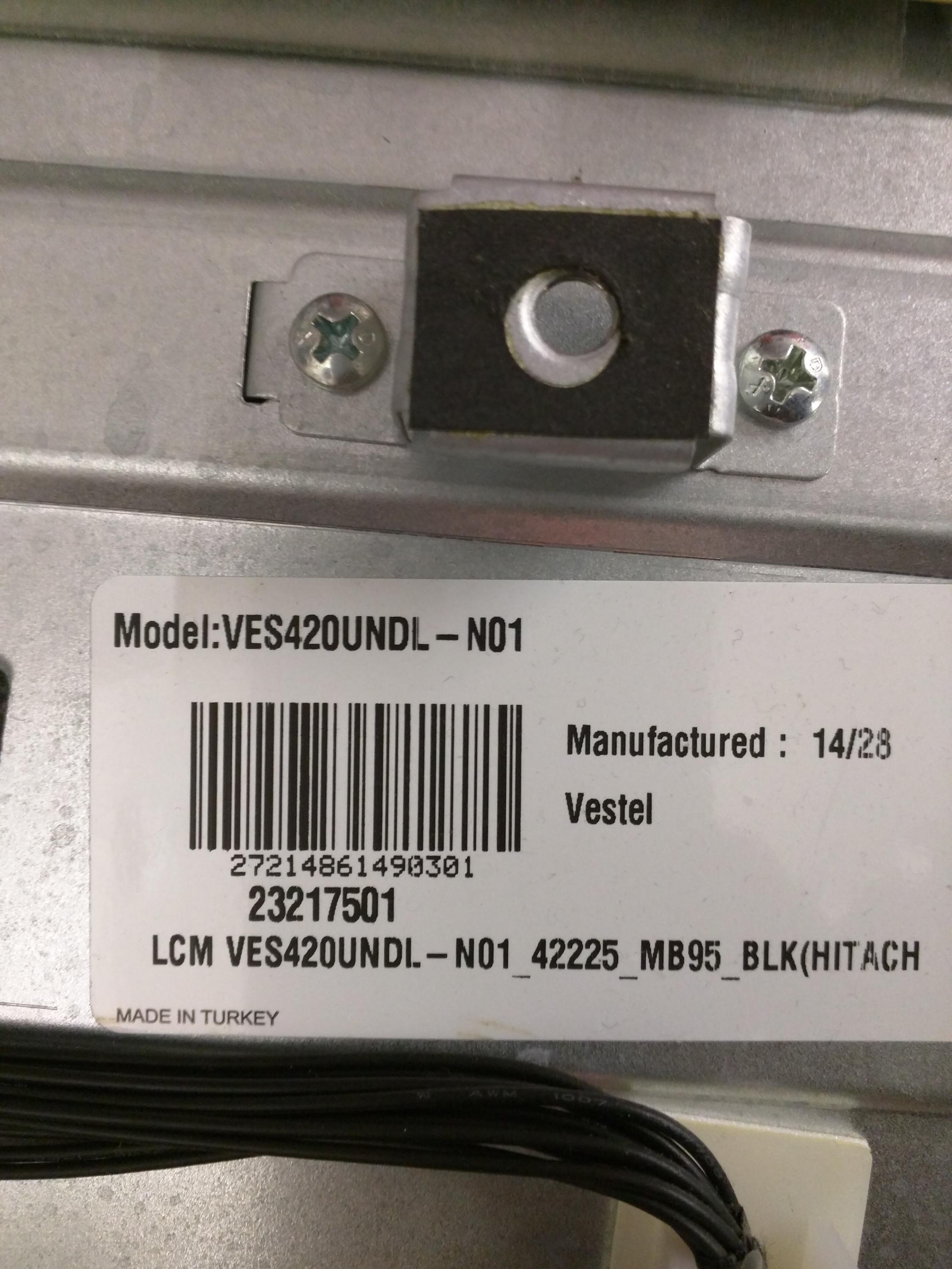

    Urgently need a used panel for this tv. Must be in the UK. Anyone got one??

    Is it cracked ? Also WNDL is an Lg 42" Fhd panel, the model should be near which is on another stick can you get an image ?

      Cracked by yours truley lol. I'll get image tuesday as aim off work till then.

        Anyway the Lg panel model number will be on a sticker and something like LC420WXU SF E1

              No other sticker. On the metal bit i see:
              mb95 fhd-lg2d
              42180 dled
