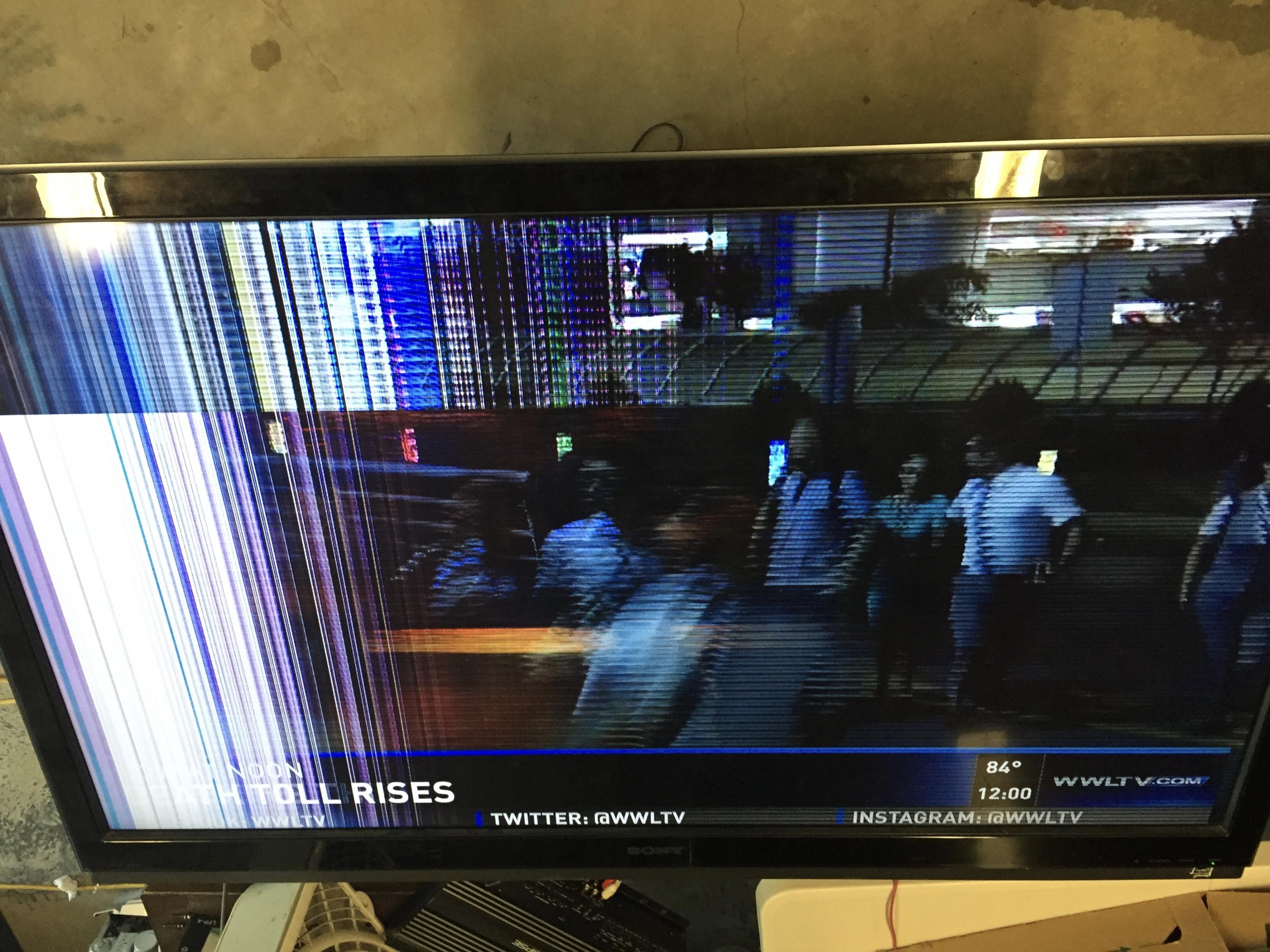

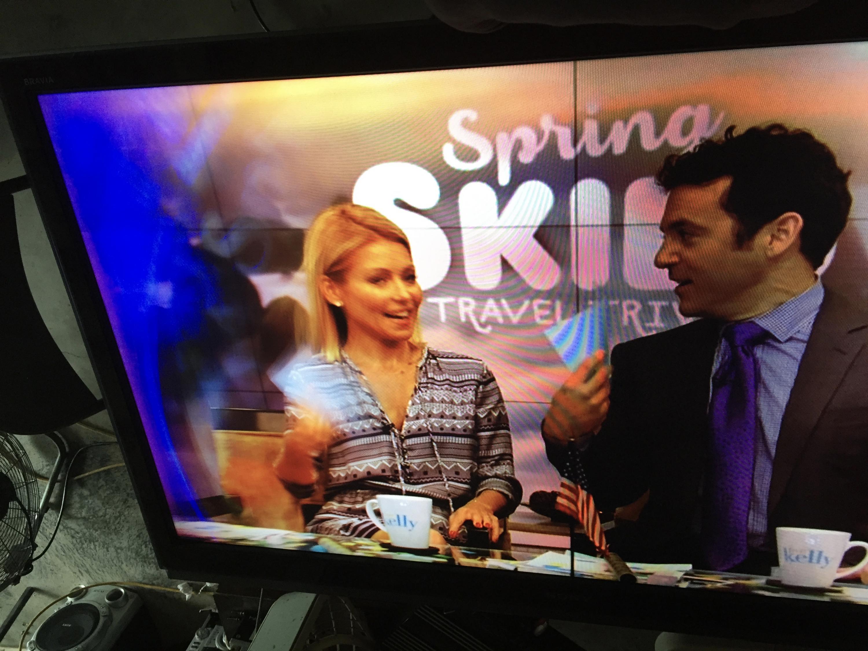

    The tv is having some ghosting and lines on the screen. I can hear a low pitched noise on the t con when the whole screen is distorted.
    Is this a tab bonding issue?

    i would say its worth to give try first with tab bonding
      Re: Sony KDL-52VL150
      This model is known for having bad tab bonding problem.
      This is my TV that I fixed with bad tab bonding, and I use it everyday for many years now.
        It was the top left tab bonding, I will try and order a thermal pad sheet.
