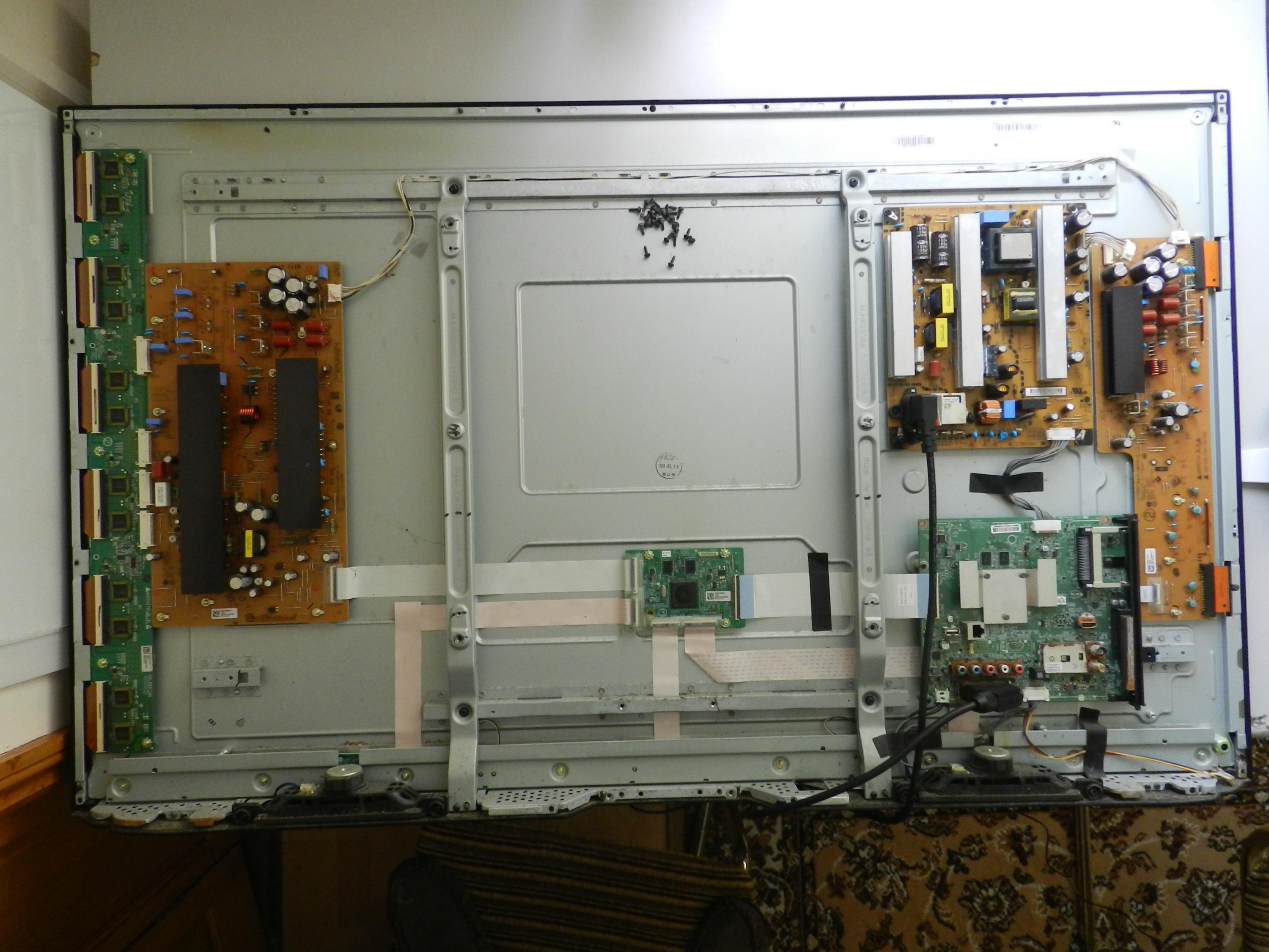

    I've acquired this set which has a shattered screen that I intend to strip down for spares/repairs.
    I've disconnected the power supply from the Xsus (which links across to the Ysus) and all the power supply voltages come up when switched out of standby.
    The set also has sound and respond to the remote control.
    Is there any way to power up the Xsus, Ysus and control board for testing without blowing any of the boards.

    ould have thought the chassis would run if all is well--providing the tabs to buffers and X are disconnected from the boards...
    --Never tried it, but cant see why it shouldnt run...

      Thanks Alastair, That's what I was hoping I could do. Will let you know how it pans out.

          Checked both Xsus and Ysus panels for shorted diodes, mosfets and all appeared to be fine.
          Powered up with the plasma panel ribbons disconnected and reconnected all supply cables.
          Measured +Vy and Vzb. The +Vy voltage was rising fairly fast towards +300V and then dropping out. I believe that over voltage protection was kicking in.
          So it certainly doesn't look like any major faults on the boards.
          Thanks to Alastair for his advice.
