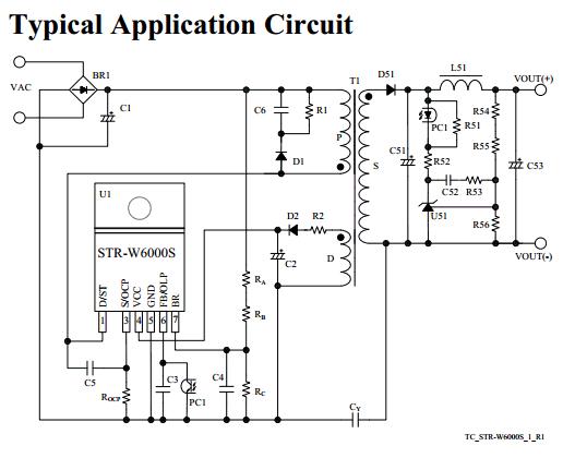

    As I indicate thee board in question does not have PFC, but you still have SMPS circuit that will still generated the back EMF by that power transformer, please read up on when happen when energize and deenergize inductor then you will understand why they put in the 1000V higher cap in that section. That cap is exposed to much higher that 330vdc.
    http://i.stack.imgur.com/REXp2.png look at c12 which has the same function as CM804 of your power supply board.
    http://electronics.stackexchange.com...details/254675
    https://cdn.badcaps-static.com/pdfs/...4fc807c47b.pdf
    See page 13, (F) = Voltage across the MOSFET Q1
    BTW, common failure mode of ceramic cap is shorted circuit.

      Let me question the cause-effect order of this apparently recurrent failure. If ceramic capacitor is 1KV rated, and the TV is powered from 230V AC, at that point of the PSU there's nothing that can generate more than 1000V. I'm starting to think that it's the capacitor that fails first. The IC gets shorted because the cap shorts briefly before blowing to bits. What else can make a ceramic capacitor explode this way?
      I see no problem in removing the white insulation glue. I use a small flat screwdriver to remove some big chunks and then I unsolder the IC. Once all legs are unsoldered, just pull the IC and all the glue that comes with it.
      Thanks for the tip, will try to get the last gunk off after desoldering the bad parts, still waiting for the replacement parts.
      I was just assuming the STR-W6052S failed first because in my experience with power supplies MOSFETs usually fail while ceramic capacitors rarely do so.
      After looking at the datasheet for STR-W6052S I'm starting to understand it a little better, they have sample schematics in there which seems to match the board. I'm a bit of a rookie with this type of circuit though, anything involving high voltage stuff. On the bright side, at least I learned something new today, figured out what a "damper snubber" cap is.
        Re: Samsung BN44-00505A(PD23A0Q) psu, smd transistor types
        "usually fail while ceramic capacitors rarely do so. " if look through lots of threads at BC and fix lots of circuit in that power supply section you will this type of caps failed in this application and we also recommend going with even higher Voltage rating.
        "After looking at the datasheet for STR-W6052S I'm starting to understand it a little better, they have sample schematics in there which seems to match the board. I'm a bit of a rookie with this type of circuit though, anything involving high voltage stuff. On the bright side, at least I learned something new today, figured out what a "damper snubber" cap is."
        You should also look at the board and see how cap CM 804 is connected to the STR also, it is basically connected across the switch (Source and Drain, Pin 1 and pin 3 of the STR) in this case it is the internal power MOSFET inside the STR.

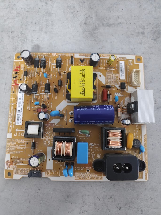

                              My Samsung T24B301EW broke, blue status LED is on, so there is some power, if trying to switch it on the LED blinks 3-4 times slower then blinks very fast, nothing happens.
                              Found this thread, trying to understand, whats going on.
                              Took a look at my PSU BN44-00505A, some pictures here: https://imgur.com/a/AnmN8sD
                              CM855 seems to be damaged, could it be the only reason for behaviour? Can you pro people maybe spot other damage or suggest which parts I should inspect further?
                              Trying to locate other parts mentioned in thread, seems I can not find that STR-W6052S, any hint where to look?
                              Am a beginner, not totally clueless but bare with me please, have soldering iron and simple voltmeter. Managed to fix a dead old harddisk a few month ago with motivation from Louis Rossmann videos, "just try it" attitude, a lot of google, ordering and exchanging mainboard and switching smd rom chip with borrowed hotair station.

                                FYI, replaced CM855 with a new 10 V 1200 uF, TV works again.
