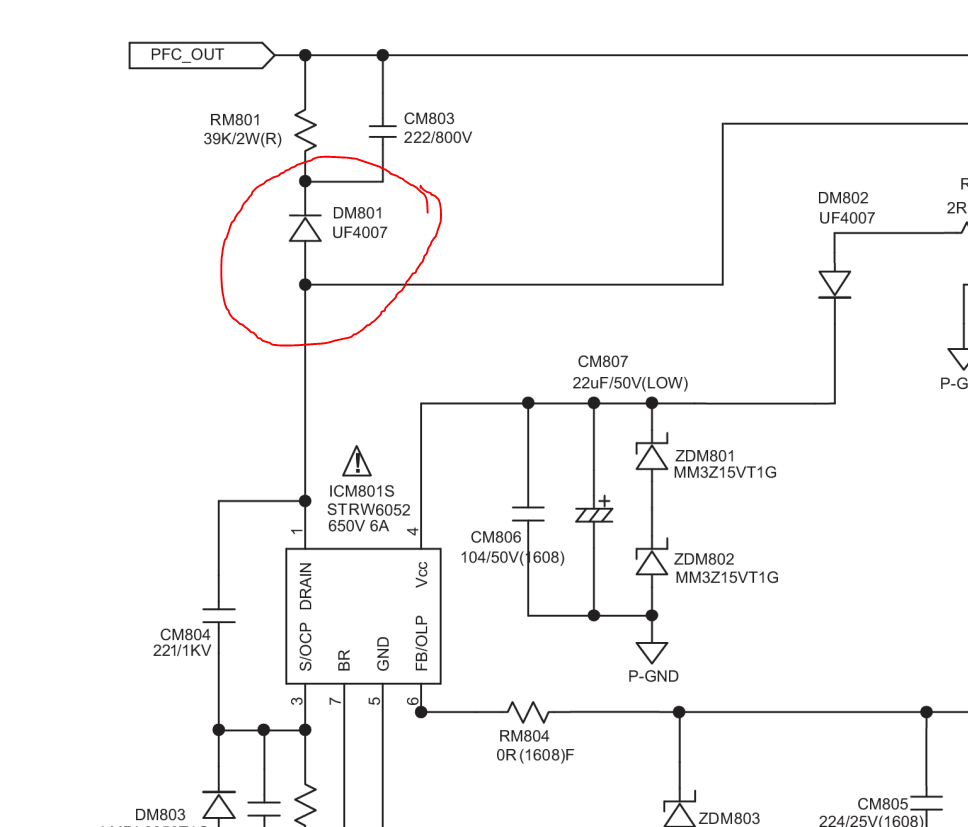

                  CAN SOMEONE HELP ME? WHAT IS THE REFERENCE OF THE DM801 DIODE?
                  • lotas
                    • Jan 2016
                    • 4905
                    • Russia
                    #50
                    DM801 - UF4007

                      Hi, I am trying to repair the specific SMPS. The STR W6052S seems okay (high resistance to all pins). What's the point of the diode if the low ohm resistor beside (RM803) makes the circuit almost shorted?
