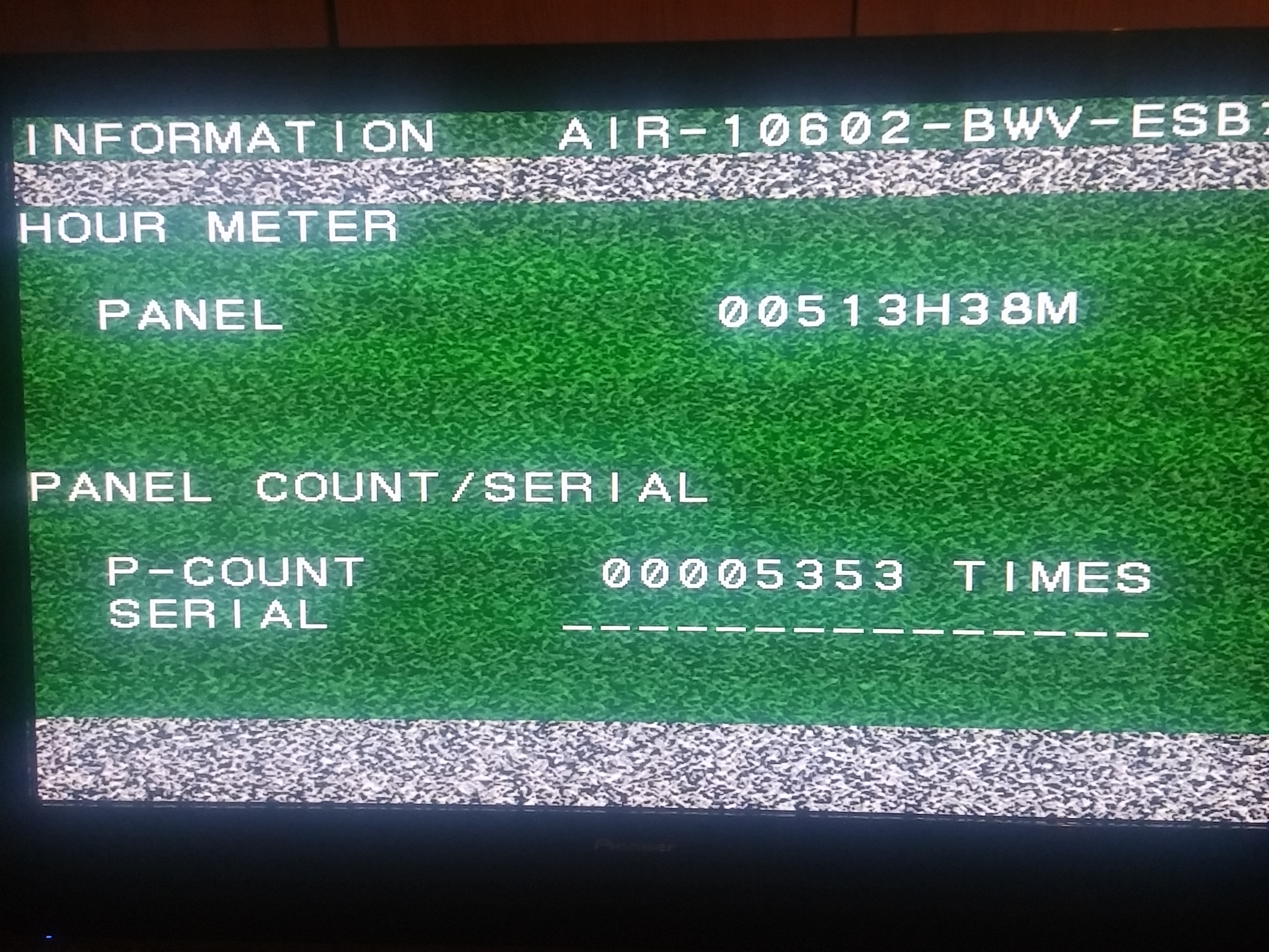

    Just got this tonight. Panel hours says 00513h38m. Does this mean its been on for 513 hours total as it seems in plausible here is a photo of the service menu. Is it possible someone has reset this. Cheers.

    First off can I ask how you get into the SM ? Also yes 513 hours is very low tbh basically new

        Ok cheers, also I dont think there is a way to rest it. Does it look physically like its had more use age. Maybe take the back off ?

          Well the p count that i presume is power on times is over 5000. Is p count power on times? Its a shame really. Paid £10.50 for it cause they thought the hdmi ports were broken but they were just turned off in the menu.
          They didnt mention the light 4 inch scratch right down the center of the screen. Ill see if i can polish it out or something but if not ill probably end up stripping it.

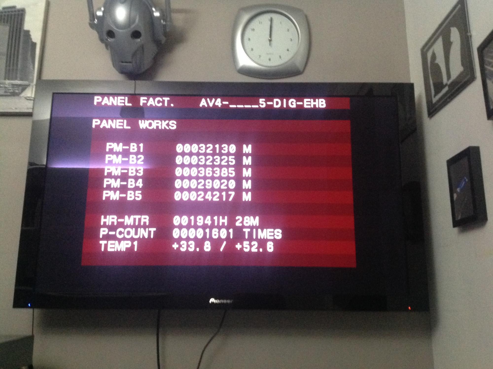

                Also I want to say thanks for that info, helped me finally get into the SM on my 508XD lol fucking hell also this has less than 2000 hours on it !
